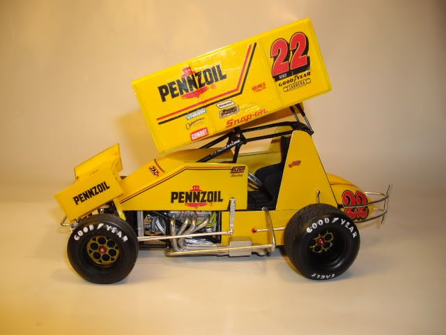

Helix Posted February 17, 2016 Posted February 17, 2016 You can buy upgraded parts such as wheels, Hood, exhaust, Mud guard for this kit, through 'The Parts Box' in Australia..... At least it will look updated if you utilise these parts, here's an example of what I achieved.

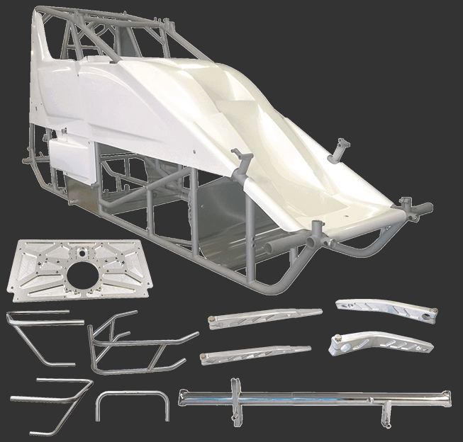

Ace-Garageguy Posted February 18, 2016 Posted February 18, 2016 (edited) Are the cars then sort of (CKD) kit cars, or cobbled together by the racing teams, to their own or national (US, CAN, AUS safety) specs, with parts from different original equipment manufacturers (OEM)? Once again, Google is your friend. For definitive answers, try searching "sprint car chassis kits". Several manufacturers supply chassis and body kits that meet the sanctioning body requirements, and there are specialized engine builders, component suppliers, etc. These are NOT junkyard cars...though there is nothing to stop a competent fabricator from building his own chassis, providing it meets the specific technical requirements of the relevant rulebook. Similarly, engines can still be based on junkyard-sourced major components. Some engine builders STILL prefer to start with "seasoned" blocks that have been run in extended passenger car service, citing post-machining dimensional stability. Edited February 18, 2016 by Ace-Garageguy
