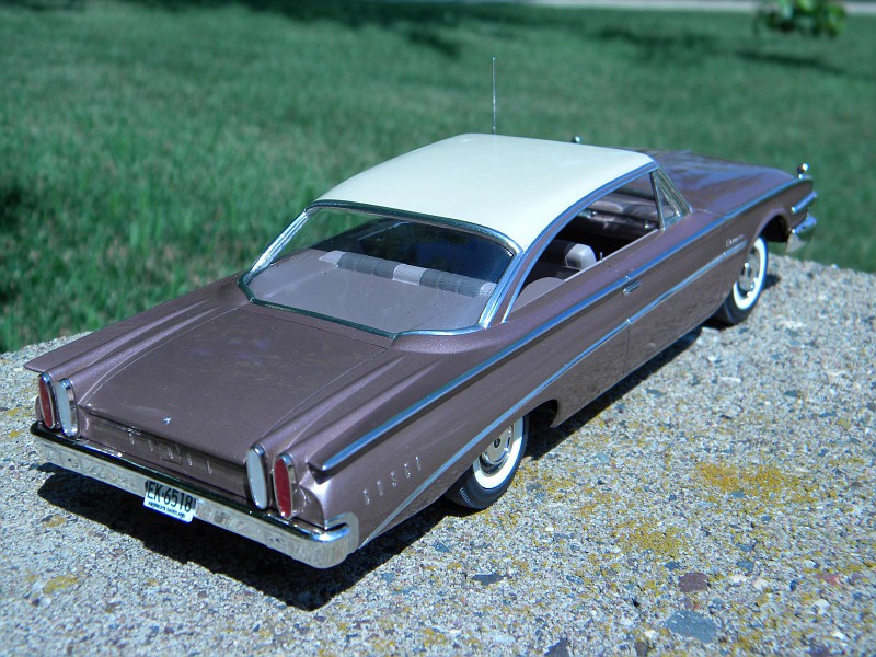

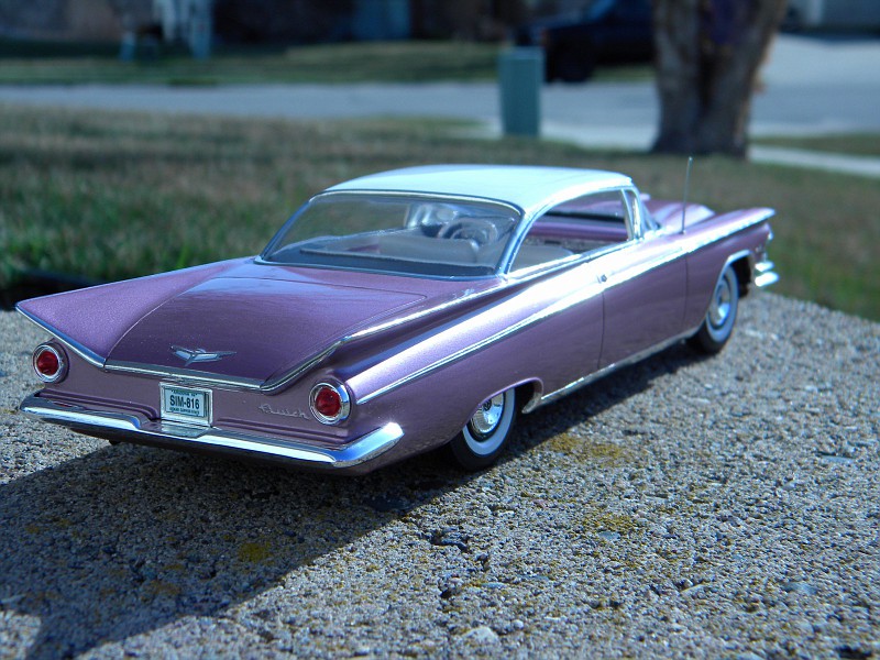

StevenGuthmiller Posted December 28, 2017 Share Posted December 28, 2017 1 hour ago, Zoom Zoom said: I often cut very thin strips of foil that are close if not exactly the width I need, and carefully apply it so little or no trimming is necessary, especially on trim that has poor engraved detail to use as a cutting guide. I need to try the tape trick as well, though I'm pretty satisfied w/my method, which is easy enough even if/when my hands aren't totally steady. I cut thin strips of foil like you do for certain pieces of trim that are completely straight, mainly for interior door trim, but that only works well for straight pieces. If your trim is curved or tapered or oddly shaped in any way, it's difficult to get it cut to the correct shape & size. I use the tape method for everything from side spears to window trim. It gives you perfectly clean & straight edges on everything you foil. If you cut your tape strips thin enough, you can even get it to bend around wheel wells to give you a nice clean edge. Steve Quote Link to comment Share on other sites More sharing options...

Snake45 Posted December 29, 2017 Share Posted December 29, 2017 21 hours ago, StevenGuthmiller said: I cut thin strips of foil like you do for certain pieces of trim that are completely straight, mainly for interior door trim, but that only works well for straight pieces. If your trim is curved or tapered or oddly shaped in any way, it's difficult to get it cut to the correct shape & size. I use the tape method for everything from side spears to window trim. It gives you perfectly clean & straight edges on everything you foil. If you cut your tape strips thin enough, you can even get it to bend around wheel wells to give you a nice clean edge. Steve Steve, those are both beautiful! Don't believe I've seen either one of them before. You are DA MAN! Quote Link to comment Share on other sites More sharing options...
