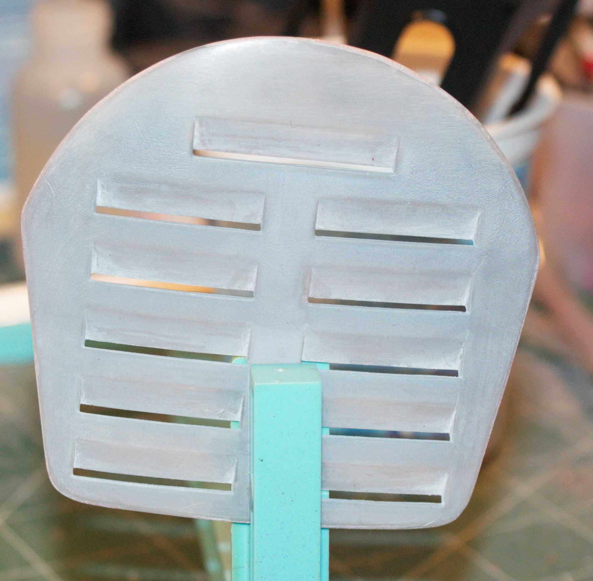

Ro3bert Posted April 26, 2018 Years ago I got a 1/16 scale Monagram F 40 Ferrari, did some work on it including priming the rear (clear) window. I couldn't find what color it was supposed to be and assumed it was to be painted along with the rest of the model. Recently I got to thinking about whether it was supposed to be painted and decided it shouldn't have. I put into a pot of brake fluid I'd used to strip something else black and primed. Oh, boy what a mistake and disaster. The window was stripped of the primer, or at least softened so I could brush it off under the faucet. Now for the problem, it seems to have been dyed gray. I tried to get it clear by sanding and later by dipping into alcohol but nothing seems to have worked. Sorry the images are so large, should have made them smaller to start with. I know I should have provide fresh brake fluid but I didn't (didn't really think about it being dirty) so now I have a gray window. Is there any way to de-dye it? or do I have to sand blast it? It is very thick so if I have to I can sand it until the color is gone. I suppose I could just put them back into clean brake fluid but since both sides are that gray color I'm not sure it would help. Any suggestions would be appreciated. I don't have that small airbrush sand blasting kit and can't afford it just now. Robert Quote Share this post Link to post Share on other sites
935k3 Posted April 26, 2018 It's not dyed. It is etched by the hot primer, It need sanding and polishing to bring it back. Quote Share this post Link to post Share on other sites
Snake45 Posted April 26, 2018 29 minutes ago, 935k3 said: It's not dyed. It is etched by the hot primer, It need sanding and polishing to bring it back. Dr. Snake's second opinion concurs. You'll have to sand and polish. Quote Share this post Link to post Share on other sites
Ace-Garageguy Posted April 26, 2018 Forget it. The clear plastic may also have been attacked chemically by the brake fluid. Different plastics react differently, and clear parts are chemically different from not-clear parts. Even if the problem is only etching on the surface (from the primer or the brake fluid), it would take a lifetime of painstaking work to sand and polish all those little areas. If you want to broaden your skill set, the part is probably large enough to use as a master to make a mold to make a vacuum-formed clear replacement from. If it were me, I'd try to find a gluebomb that has a good window. Not impossible, but it will take some looking. Quote Share this post Link to post Share on other sites
Ro3bert Posted April 26, 2018 Thanks all, I guess I'll try sanding first. The thought of using it as a mold is a little daunting but I have a vacuum pump from an old auto air condition station that I have always thought of using for vacuum forming but have never tried. Making a vacuum forming machine would be a bit of a job but since I've kept it all these years I might as well get going. Besides it would certainly do my modeling skills a world of good. Wish I'd known what Bill said about the possibility of the brake fluid attacking the plastic. Learn something new every day. Robert Quote Share this post Link to post Share on other sites

Snake45 Posted April 27, 2018 It's not a certainty that the brake fluid damaged the part internally, though it's a possibility. I know if you put naphtha on styrene and stress it in any way, it will crumble like a cookie, but let it dry out completely and it's fine again. I'd at least try polishing a small, easy section to see what it looks like. I'd use #1000, then #1500, then #2000 wetordry, wet, and then Wright's Silver Cream. Walmart's Trim nail stick 3-set would make quick work of it, but they haven't had them in almost a year and I don't know if they ever will again. Quote Share this post Link to post Share on other sites

LDO Posted May 7, 2018 (edited) A vacuum formed copy will have very soft detail for those vents. Polishing will also soften the hard lines. IMHO, your time would be better spent looking for a replacement kit part. Put an ad in the wanted section. You never know what might turn up. I just sent off 3 packages to other members of this site, and I still need to get one sent out to Ace Garage-Guy. Edited May 7, 2018 by LDO Grammar Quote Share this post Link to post Share on other sites

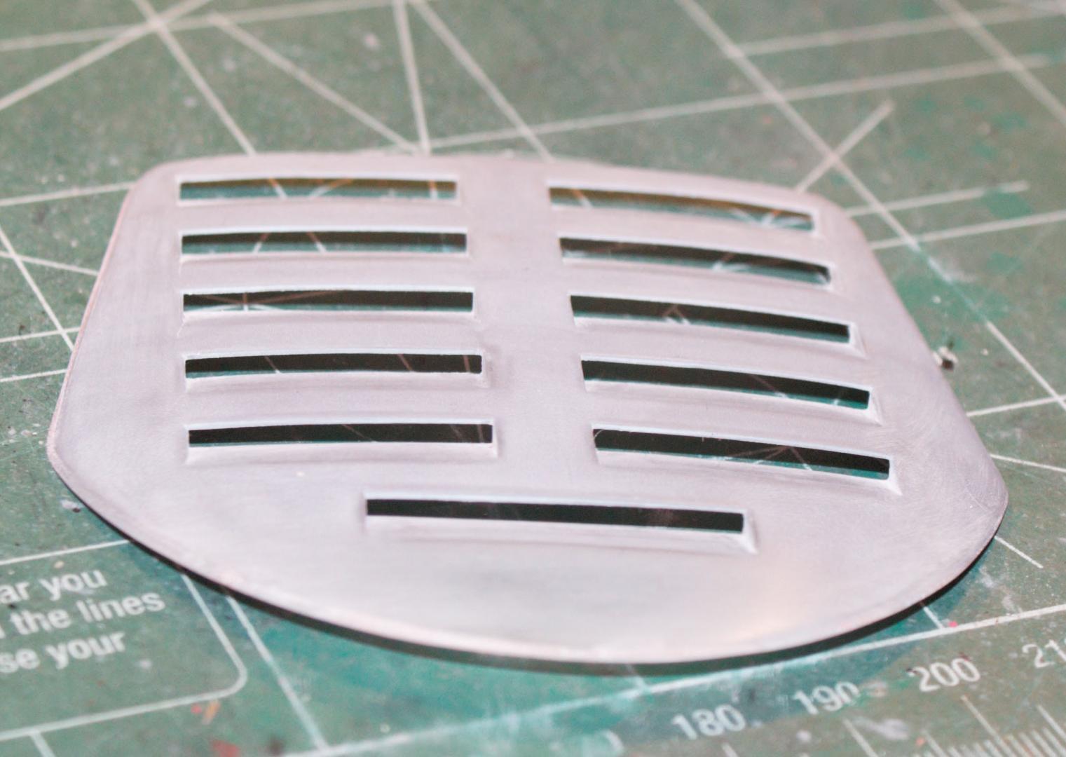

ChrisBcritter Posted May 10, 2018 Robert, here are the missing photos: Hope this helps. Quote Share this post Link to post Share on other sites
