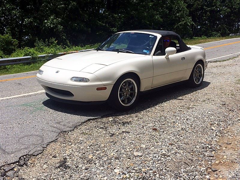

I'm enjoying this. We had a 1995 M Edition. Beautiful car in Merlot Mica, tan interior, and BBS Wheels. It was a ball to drive. I'm afraid my wife had a close encounter with a tree and it was totaled. Luckily she was not seriously hurt but felt terrible because it was basically her car and she let me drive it occasionally.

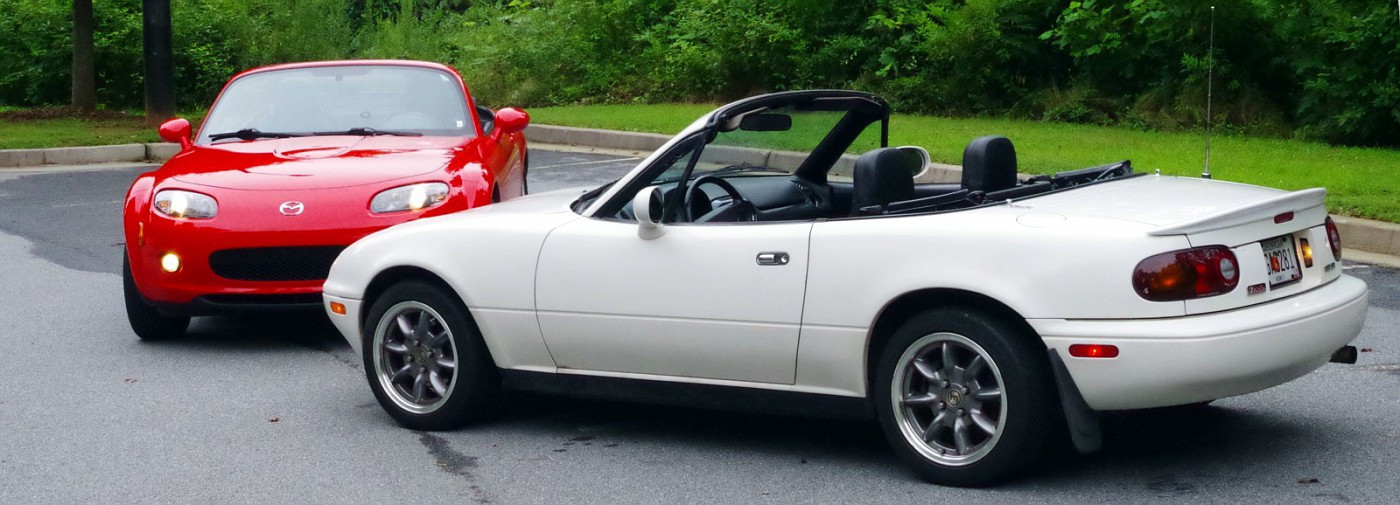

I plan to build a BRG and '93 LE someday, as well as finish the model I started of my own '96. The guy that bought mine has finished his model of it. I wish someone would do the Chaparral wheels that I had on mine, none of the various Panasport or similar wheels in scale are right.
I'd love to take Aoshima NB and make a Mazdaspeed. Lava Orange would be the color for sure!
Here's when I had both cars for about 3 months:
Here it is w/the new owner, he ditched the rear mud flaps and had Koni yellows installed so it sits a lot better now. It currently has a red OEM hardtop. Original soft top is still good but the rear window is shot:
One of my best photos of my NC was when a couple buddies and I hit the Dragon on a Tuesday afternoon in July a couple years ago, we made the Killboy highlights. We thought it might happen w/the trio of True Red NC's and they always let me drive in front LOL. On our way back south on the Dragon we came up on a pristine stock early NSX driven pretty well but he let us pass as we were going faster. We saw the grins on their faces on Killboy's photos that evening, they were enjoying  riding at the back of our little red pack.
As for driving the NC, I hated the looks with a passion when new. Now I love them, but they have to be lowered. I did new suspension which made a world of difference and bought NC2 used wheels from Goodwin Racing. My original OEM bumpstops have now failed 30k miles after suspension mods so I will upgrade the springs (again) to Progress Technologies & use FatCat poly bump stops. But first time I drove an NC was eye-opening, they had really improved the Miata dramatically, much stiffer structure, much more power, and the top operation is stupid-easy up or down from the driver's seat and when stowed it makes it's own tonneau cover. I have an ECU tune and new exhaust, so it's pretty quick, and it gets better fuel economy than my NA did (with about 40 more HP). Eventually I'll get a 2019-newer ND. Only have driven one ND a 2016 GT manual, didn't notice power increase on the short drive, driving position is better, and it leans a lot compared to my NC's upgrade. They are really nice. A friend is getting an orange 30th soon, trading in his 2018 ND Club w/Brembo package that replaced his beloved NC Club that was T-boned by an inattentive driver. He told me last week "the NC is a better daily driver, the ND is better for performance driving".
