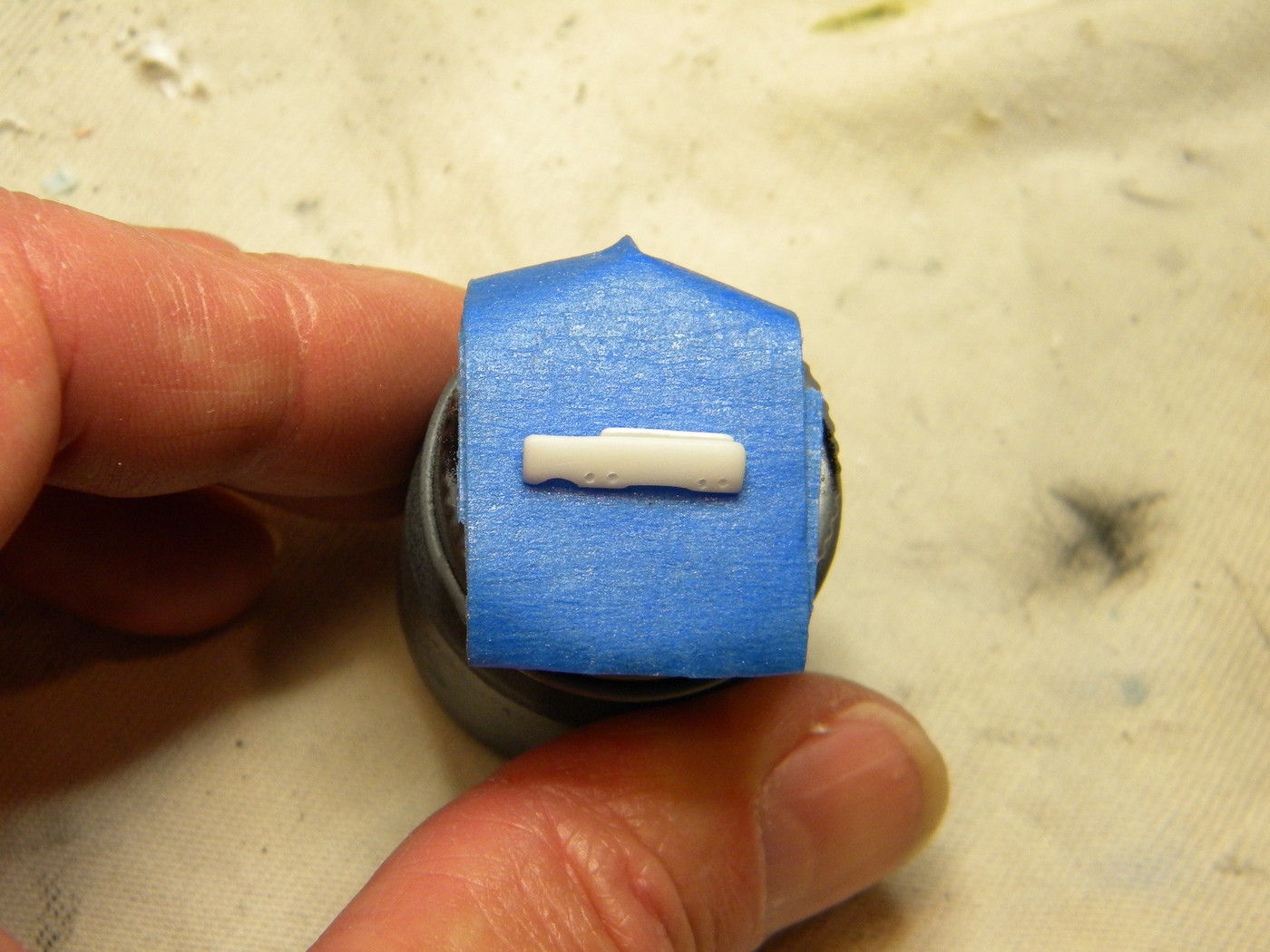

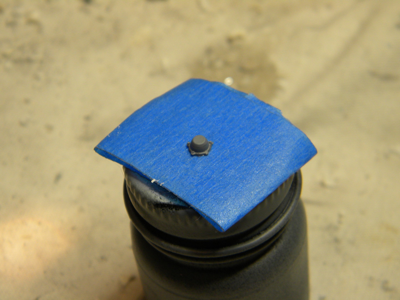

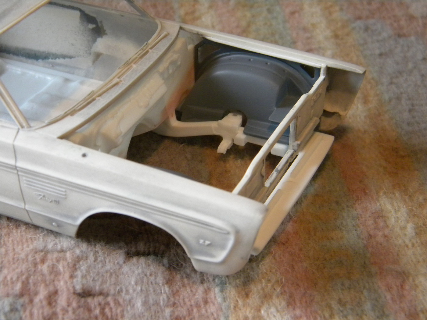

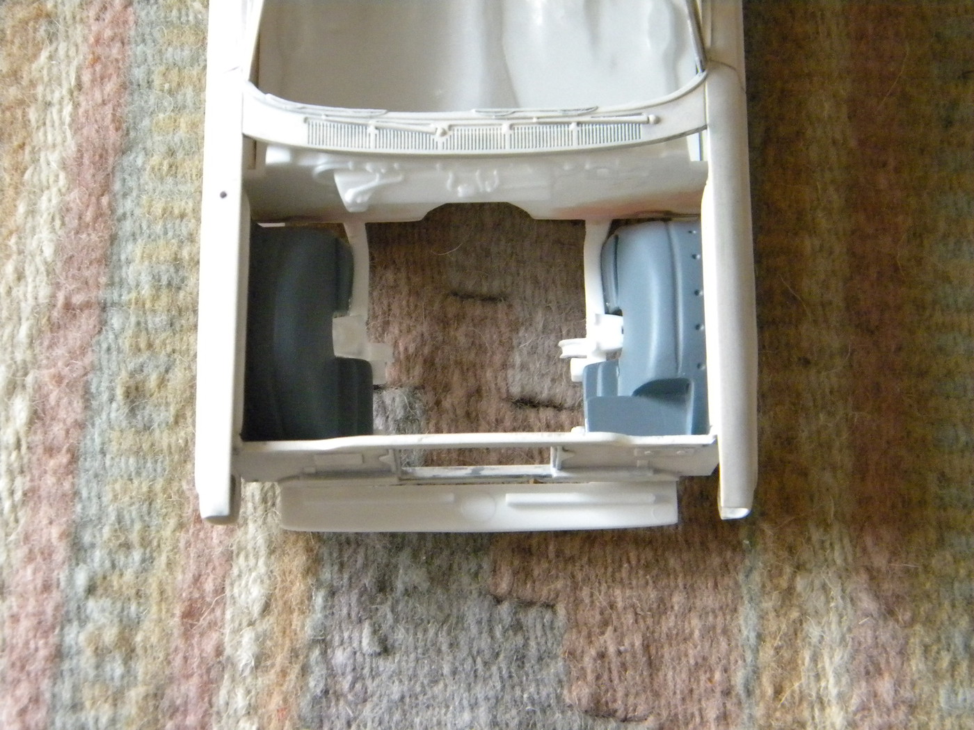

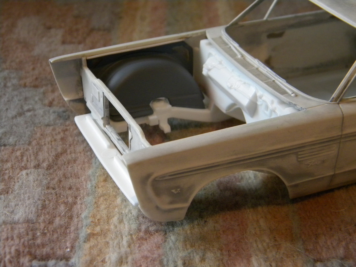

StevenGuthmiller Posted March 26, 2019 Author Share Posted March 26, 2019 Got a little more time at the bench today, finishing up the fender wells, getting them primed and then installed on the chassis along with the firewall. This will make it a simple "drop into the body" operation when that time comes. I will add some wiring and plumbing detail at a later time I am also experimenting with casting the center caps for the wheels and will see how they come out before I remove the originals. Then I whipped out a quick washer jar! My next step will likely be to begin contemplating the possibility of removing the convertible "top wells" from the interior and re-working the door panels. Steve Quote Link to comment Share on other sites More sharing options...

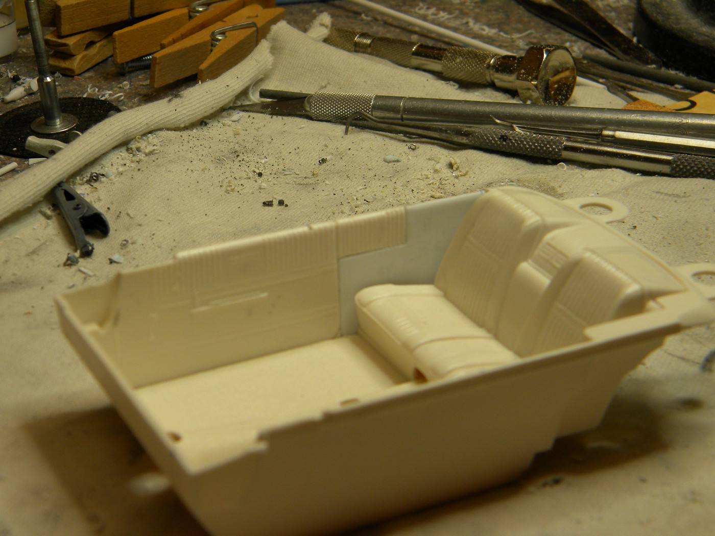

StevenGuthmiller Posted March 26, 2019 Author Share Posted March 26, 2019 Well, now I done it! There's no turning back now! The convertible top wells are going bye-bye. I'll be replacing the rear panels and then basically trying to save the pleats on the top and the emblem on the door panels. All of the rest of the trim will be removed and replaced. I wish myself luck! Steve Quote Link to comment Share on other sites More sharing options...

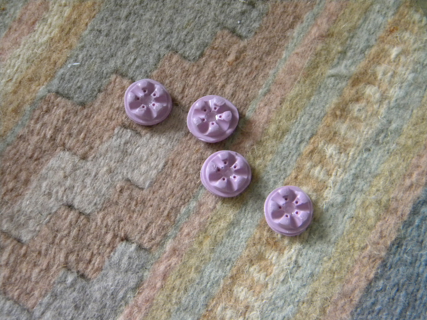

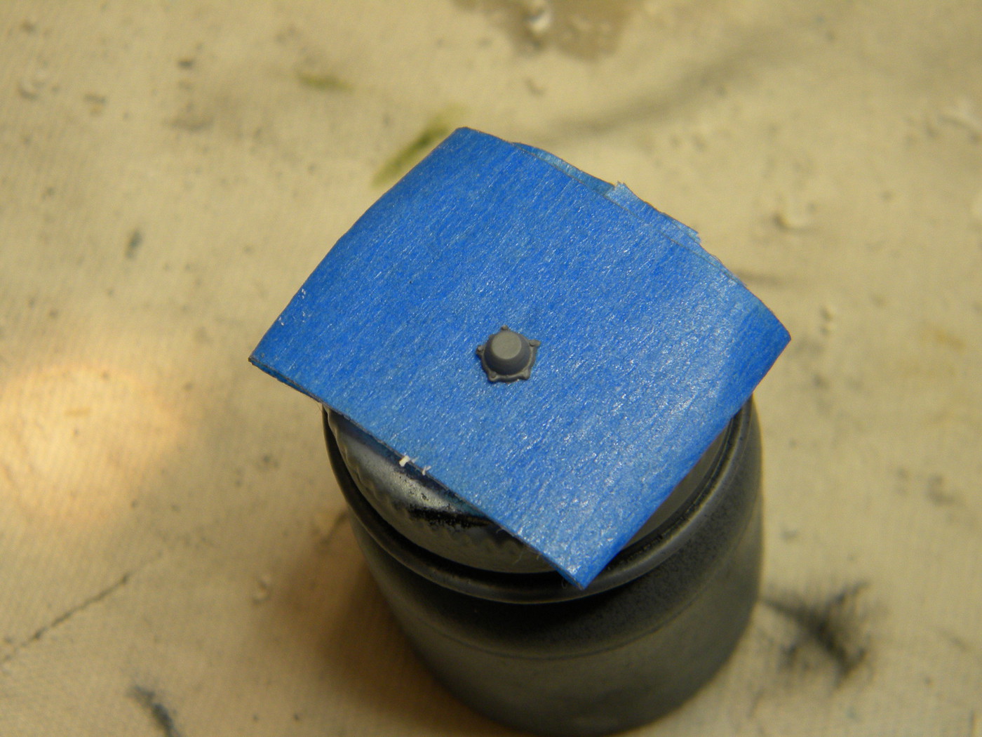

StevenGuthmiller Posted March 27, 2019 Author Share Posted March 27, 2019 Looks like a go on the cast wheel hubs! Steve Quote Link to comment Share on other sites More sharing options...

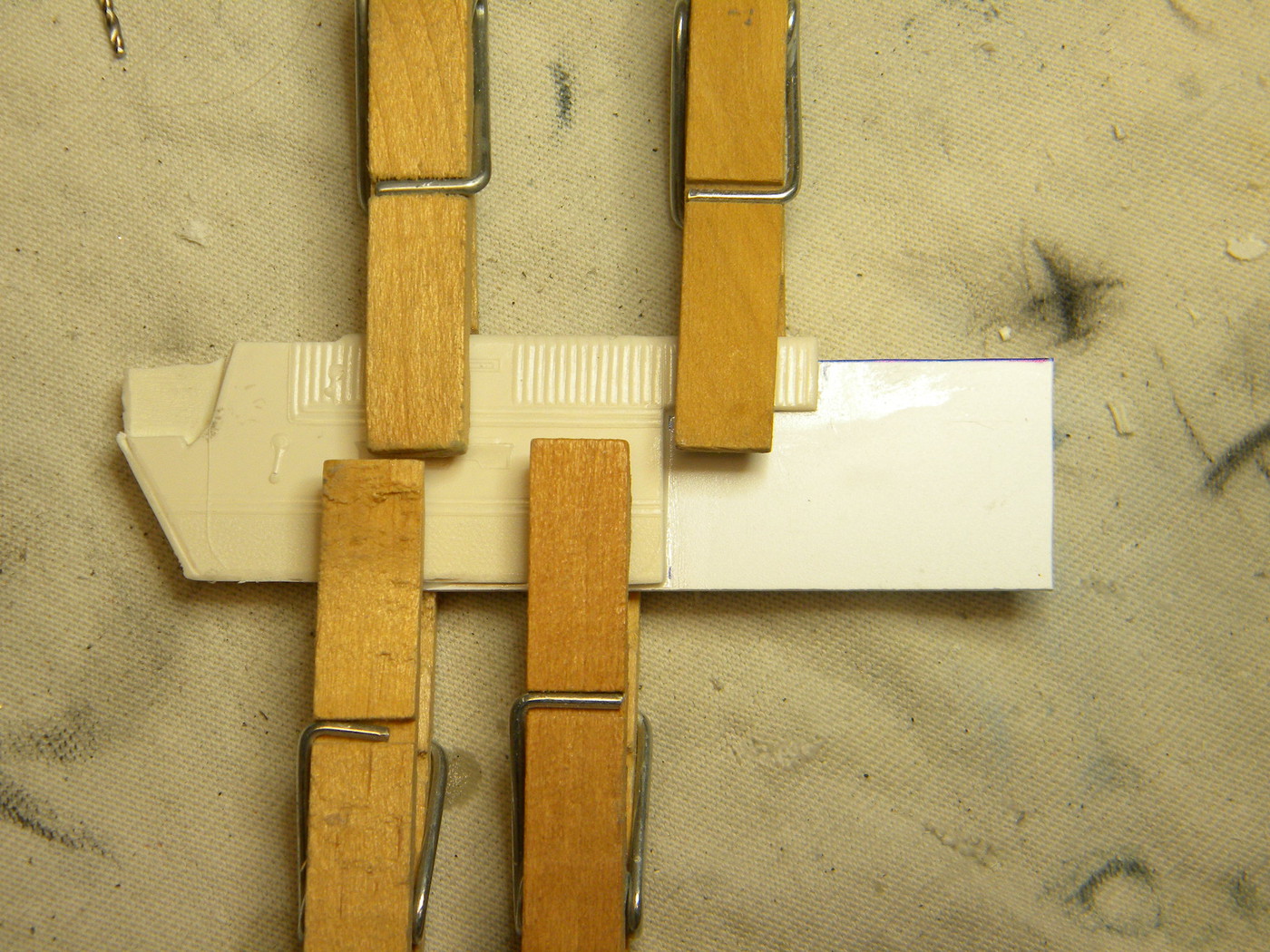

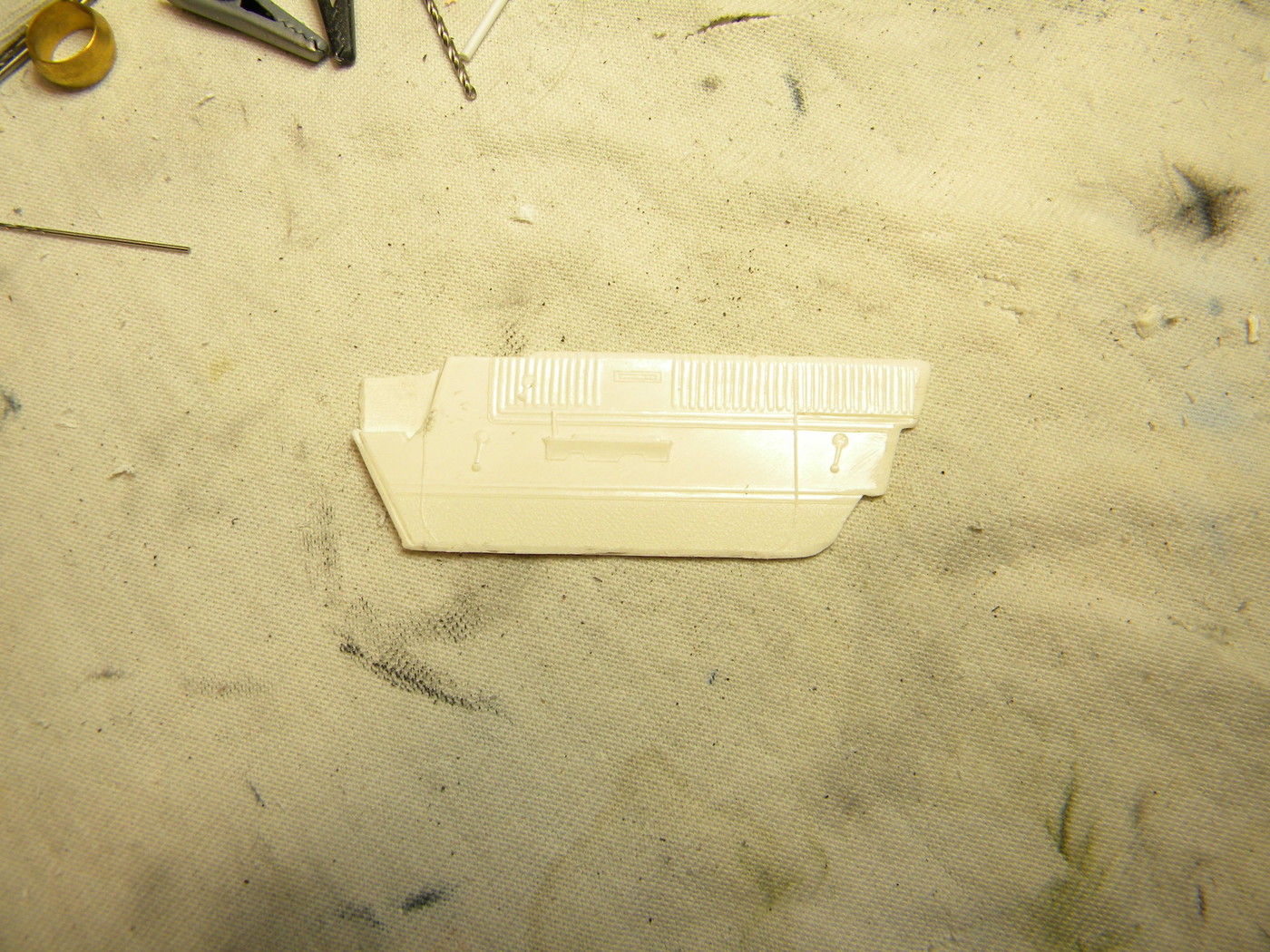

StevenGuthmiller Posted March 27, 2019 Author Share Posted March 27, 2019 So far I'm pretty happy with how the door panels are working out! Steve Quote Link to comment Share on other sites More sharing options...

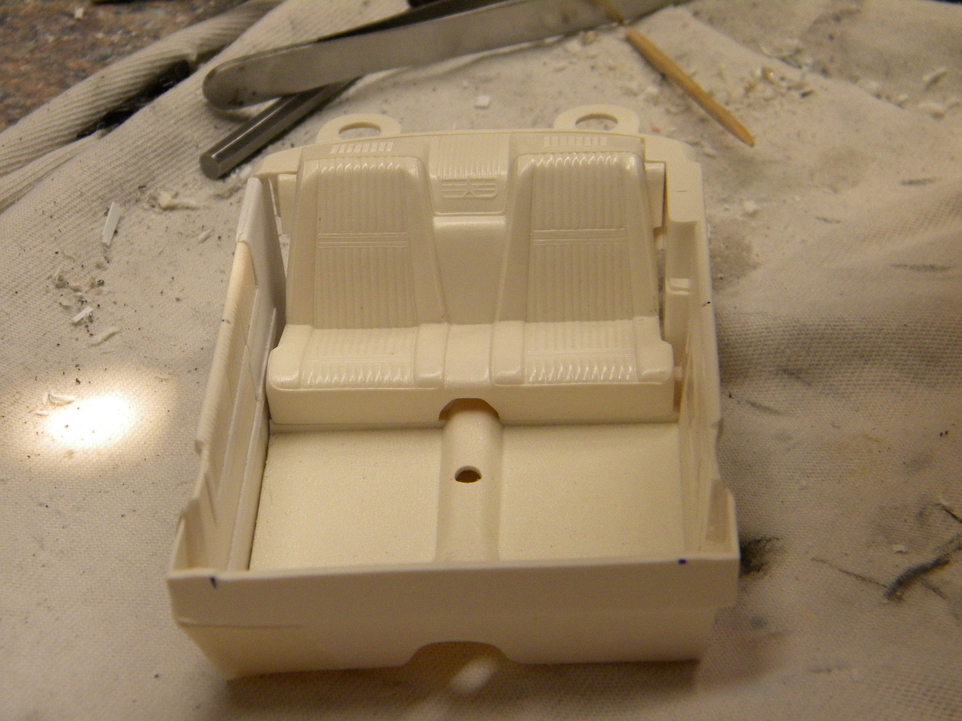

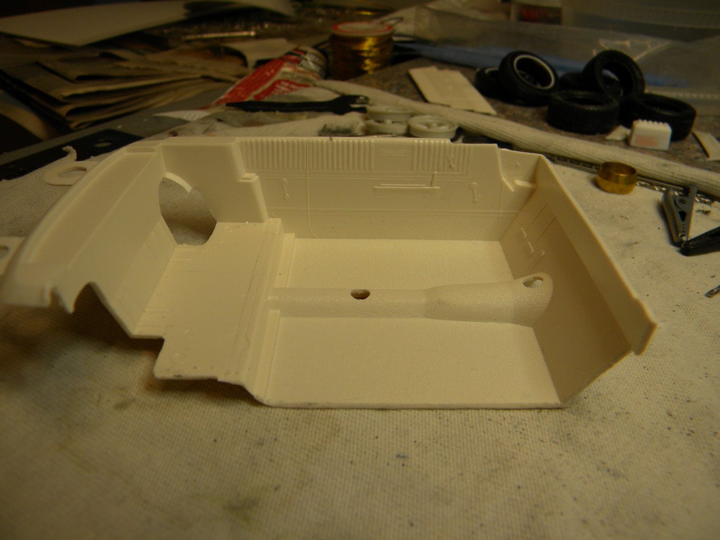

StevenGuthmiller Posted March 29, 2019 Author Share Posted March 29, 2019 Some more work on the interior. I have removed the bulk of the trim and have started to replace it. The pleated upholstery has been scribed deeper and shaped a bit This is some of the upholstery trim that will be sanded and painted the same color as the rest of the interior. Some chrome trim will be added later. I then began scratch building some arm rests. Steve Quote Link to comment Share on other sites More sharing options...

TarheelRick Posted March 30, 2019 Share Posted March 30, 2019 Good looking conversion on that interior. One question, will there be a gap between the ends of the seat and the new interior panel? If so what are your plans to fix it? Inquisitive minds want to know? Quote Link to comment Share on other sites More sharing options...

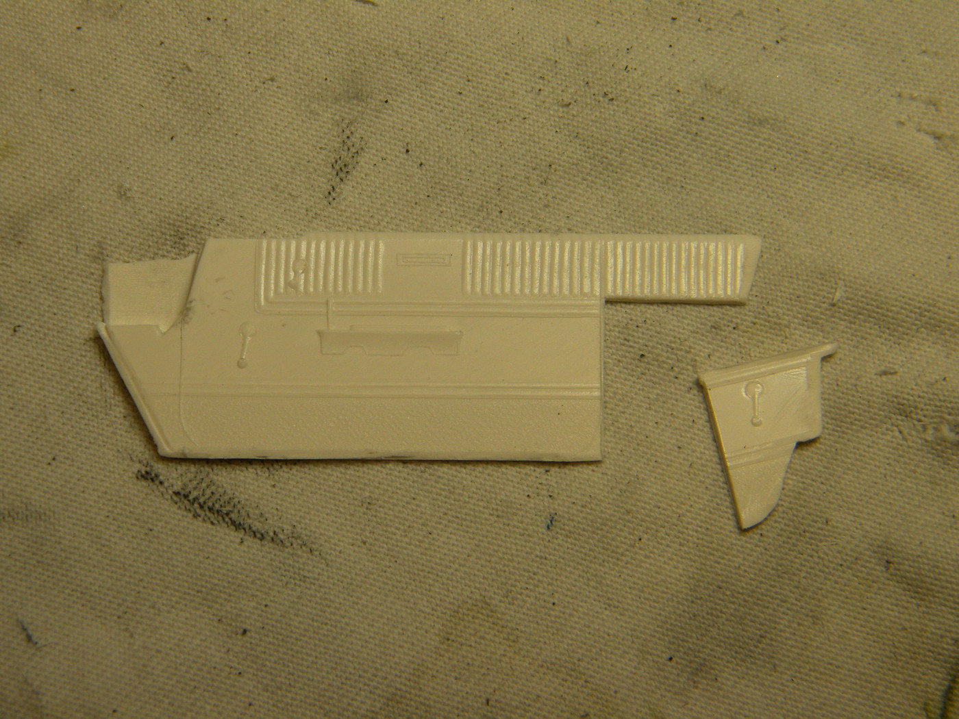

StevenGuthmiller Posted March 30, 2019 Author Share Posted March 30, 2019 5 hours ago, TarheelRick said: Good looking conversion on that interior. One question, will there be a gap between the ends of the seat and the new interior panel? If so what are your plans to fix it? Inquisitive minds want to know? Yes, there will be a gap. I have been contemplating this for some time. There was a gap between the door panel and the seat even before the modifications, due to the shape of the seat. Removing the top wells will increase that gap by about 2mm or so on each side, but I've decided that it won't be enough to warrant trying to figure out a way to widen the seat. The shape of the rear seat would make it difficult to find a place to widen it. I will be adding a slightly wider panel on either side of the seat something like the one that was already there. In this photo, you can see how the configuration looked prior to modification on the right side, and the added gap that will need to be addressed on the left. In my eye, it's not enough to justify figuring out a way to convincingly widen the seat. Keep in mind that the interior represented in this kit is correct for a Sport Fury anyway, and not a FuryIII, which is what the body represents. So short of a complete interior revamping, it will not be correct anyway. Steve Quote Link to comment Share on other sites More sharing options...
StevenGuthmiller Posted March 30, 2019 Author Share Posted March 30, 2019 It might require a little bit of refinement, but it looks good enough for me. Steve Quote Link to comment Share on other sites More sharing options...
