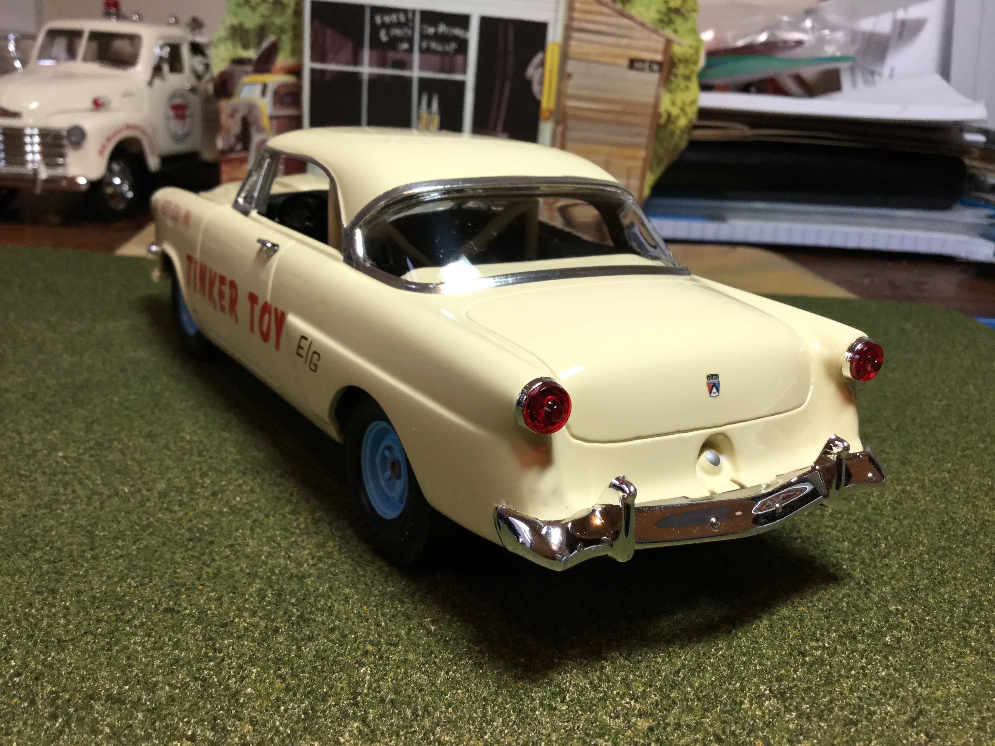

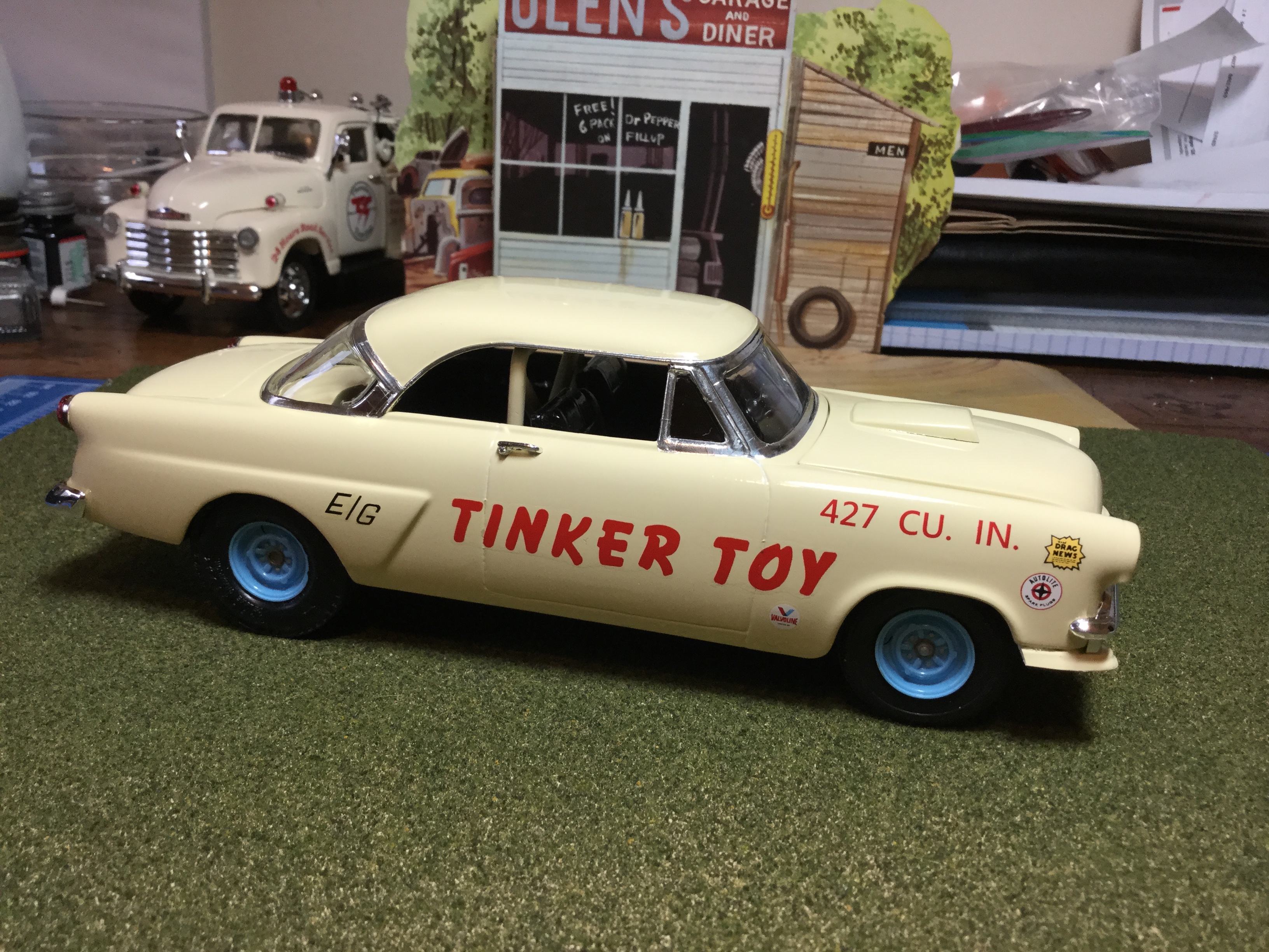

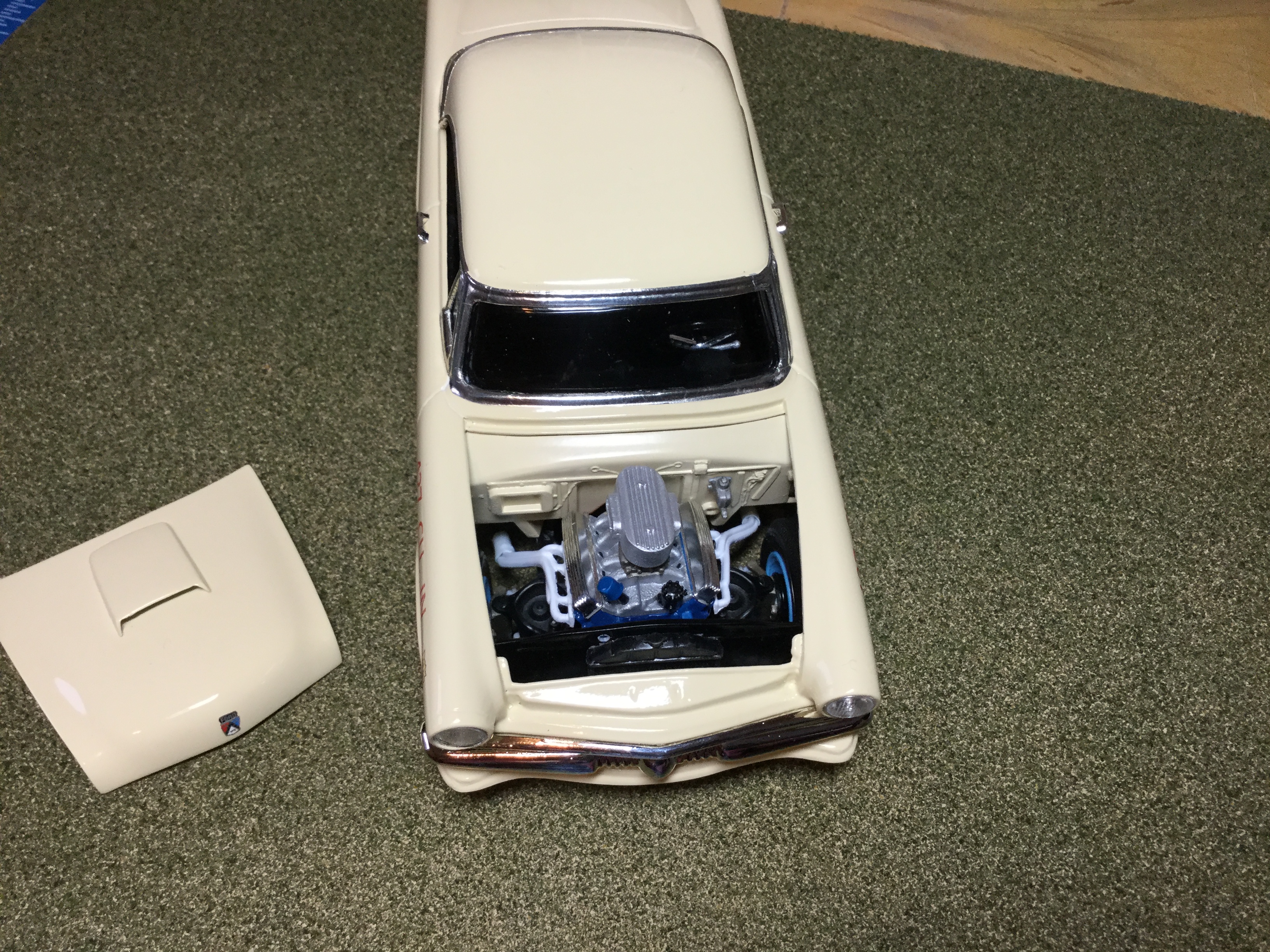

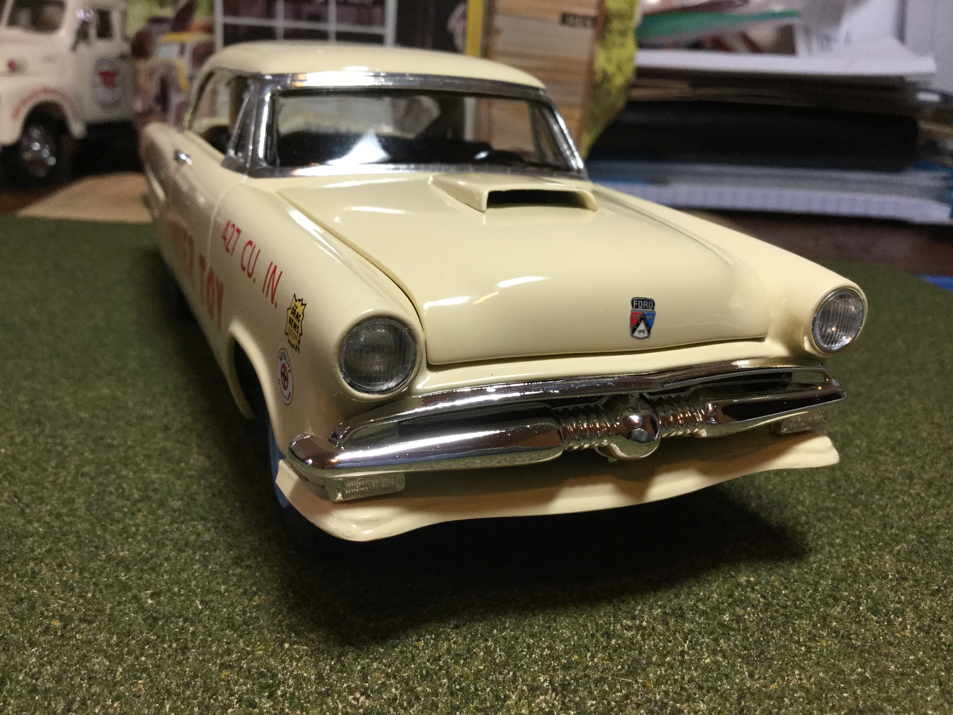

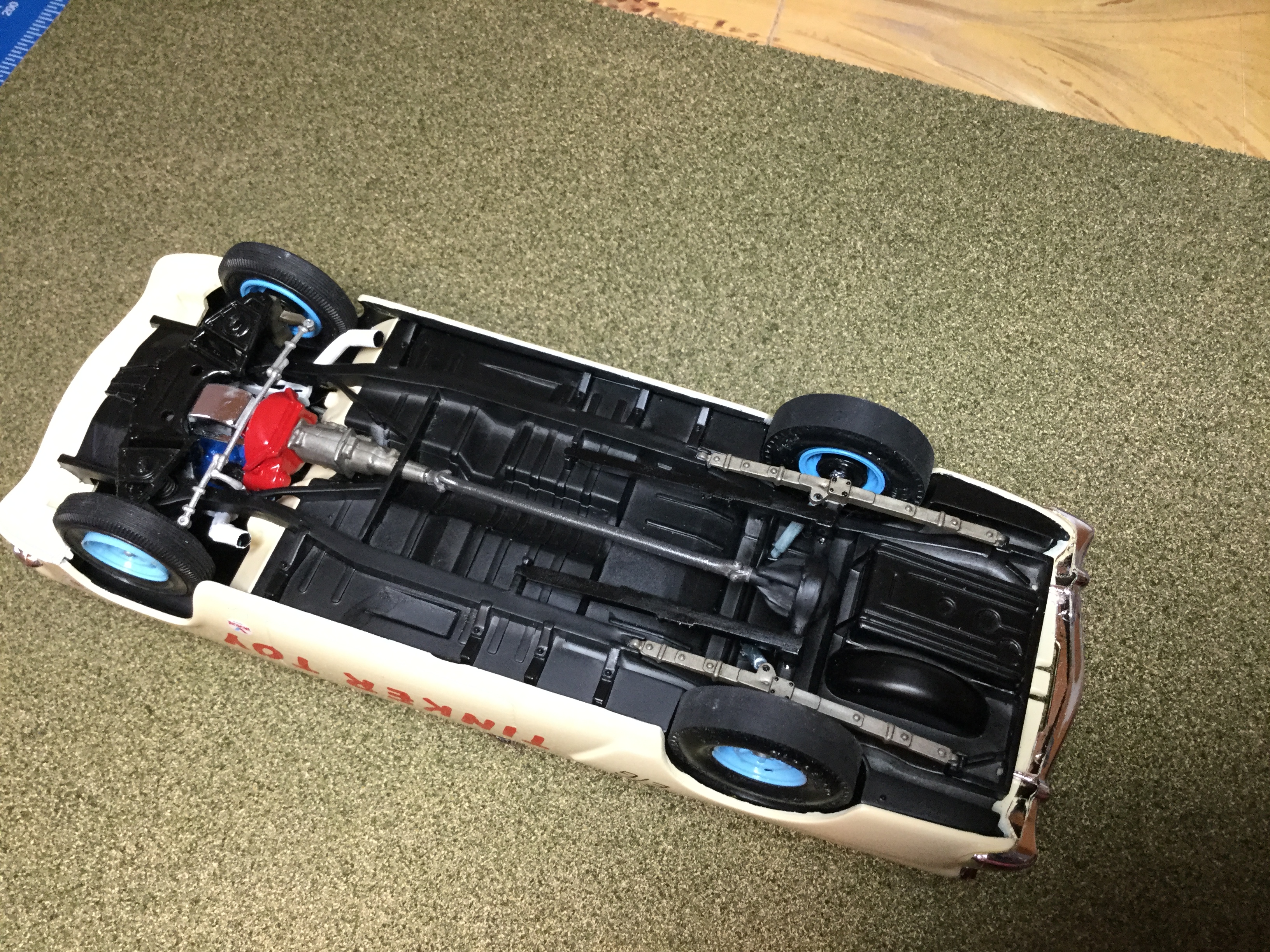

dragcarz Posted April 20, 2019 Posted April 20, 2019 I’ve grown to dislike this kit.....I started this build back in 2013, failed paint job, threw into the purple pond and it attacked the plastic. Wrinkled the plastic, I did lots of body work removing the wrinkles and the chrome trim channels in the body. I added a parts box hood scoop. I finally got it painted custom mix of Testors small bottle yellow and white, and added the Johan decals. I removed the back seat and added a parts box roll bar. The front seats are from the Revell 65 Malibu kit, a parts box steering wheel, shifter, and tachometer. The engine is a Revell Parts Pack Ford 427 and 4 speed transmission. Parts box wheels, slicks and traction bars finished out the bottom. Maybe it was me, but nothing wanted to fit. The back glass is a short shot not fitting the c pillar. This thing has been thrown back into the box more times than I can count. Yes I know the hood emblem is crooked, nothing a piece of tape can’t fix. I guess it captures what I started to accomplish, an early 1964ish home built budget race car. As always comments questions and criticism welcome.
GaryR Posted April 20, 2019 Posted April 20, 2019 Looks good to me! I have plans to build a gas class car outta this kit myself. It would be more like B/Gas though, with a 427. NOT trying to nitpick! I like it1
iBorg Posted April 21, 2019 Posted April 21, 2019 I think you got the spirit of two or three guys getting together a building a car in 1963 or '64. Its a nice build that apparently fought you along the way.
High octane Posted April 21, 2019 Posted April 21, 2019 I agree with Gary that it would probably run B/G and yes I like your build as I am a gasser fan from way back.
dragcarz Posted April 21, 2019 Author Posted April 21, 2019 Thanks for the comments everyone. I went back and forth on the class this thing would run in. Seemed like with stock suspension and just two four barrel carbs it would fall into a lower class. I wanted to do it as a D/G but I couldn’t find a D in my decal stash. The A and B Cars all seemed to have straight axles under the front end.
David G. Posted April 21, 2019 Posted April 21, 2019 It came out nice, well worth the effort. David G.
afx Posted April 21, 2019 Posted April 21, 2019 (edited) The class designations A, B, C etc. are based on power-to-weight ratios. Here's a link that explains it. http://www.gassermadness.us/Gas_Classes/index.htm Edited April 21, 2019 by afx
iBorg Posted April 22, 2019 Posted April 22, 2019 I'm pretty sure that's a 1953 Ford. Shipping weight was about 3100 pounds. With a 427, it would need to weigh over 5500 pounds to be a NHRA E/G car. As a B/G car, it would need to weigh 3843. I'm not sure when Modified Production started, but it sure looks like a M/P car to me. It's easy to get overly paranoid over the class designation. If you really want to throw the "experts" tell them its either built to AHRA or NASCAR (yes they did run drag cars in the 60's). Very few people are going to have a clue whether you're right or wrong. Adding an AHRA decal would seal the deal.
