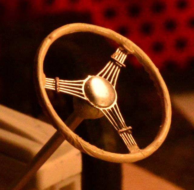

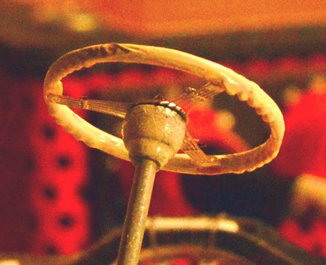

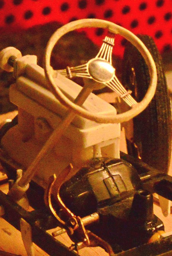

Straightliner59 Posted May 5, 2020 Author Share Posted May 5, 2020 (edited) I put together a banjo steering wheel. I turned the hub part that mounts to the column on the lathe. The horn button is just a disc, punched from tooling aluminum. There were photo-etched cross-braces with the wheel kit, but, to add a little color, I annealed and hammered some fine gauge brass wire. Thanks for looking! Edited May 5, 2020 by Straightliner59 Quote Link to comment Share on other sites More sharing options...

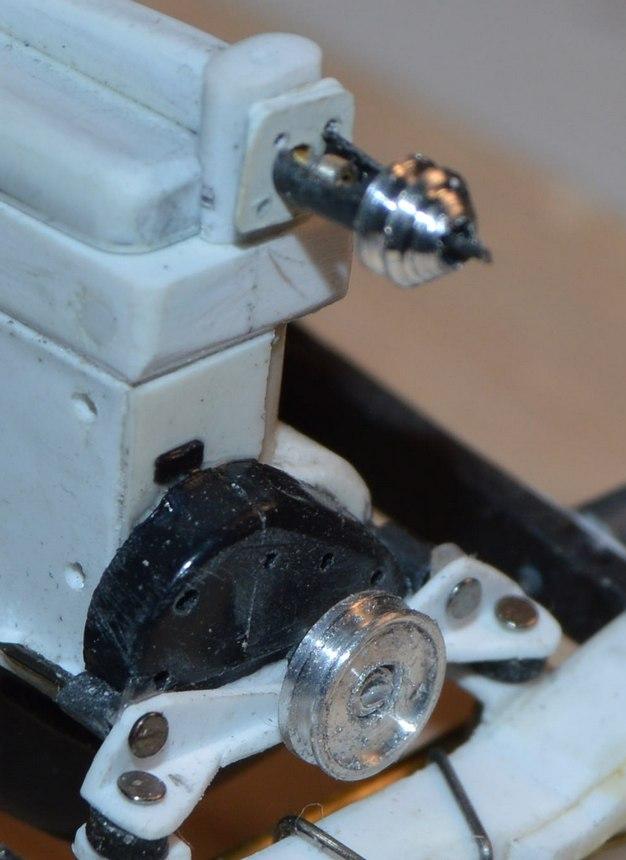

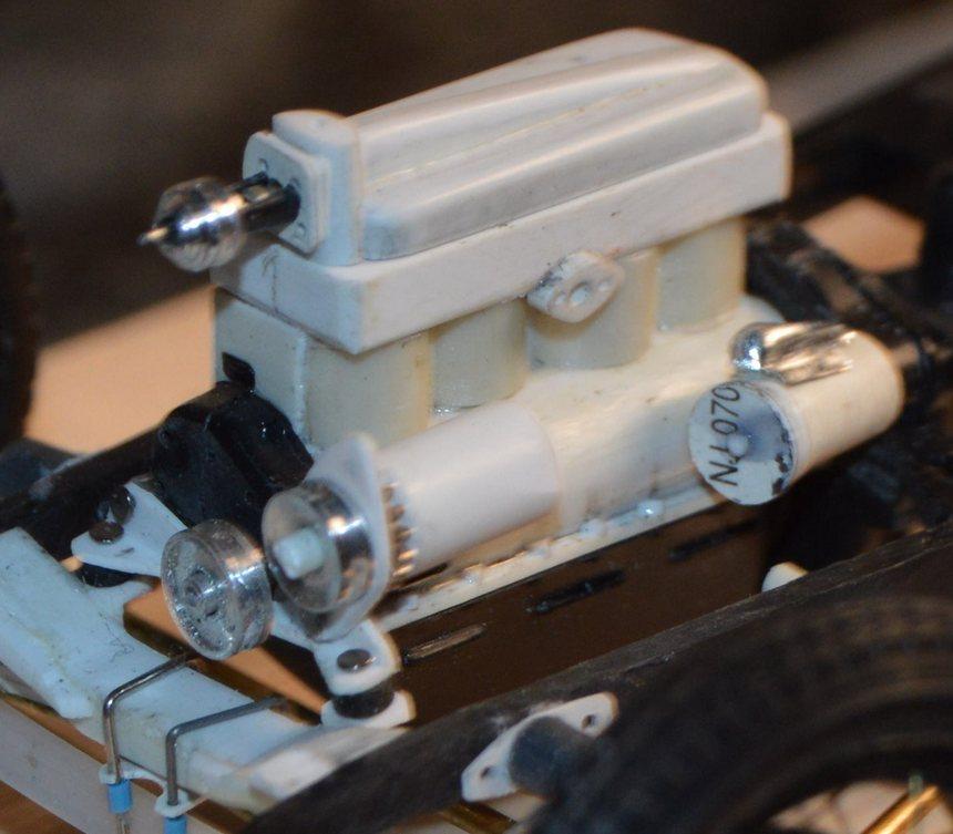

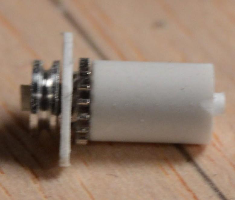

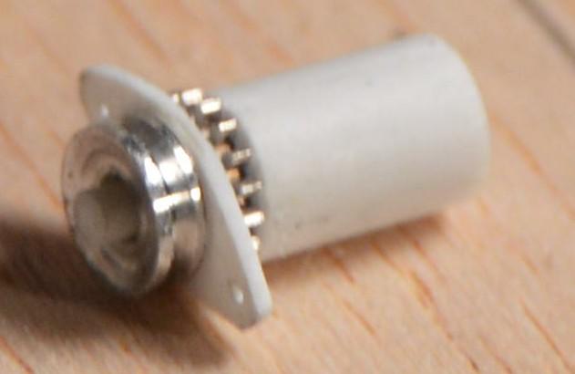

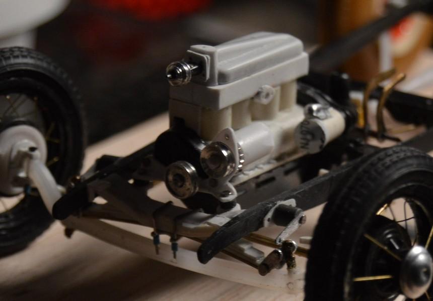

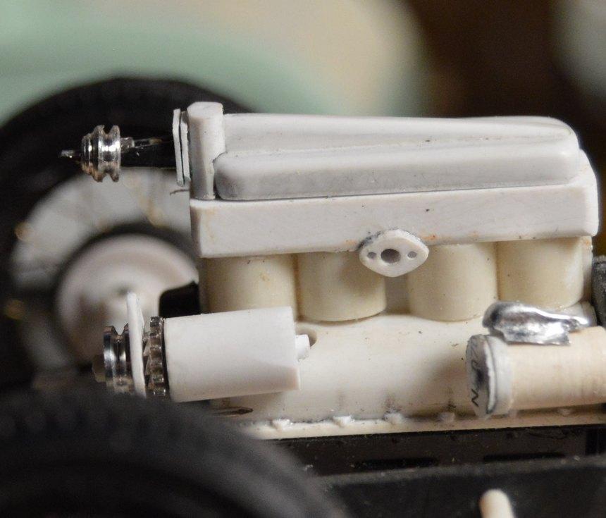

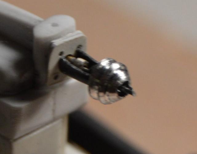

Straightliner59 Posted May 5, 2020 Author Share Posted May 5, 2020 12 hours ago, Modelbuilder Mark said: Outstanding! Thank you, Mark! I made new pulleys, today, along with getting the generator sorted out. It's assembled in the wrong order, here. Of course, the mounting bracket should be against the front of the case. Duh! I just threw it together, to get the photos, so none of it's attached. Quote Link to comment Share on other sites More sharing options...
AmericanMuscleFan Posted May 5, 2020 Share Posted May 5, 2020 Great job on the steering wheel Daniel, the addition of the brass is a nice touch and show again your attention to detail. Very nice generator, did you used a small gear between the flange and the case? If so, nice touch too! Skillful man you are sir!!! Quote Link to comment Share on other sites More sharing options...

Straightliner59 Posted May 6, 2020 Author Share Posted May 6, 2020 13 hours ago, AmericanMuscleFan said: Great job on the steering wheel Daniel, the addition of the brass is a nice touch and show again your attention to detail. Very nice generator, did you used a small gear between the flange and the case? If so, nice touch too! Skillful man you are sir!!! Thank you, Francis! I just thought the extra touch of color would be nice, on the wheel. I did, indeed, use a small gear. My late friend, Don Fahrni gave me a box of watch parts, a few months before he died. There are a lot of usable gears, etc., in it. Your kind words and comments are always very much appreciated! 12 hours ago, espo said: The attention to all the fine details is really interesting to follow, and they look great. Thanks, David! I truly enjoy that aspect of the hobby. I like to have, and to give people, lots of stuff to look at! Quote Link to comment Share on other sites More sharing options...

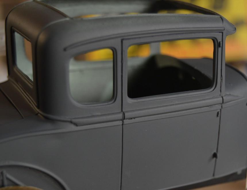

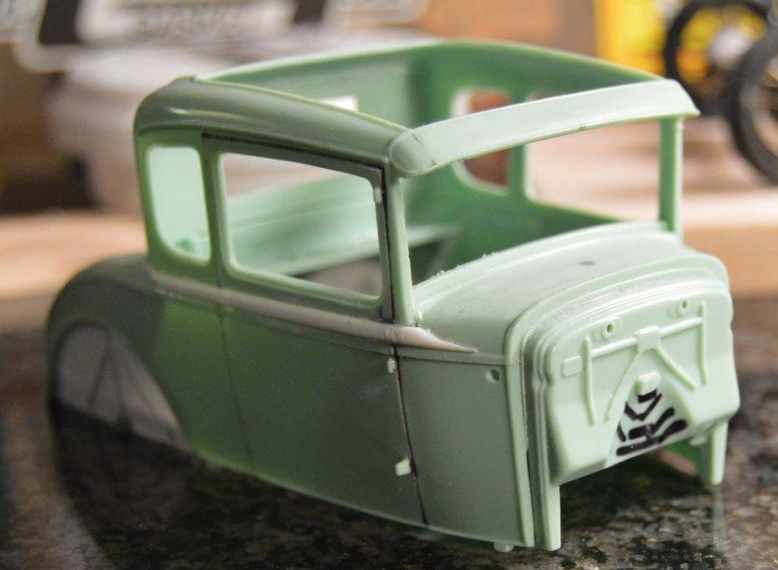

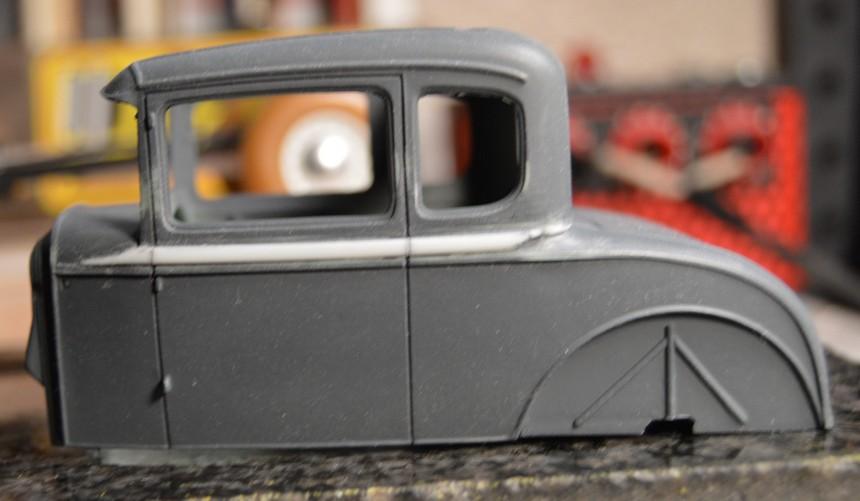

Straightliner59 Posted May 10, 2020 Author Share Posted May 10, 2020 I've started work on the welting that Monogram oddly left off the body. A fair amount of sanding and filling to do, but, I think it's a good start. I'm debating whether I want to open the doors, or not. I'm not sure if I am trying to talk myself into it, or out of it! As always, questions, comments and critiques are welcome. Thank for looking! Quote Link to comment Share on other sites More sharing options...
AmericanMuscleFan Posted May 10, 2020 Share Posted May 10, 2020 Good job on the body work Daniel! I see that you added half round styrene strips in the wheel openings to simulate the embossing, nice touch! I think it's a good candidate to cut the doors open but you know what it is with all the extra work... The hinges are outside the body and could be fun to make. From what I've seen so far on this build I don't think it's a brake for you! I don't want to play the tempting demons!!! Quote Link to comment Share on other sites More sharing options...
Straightliner59 Posted May 10, 2020 Author Share Posted May 10, 2020 1 hour ago, AmericanMuscleFan said: I don't want to play the tempting demons!!! Yeah, I don't need any help, there! I added the rolled ribs pretty early on. It definitely looks naked, without them! I'll likely talking myself out of opening the doors, right up 'til the second I cut 'em out! Quote Link to comment Share on other sites More sharing options...

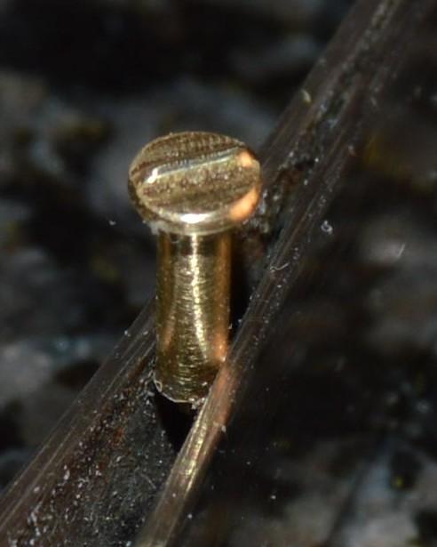

Straightliner59 Posted May 10, 2020 Author Share Posted May 10, 2020 I'm leaning closer toward opening the doors. I've not completed a model, before, that I opened the doors. This one should be relatively simple, to do. Inspired by Francis and Tim, I took a very baby step, and made a filler cap for the fuel tank. The tank will be relocated to the trunk/rumble seat area. I ran across a really neat way a guy did his, that uses a small electric pump, mounted to the frame. The lines are run through the glass bowl, and everything. Apparently, a pump is desired, when running two carbs. Anyway, making the brass cap (inspired by those on many of the trucks I've driven, through the years) went without a hitch! You can see, in a couple of the images, pencil marks on the body, indicating possible locations for the filler to be located. I am open to suggestions--please? ? I think it will be simple projects like this filler cap that will give me some confidence, and a greater comfort level, with my mill. That will likely lead to more ambitious efforts! Now, about those doors... Quote Link to comment Share on other sites More sharing options...
AmericanMuscleFan Posted May 10, 2020 Share Posted May 10, 2020 25 minutes ago, Straightliner59 said: I think it will be simple projects like this filler cap that will give me some confidence, and a greater comfort level, with my mill. That will likely lead to more ambitious efforts! Now, about those doors... You're absolutely right Daniel, we must walk before we can run! You made a very good job with the filler cap. Speaking about the location for this one, I would place it on the fender... I'm kind of a traditional person and I think it would be a logical position. Would be cool with the doors opened... lol. Just kidding, it's already a very cool build!!! Quote Link to comment Share on other sites More sharing options...
Straightliner59 Posted May 10, 2020 Author Share Posted May 10, 2020 42 minutes ago, AmericanMuscleFan said: You're absolutely right Daniel, we must walk before we can run! You made a very good job with the filler cap. Speaking about the location for this one, I would place it on the fender... I'm kind of a traditional person and I think it would be a logical position. Would be cool with the doors opened... lol. Just kidding, it's already a very cool build! Thank you, sir! I think the fender would look best, too. As I said, earlier, I am kind of leaning toward opening them, just to try something new! It's more fun, that way! I shot some primer on it, to get an idea of where I am. Not bad, for a rough draft, I think. Quote Link to comment Share on other sites More sharing options...

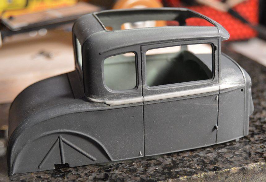

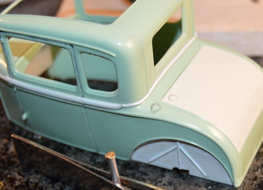

Straightliner59 Posted May 11, 2020 Author Share Posted May 11, 2020 Did a bit of sanding on the character line. I've never been much for body work! The spear point on the cowl is especially tricky to get to... Quote Link to comment Share on other sites More sharing options...
