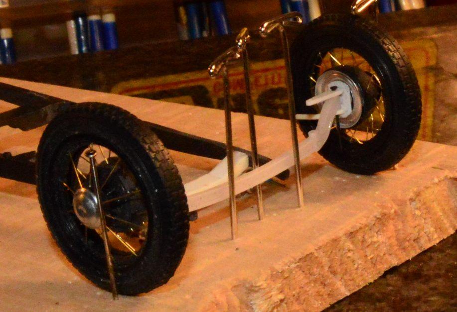

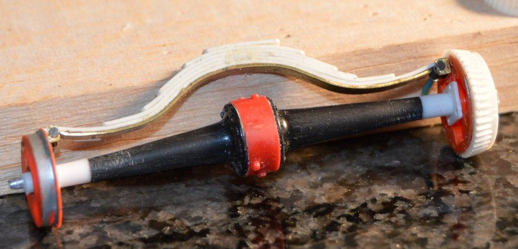

Straightliner59 Posted November 1, 2019 Author Share Posted November 1, 2019 I had to move the rear crossmember up. The car was just going to sit too high, if I hadn't. I have the rear suspension mostly worked out. Quote Link to comment Share on other sites More sharing options...
Ace-Garageguy Posted November 1, 2019 Share Posted November 1, 2019 Lotsa good stuff going on here... Quote Link to comment Share on other sites More sharing options...
Mr. Metallic Posted November 1, 2019 Share Posted November 1, 2019 I may have missed the explanation, but why did you make the choice to link the spring to the brake backing plates? I don't think I've seen it done that way before as opposed to the typical link to the axle. Not saying it's wrong, but curious why you did it that way. I'm always looking to learn. Quote Link to comment Share on other sites More sharing options...
Straightliner59 Posted November 1, 2019 Author Share Posted November 1, 2019 7 hours ago, Mr. Metallic said: I may have missed the explanation, but why did you make the choice to link the spring to the brake backing plates? I don't think I've seen it done that way before as opposed to the typical link to the axle. Not saying it's wrong, but curious why you did it that way. I'm always looking to learn. I did it that way, because, when I built "The Bug", that's how it was done, so, I did it out of familiarity. When I was looking for photos, it became apparent that guys mounted them in whatever way worked for them. It's not too late to change it, if it sits too high! Quote Link to comment Share on other sites More sharing options...

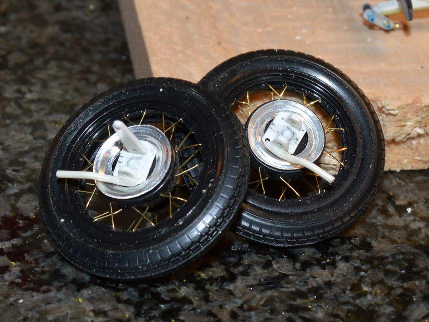

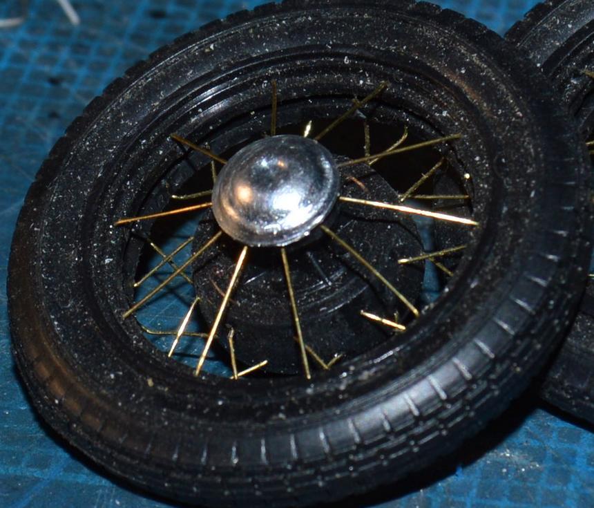

Straightliner59 Posted November 3, 2019 Author Share Posted November 3, 2019 A very small update: I made these front wheel/hub covers by using various diameters of tubing to form sift aluminum sheet (tooling aluminum) over a kit wheel. I then used a hole punch to remove it from the sheet. I will clean up the edges, a bit, but, I think that worked out, pretty well! Quote Link to comment Share on other sites More sharing options...
oldnslow Posted November 4, 2019 Share Posted November 4, 2019 Do you have a tutorial on lacing the front wheels ? Quote Link to comment Share on other sites More sharing options...
Straightliner59 Posted November 4, 2019 Author Share Posted November 4, 2019 1 hour ago, oldnslow said: Do you have a tutorial on lacing the front wheels ? I don't. All I did was cut out a spoke at a time, and replace it with .008" brass wire (rod). That kept everything aligned! It was pretty easy, it just took some time. Quote Link to comment Share on other sites More sharing options...

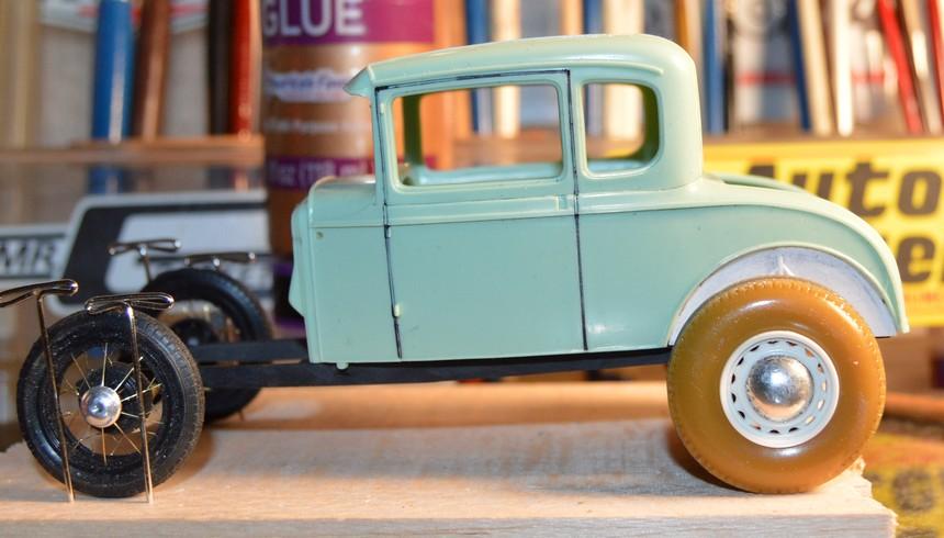

Straightliner59 Posted November 4, 2019 Author Share Posted November 4, 2019 1 hour ago, afx said: Wheels look great Daniel. Thanks, JC. Much appreciated! I got the stance finalized. The rear wheels aren't attached to the axles, yet. The one in these photos has rolled forward. It will be in the proper location, once everything is in place. Quote Link to comment Share on other sites More sharing options...

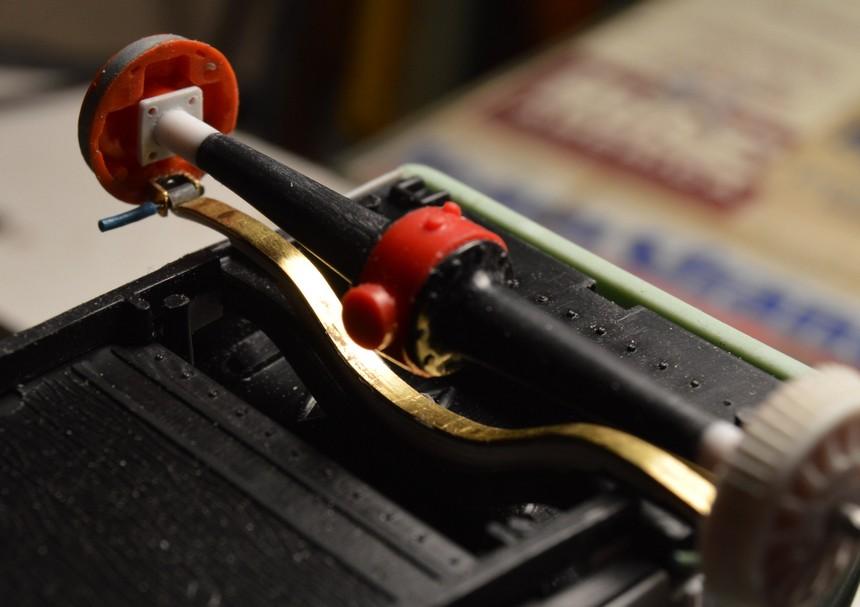

Straightliner59 Posted November 8, 2019 Author Share Posted November 8, 2019 This is how the rear suspension ended up. The spring is now mounted to the axle, rather than the backing plate. Now, I can move on to the front spring/axle. Quote Link to comment Share on other sites More sharing options...

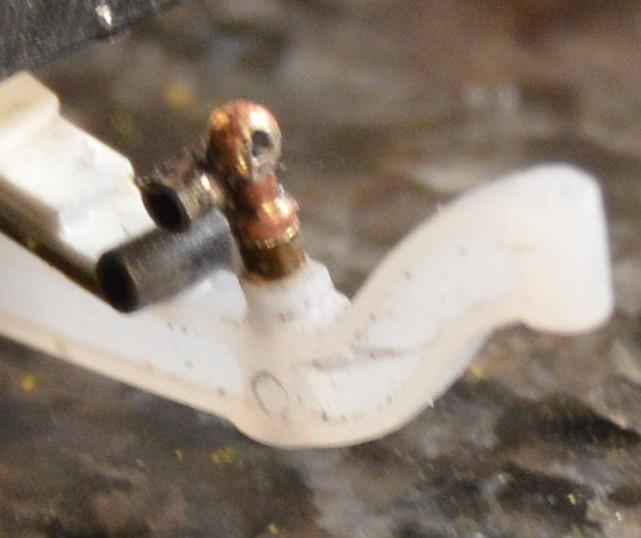

Straightliner59 Posted November 10, 2019 Author Share Posted November 10, 2019 Some of the assemblies are getting close to completion of the "figgerin' out" phase. I made the front spring perches from three pieces of brass, each. I used an HO handrail stanchion for the main structure. The eye for the shackles is 3/64" brass tube, cut 3/32" long. That tube was then soldered to the handrail stanchion. Finally, I cut a 1/32" length of the 3/64" tube, to slide over the peg end of the stanchion, to give the assembly some elevation. The ball end of the stanchion will mount the shock arm. In this group of photos, everything is white glued to the chassis. One of my goals for this project, is to attempt to assemble the entire thing, be it pinned or white glued, before It's disassembled and painted. I have never really focused on that aim, but, I have had to accept many flaws, over the years, because I got too far ahead of myself. Quote Link to comment Share on other sites More sharing options...

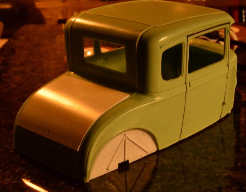

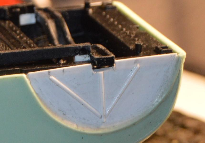

Straightliner59 Posted November 10, 2019 Author Share Posted November 10, 2019 Early this morning, I was digging parts from the kit box, and discovered that the lid for the rumble seat is missing. I thought about trying to find a parts kit I could pick up, for a reasonable price. Looking at the open space in the body, I decided it wouldn't be too difficult to make one. I got out a section of .030" sheet and began working it to shape, sanding it to size. I began by "cold curling" the sheet. Once I'd gotten it as close to shape as it would go, sans heat, I turned the blow dryer on low heat, and applied that, for as long as I comfortably could, while pulling the curves tighter. After repeating that a couple of times, I had a panel that's usable. Since I'm not going to have an opening trunk/rumble seat, I can cement it into its final position. I ended up giving the panel one more heat treatment, after these photos were taken. It fits better, now. Quote Link to comment Share on other sites More sharing options...
gman Posted November 10, 2019 Share Posted November 10, 2019 Your new lid will probably fit much better than the kit-supplied one. Out of the box, there are large gaps and fit isn't 100% optimum anyhow. An acceptable fit with the kit's trunk/rumble seat lid requires building up the sides with styrene to close those gaps for a proper scale appearance. Quote Link to comment Share on other sites More sharing options...
Straightliner59 Posted November 10, 2019 Author Share Posted November 10, 2019 1 hour ago, gman said: Your new lid will probably fit much better than the kit-supplied one. Out of the box, there are large gaps and fit isn't 100% optimum anyhow. An acceptable fit with the kit's trunk/rumble seat lid requires building up the sides with styrene to close those gaps for a proper scale appearance. Thanks, Greg! It fits tightly, now, for sure. All I need to do is ease the edges, and cement it into place. Quote Link to comment Share on other sites More sharing options...
Straightliner59 Posted November 11, 2019 Author Share Posted November 11, 2019 Front axle is mounted... Quote Link to comment Share on other sites More sharing options...
Straightliner59 Posted November 15, 2019 Author Share Posted November 15, 2019 I've got a few more things done. I got the trunk lid cemented into place. The spindles are built. If I can get the front axle remounted before I go to bed, I can get it on the wheels! Always a big step! As always, questionsm comments and critiques are welcome. Quote Link to comment Share on other sites More sharing options...
