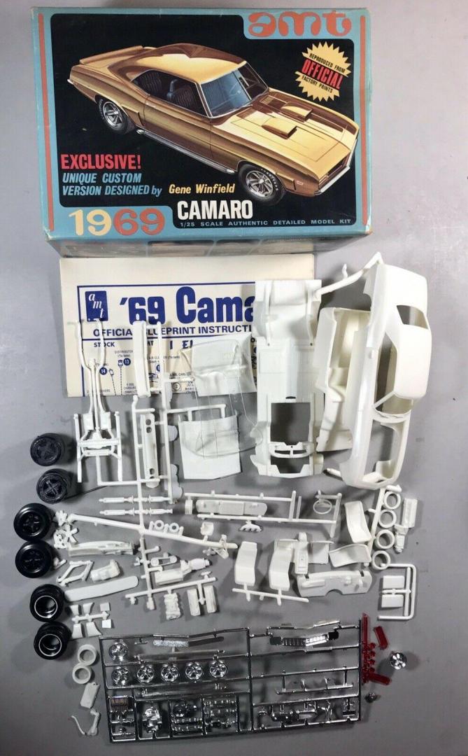

Here's a look at the original Y-913 issue, using pics I found on the 'net...
That distinct '69 AMT box art, featuring the custom version designed by Gene Winfield, wearing Foresight Ventures Flag "mag" wheels, dual hood scoops, rear quarter panel scoops, and rear spoiler:

A somewhat messy look at the included parts is below. Note two hoods are included-- both SS and Sport Coupe (standard) hoods:
Was the Y-913 '69 Camaro kit only issued once?

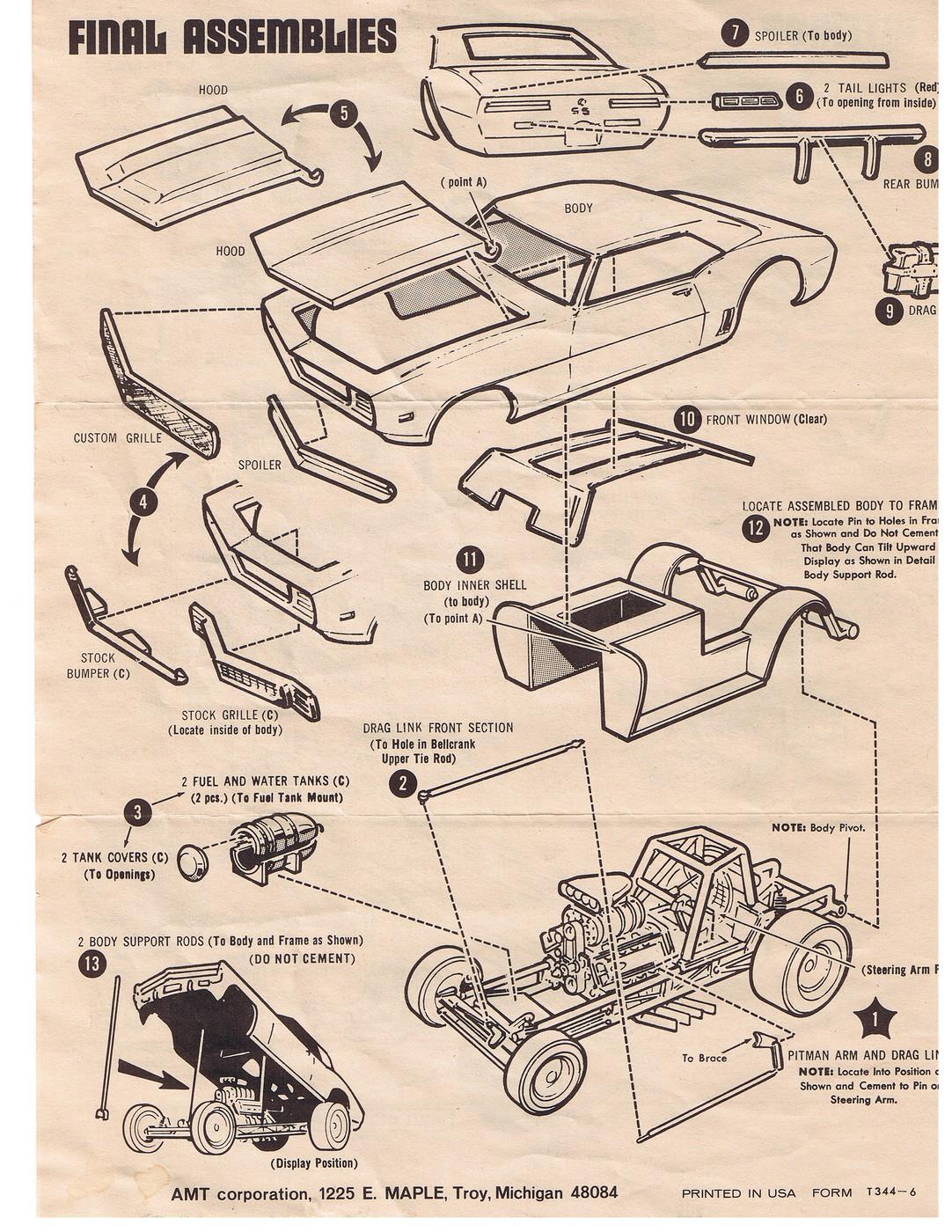

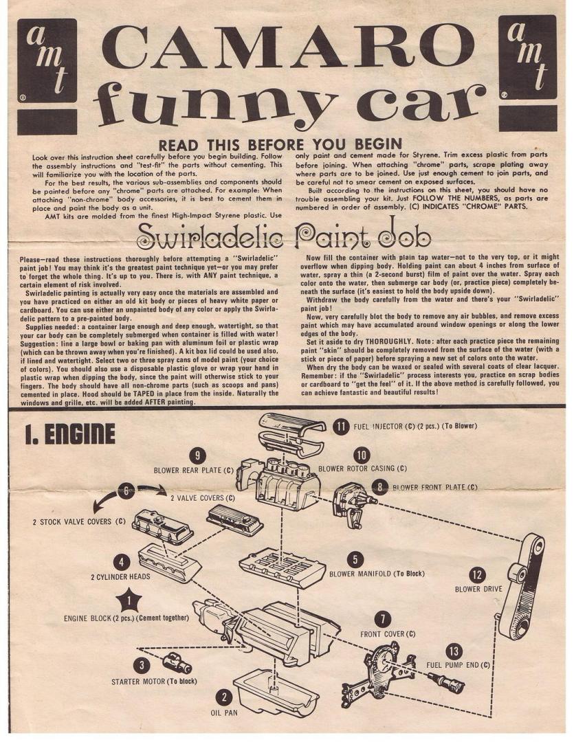

The AMT T-344 Funny Hugger kit was released next (can anyone verify a release date?), utilizing the body shell, both hoods, grille, bumpers, and the modified "glass" (and likely more) from the Y-913 kit:
Below, one of the box's long side show a drawing of the body shell being lifted above the F/C chassis, but the rear wheel openings remain stock-- is this accurate? Did the T-344 Funny Hugger kit's body retain stock rear wheel openings? I can't find a clear pic to determine either way, but the instruction sheet (courtesy of the Drastic Plastic site) shows enlarged, rounded rear wheel openings:

Which other parts were carried over from the Y-913 kit to the T-344? Are the supercharger, matching intake manifold, two-piece injector scoop, and blower belt/pulleys/tensioner carried over? Is this where the big block Chevy engine from the Y-913 kit ended up? From the T-344 instruction sheet:
I can't find any clear, large images of the T-344 Funny Hugger kit, so if anybody has some, please add them.

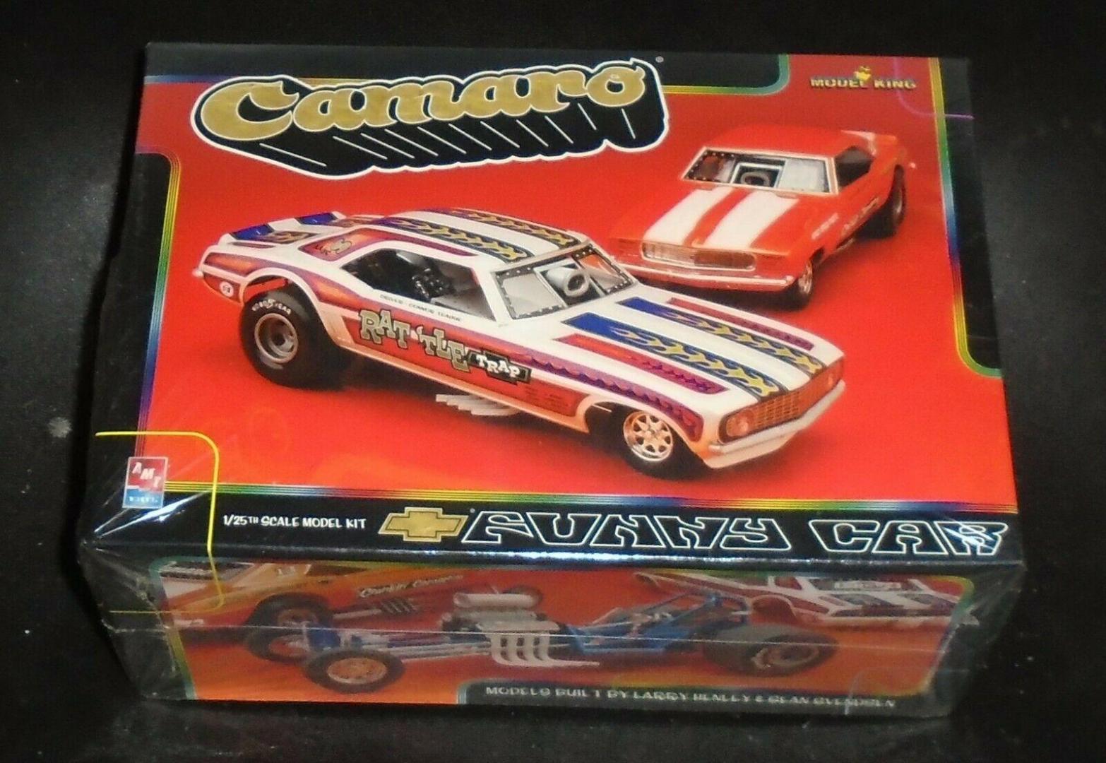

Finally, the Funny Hugger II was reissued in 1997 by Model King, and included two very full decal sheets:
Below is one group of chrome parts from the Model King reissue, and the original stock cross-ram style intake manifold appears to be present:
Below is the body shell from the Model King kit, showing the enlarged rounded rear wheel openings mentioned earlier:

Both funny cars have the enlarged rear wheel openings.  They're way bigger than needed for the first version.
The Funny Hugger II body also has the front wheel openings relocated forward from the stock position, due to the longer chassis which was also used in three other kits.  That change likely killed off any possibility of the '69 ever being reissued in stock form.
The "unblocked" plated tree in the Model King issue also includes the front motor mount from the first Funny Hugger kit.
