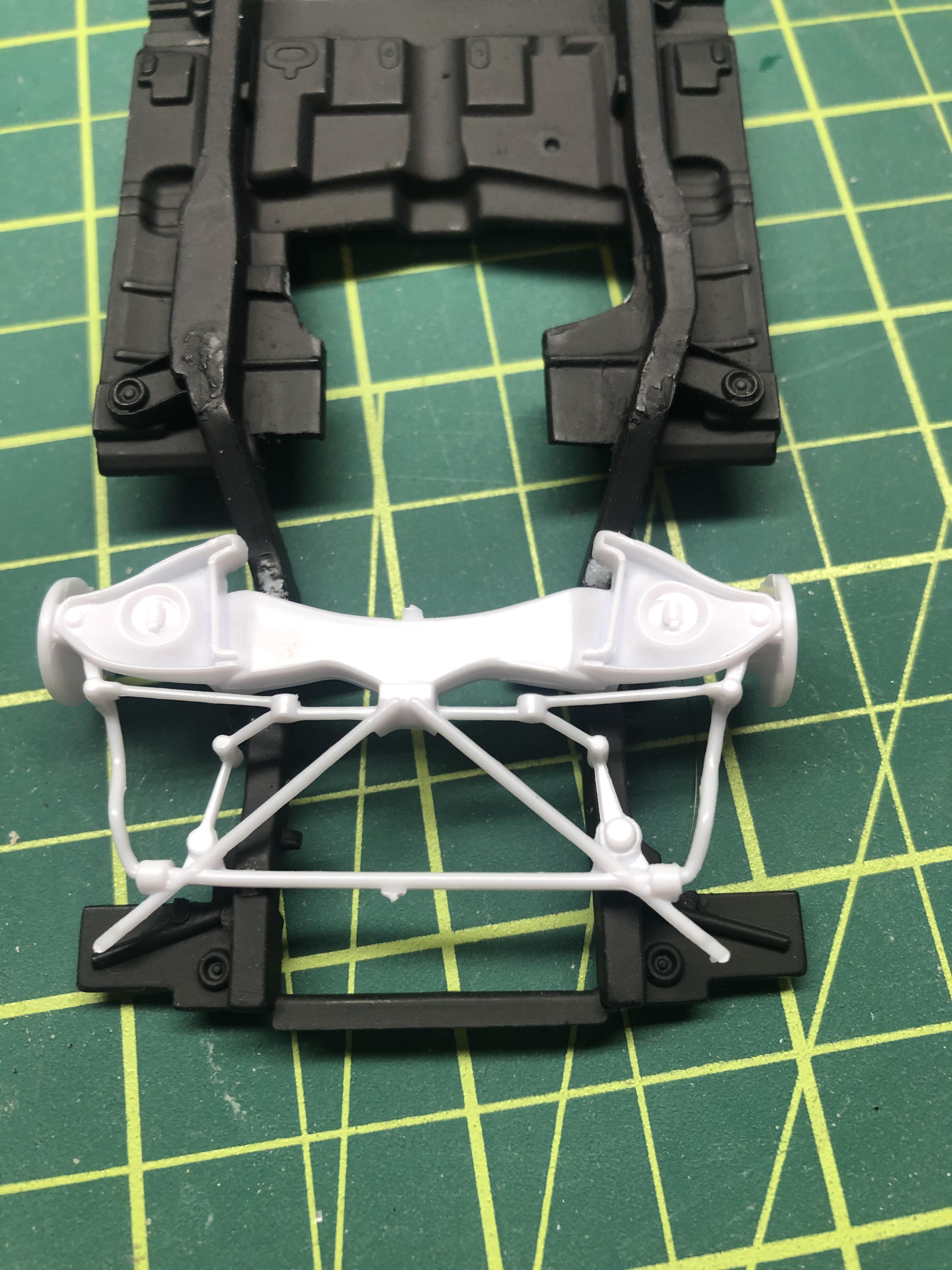

WGaree Posted December 5, 2020 Share Posted December 5, 2020 12 hours ago, Jordan White said: Scale-wise, it would need to be the Oldsmobile since the rest of the G-Body kits are 1/24 while the S10 is 1/25 (assuming they are true to scale). the unit out of the GN/GNX fits almost perfectly only the swaybar brackets don’t meet the frame everything else lines up to the frame and track width with the kit supplied (the incorrect 4wd) wheels looks good don’t have an oldsmobile kit to yank the suspension unit out of it, assuming scale accuracy of the olds, would be just slightly too narrow, it’s piece may work better with a 2wd appropriate wheel as a result Quote Link to comment Share on other sites More sharing options...

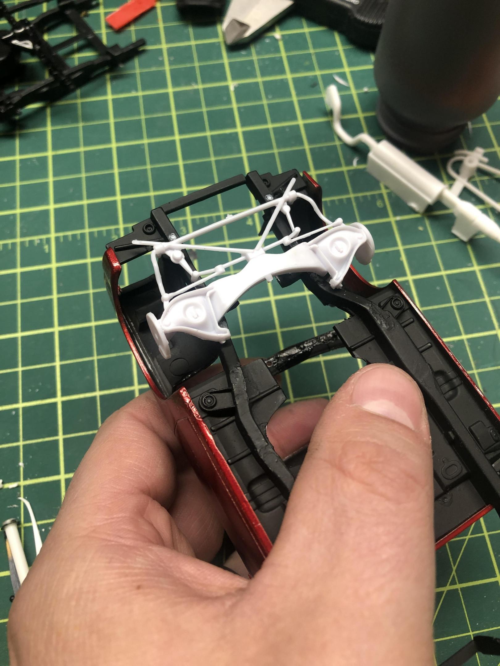

Jordan White Posted December 8, 2020 Share Posted December 8, 2020 Surprisingly, it may be tough to adapt the Olds front end to the S10 chassis. The suspension mounts end up a bit wider than the frame, there aren’t any buckets for the “coil springs”, and it pushes the wheel hubs fairly close to the edge of the wheel well. Quote Link to comment Share on other sites More sharing options...
WGaree Posted December 9, 2020 Share Posted December 9, 2020 that fits almost exactly like the supposedly larger GN/GNX unit only the control arms don’t fit up to the rails as nicely, they look more size correct not as elongated as the GN unit, the “spring” lumps and the hub width are about the same and the detail is much better. Quote Link to comment Share on other sites More sharing options...

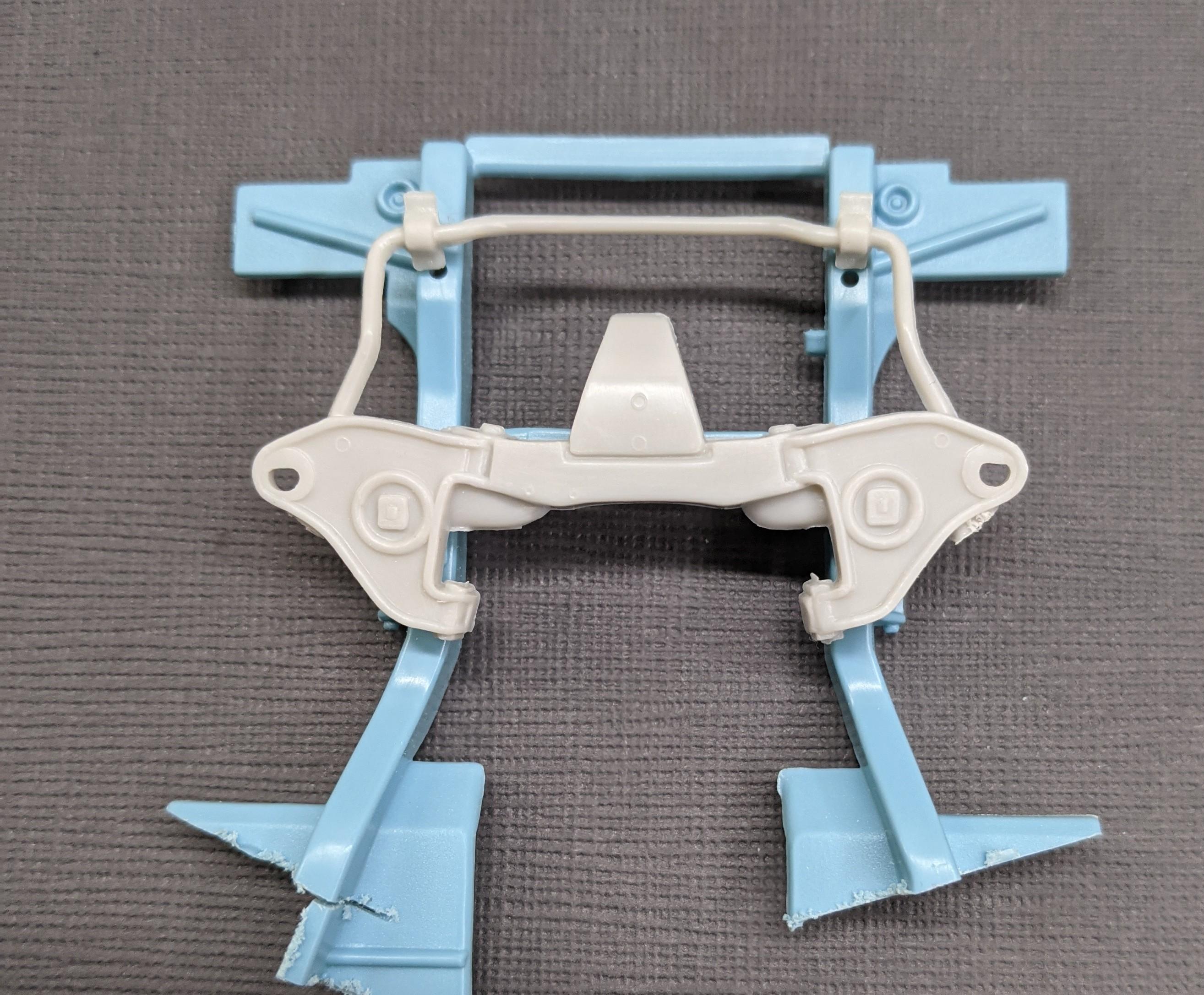

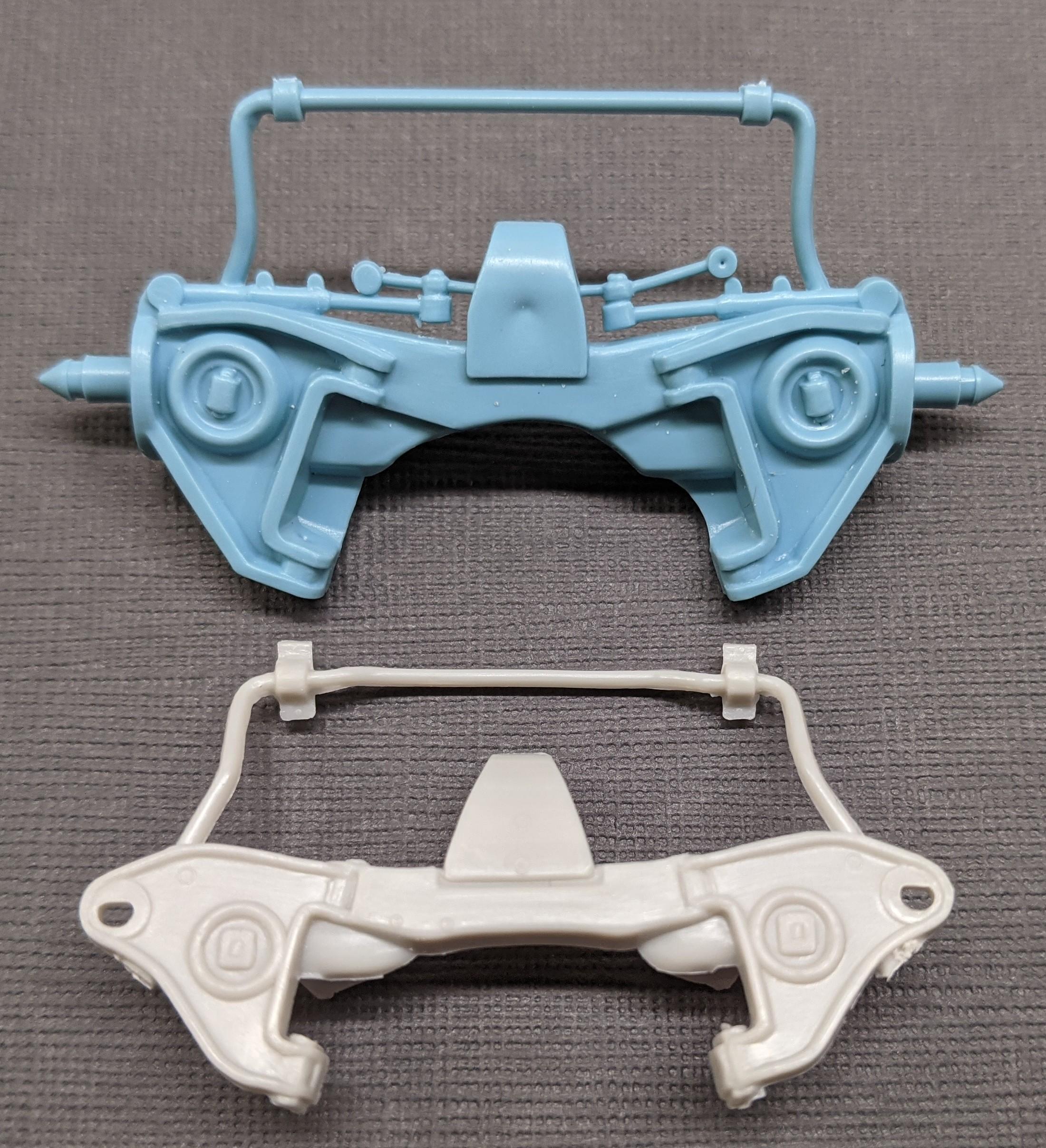

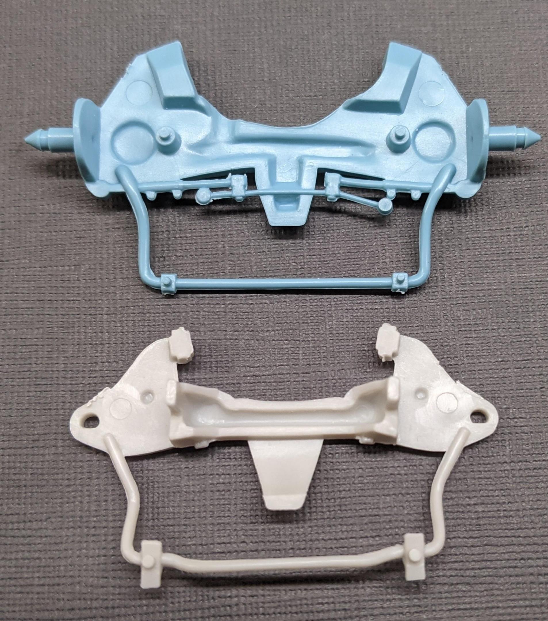

Casey Posted December 9, 2020 Share Posted December 9, 2020 54 minutes ago, WGaree said: that fits almost exactly like the supposedly larger GN/GNX unit only the control arms don’t fit up to the rails as nicely, they look more size correct not as elongated as the GN unit, the “spring” lumps and the hub width are about the same and the detail is much better. Despite the scale difference, the '84 Olds appeared to still be heavily based upon the earlier 1/24 Monogram GN/Monte Carlo kit design. The Monogram S-10 kit's 2WD upper control arms are well, poor, to be kind, so I was hoping the 1/25 Olds Cutlass parts'd be an upgrade there, at least. Below are several shots of the original Monogram S-10 issue (kit #2434, in aqua colored plastic) compared to the same parts from the 1/25 AMT '95 Chevy S-10 SS/LS kit, molded in gray. The AMT crossmember has some vertical pieces as part of the crossmember which don't quite fit inside the Monogram kit's frame rails, but they can be flexed, or thinned if one so desired. I think the Monogram LCAs look much crisper and better defined, though, despite being molded as one with the crossmember. Quote Link to comment Share on other sites More sharing options...

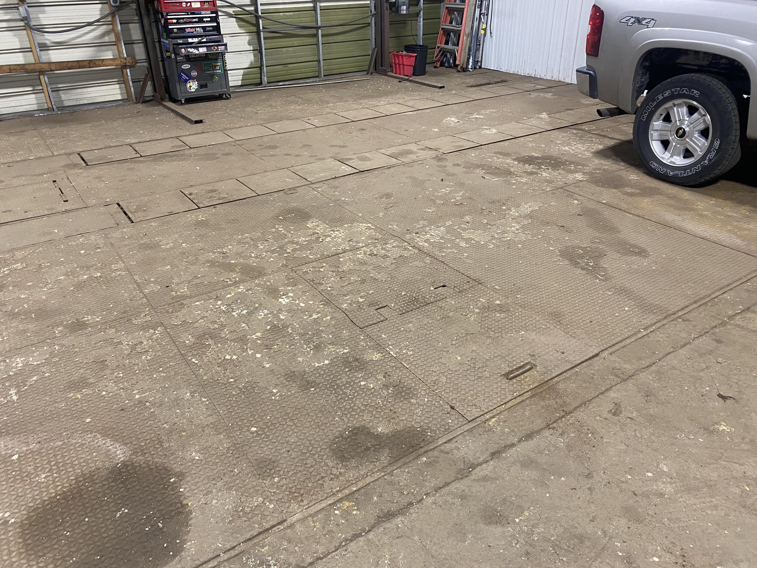

Casey Posted December 9, 2020 Share Posted December 9, 2020 We've got options. ? The GM Photostore just posted this on their facebook page. Good tail light bezel/trim detailing reference at least: 1 Quote Link to comment Share on other sites More sharing options...
mikemodeler Posted December 9, 2020 Share Posted December 9, 2020 Looks like there are a couple of solutions for this dilemma- 1. Find the original kit and use the stock front end from it. 2. Hope someone can cast a copy of the original or make a 3D print of it. 3. Get the AMT 96 S-10 or Sonoma kit and use the chassis from it. Quote Link to comment Share on other sites More sharing options...
Dale Gribble Posted December 11, 2020 Share Posted December 11, 2020 On 12/9/2020 at 11:40 AM, Casey said: We've got options. ? The GM Photostore just posted this on their facebook page. Good tail light bezel/trim detailing reference at least: That’s an amazing pic! I have a shop in an old GM plant , and my floor has this spot where the line changes from overhead to floor. So neat to see what it used to be !! 1 Quote Link to comment Share on other sites More sharing options...
