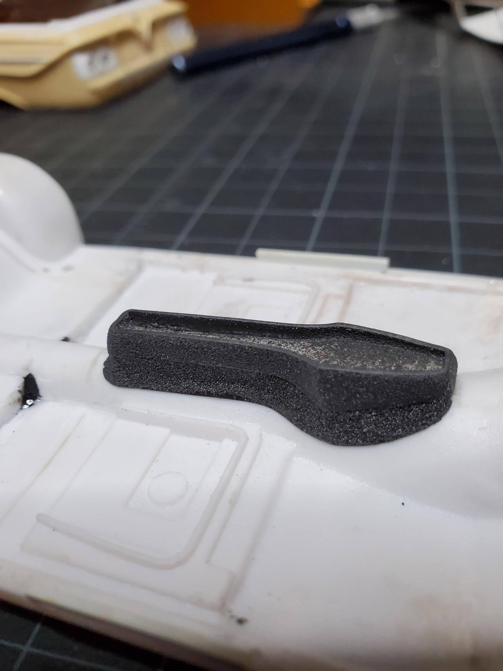

So I've been trying the embossing powder for the first time after getting back in to the hobby. It works really well!
I've been using the 'wet paint' method and so far have had good results, albeit I've only done a few parts to my Barracuda build. Since gloss colors tend to dry the slowest, that's all I've used, but even at that there's a short window to get the surface covered and not have dry spots.
The parts I've done are for a '66 Barracuda. The console has a lot of carpet attached to the bottom that drapes over the trans tunnel. I made that area out of .010 sheet and used a fine embossing powder. I have one that's a little more course, but it gave too high a build for the application. I think for parts like this console, or the carpeted bottom of door panels, or any other carpeted area that's not the floor, I'll be using the finer powder. For the floor, I'll try the courser stuff.
I've also been experimenting with other powders for other textures. For the top, plastic part of the console, I used all purpose flour. I tried that, as well as baking powder and corn starch. The flour had the best texture. A lot of 60's Mopars have a more 'pebbley' grain on all the surfaces so it looks really good. For other types of grained surfaces, it may not look as good or to scale.
