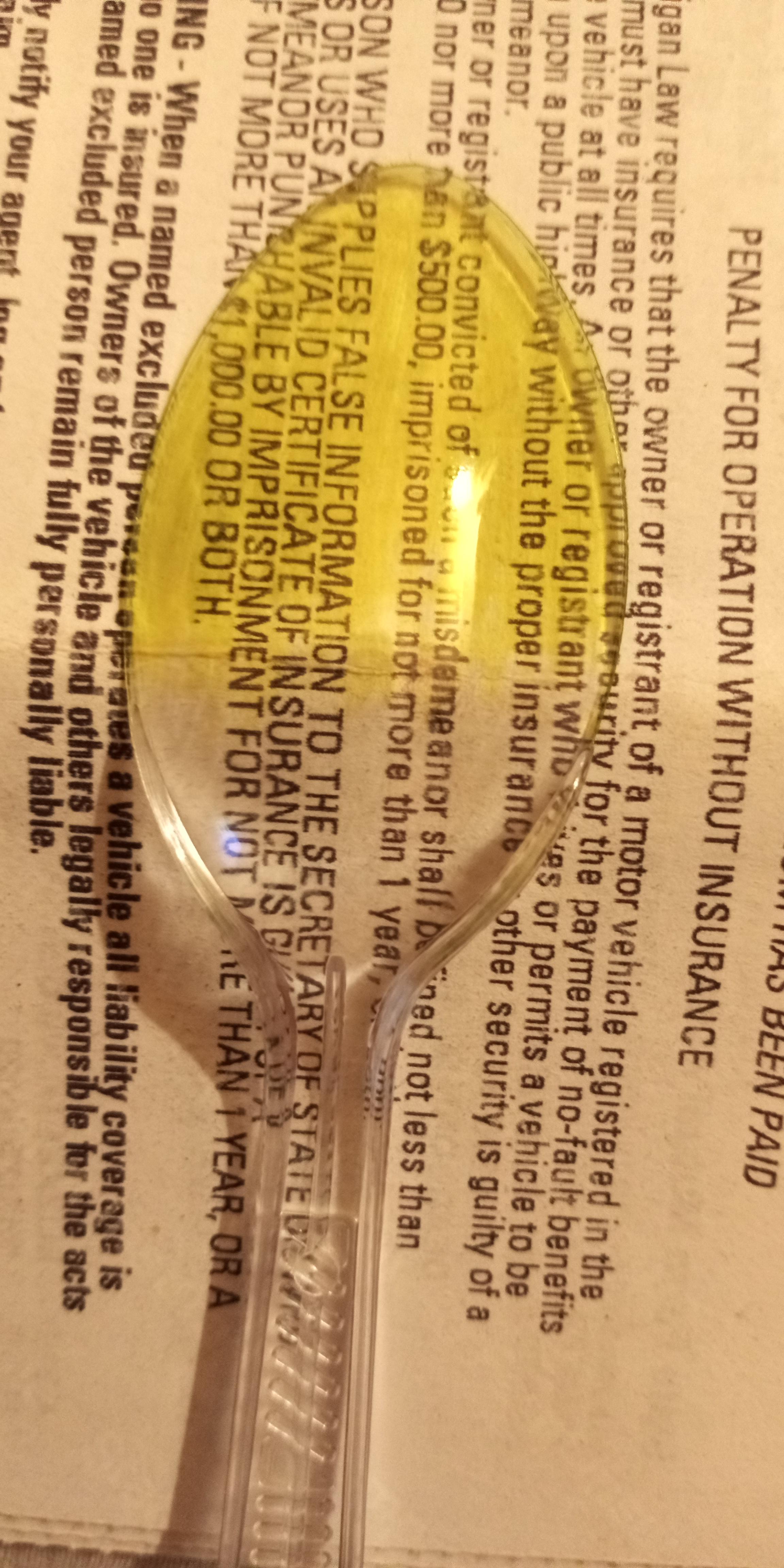

This was just done with a yellow Sharpie and a really cheap clear plastic spoon without the Future barrier clear coat..... Looks pretty good!... ??
