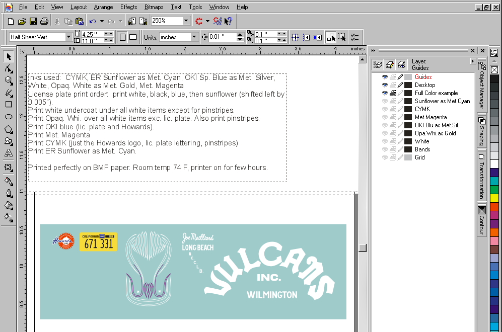

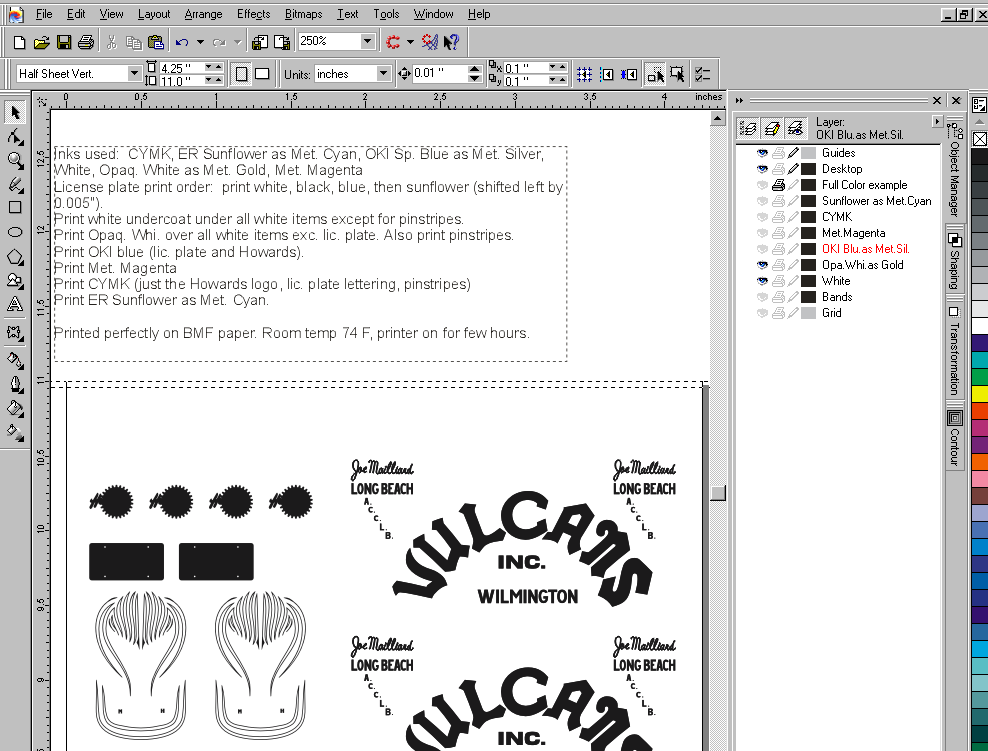

peteski Posted December 11, 2020 Posted December 11, 2020 (edited) 1 hour ago, Bugatti Fan said: This has been a very interesting thread to read. I have not tried printing my own transfers yet, but something I learnt from this is to print on white decal sheet would be better than on transparent. I have a modest hp inkjet printer so hopefully when I get to try this my end results may be passable. I would guess that one would need to maximise the number of designs on a sheet at the drawing stage otherwise a lot of expensive decal sheet could be wasted. Unless the model is big, one decal sheet would have to be utilised to best advantage for multiple projects. One of the other things that came over is not to get stressed out. It is just a hobby after all, and by dint of its nature, experimentation and learning by mistakes and gaining experience are all par for the course. Noel, Blank decal paper is not *THAT* expensive. Cheaper than a small bottle of hobby paint. Still, my trick to double my use is to split each letter-size (8.5" x 11") sheet in half vertically. I end up with two 4.25" x 11" sheets. I just design my artwork to fit on that width paper. Then I have another paper-saving trick. I often print very small images and only one or two. I place them right at the very top printable edge of the artwork page, print, then cut the decal off from the top of the page. I end up with vertically-partial half-sheet. I then use that partial sheet repeatedly for future small jobs. Sometimes I can get 5 or 6 separate decal projects from one half sheet without having to print them all at the same time. I still keep the 11" length of paper size in my artwork (just have the objects to be printed on top). The program or the printer do not care the the sheet is shorter than expected. It still gets ejected properly. Of course this only works if the artwork does not require full size width. But even then, if the length of the artwork is not full 11", I can trim the printed images of the top of the sheet and use the remaining blank piece for next project that doesn't require full sheet. Of course the printer does have minimum length pf paper that it can deal with, so if I get to that point I have to throw away the small remaining piece of paper. But overall I squeeze as much as possible out of my decal paper. As far as using white vs. clear film paper then yes, unless the decal will be applied to a white-color model, it needs to be printed on white. If printed on clear and applied to a non-white surface, the color of the surface will tint the colors of the decal. It is standard subtractive color method. If the decal is transparent yellow and applied to a blue model, the result will be green decal image. I know of at last one decal manufacturer who actually uses that to their advantage. Here is an example https://k4decals.com/collections/reefer-decals/products/mistletoe-hams-36-ft-billboard-reefer-decal-mistle . Specifically look at and ready the instruction scan. It explains things. Edited December 11, 2020 by peteski

peteski Posted December 11, 2020 Posted December 11, 2020 I think I'll end my comments here with a statement that an average Joe cannot magically get their custom decals made. What is needed are learned skills and understanding of the process. Like it or not David, you need to acquire knowledge of the process and lingo. Listen, when started building models you didn't know about all the various paints, adhesives and techniques which are involved in model building. You had to learn and acquire them. You also need to understand that the same goes for designing and printing custom decals Educate your self about the process and the lingo. I suggest that you should stop looking for shortcuts, and gain the knowledge and experience which will allow you to be successful at designing custom decals for your hobby. You mention designing some artwork in MS Paint which was then successfully used (after being converted to vectors by someone). Think about it - if you learned how to work with vectors, you could provide a print-ready artwork without getting someone else involved. And as I mentioned few times before, vector-based drawing programs have lots of features which make drawing your artwork much, much easier. You would save time on the artwork design, and once you learn this skill, you can use it for any other hobby or professional work. Vector drawings (because they can easily be drawn to exact and known dimensions) can be used for things other than just decals. I often create drawings for making custom model parts. I print that artwork in 1:1 scale and use it as template for cutting those parts. When I design decals I often place the actual model on my scanner then import the scan of the model into Corel Draw, and place it on a lower layer and lock it. Then I can draw the decal artwork directly over that 1:1 scale scan of the model. That way the decal will fit perfectly when printed. It makes the design so much easier than guesswork. I'm showing you my tricks to convince you that it might not be such a bad idea to learn a new skill for your hobby.

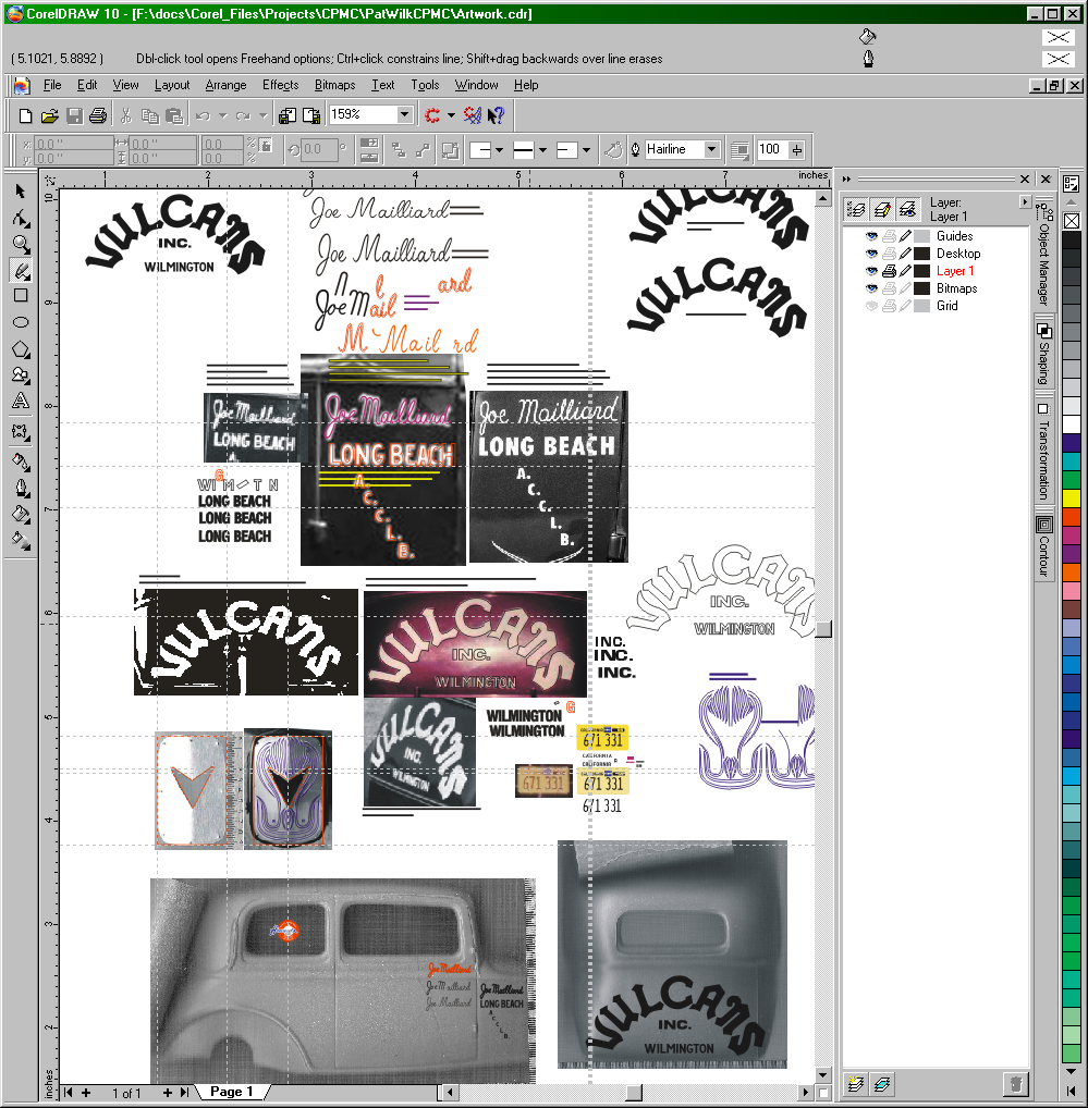

peteski Posted December 11, 2020 Posted December 11, 2020 58 minutes ago, camaro69 said: As Peter said: Inkscape is a free vector drawing software. You can import your jpg and convert it into curves. The only problem is that you have to smooth the automatically generated curves. It's a learning process but it works too. I can do that in Corel too, but I find that manually tracing the bitmaps takes less time than fixing the auto-traced curves.
Plumcrazy Preston Posted December 12, 2020 Author Posted December 12, 2020 (edited) 2 hours ago, peteski said: I can do that in Corel too, but I find that manually tracing the bitmaps takes less time than fixing the auto-traced curves. Can objects by copied and pasted into Corel as a photocopy of a photograph or an image from another program like Paint? When I made my window decal image for my jetliner, I used my computer scanner to copy the original decal sheet in the box and then traced that row of windows to form new ones with simple spot colors. I will sometimes use a photo then painstakingly recolor each and every pixel one by one about the outlines. Even my wolf head logo was snagged by me from Google and reworked in Paint. I did that copy/paste/trace of the stock decal sheet to remove the Eastern Airline livery from the row of windows and doors and put in my own custom markings: AMERICAN ORIGINAL. Paint has simple shapes like squares with rounded corners and such. That's how I formed the new windows and doors over the old ones. Copy/paste is a tool I use heavily in an image editor like Paint as well as the eraser tool, the Fill can, the color grabber, and the margin ruler. Dragging the select tool makes it easy to measure the height or width of an object in pixels or inches. So basically can a vector program use an existing image or part of one as a template to build a new picture? Can one easily design logos with letters going around a circle as the Presidential Seal? I used WordArt in Microsoft Word to make the logo of PRESTON bent above the wolf head for my truck door sign in the shape of a rainbow. Is vector a great tool to make Harley-Davidson logos for gas tanks? How about if I had a photograph of a red car and I wanted to recolor it orange? Is the Eras font available in Corel? Can objects be rotated a certain number of degrees and easily resized? Can objects be flipped horizontally or vertically to make a mirror image of something? Can I add a border or outline to letters and numbers a different color than the fill and at a prescribed thickness? Paint does not allow me to border the characters text objects while typing in text. It is indeed rather limited. Edited December 12, 2020 by Plumcrazy Preston
peteski Posted December 12, 2020 Posted December 12, 2020 (edited) "Yes" to all your questions David. Corel Draw (or other similar programs like Adobe Illustrate or Inkscape) can do all you mentioned (and much more). And much easier than repainting things pixel at a time. But you will need to do some learning. Thankfully in today's digital world, there are plenty of video tutorials on hwo to perform all the "magic: in those programs. Only thing is needed is time and some patience. I often use a photo or a scan of some logo to trace it into clean vector format. Each color can be made into a separate vector object and can easily be manipulated (like changing its color). Corel Draw also offers automatic tracing of bitmaps into vector objects, but the original bitmap needs to be hi-resolution and clear. I still find that I can do better job tracing bitmaps manually than what the program can do. And vector-based drawings can easily be resized without any pixelation. This is sort of like the modeler who uses spray cans to paint their models but refuses to use an airbrush, because he thinks it is too much of a pain to clean after painting. If he broke down and decided to get an airbrush, he would realize that the cleanup is not all that tedious, and the airbrush allows for much better control and better paint jobs. If you want to get better and quicker results (and have easier time dealing with decal manufacturers) it is time to graduate from MS Paint and pick up a vector drawing program. Inkscape is free to use. Personally, I use Corel Draw, because I started with version 2 or 3 back in the early '90s, so I'm used to it. I currently use version 10 and 12 (current onbe is version x8 or 18). I have no need for the latest - mine do all I need (and a lot more) already. Here are some examples of my decal designs in Corel Draw. This is my virtual "sketchpad" This is where I do my tracing. The photos (bitmaps) are placed in the Bitmaps layer and locked. "Bitmaps" is just a name I assigned to that layer - it is just like any other layer in Corel. I then do the vector tracing over them on Layer 1. The black/white images of the car body are actual scans of the model. I place a copy of the tracings over those scans and size them to fit on the model. As you can see there are rulers around the drawings, so all the sizes are in real inches - no guessing needed. Once I have all the objects sized properly in the sketchpad file, I create the actual decal artwork. The above image is not what I'll be printing on my alps printer - it is just a rendering of what the printed objects will look like when printed out. Notice the instruction above the drawing - that is what I use for printing. Also notice all the different layers defined on the rigth. Each of those layers is a separate print run for Alps. Alps has the ability to retain the paper inside, so each printing pass will be perfectly aligned with the previous passes. All but the CYMK layer are printed as spot colors. I also use special Alps printing tricks, sch as relabeling cartridges. Alps is a very capable printer, but there are many tricks that aren't covered in its manuals. There is a large Alps users community where we share our printing techniques. This is what the actual artwork for white ink (to be sent to the printer) looks like. All that is black will be printed with white ink, and all the white "paper" areas will be left blank. Here you see that the white ink will be applied under the license plate and Howard's Cams logo color images which will be printed in subsequent print passes. As you can see, this process is not the simplest, but the results are excellent. And since I work in actual-size artwork, the size that shows up on the screen is the same size that gets printed. Edited December 12, 2020 by peteski
