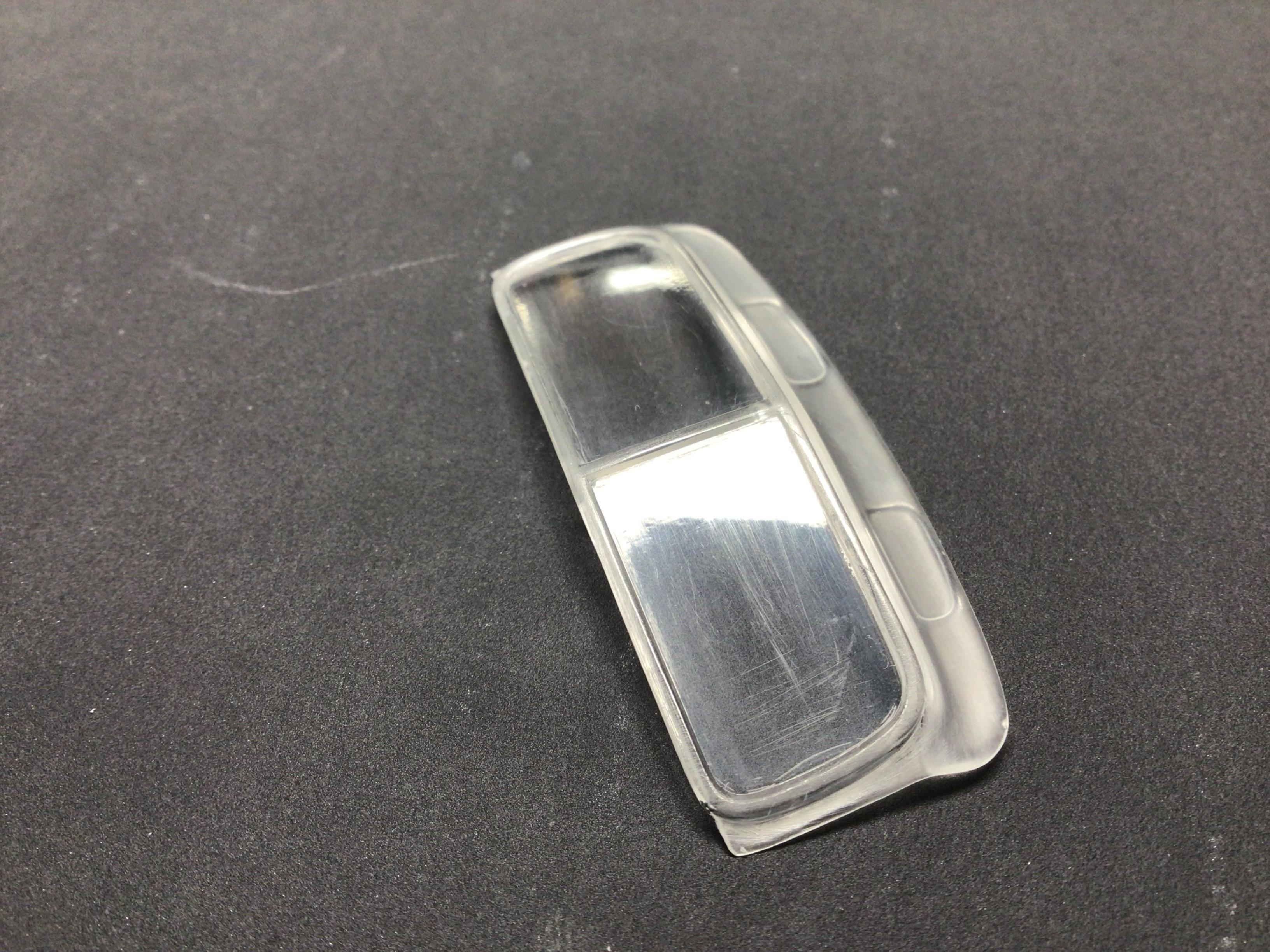

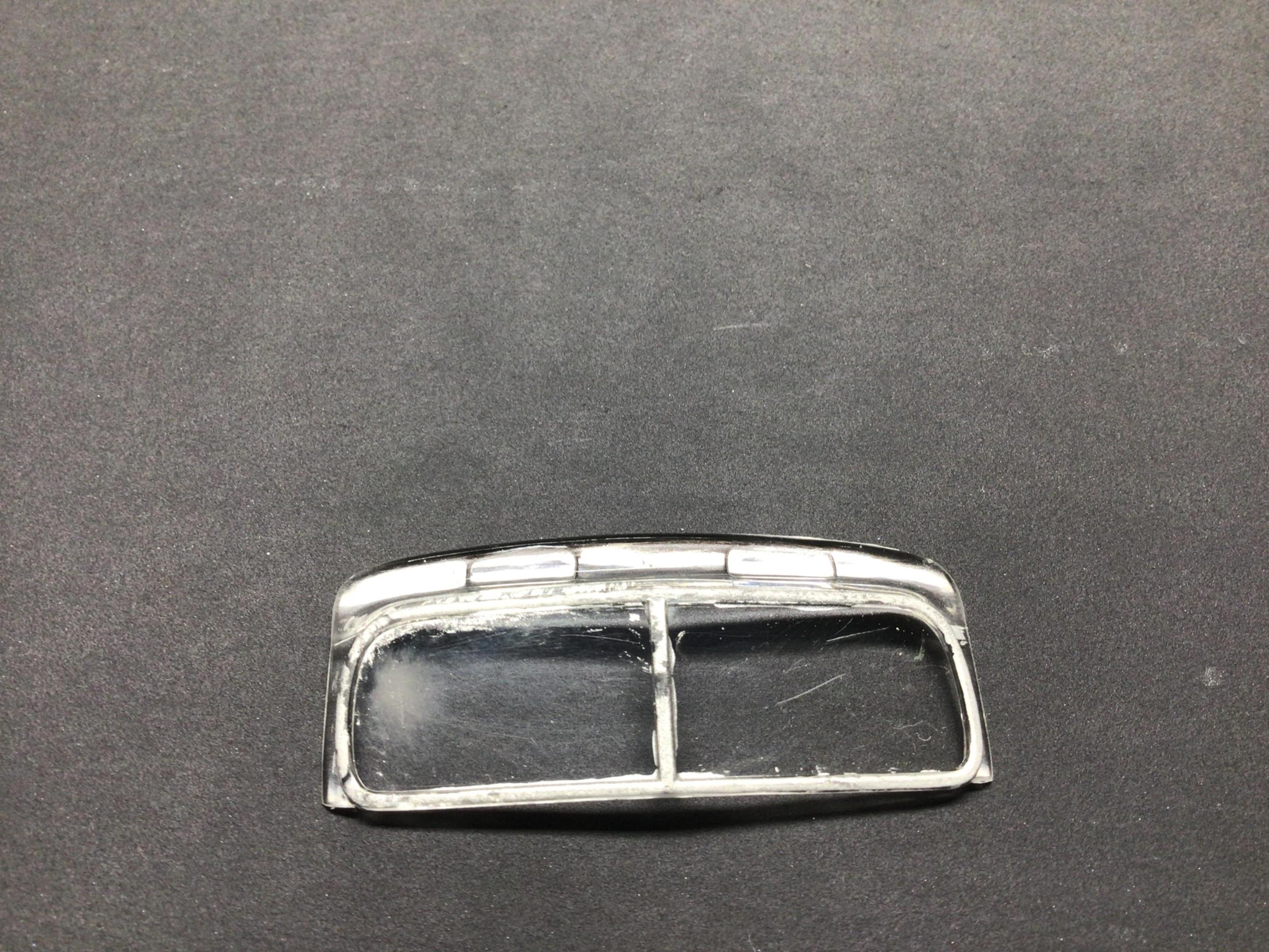

NOBLNG Posted October 8, 2021 Share Posted October 8, 2021 (edited) The silver paint that was used on this glue bomb does not dissolve in Super Clean. What would be the next best stripper to use that won’t damage the clear plastic. I will be picking up some Novus polish later today to get rid of the small scuff marks. Thanks. Edited October 8, 2021 by NOBLNG Quote Link to comment Share on other sites More sharing options...
jchrisf Posted October 8, 2021 Share Posted October 8, 2021 I've had luck with DOT 3 brake fluid when Super Clean wouldn't remove it. Quote Link to comment Share on other sites More sharing options...
NOBLNG Posted October 8, 2021 Author Share Posted October 8, 2021 Just now, jchrisf said: I've had luck with DOT 3 brake fluid when Super Clean wouldn't remove it. And that won’t harm the clear plastic? I know it can make regular styrene brittle, and clear is already more brittle…? Quote Link to comment Share on other sites More sharing options...
Fat Brian Posted October 8, 2021 Share Posted October 8, 2021 You could try 91% alcohol. Quote Link to comment Share on other sites More sharing options...
jchrisf Posted October 8, 2021 Share Posted October 8, 2021 1 hour ago, NOBLNG said: And that won’t harm the clear plastic? I know it can make regular styrene brittle, and clear is already more brittle…? Good question.. I've never used it on clear before. Honestly, I'd just sand and polish it out if it were me. Quote Link to comment Share on other sites More sharing options...
NOBLNG Posted October 8, 2021 Author Share Posted October 8, 2021 3 hours ago, jchrisf said: Good question.. I've never used it on clear before. Honestly, I'd just sand and polish it out if it were me. Ok, I sanded the raised rim which I am re-painting anyways and scraped the inside corners as much as possible. My local HS only had Tamiya compound, so I am trying to polish out the scratches. Some are fairly deep.🤨 What would be the coarsest grit paper that could be used prior the polishing compound? Quote Link to comment Share on other sites More sharing options...
Rick L Posted October 8, 2021 Share Posted October 8, 2021 A little time consuming but If you start with fine polishing cloth and work your way down to coarser grit you won’t damage the clear any more than it’s damaged now. Then you can work your way back up in grit to a satisfactory level. If the scratch is deep you could then go to sandpaper proceeding the same way. Quote Link to comment Share on other sites More sharing options...
jchrisf Posted October 9, 2021 Share Posted October 9, 2021 (edited) 18 hours ago, NOBLNG said: Ok, I sanded the raised rim which I am re-painting anyways and scraped the inside corners as much as possible. My local HS only had Tamiya compound, so I am trying to polish out the scratches. Some are fairly deep.🤨 What would be the coarsest grit paper that could be used prior the polishing compound? I'd probably start with 2,000 and go up to 6 or 8,000 then I use a Dremel with a buffing wheel and some Mequiar's Ultra-Cut and then polish. The dremel makes it so much faster and smoother than I can do by hand Edited October 9, 2021 by jchrisf Quote Link to comment Share on other sites More sharing options...
Paul Payne Posted October 9, 2021 Share Posted October 9, 2021 Another thing you could try after getting everything as good as possible with sanding and polishing would be to spray it with clear gloss. Quote Link to comment Share on other sites More sharing options...
NOBLNG Posted October 9, 2021 Author Share Posted October 9, 2021 Thanks for the suggestions Guys. I have been going to town on it with the coarse polishing compound and I think I’m getting there. I mounted a piece of foam gasket on an old electric toothbrush, and it seems to be working fairly well. Quote Link to comment Share on other sites More sharing options...
SfanGoch Posted October 9, 2021 Share Posted October 9, 2021 Dipping it in Future/Pledge Floor Care/whateverthehellitscallednow is better than spraying any kind of clear gloss. It will fill in any small scratches which might be left. Quote Link to comment Share on other sites More sharing options...
alan barton Posted October 10, 2021 Share Posted October 10, 2021 I'll second that, Joe! You could dip that screen in Future right now, as it is, and the windows would look like brand new! Cheers Alan Quote Link to comment Share on other sites More sharing options...
