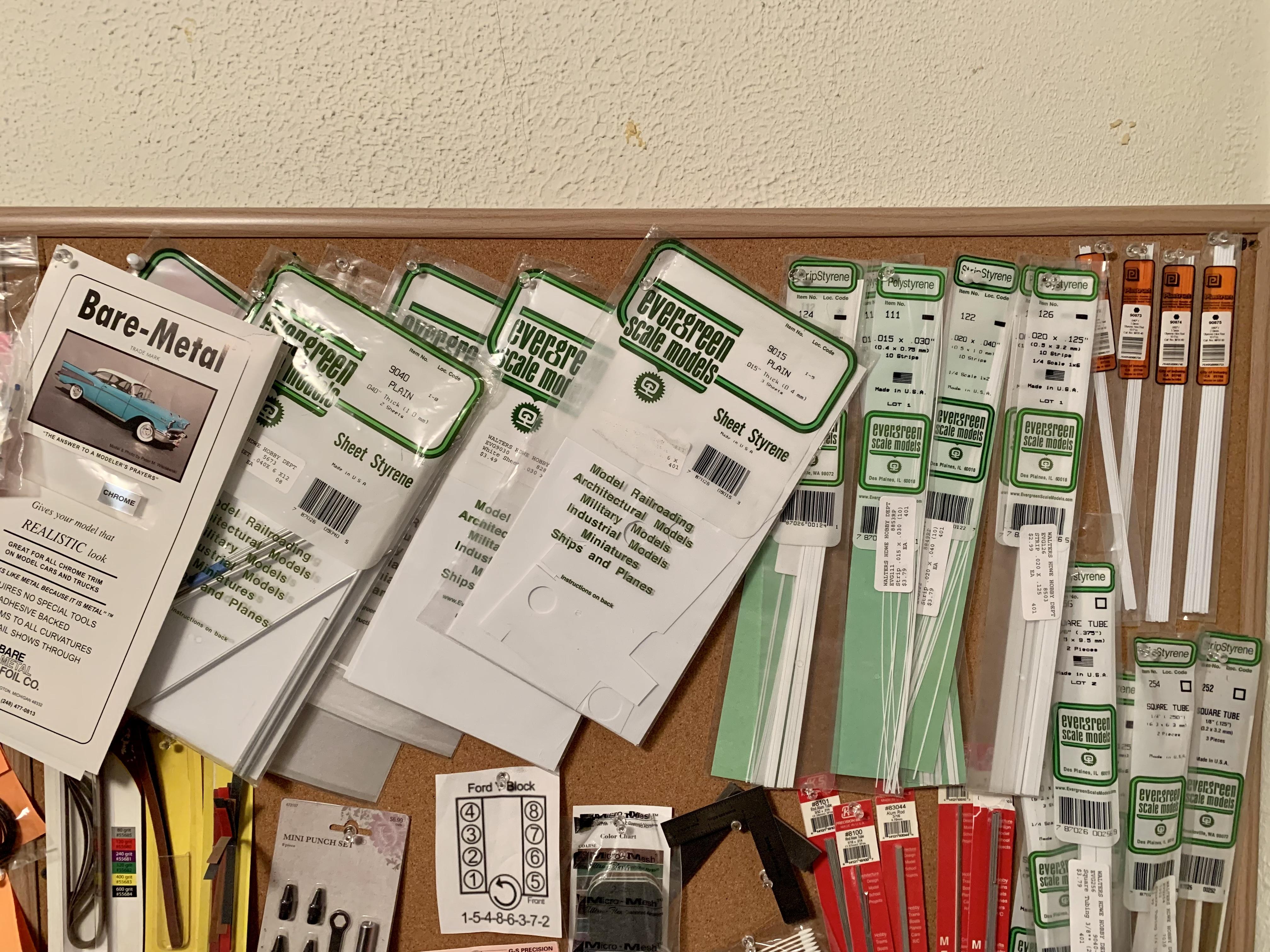

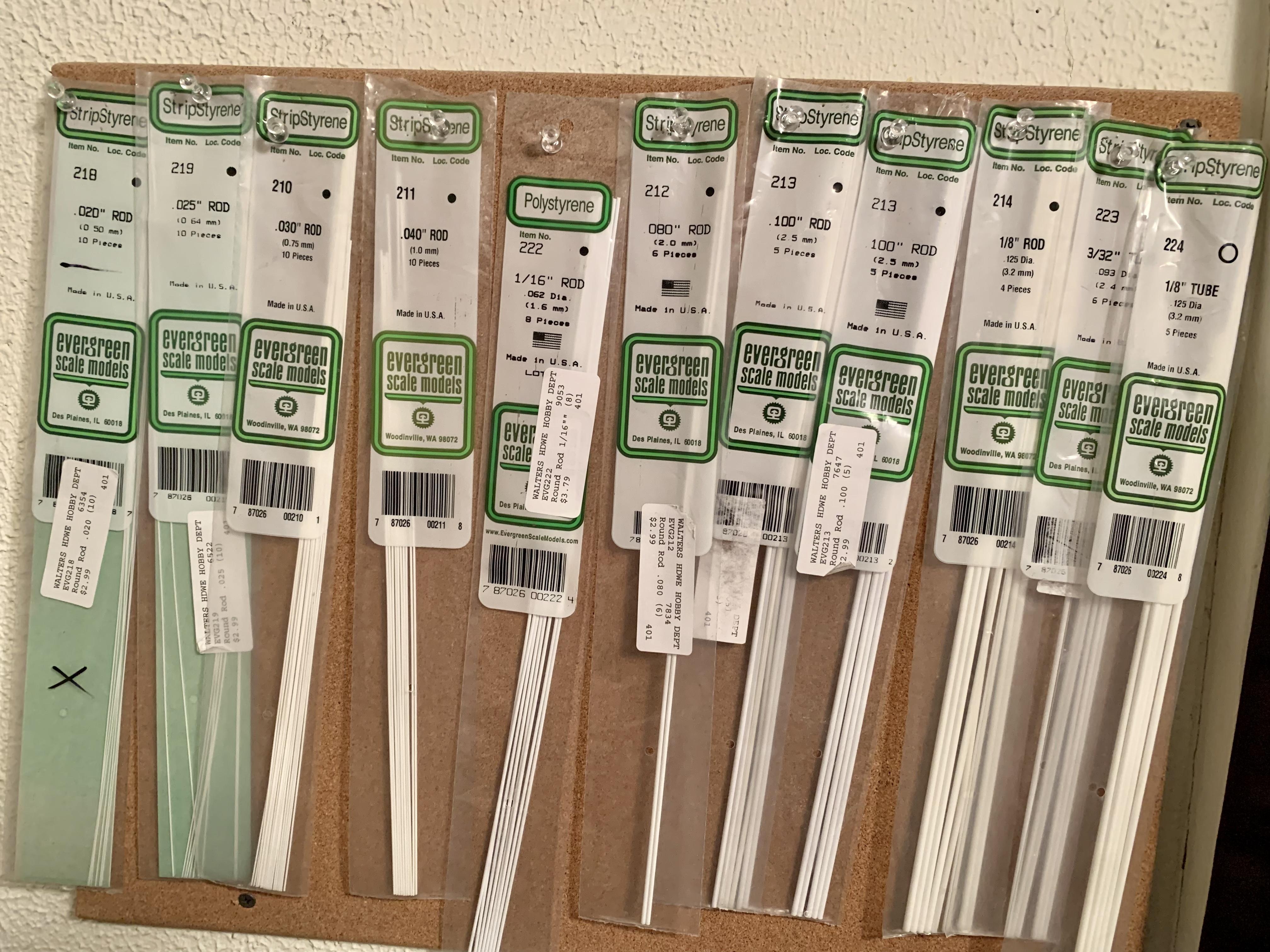

Brutalform Posted December 16, 2021 Posted December 16, 2021 (edited) Probably a little easier to just post these pics of my supplies. Besides the tube, and rod styrene, the strip styrene in the first pic comes in real handy at times too. Some brass and aluminum rod, and tube, also is useful for making driveshafts and attaching wheel backs etc. I totally agree with Greg on having a few things you might need sometime, than not having it. Edited December 16, 2021 by Brutalform 2

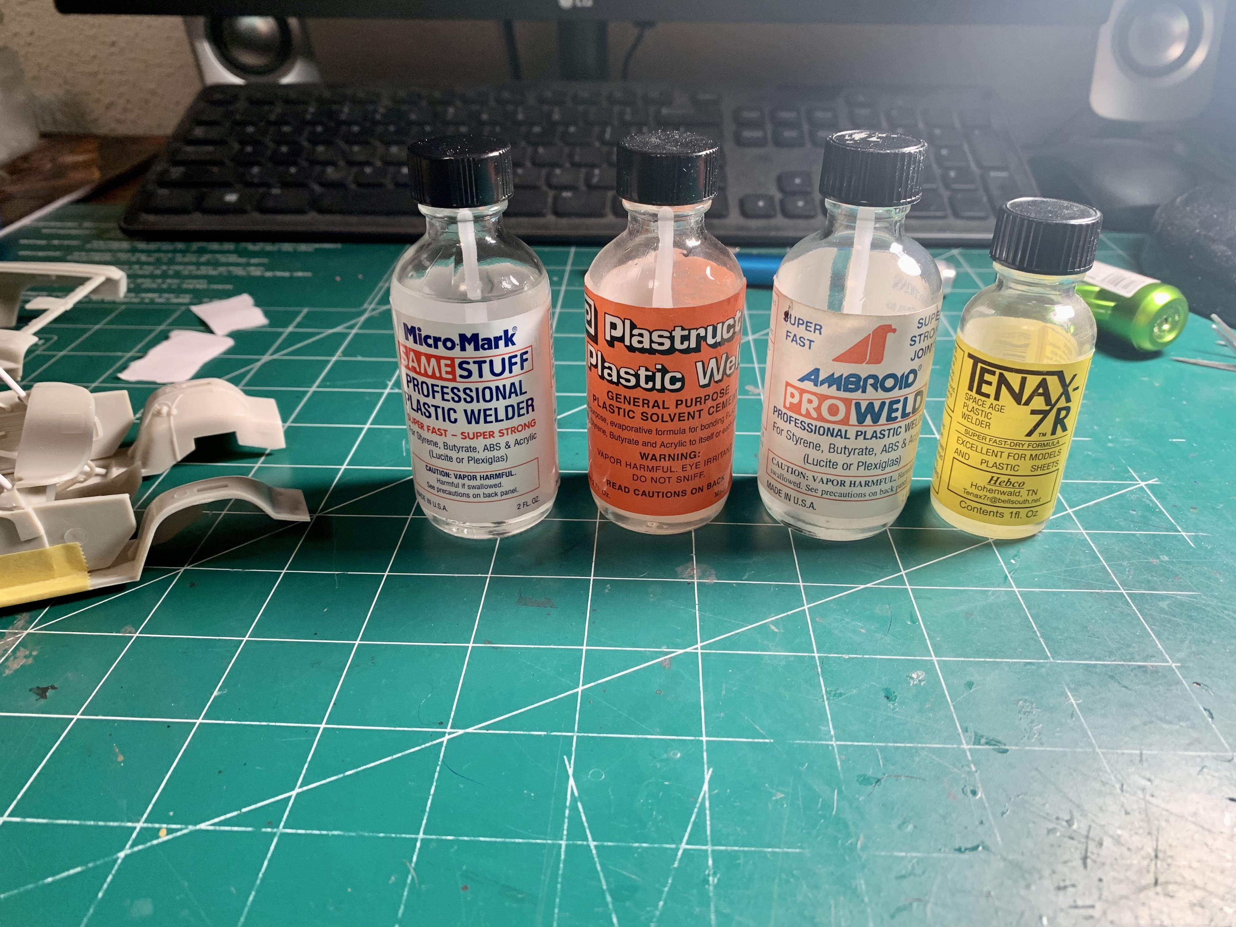

Brutalform Posted December 16, 2021 Posted December 16, 2021 And don’t forget a quality plastic welder. I do believe the Tenax, and Pro Weld is no longer available, but, the MicroMark, and Plastruct will get the job done. 1
