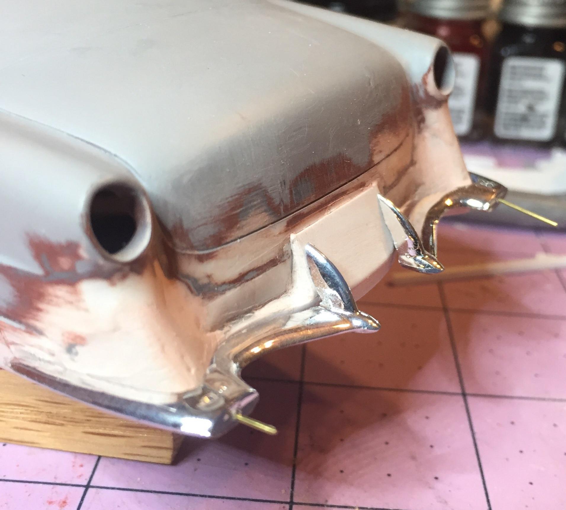

customline Posted January 14, 2022 Author Share Posted January 14, 2022 (edited) A little forward movement. This is every bit as difficult as I thought 😕 Edited January 14, 2022 by customline Added text Quote Link to comment Share on other sites More sharing options...
misterNNL Posted January 14, 2022 Share Posted January 14, 2022 On 12/21/2021 at 6:29 PM, customline said: Up till 3 am on this. I think I see the light at the end of the tunnel. This will look much better than what I had and is a lot closer to my inspirational subject. the bumpers will be pinned on the ends as shown here. Over-riders will be glued to the plate mount. Still a ways to go to get it smoothed out. Thanks for looking It really liking these Corvette bumpers. Their styling flows very well in that area. IMHO much better choice than the other attempts. Looking forward to seeing this play out. Quote Link to comment Share on other sites More sharing options...
customline Posted January 15, 2022 Author Share Posted January 15, 2022 1 hour ago, misterNNL said: It really liking these Corvette bumpers. Their styling flows very well in that area. IMHO much better choice than the other attempts. Looking forward to seeing this play out. Yeah, me too,Tom 😪 Thanks for the encouragement. Quote Link to comment Share on other sites More sharing options...

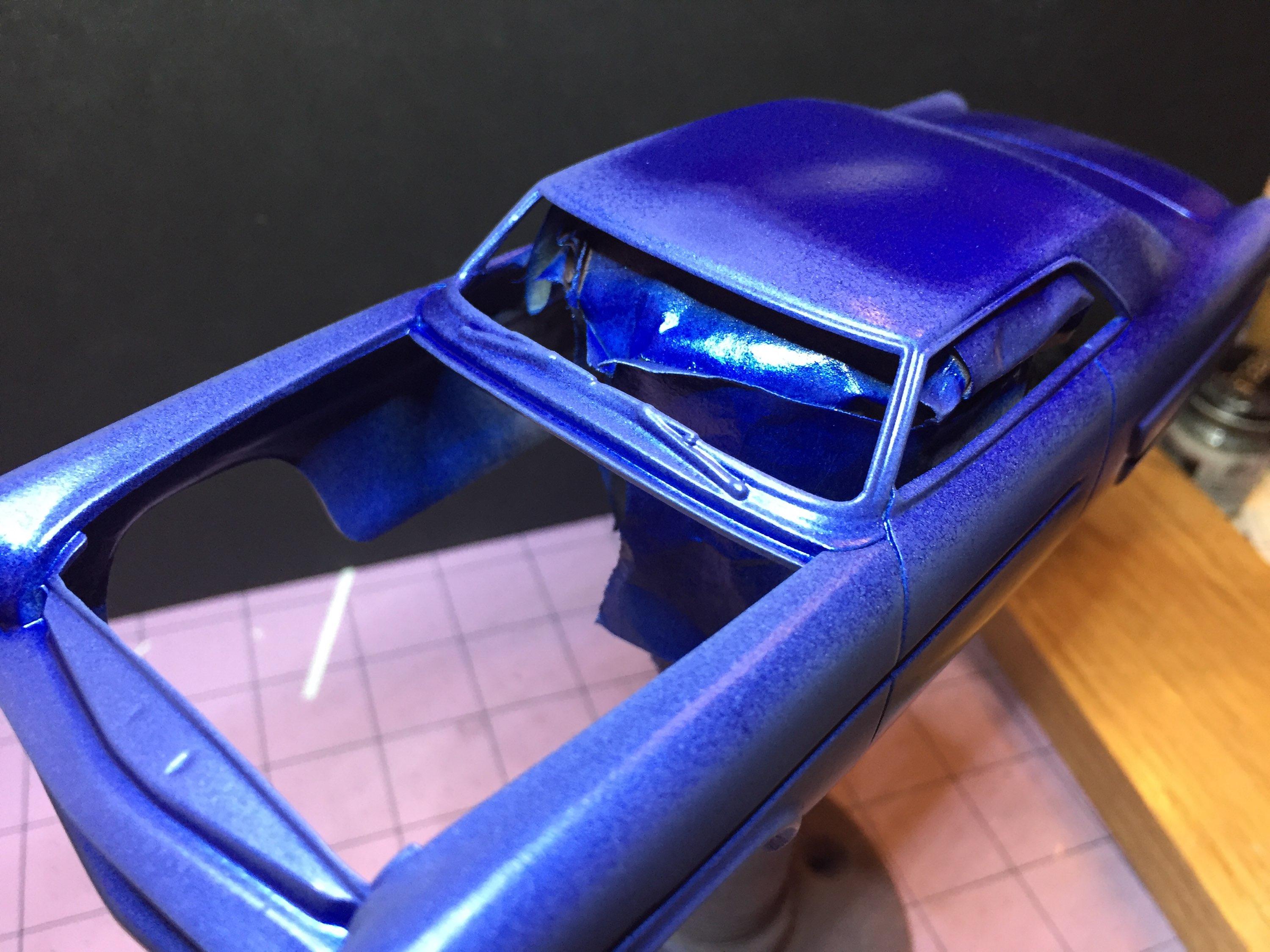

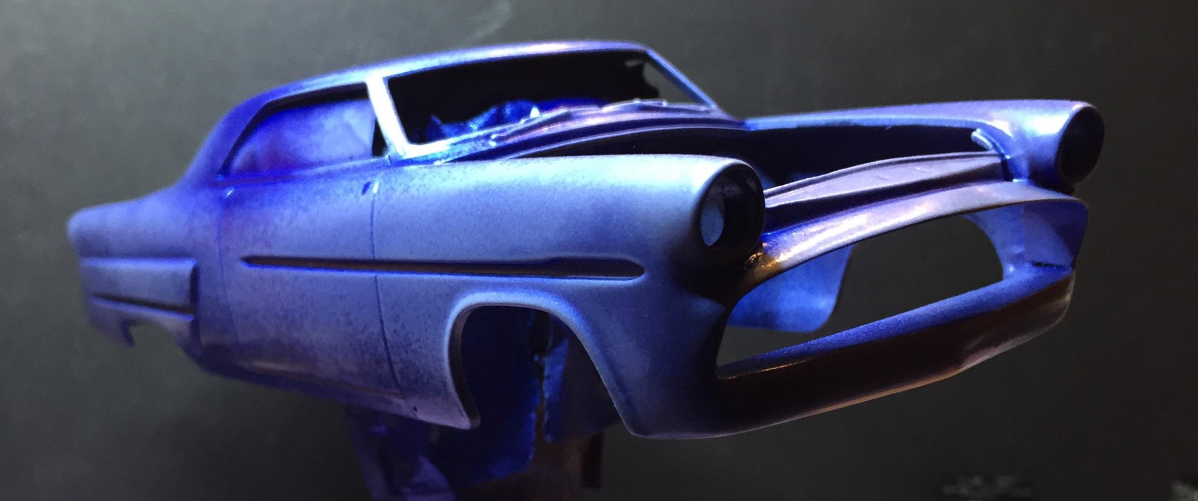

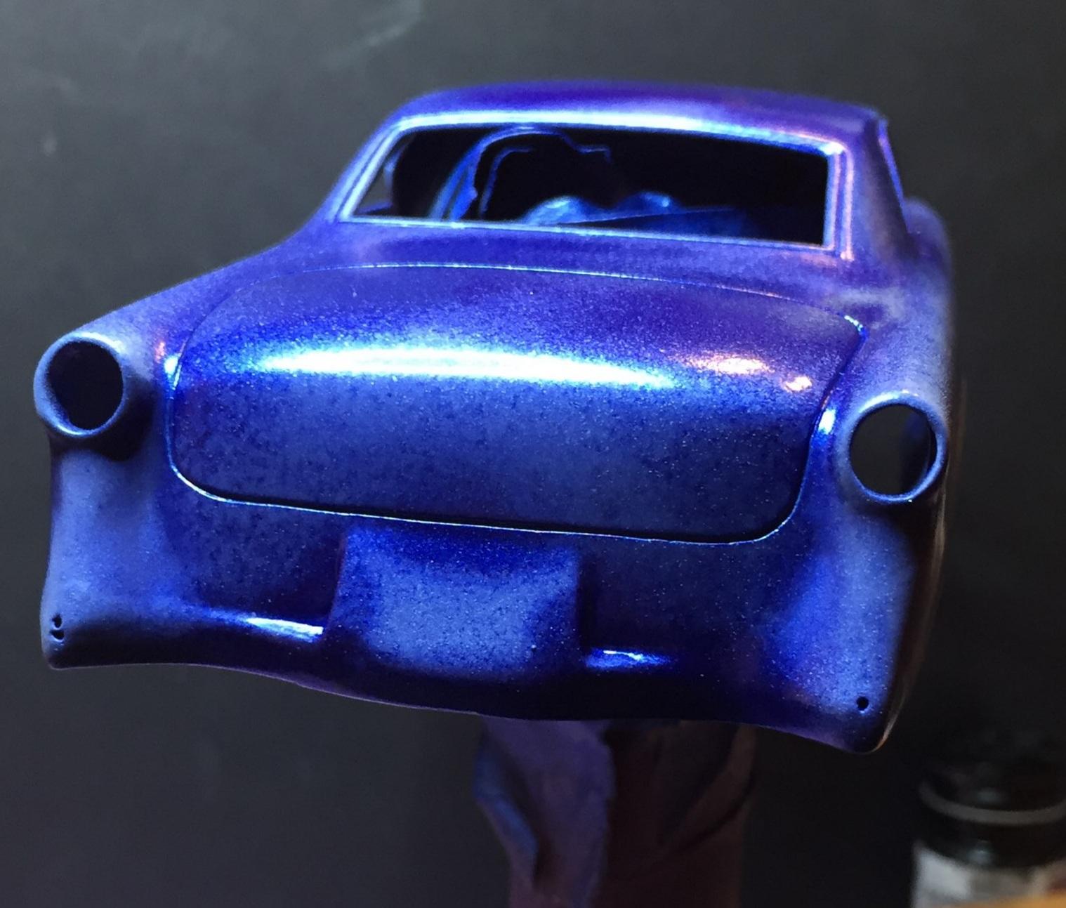

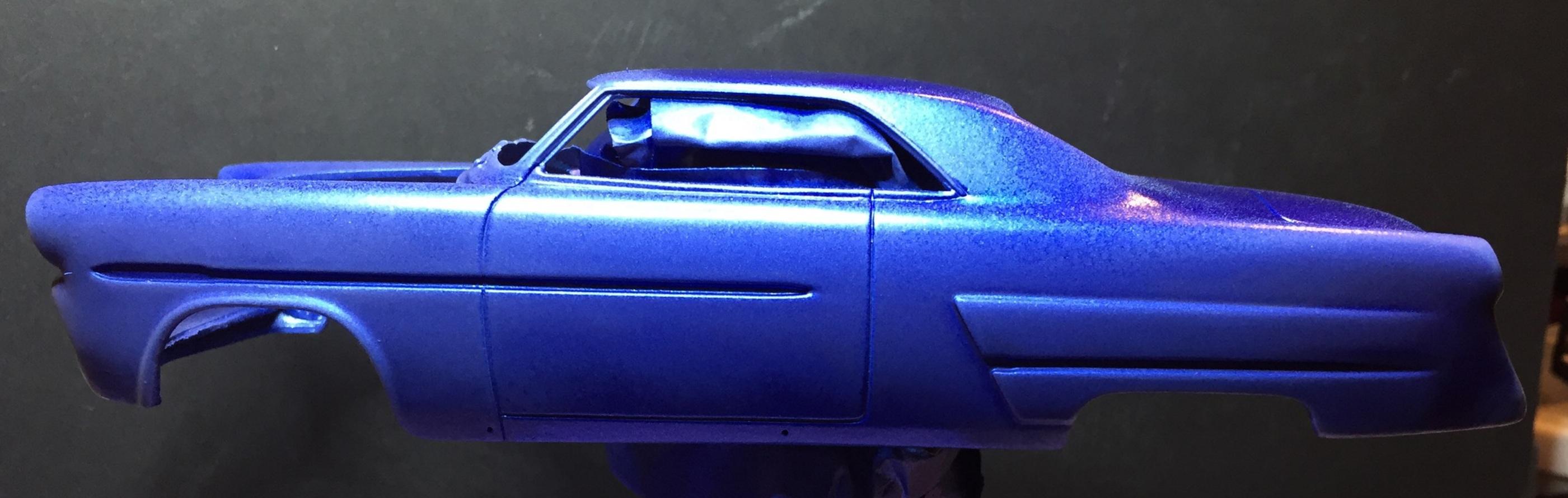

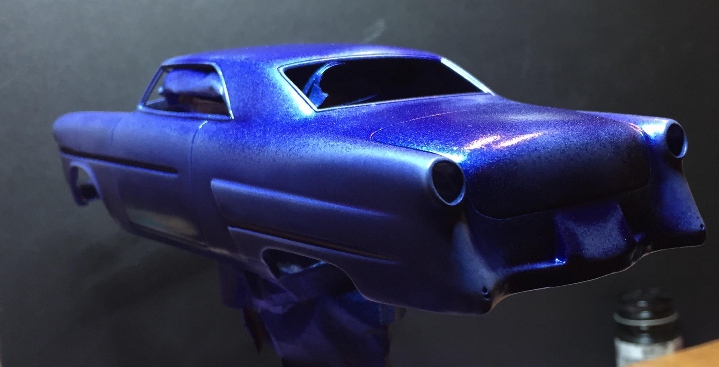

customline Posted February 3, 2022 Author Share Posted February 3, 2022 The weather broke warm today so I rushed out to the garage, a can of Duplicolor "Electron Blue Pearl" under my arm, a handful of styrene and Bondo covered with Handi-wrap ( it had rained a little) and got 'er done! But it's going to be more work after it cures. I'm told this paint is acrylic lacquer but I'm not totally convinced. At this point, it doesn't matter. This is a done deal. I believe Duplicolor is formulated as a two part system. Gotta cover with Clear coat. Maybe not. I don't know yet. Here's what it looks like now, blushed to the max. Quote Link to comment Share on other sites More sharing options...
espo Posted February 3, 2022 Share Posted February 3, 2022 Looks like you may need at least one more color coat. Quote Link to comment Share on other sites More sharing options...

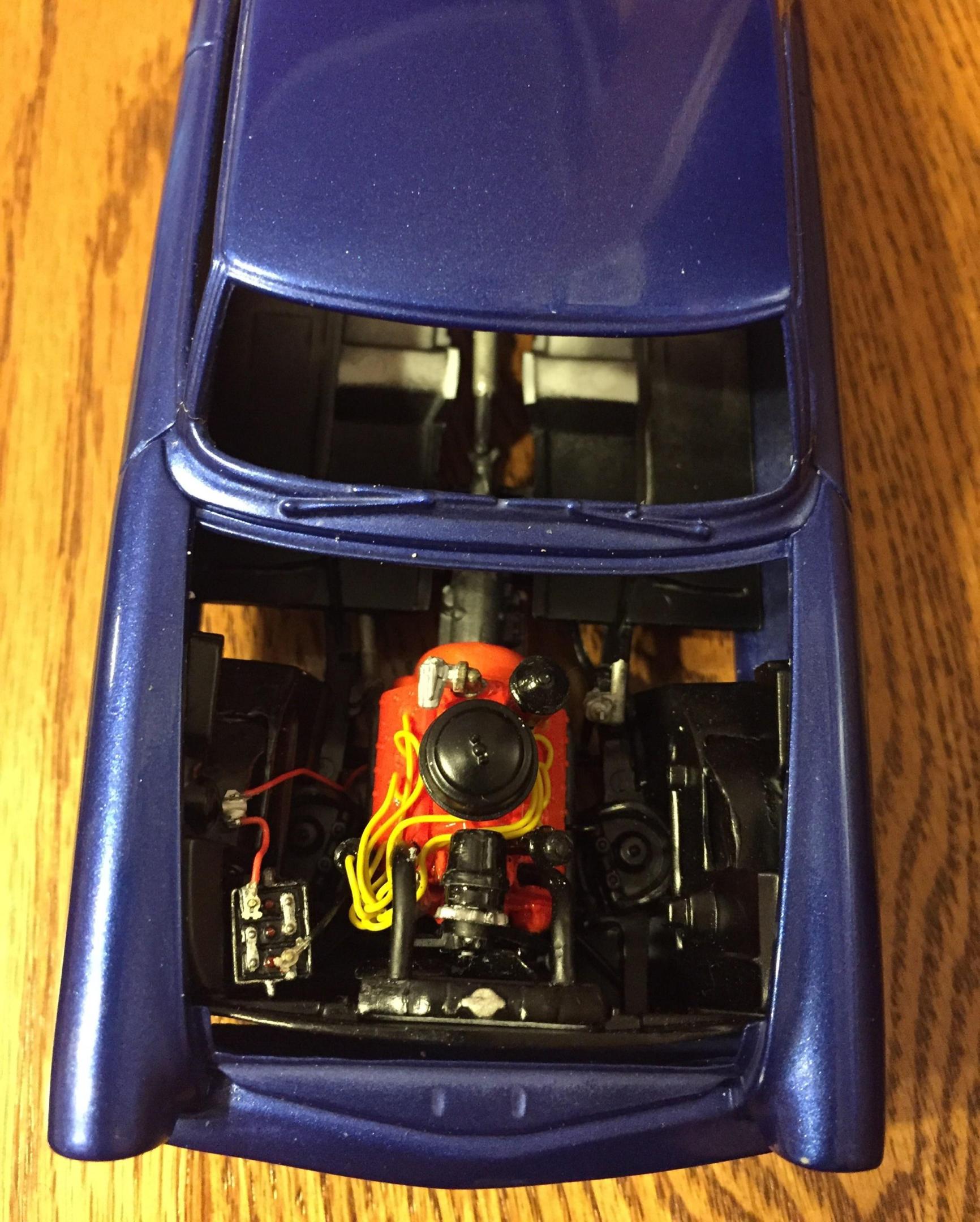

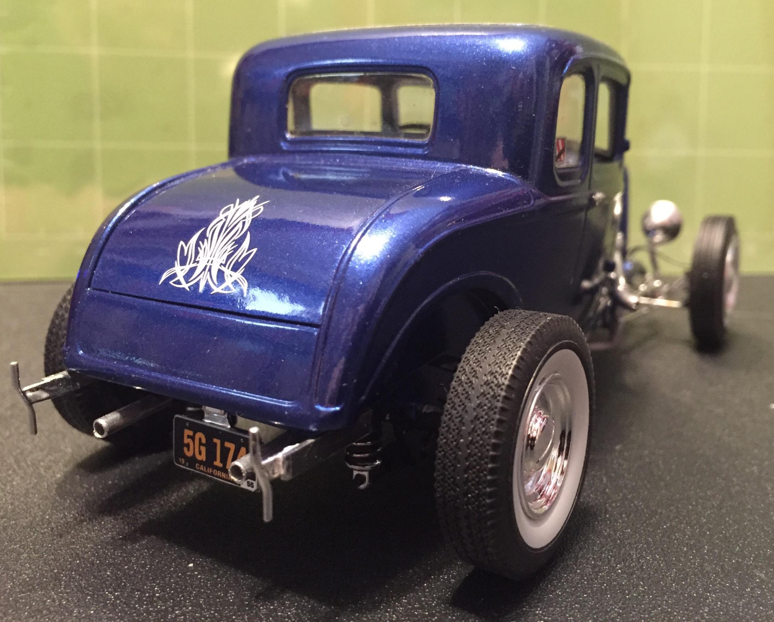

customline Posted February 3, 2022 Author Share Posted February 3, 2022 (edited) 17 minutes ago, espo said: Looks like you may need at least one more color coat. Well, I dunno...that just might be, Dave, but the blush is just on the surface. While doing this today, I recalled another car I painted with this can. I remember using clear over it and I accepted a little orange peel thinking "good enough" but this build will get more attention to the finish. I have a lot of time in this one. Below is the other car I painted with this can. The Victoria has got to be slick🤓 by the way, where are my tail lights? Edited February 3, 2022 by customline Added text Quote Link to comment Share on other sites More sharing options...
bisc63 Posted February 4, 2022 Share Posted February 4, 2022 Acrylic lacquers are very susceptible to moisture in the air, and when I read you were about to paint just after the rain, I knew what was coming next. I began doing body work on cars just at the tail end of lacquers being used, so I learned it then. As you noted, it looks intimidating, but after a good cure, will polish out. Quote Link to comment Share on other sites More sharing options...
customline Posted February 4, 2022 Author Share Posted February 4, 2022 2 hours ago, bisc63 said: Acrylic lacquers are very susceptible to moisture in the air, and when I read you were about to paint just after the rain, I knew what was coming next. I began doing body work on cars just at the tail end of lacquers being used, so I learned it then. As you noted, it looks intimidating, but after a good cure, will polish out. Yeah, I might be able to polish it out. I'll see what it looks like at 6000 grit. I ain't skeerd 💩 Quote Link to comment Share on other sites More sharing options...
bisc63 Posted February 4, 2022 Share Posted February 4, 2022 Nothing to lose, right? In a spray gun, we avoided this by using a very slow drying (high temp) reducer, to allow the trapped water time to evaporate out with the rest of the vapors. Thin coats, and plenty of dry time between at that. A spray can, however, is "all purpose", so never really perfectly suited to shop conditions; just generally warmer is better, and the lower the humidity the better. Good luck! Quote Link to comment Share on other sites More sharing options...
customline Posted February 4, 2022 Author Share Posted February 4, 2022 8 hours ago, bisc63 said: Nothing to lose, right? In a spray gun, we avoided this by using a very slow drying (high temp) reducer, to allow the trapped water time to evaporate out with the rest of the vapors. Thin coats, and plenty of dry time between at that. A spray can, however, is "all purpose", so never really perfectly suited to shop conditions; just generally warmer is better, and the lower the humidity the better. Good luck! The weather here is sorta paradoxical in the context of painting; when it's cold it's dry, when it warms up, like today( and yesterday), the humidity goes up. In the airbrush, I use cheap hardware store lacquer thinner. It slows the drying enough sometimes but yesterday, with the rattle can, I used a hair dryer to speed things up without 🤔 thinking. Oops! Oh well, it'll polish out but I may use clear on this one. Quote Link to comment Share on other sites More sharing options...
bisc63 Posted February 4, 2022 Share Posted February 4, 2022 Worth your money to invest in genuine high temp automotive lacquer thinner, a quart would last ages and really is different. (In a good way!) I'm in KY, so I know all about your climate issues; much the same environment as you have. Any way, loving this project, and I know you'll whip it! Quote Link to comment Share on other sites More sharing options...
customline Posted February 4, 2022 Author Share Posted February 4, 2022 (edited) Yeah, the high temp stuff would be great on a day like yesterday or today (I shot a car or two) but I use the cheap stuff because it's a bit kinder to whatever you spray it on. And it's cheap! 🥴 anyway, that's what I learned from an old man. But I hear you, Rusty 🥸 But rattle cans, it's a moot point. Edited February 4, 2022 by customline Quote Link to comment Share on other sites More sharing options...
