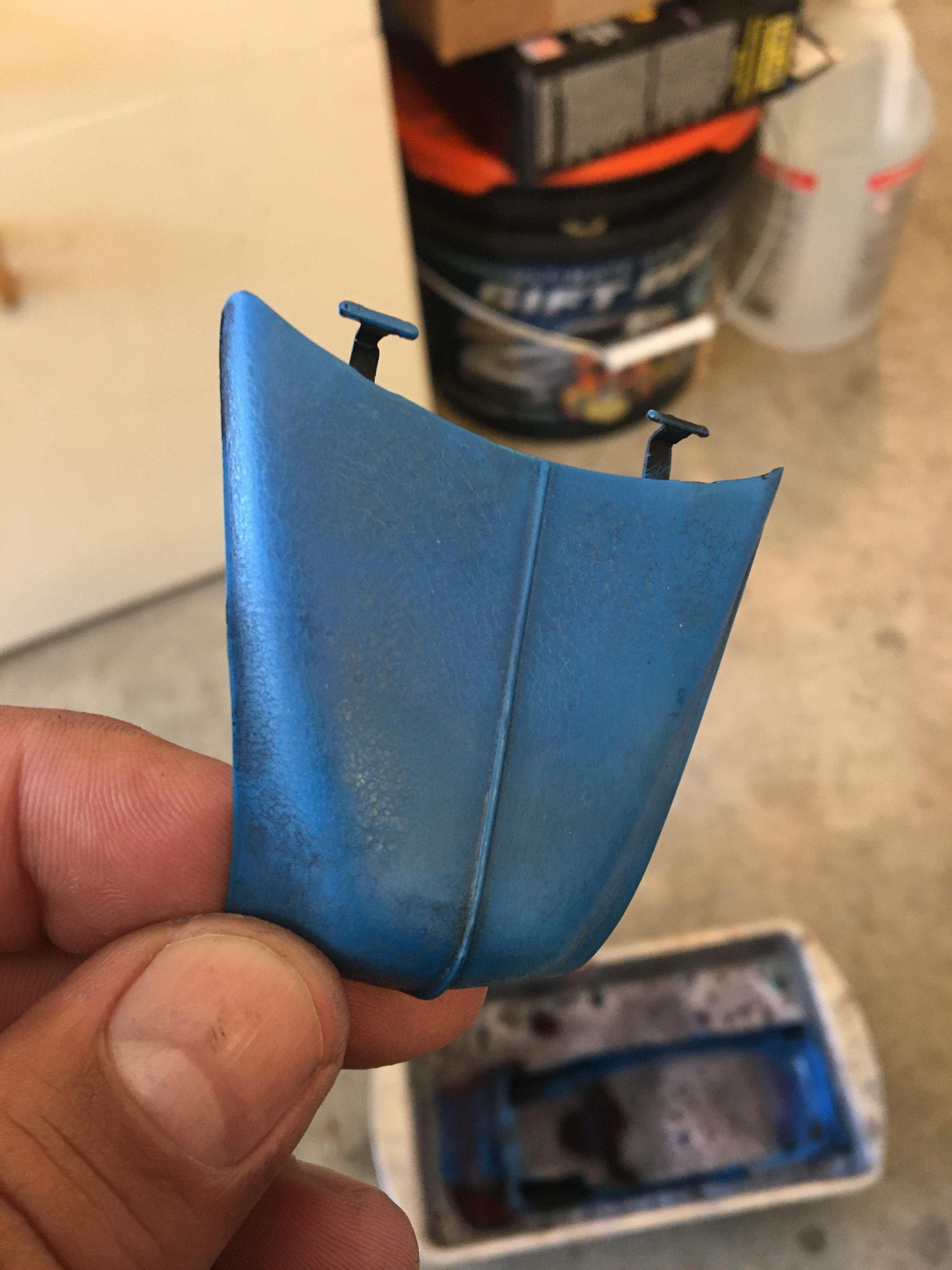

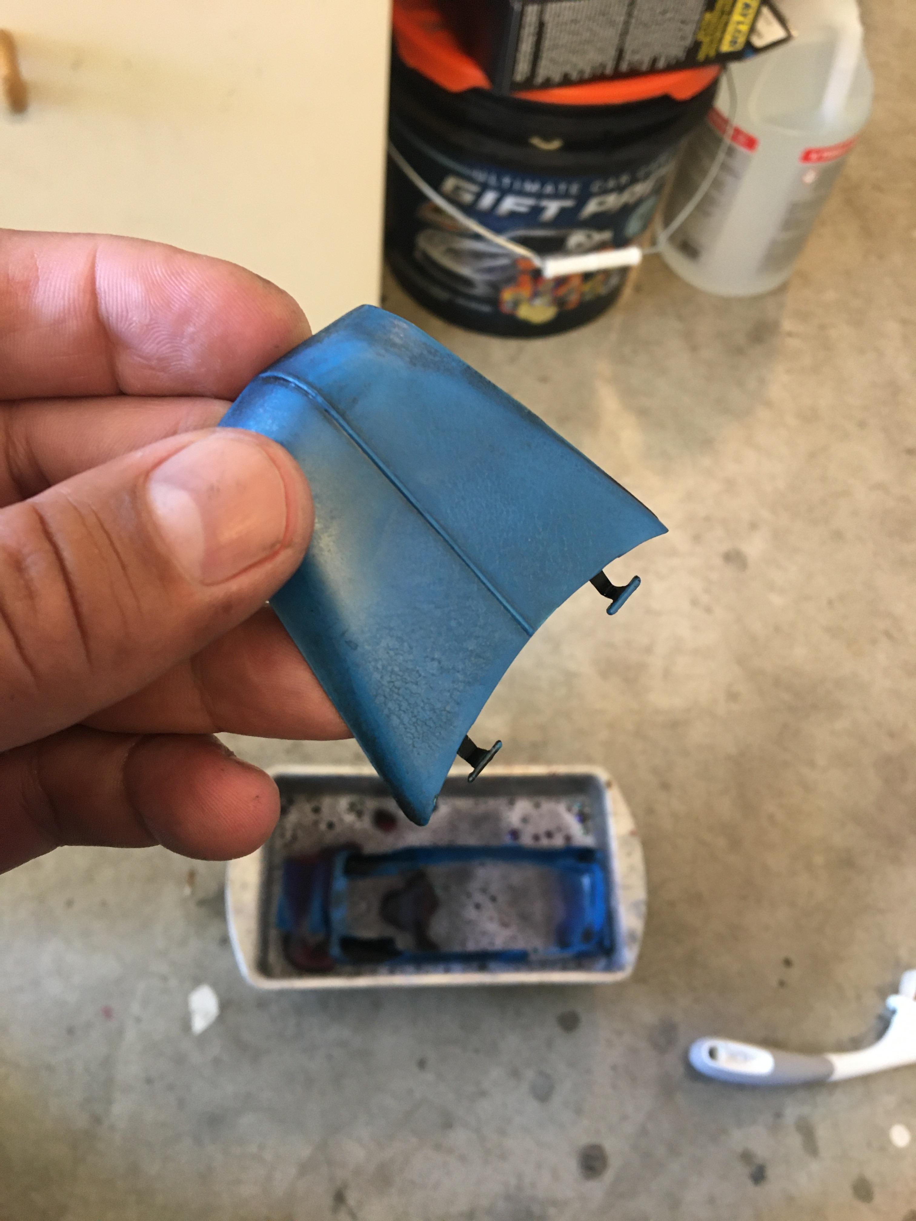

I primed & painted my revell 54 Chevy sedan(1985 release). The primer and color coat laid down nicely on the body but not so on the hood or interior panels.
When I sprayed the latter they wrinkled up or crazed. I assumed it was the paint but after having removed it in purple power it seems the plastic itself had a reaction to the paints. The actual plastic has the crazing lines in it. They were fine with the primer. It wasn’t till I sprayed the color coat that they wrinkled/crazed.
Any one have this happen before or know why?
Primer coat on both was rustoleum black primer. Color coat on hood was rustoleum gloss black, color coat on seats was an old can of krylon tan.

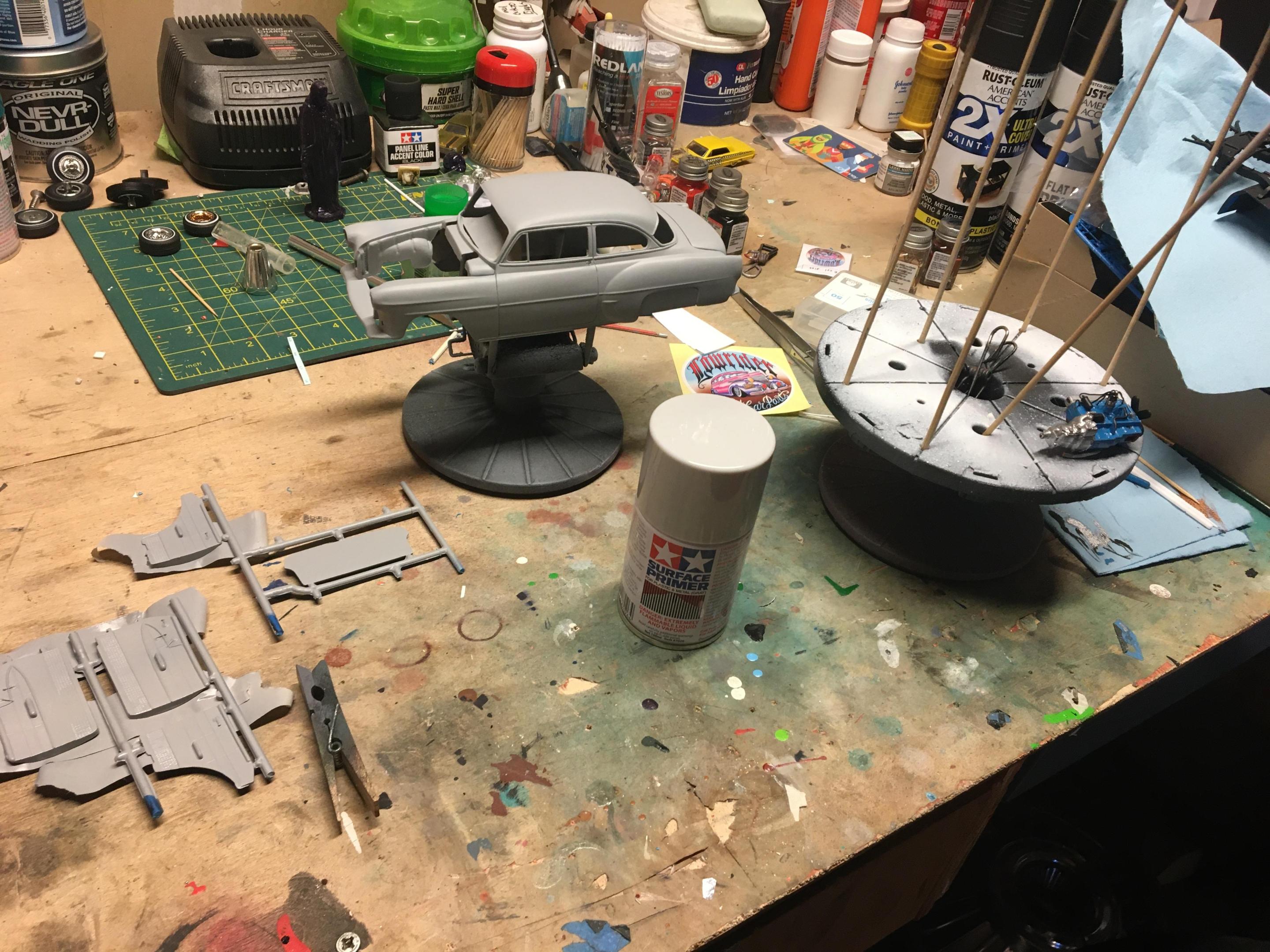

First time using tamiya primer. This stuff sure does spray pretty nice, looks to be superior to rustoleum for sure! I’ll probably continue using it in the future though I’m not crazy about the price. Here’s a picture I took after spraying with it.
