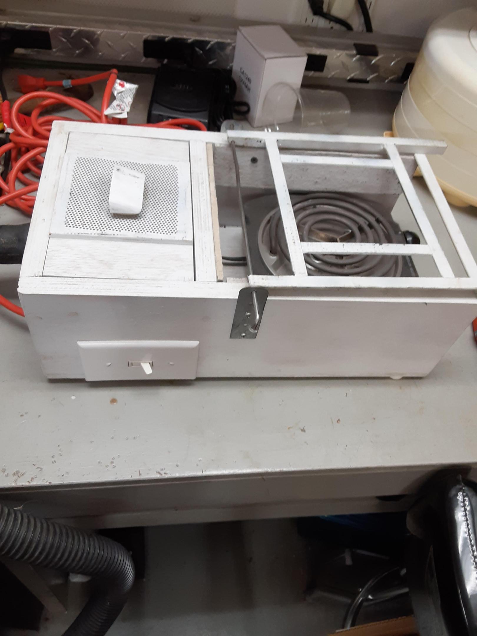

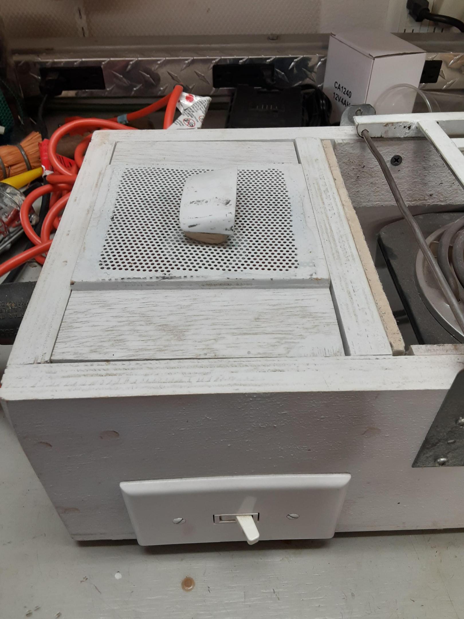

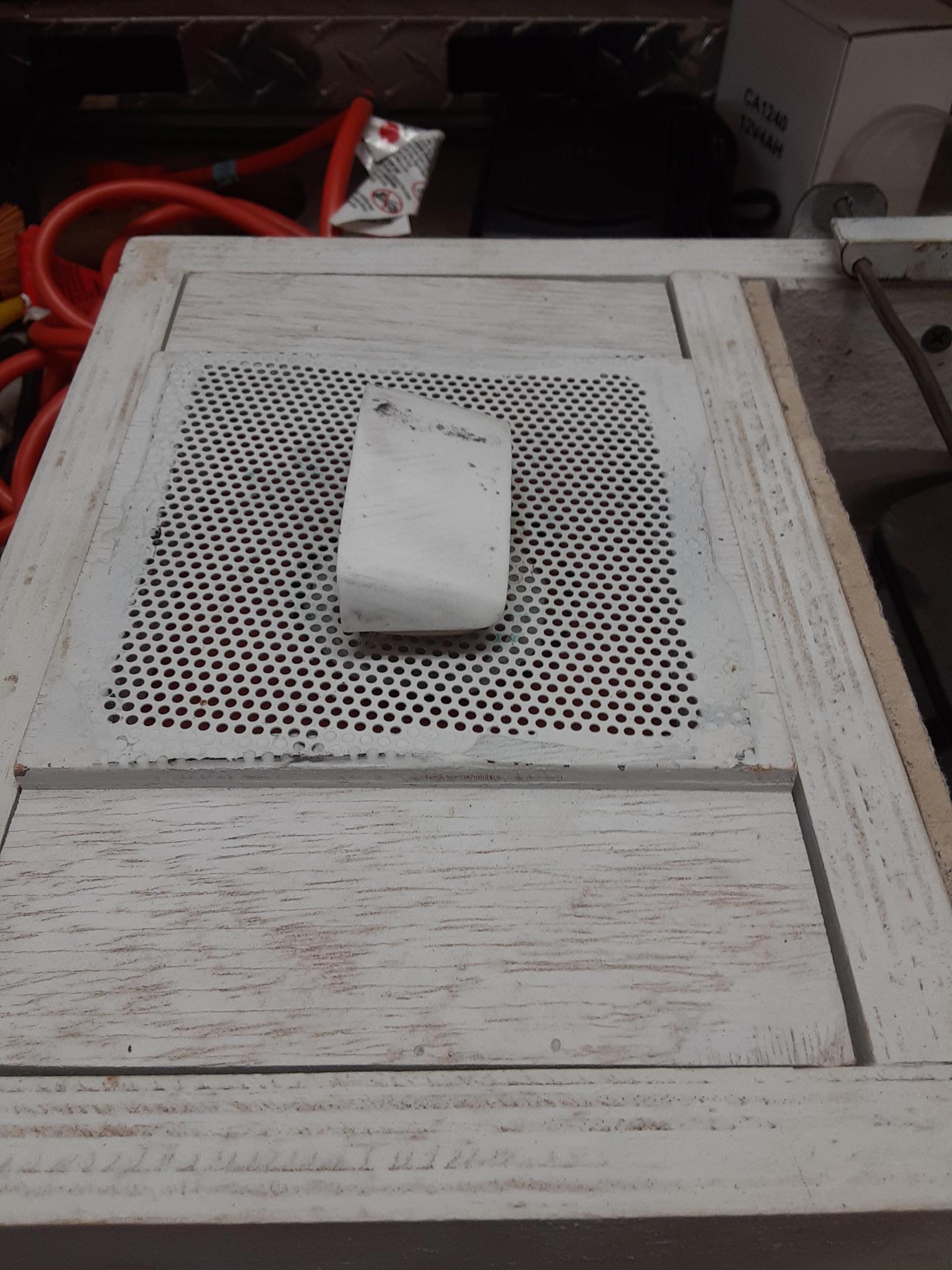

Len Woodruff Posted September 1, 2022 Author Share Posted September 1, 2022 Thanks for all of the above posts and Bill for his You Tube video. Here are some picks of my vacuum forming machine & the puck I was using for the back window. 1. Is the puck high enough off the plate? 2. Should the higher side be pointed toward or away from PETG? Quote Link to comment Share on other sites More sharing options...
Curt Posted September 1, 2022 Share Posted September 1, 2022 (edited) Len, from your description it sounds like you are not getting enough vacuum. Your former should be able to suck the PETG tightly around the buck. I would want the buck to be lower in relation to the plate. This will make it easier to achieve a seal, and also keep the plastic from being sucked under the buck, which makes it hard to free the buck from the part. As to temperature, I don't measure it. When I was starting out doing this I read that the PETG will get wavy as it hits a certain temperature. Watch carefully as it will rapidly smooth out after that. That is when you should swing the frame down over the buck and should give you a good part. This works very well for me. One more thing - dust is your enemy! Before you commence the forming take a used dryer sheet and run it lightly over both the buck and your PETG sheet. This will greatly reduce any "inclusions" in your part. Good luck! Edited September 1, 2022 by Curt Spellin correction 3 Quote Link to comment Share on other sites More sharing options...
Rick L Posted September 1, 2022 Share Posted September 1, 2022 (edited) I would lower the puck and also block all excess holes with duct tape. You only need the holes directly under the the perimeter of the window. This will give it better suction. Edited September 1, 2022 by Rick L 2 Quote Link to comment Share on other sites More sharing options...
Chariots of Fire Posted September 2, 2022 Share Posted September 2, 2022 I have a vacuu-form machine as well. I would sit the buck for the windshield right down on the grill so that when the softened sheet drops over it the rest of it gets pulled down evenly all around. Having the buck raised off the grill may be your problem. 1 Quote Link to comment Share on other sites More sharing options...
