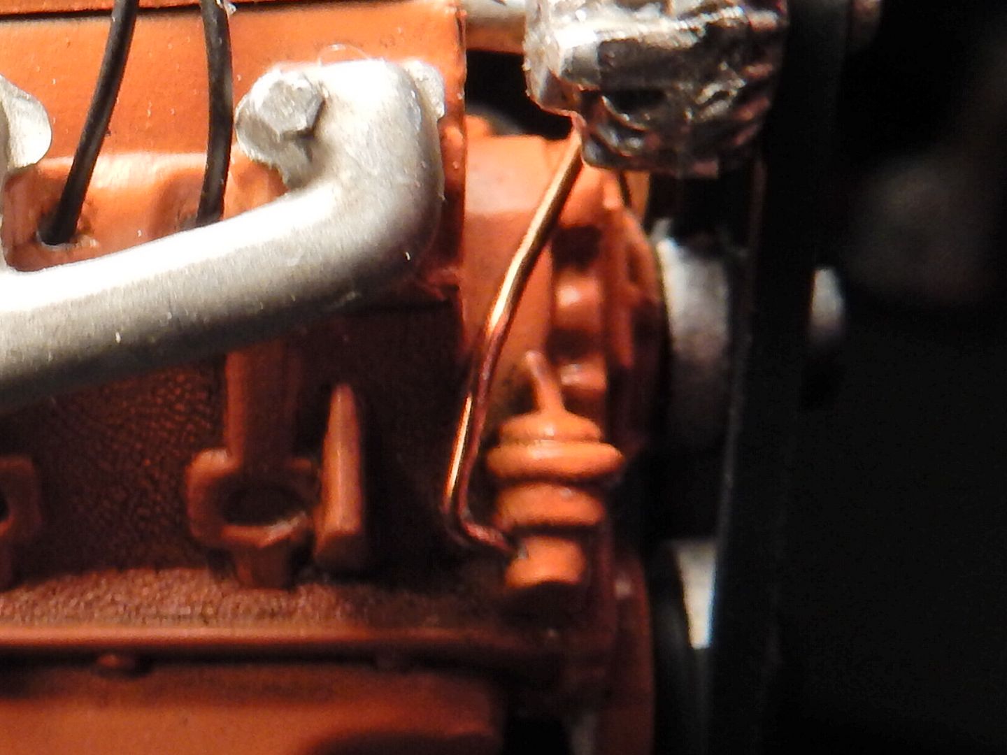

mustang1989 Posted December 21, 2014 Author Share Posted December 21, 2014 (edited) Thanks Dan! I had to make some tweaks this morning so that the air cleaner would fit over the wires and got that behind me......thankfully! Carl: Thanks for your comments too and yes I airbrushed them. Although I'm happy with the outcome of the wheels , I think I'm going to use Jim Daniels method of brushing the Model Master Metalizer paint on next time around. Ok for today's update. I only had about an hour this morning at the bench but I did manage to get started on the fuel line. I used a piece of solder to form the shape of the line initially and then used it as a template for a more rigid copper wire. The fuel filter is a piece of resin stock I had laying around. I simply cut the length I needed and drilled a hole through it and ran it through the copper wire halfway through the shaping process. I still have to clean the filter up and re-tweak the fuel line in a couple of places....namely the line to fuel pump connection but here's where its at right now. I've got plans for the other two branch off's at the carbs. Then there's the shot at the fuel pump. I don't like the fact that when I'm working on one area it always seems like I end up bumping something or needing to touch up things but "it is what it is". I knocked the alternator wiring loose at the back of the alternator. I aint touchin' it for repairs until I get this and the heater hoses done. Edited December 21, 2014 by mustang1989 Quote Link to comment Share on other sites More sharing options...

mustang1989 Posted December 22, 2014 Author Share Posted December 22, 2014 Not a HUGE update but all I had time for this morning. I broke out the Dremel and went to work on the fuel line tee off's to each carb. I made the 90 degree turn to the carbs and tapered the tee off at the main inlet line connection/ merge to fuse it in and make it look more like part of the line assy. Quote Link to comment Share on other sites More sharing options...

mustang1989 Posted December 23, 2014 Author Share Posted December 23, 2014 Ok folks. I gave this fuel line my best shot. I'm sure there are others out there that could pull this off better and I may be able to do something with this a little bit when I get it back off the motor for painting but here's where I'm at now. I decided to use some good 'ol JB weld after cleaning the copper sections up of all the oils and what not from handling it. We'll see how it all pans out. Quote Link to comment Share on other sites More sharing options...
