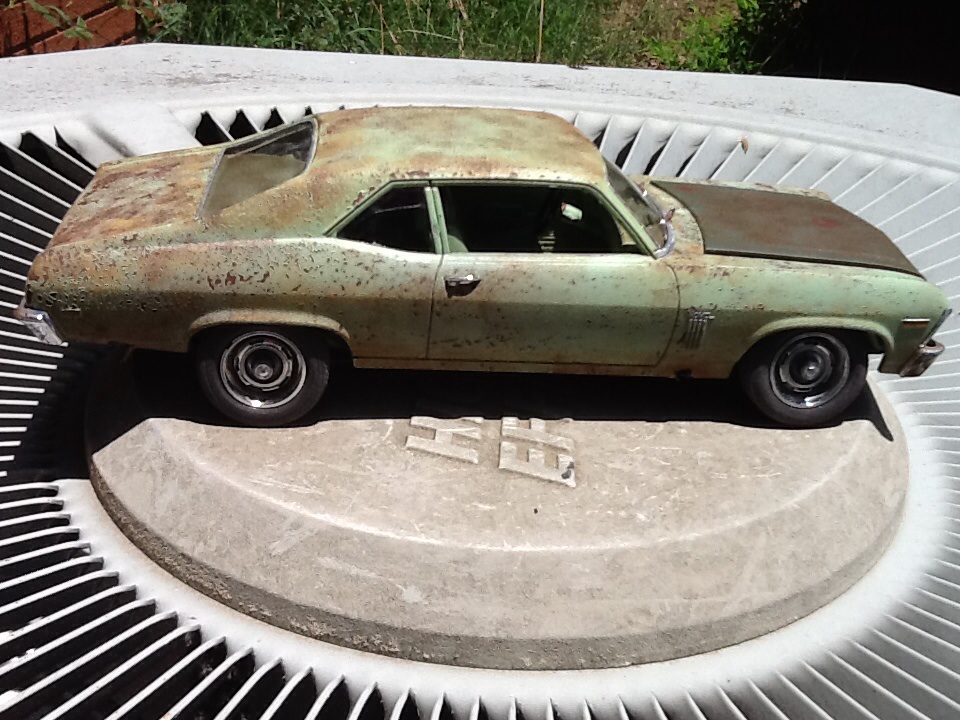

I let this dry for a few hours since its a flat paint, and once its dry, I put the body under cold running water and using the toothbrush, lightly scrub the salt off and you will have something like this...
Now once that air dries, I take some of my acrylic paint and a cosmetic spong and lightly dab the sponge on the acrylic paint and using a paper plate, I dab the sponge on the plate until the sponge is almost dry. Then I dab the sponge on the body ( think dry brushing)... Less is more ... I use the acrylic colors as described above...
When done it should look like this....

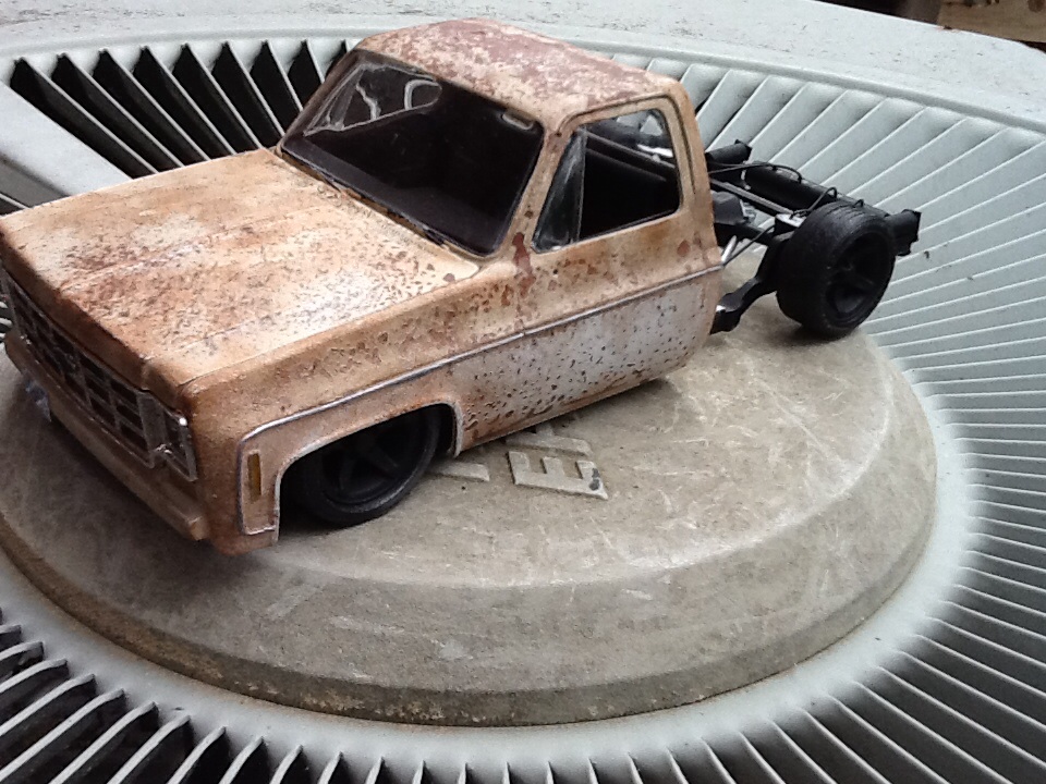

I just used this write up to do my first.....Must say its easy and fun! I have some pics in the truck section of the one Im doing....I was reading and debating and finally took a stab at it....Like I said pretty easy to do....practice on an old body or something before going full force
