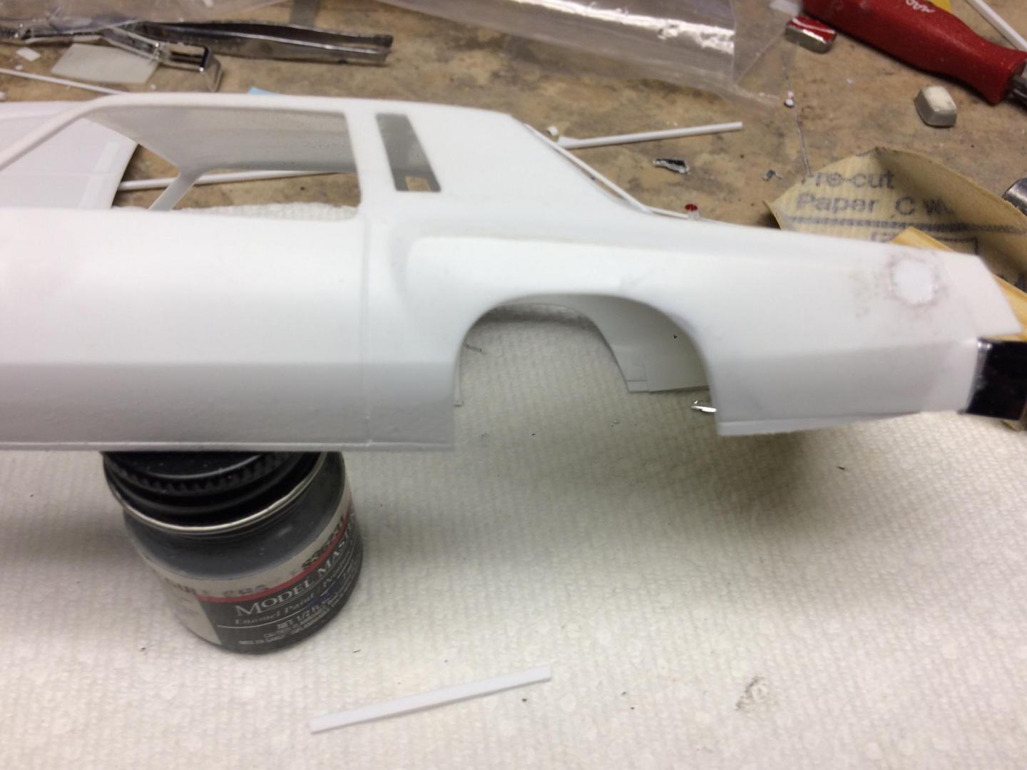

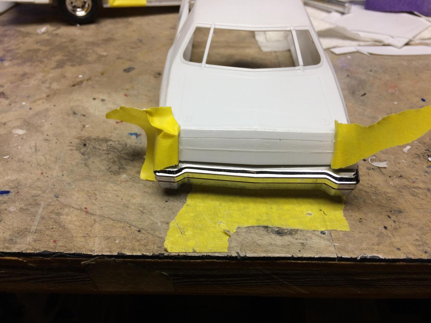

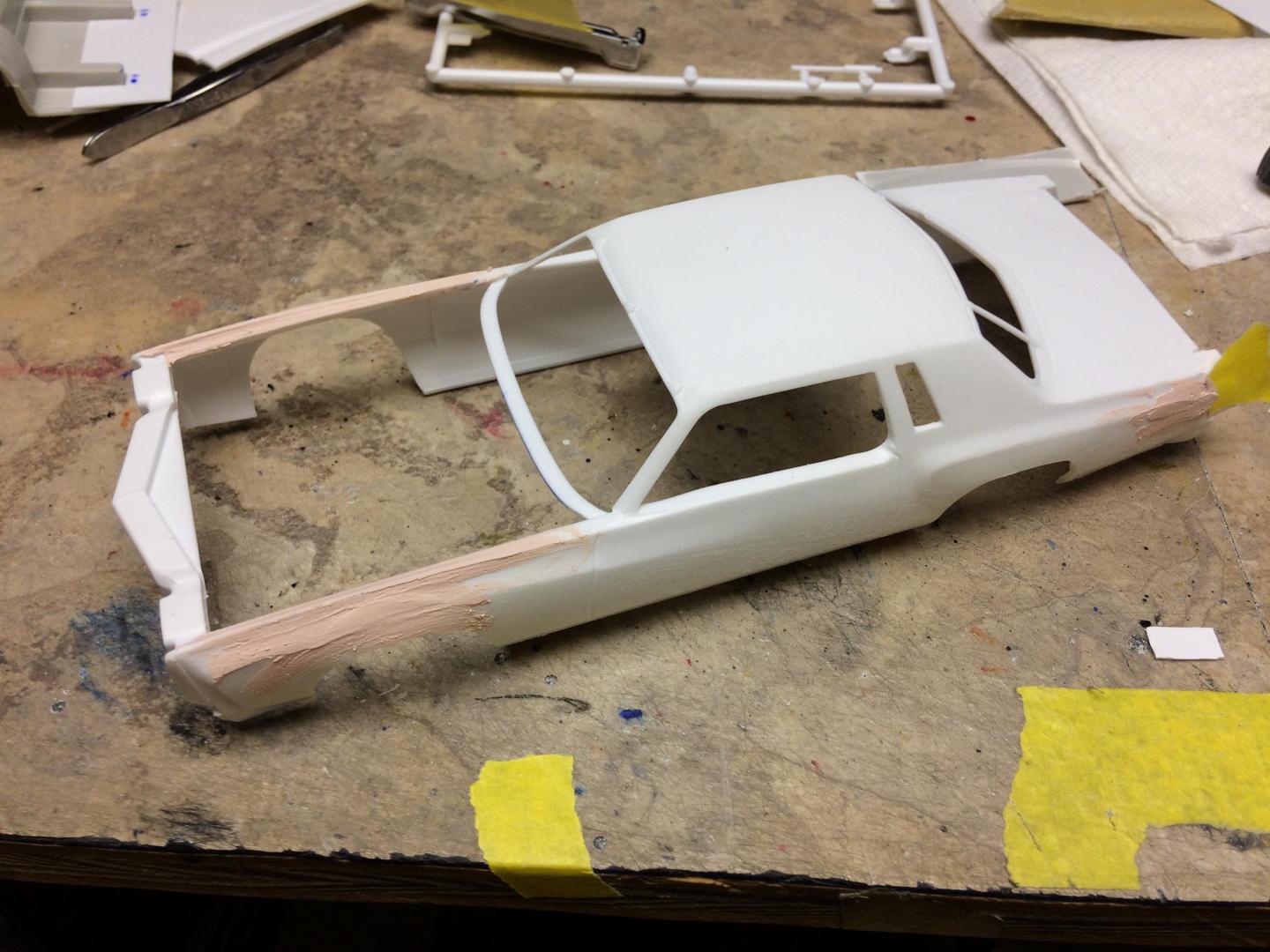

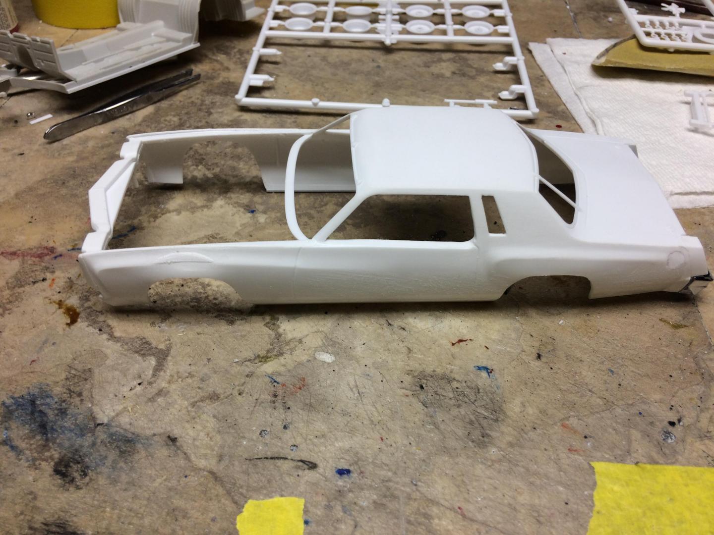

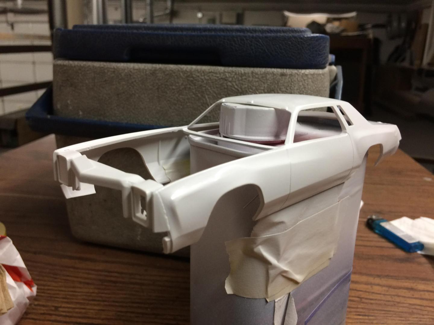

Next I puttied all that stuff up. Then I noticed the trunk was wrong for the car I’m doing. I had to fill the spoiler groove. I’ll have to make a spoiler. The kit spoiler wouldn’t work with the decals that have to go on the back of the trunk. Also the trunk had no seam where the trunk and filler panel above the bumper would meet. So I corrected that and added a fuel over flow to the right taillight cover. The top groove is where I added plastic to cover the spoiler groove. It will be puttied tomorrow.

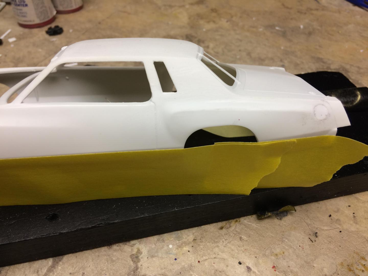

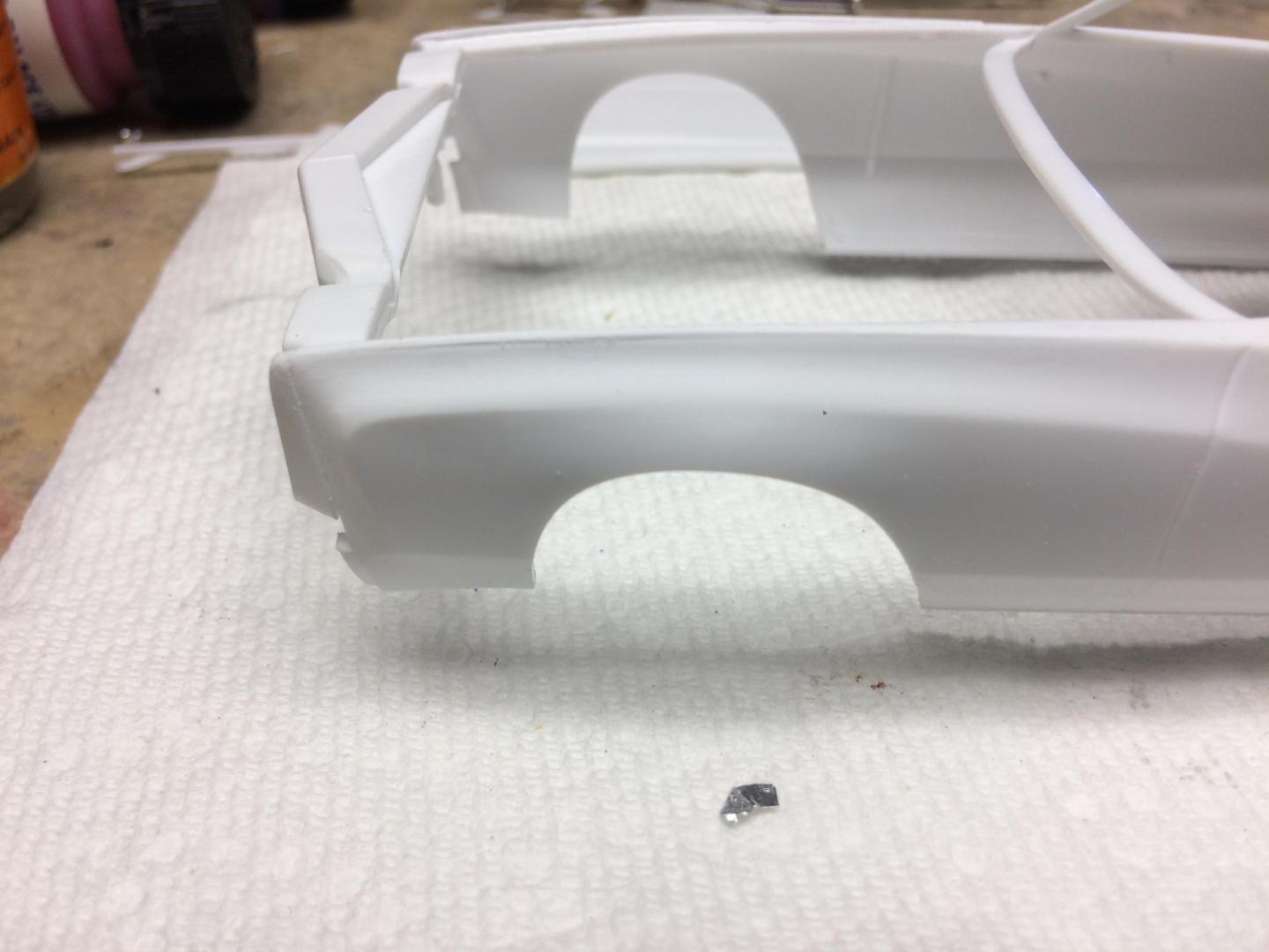

Now I added a strip of plastic to the bottom of the qtr behind the tire. I felt this area was too narrow top to bottom. Added a strip under the main body too. These cars had a small rocker panel that was missing on the Model. Also filled the fuel fill. Will be moved to the other side per road race car.

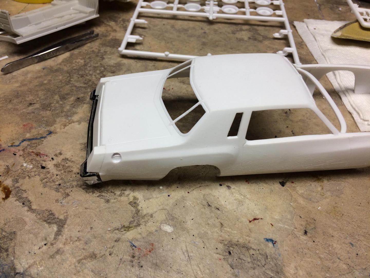

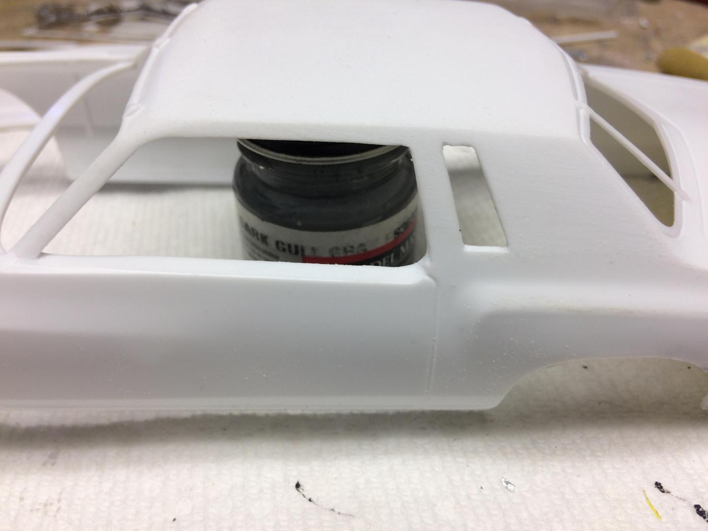

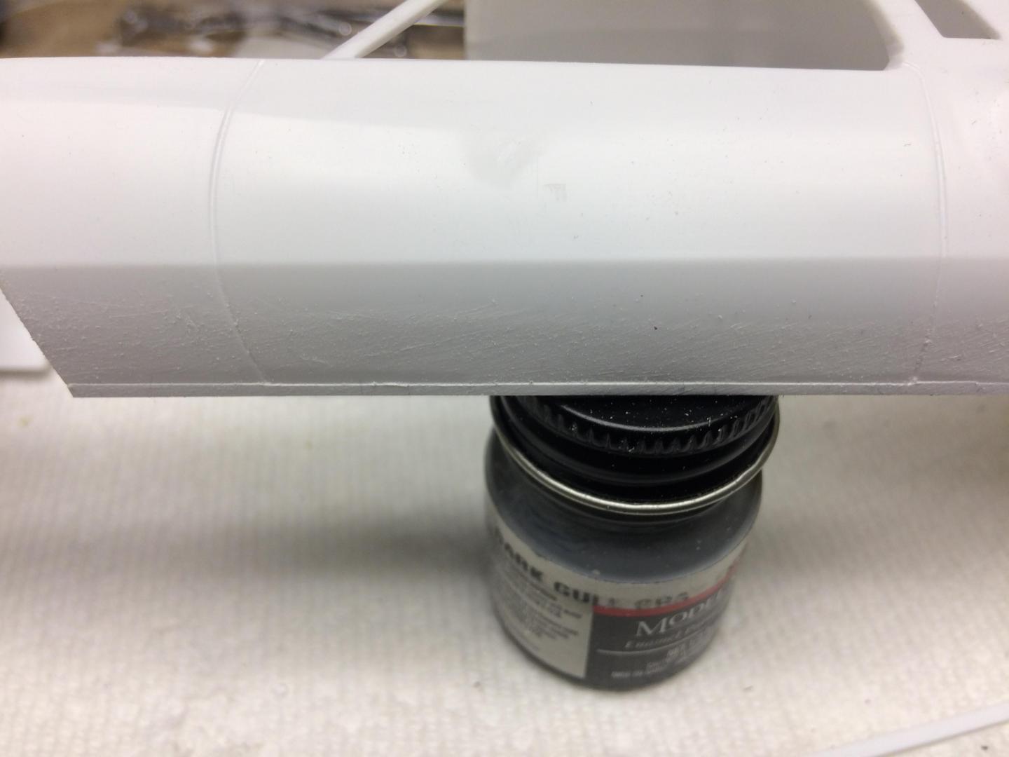

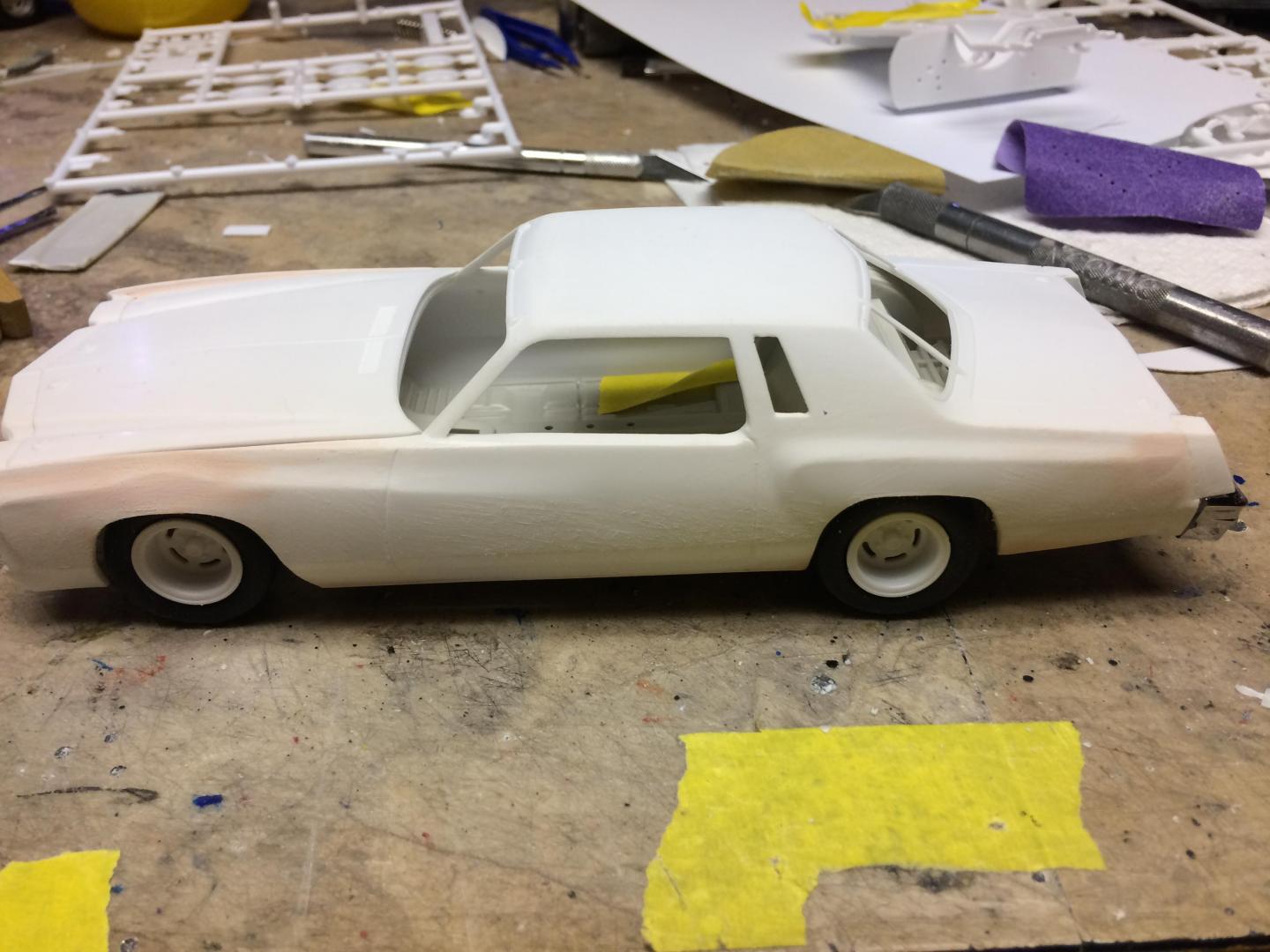

On to the body. This body never looked right to me. Most of its faults looked to be a sanding block away from correcting though. First is the side window area. I brought the door window opening up to be even with the opera window. Next I brought the back of the door window opening back to be even with the door crease. Leaving a swoop forward at the bottom like these cars had.

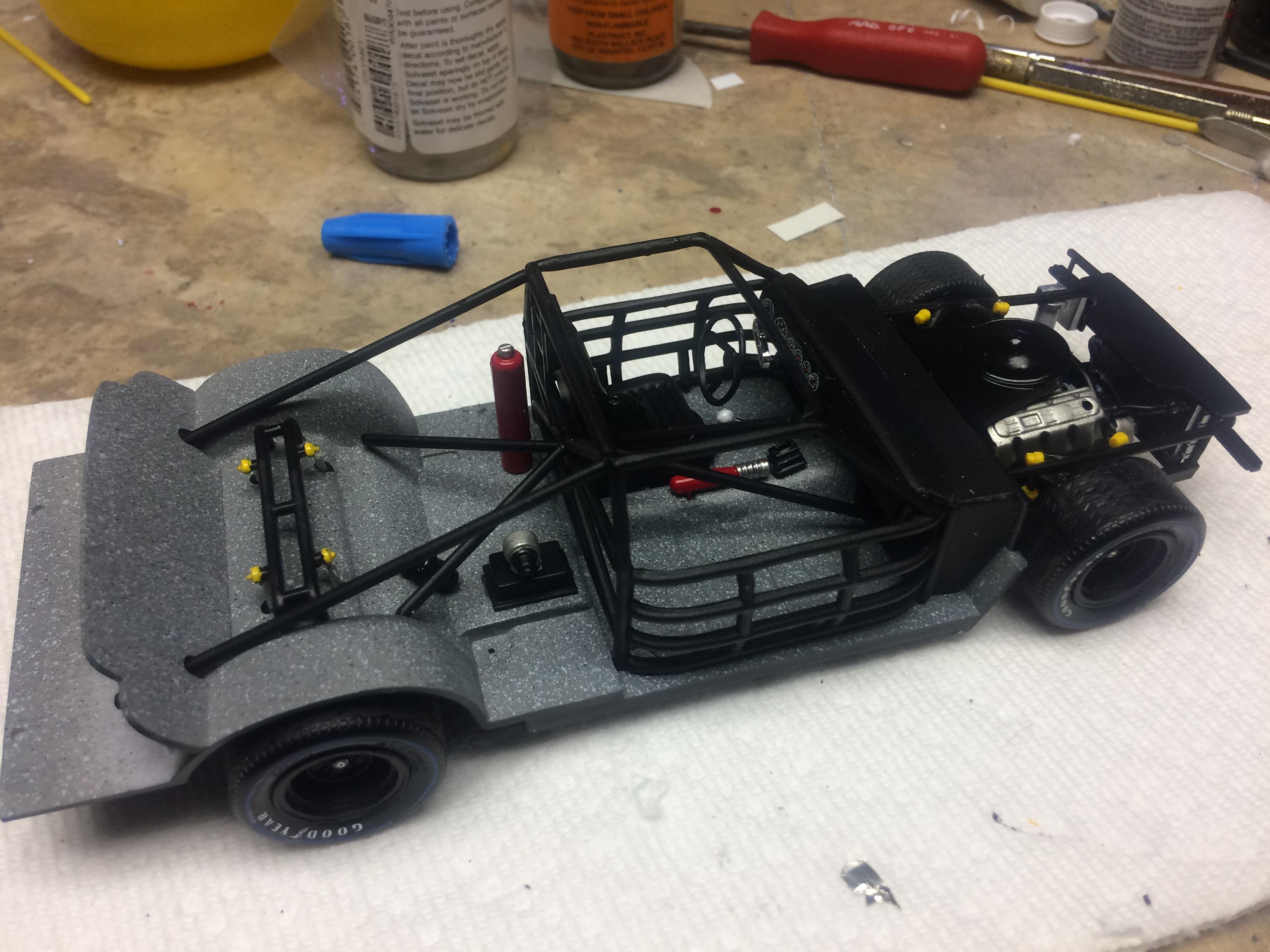

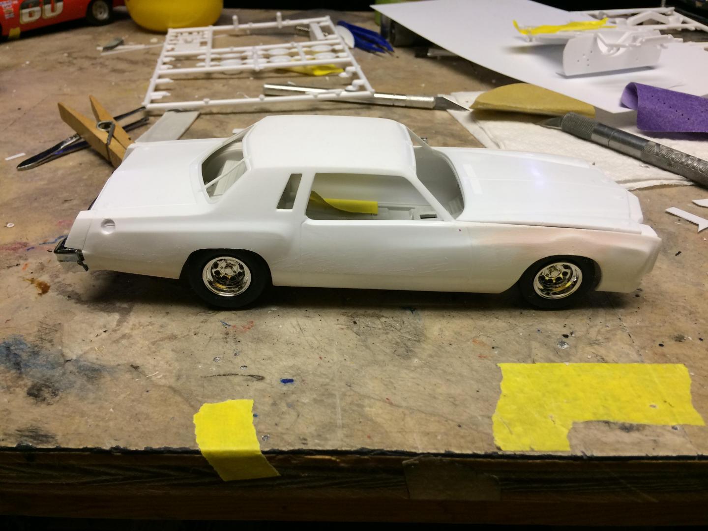

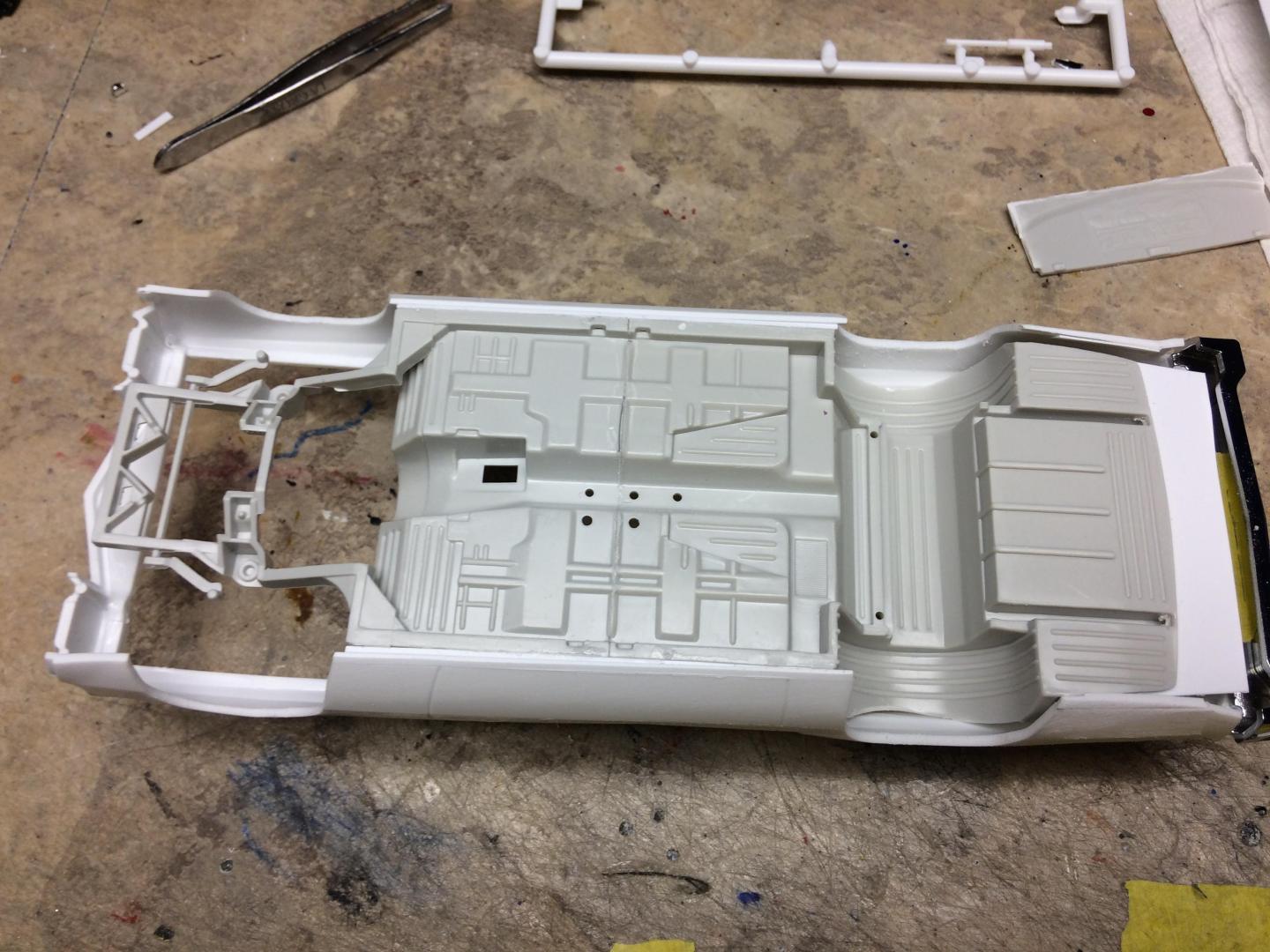

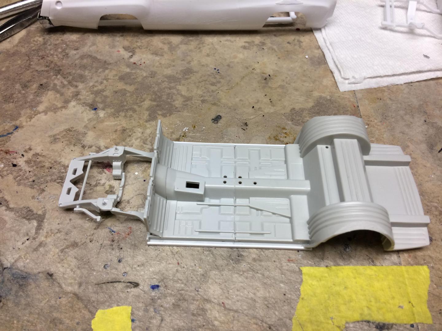

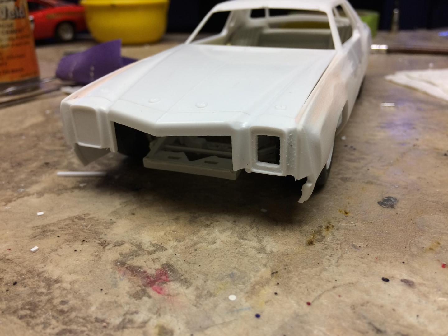

So this started as s Salvinos Baker Monte Carlo kit. I planned on modding the body a little and building it mostly out of the box. Well things changed quickly. I mocked up the kit chassis and said”I really don’t like the looks of this chassis.” So I looked at my old standby AMT TBird chassis. The way I usually stretch them didn’t look like an option. So I cut two in half in the middle and stretched it that way. Good thing I had a spare bare chassis laying around.
