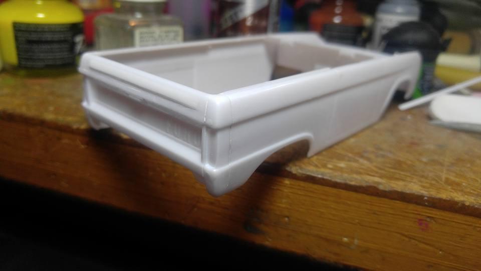

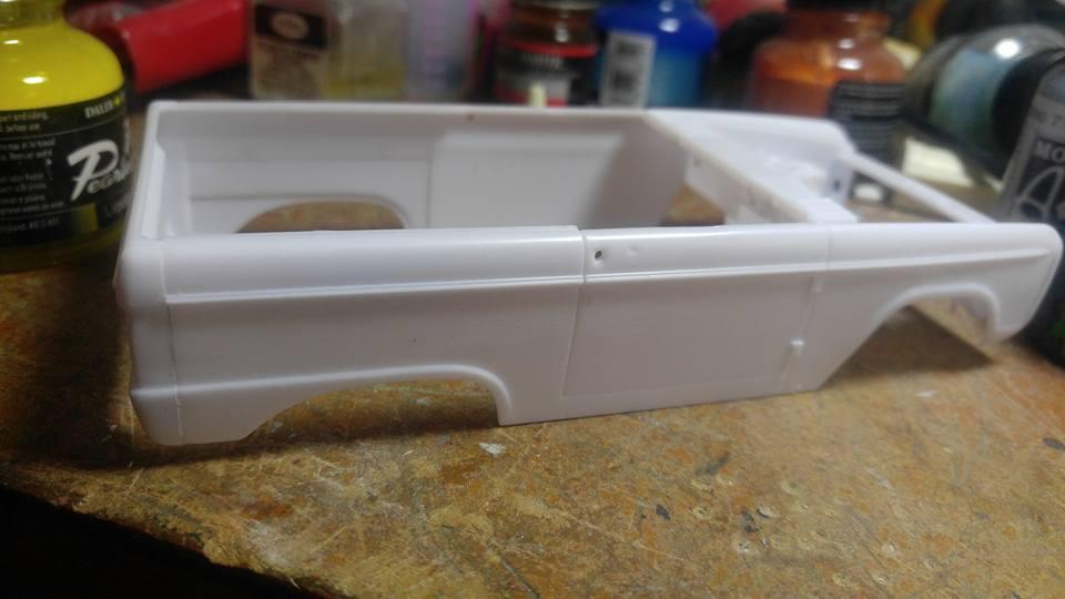

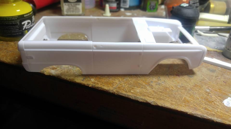

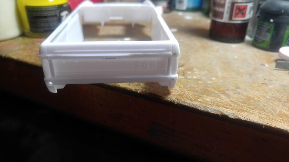

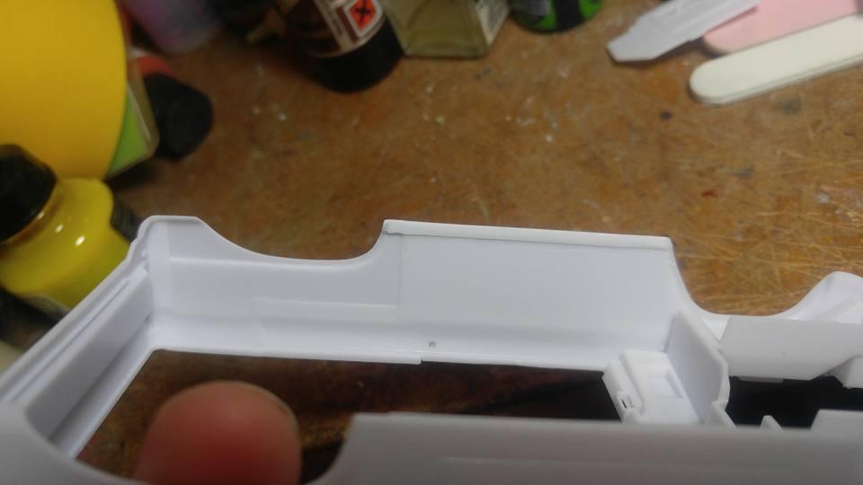

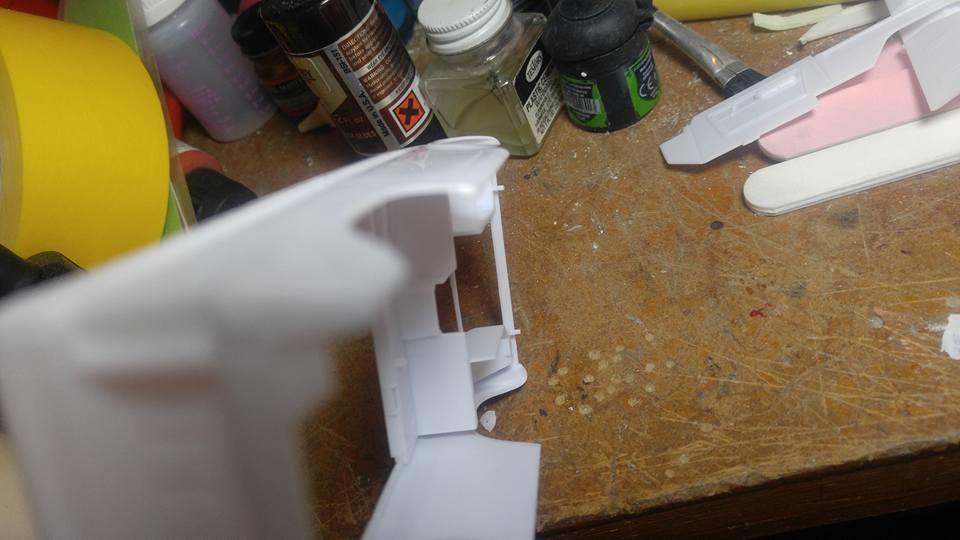

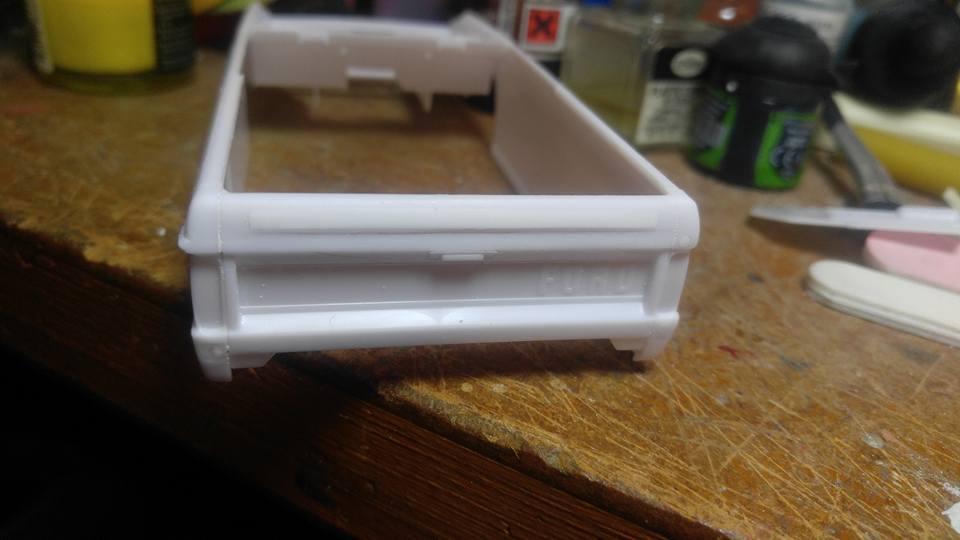

Here is my progress so far, I removed the beltline trim, marker lights to make the truck pre '68. Started removing the marker lights removed trim, hinges and marker lights filled in door handle mounting point, swing away spare mounts and filled in holes beneath tail lights rounded off rocker panels and added material below

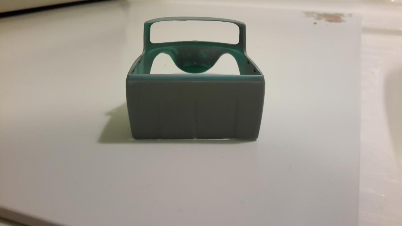

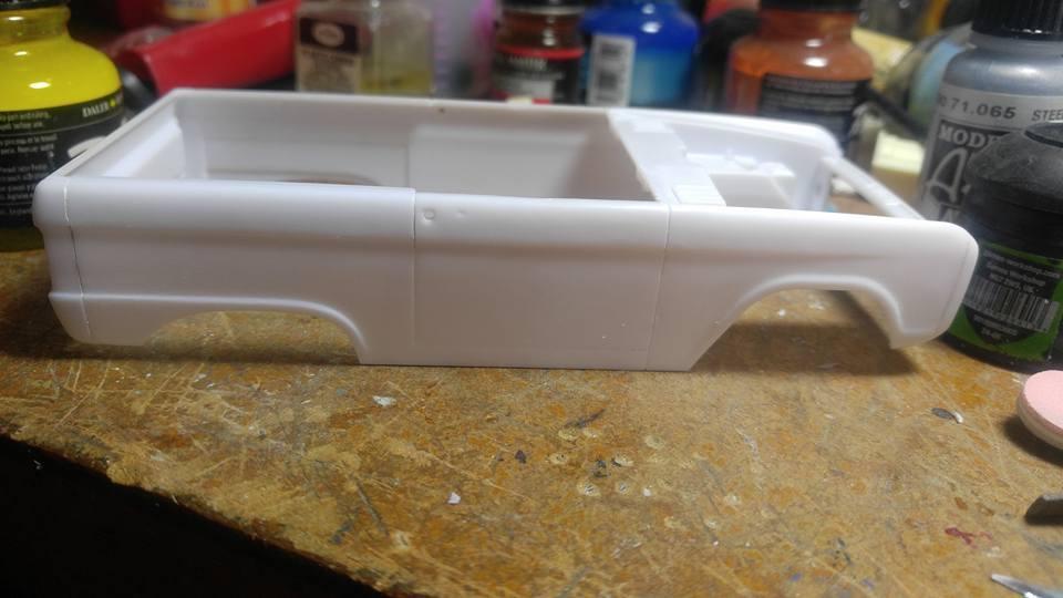

I decided to remake all body reveals and I used Evergreen strip for the top of the sides and on the rear of the cab. I went to my local Maker Space and used the laser cutter to make the new raised door panels. The details can be seen in white plastic. I also ground down some ugly tooling blobs on the inside of the body. The original kit has a tub style interior ad would cover that. Since I do not know what I will use for an interior yet, I smoothed it out. I also smoothed and filled / molded the cowl.

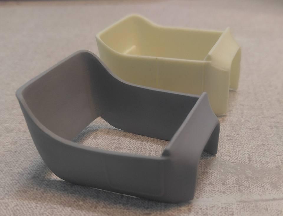

I am going to call it now, but I think the next big phase will be 1970's Resto Rods and Fad T's. I have seen a bunch of 1970's rod and custom barn finds show up in popular magazines and on Facebook. I have bee following the large scale Carl Casper Phone booth T on this site and the late 60's and early seventies are getting a lot of attention. I dug out of my stash my Tognotti King T and did some research that a lot of the Fad T's were based on the 1915 glass body. The King T is a supposedly stock bodied 1915 T... Wit a little bit of mold making magic I made the cab and turtle deck. I then proceeded to chop up the body to follow the famous Leg Show T. I cut behind the doors straight down. I cut the top of the body off front of the cut. I removed an additional 6 scale inches and re glued the cowl on. I made a template of the new curved sides and matched the back to the new, lower body sides. I shot a picture of a casting of the Tognotti T and my work. I am glad it took the pictures. This showed me two things, firstly the body sides were spreading out which I quickly straightened out. The second thing I noticed was the body leading edge sloped upward on the passenger side. Both the original body and my project body had it so i adjusted the body to even things out. I had to remove the body reveals and replace all of them.

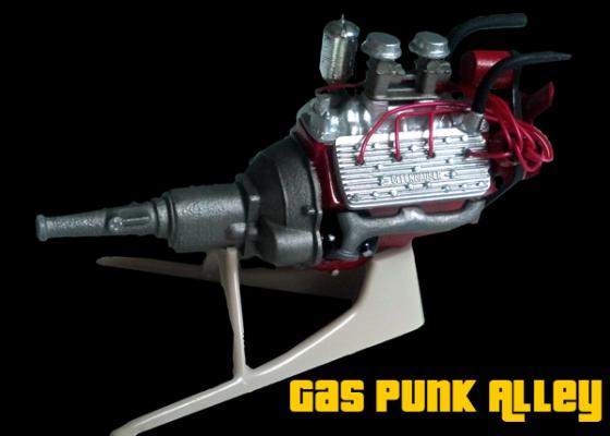

Doing more boring stuff. Filling in seams on the engine block. I also removed the upper bell housing from the block and attached it to the transmission assembly. A lot of fiddly seams to deal with. I am now able to get the transmission to fit better against the block. Still doing some clean up on the frame rails as well. -
