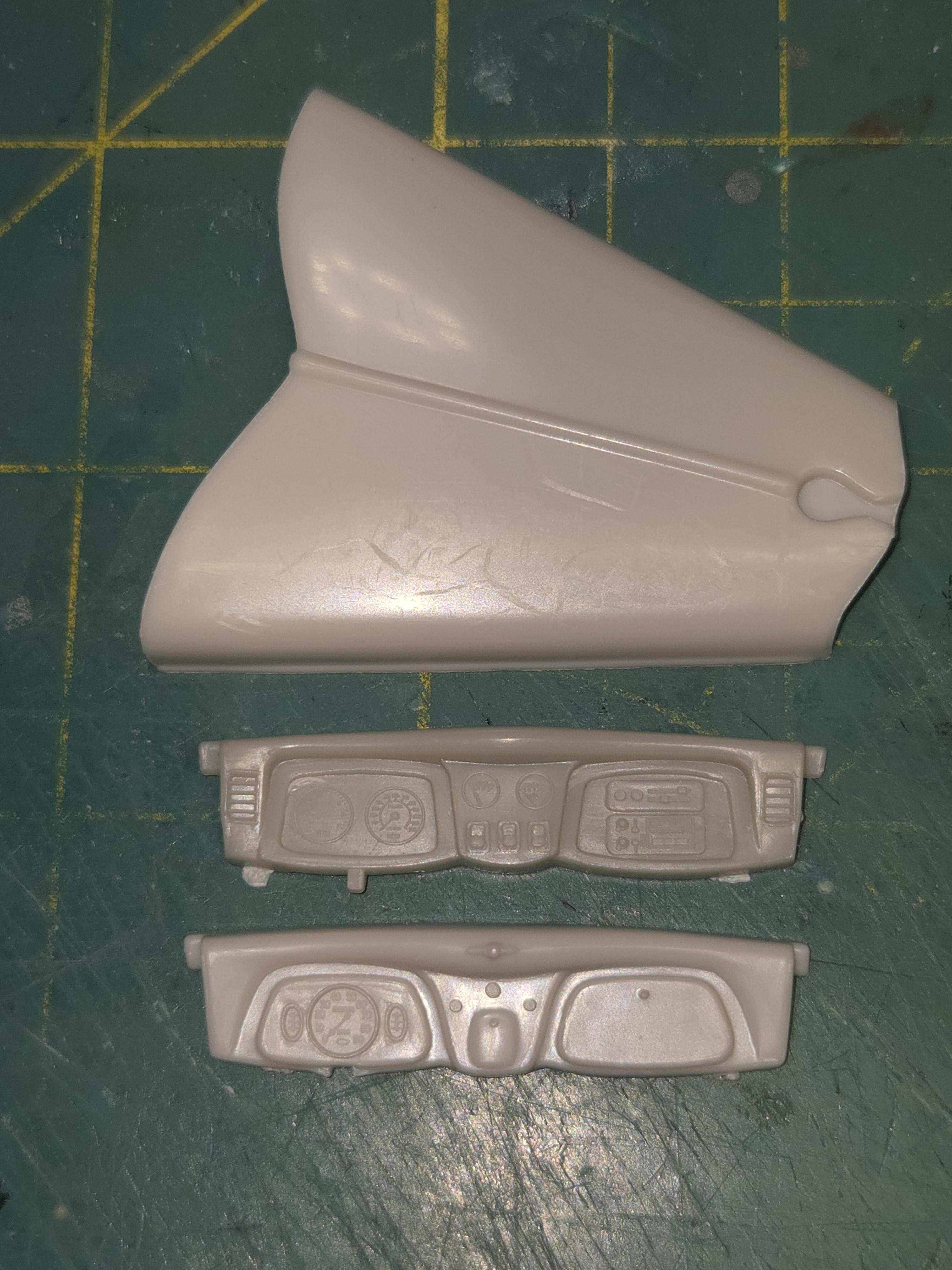

  1. I came up with one of each style of dash, stock or street rod. And found a hood, its got some very minor scratches on the right side. I bet they disappear after a very light sanding and first primer coat. Tried to get them to show a bit in the picture. Any chance you're using the street rod kit and not using the Chevy small block?
