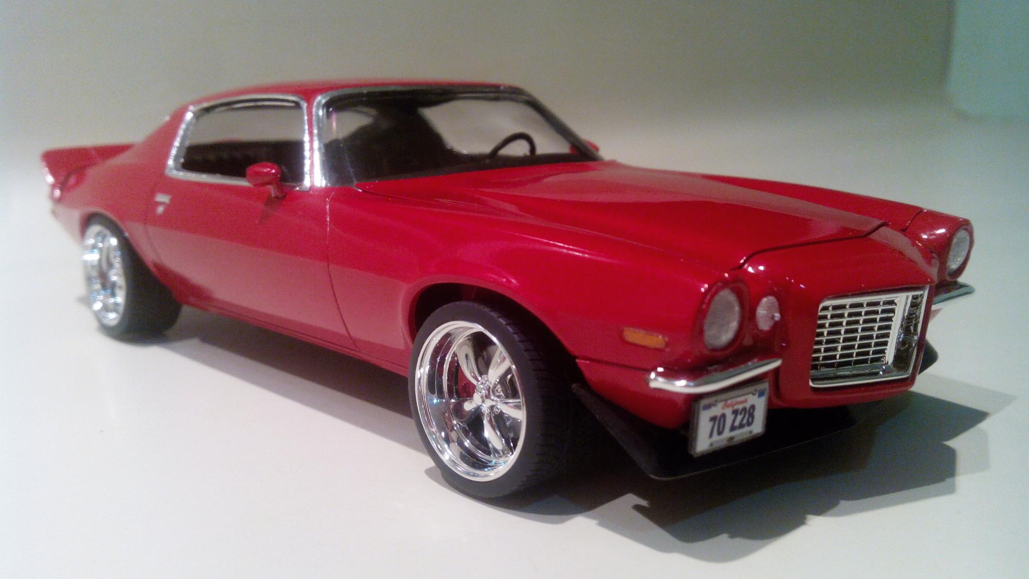

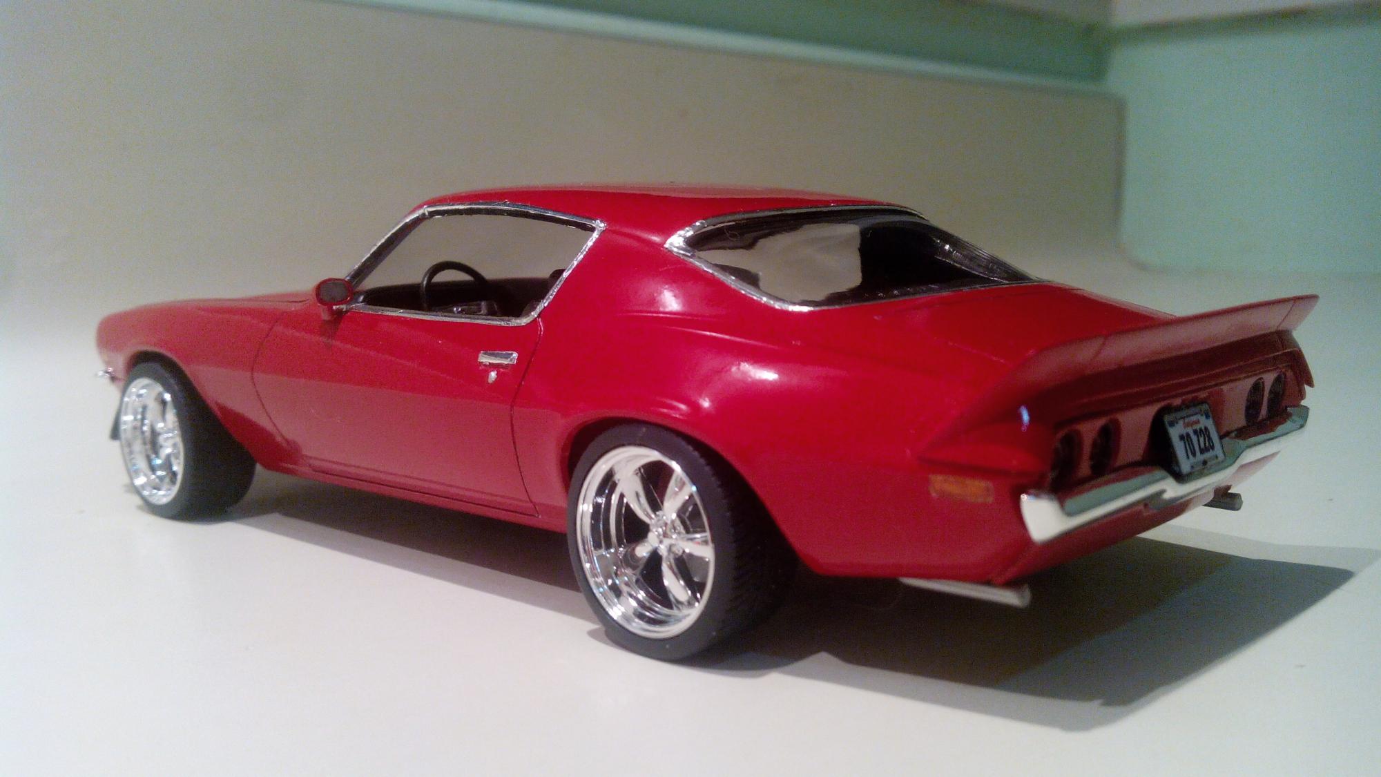

  12. Heres my 1970 Camaro. It has Pegasus wheels and a resin rear spoiler.
