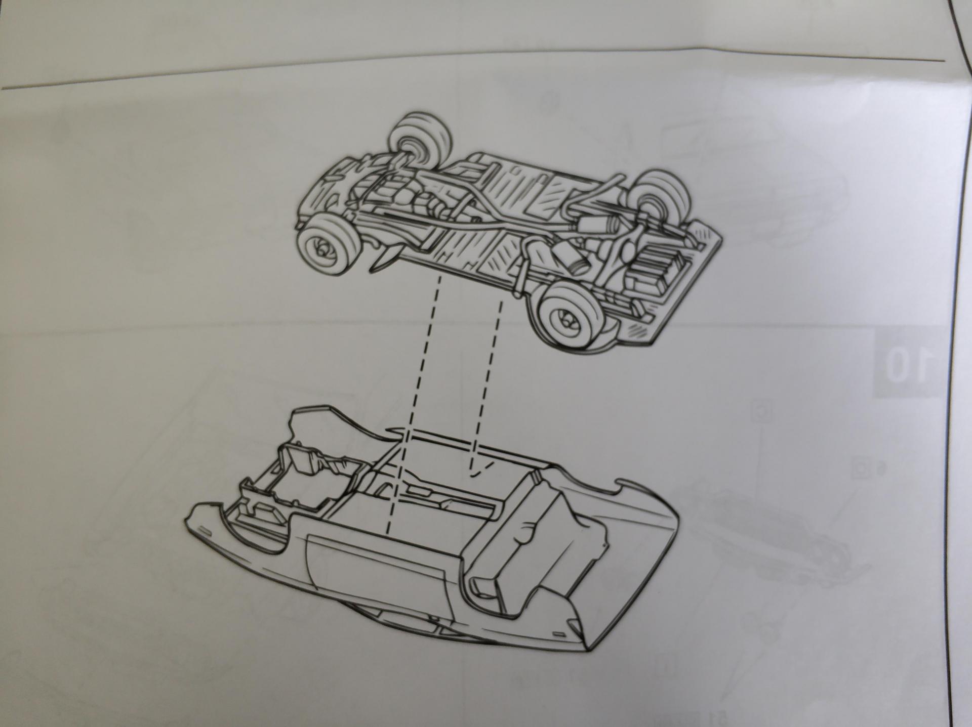

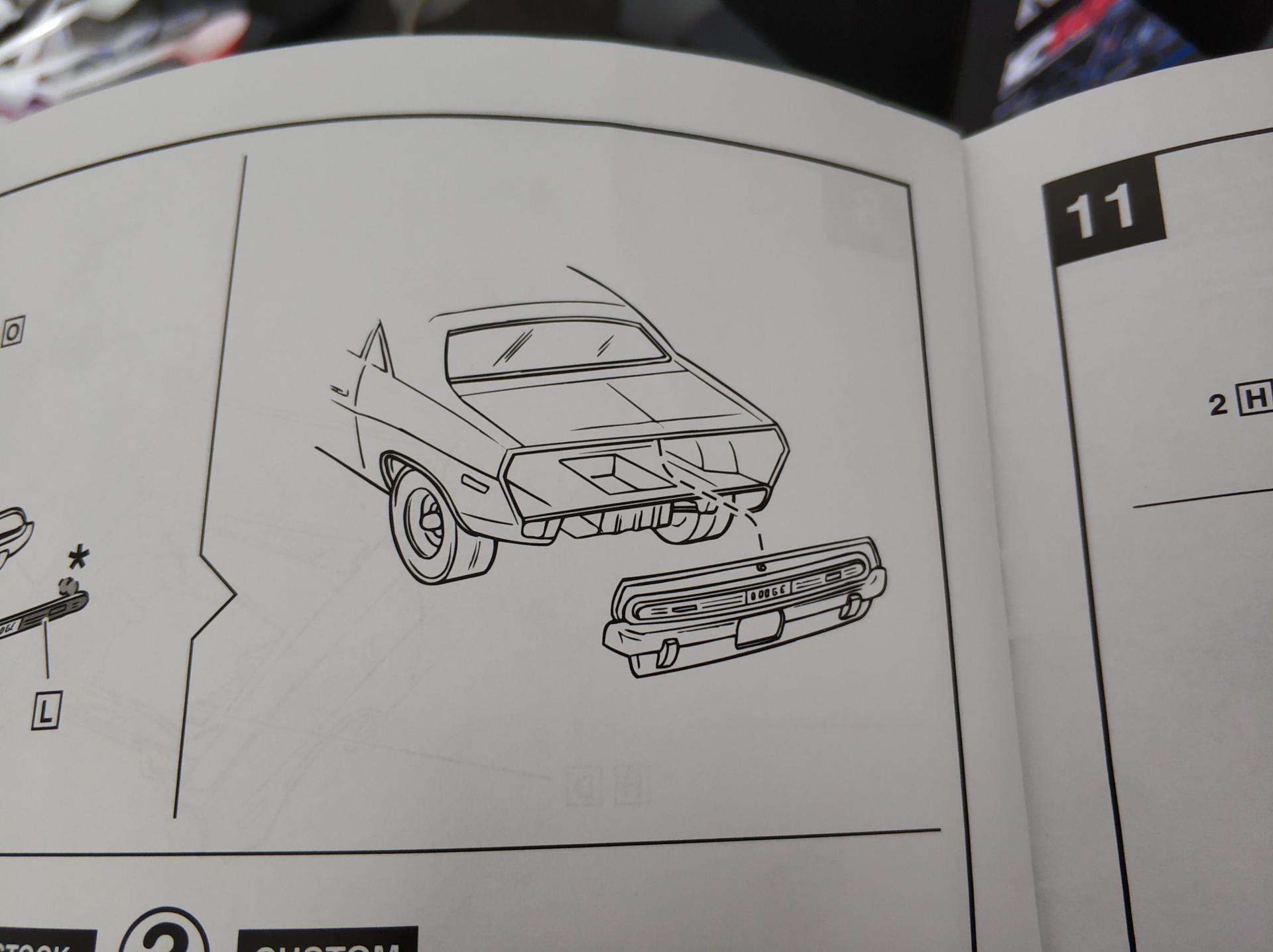

Gidday, just looking at David Thibodeau's Sam Posey Trans Am Challenger, it seems like he attached the front and blended the guard before painting, but possibly attached the rear after chassis fitment. On my build I have actually cut the lights and grill from the front bodywork, because that area would be fairly hard to mask if glued in place. I can paint it black, add details and then glue it in place after. I think your idea is good to cut away some of the fenders on the chassis to make fitment easier. Thanks for the idea. Mike -
Gidday, I was wondering if you had to attach the body to the chassis per the instructions without the front and rear light/grill/bumper assemblies, or whether you could attach them first so the seams could be smoothed and painted as one before assembly onto the chassis. See attached photos thanks very much Mike

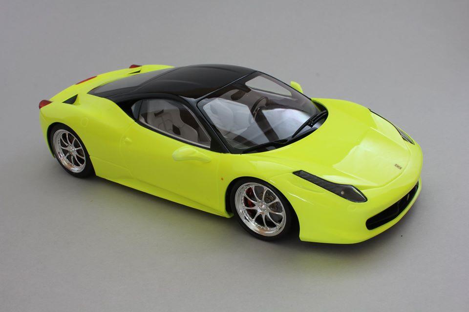

The paint is gaianotes fluro yellow with 2k clear over top. Thanks
The exhaust tips are actually just the kit plastic ones, but do look pretty good. Thanks

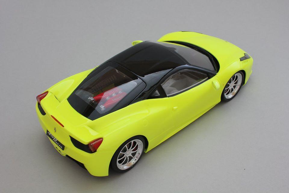

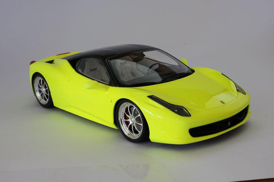

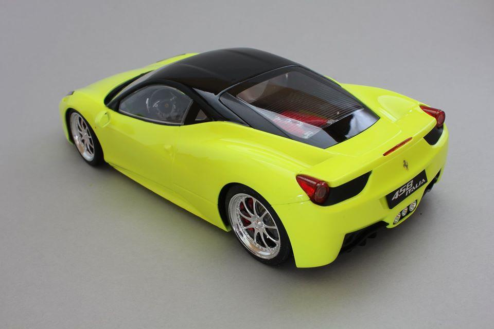

Fluro yellow paint (not showing properly in pics), 2k clear, carbon fibre roof decal, lowered, Pegasus wheels.

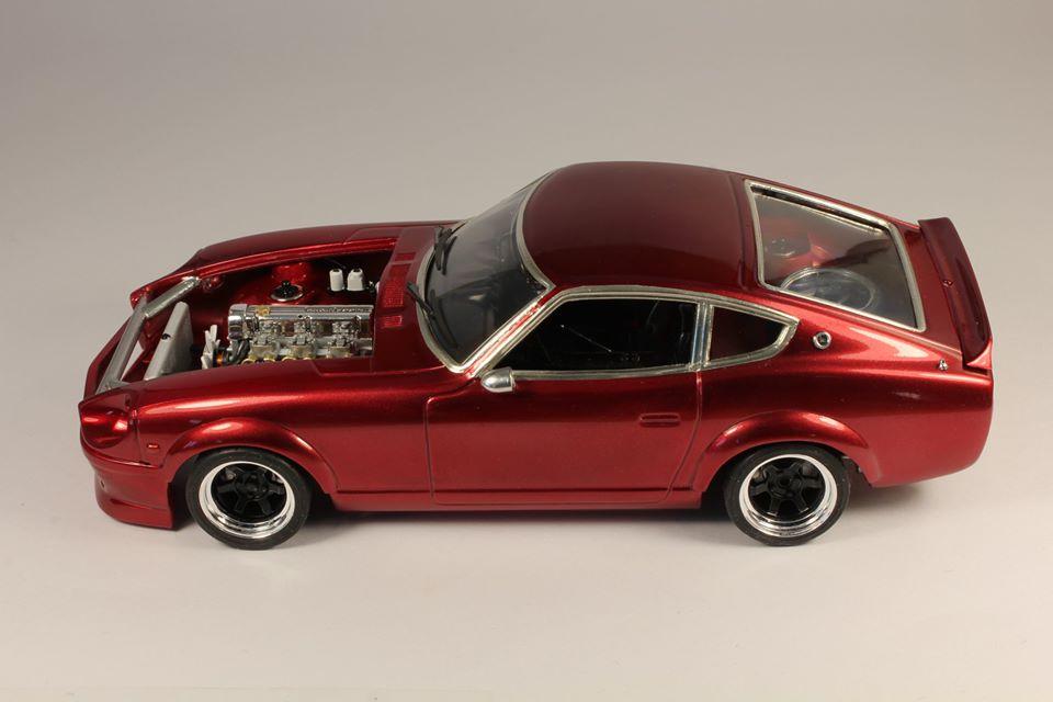

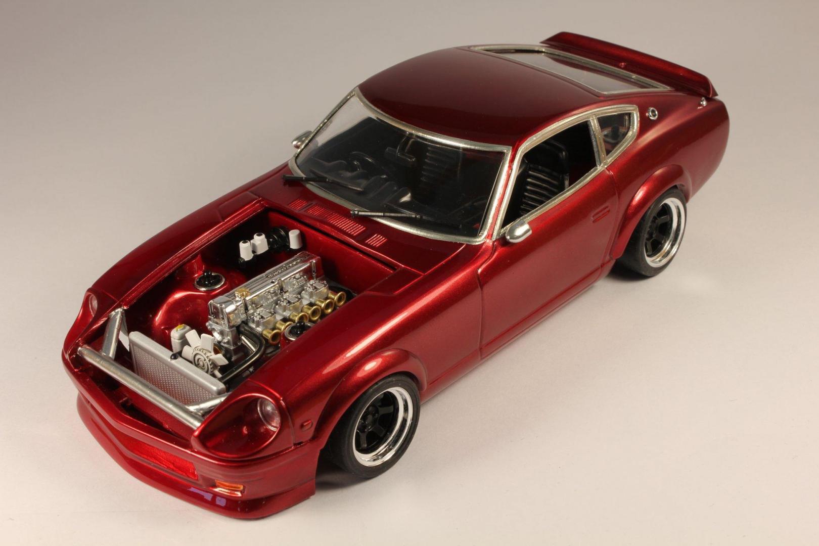

Finished a couple of months ago, cut out bonnet, nail polish paint, with 2k clear. Asuka wheels/tyres. Lowered etc

To be honest the above paint finishes are not perfect and do have dust etc in the paint. However for the amount of effort involved and lack of any risky sanding, they strike a good balance. Especially with 2k clear, you generally can just follow the instructions and as long as you get it wet enough on the final coat, you will get this kind of finish consistently.
I don't bother with sanding. The most important thing is to apply the base coat/clear in the best way possible to reduce orange peel. With lacquer this would be done with Mr Levelling thinner and also applying very wet without runs (very hard to do well) after some mist coats to tack it up. The photos below are 2k clear with no sanding - which is probably the easiest to get this kind of finish. So I guess my answer would be concentrate more on getting a good finish from the airbrush rather than the finishing products.

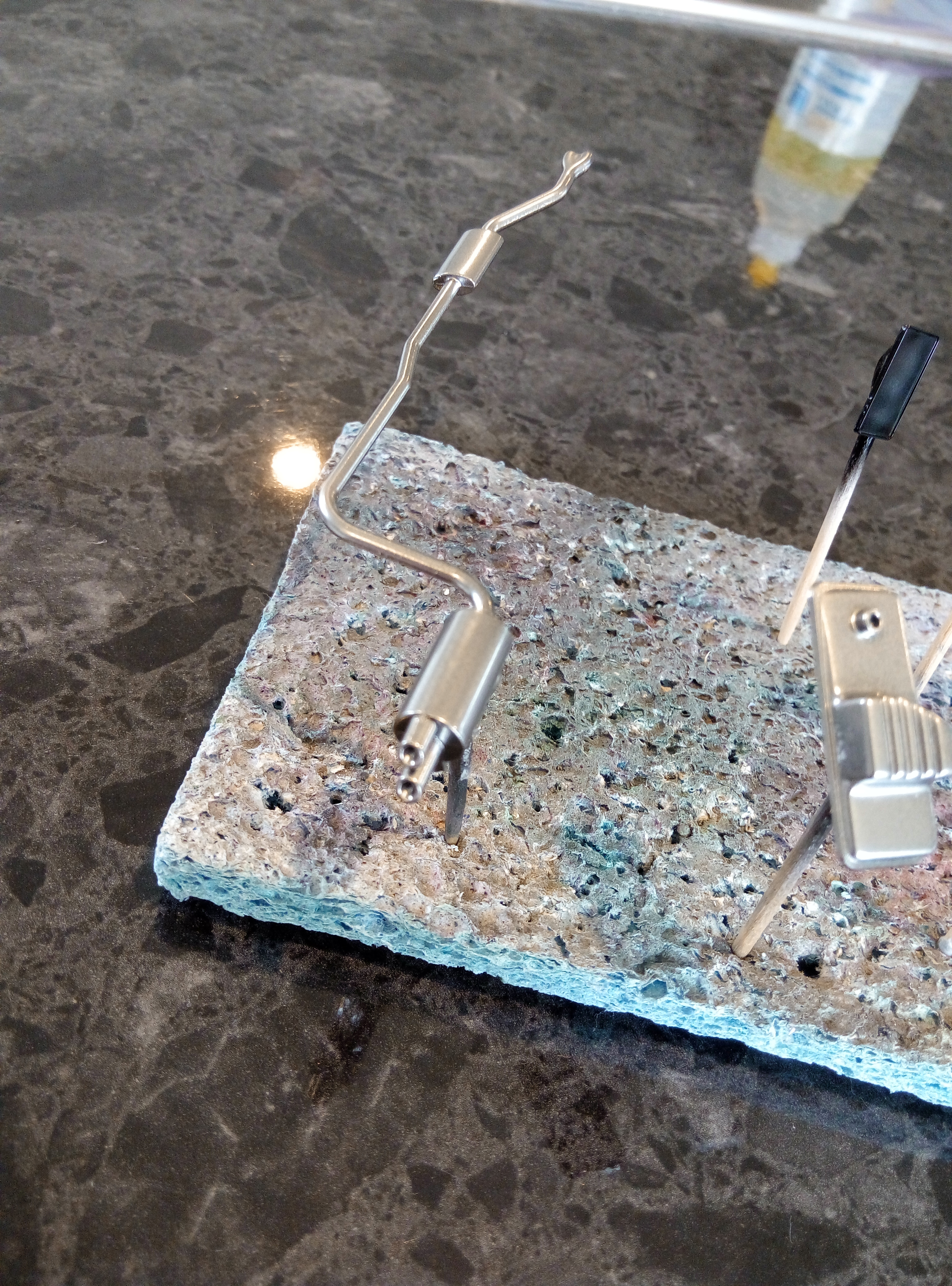

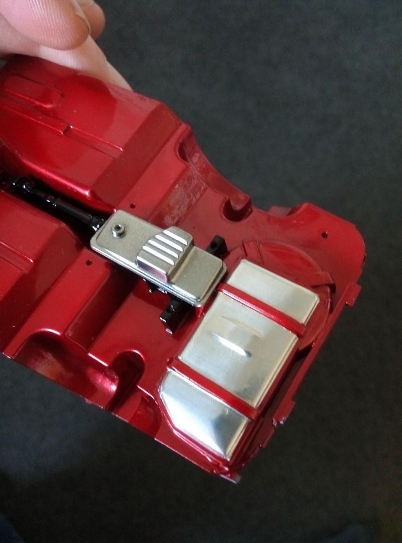

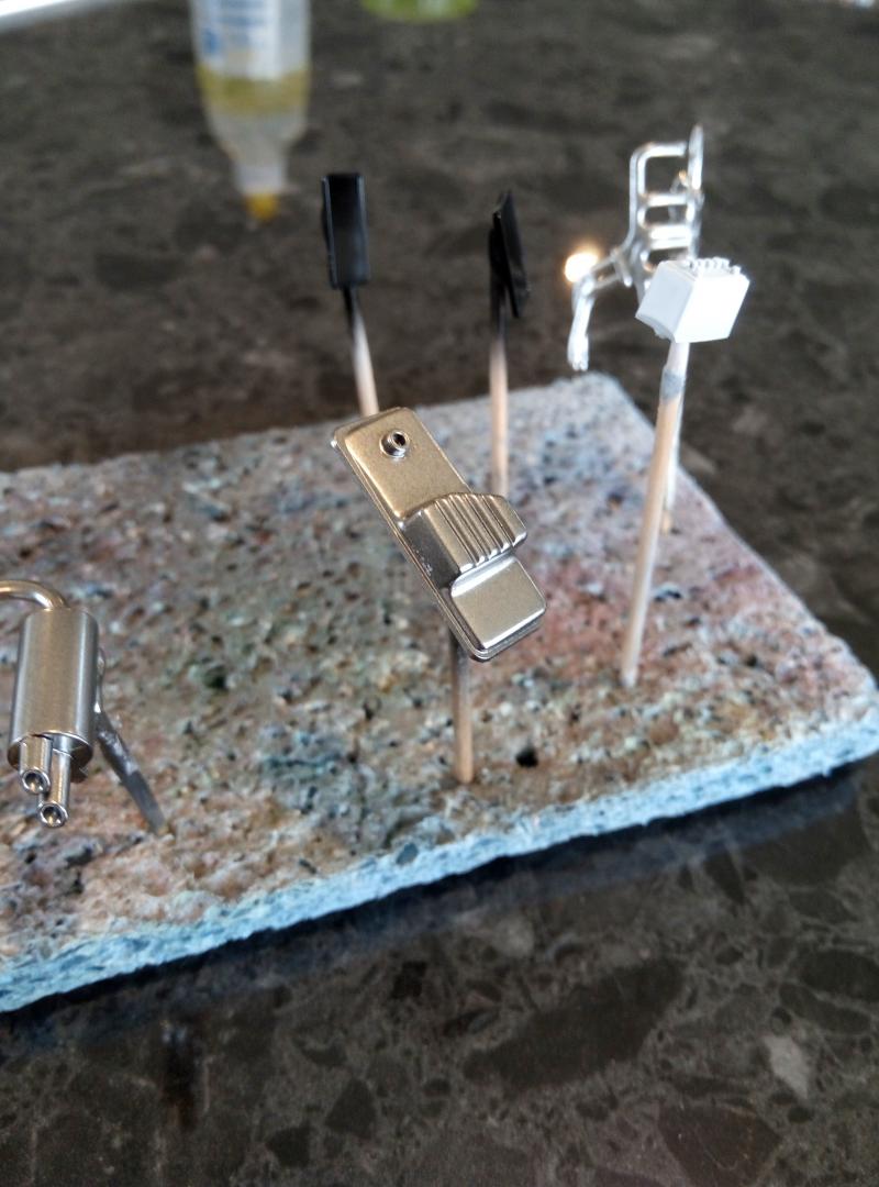

Hi guys, I tested the E7 paints shine chrome on a couple of parts. I think it came out looking like a good match for stainless steel. I also cleared the parts with their chrome sealer with no dulling evident. The photo of the chassis, shows the shine chrome on the left and aluminium foil on the right.
