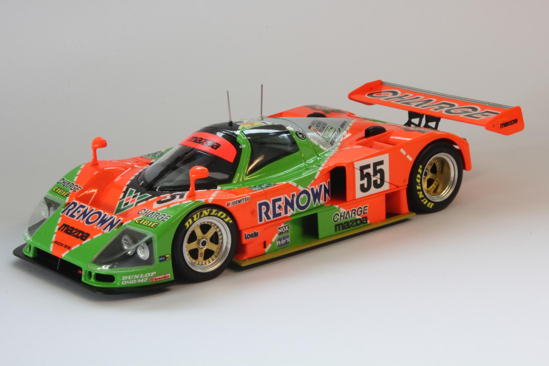

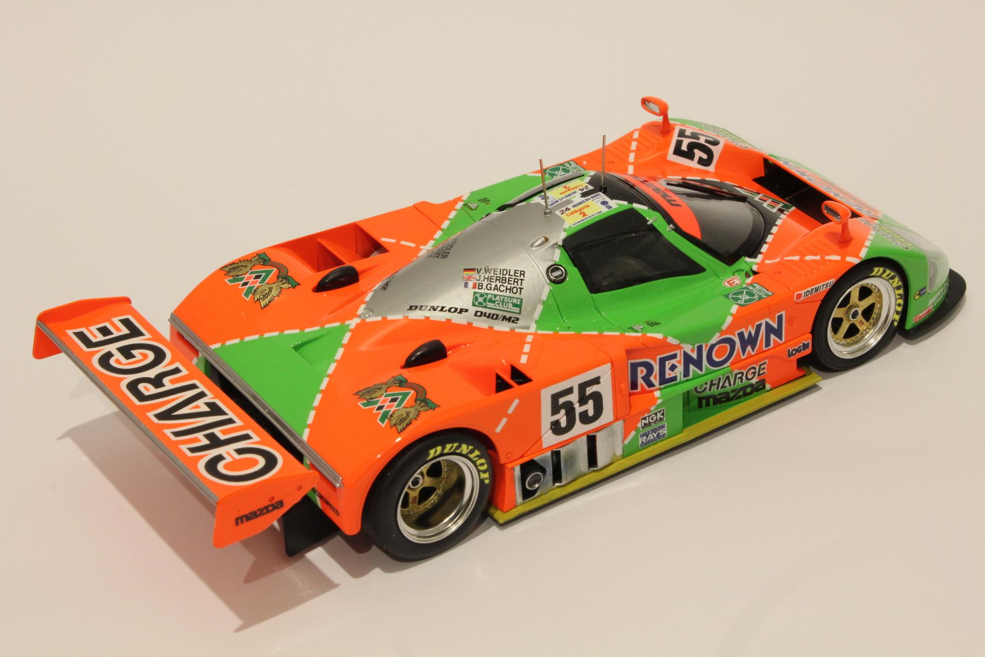

Gidday, I used Gaianotes fluro orange (basecoat was Tamiya Orange - cant remember the number), Tamiya light green TS22, Tamiya black and Alclad ALC101 aluminium. Then 2k clear, decals and then 2k clear again. The colours suggested in the instructions are way off BTW. Regards Mike

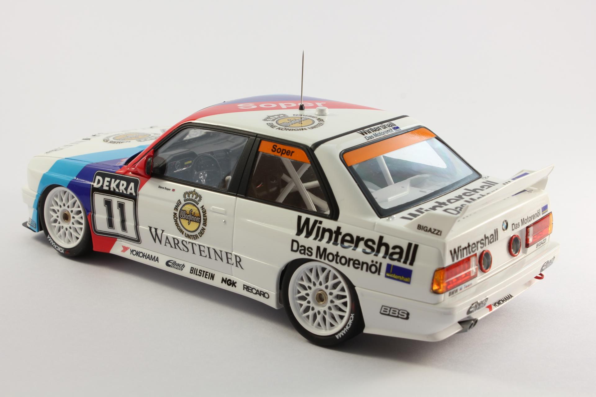

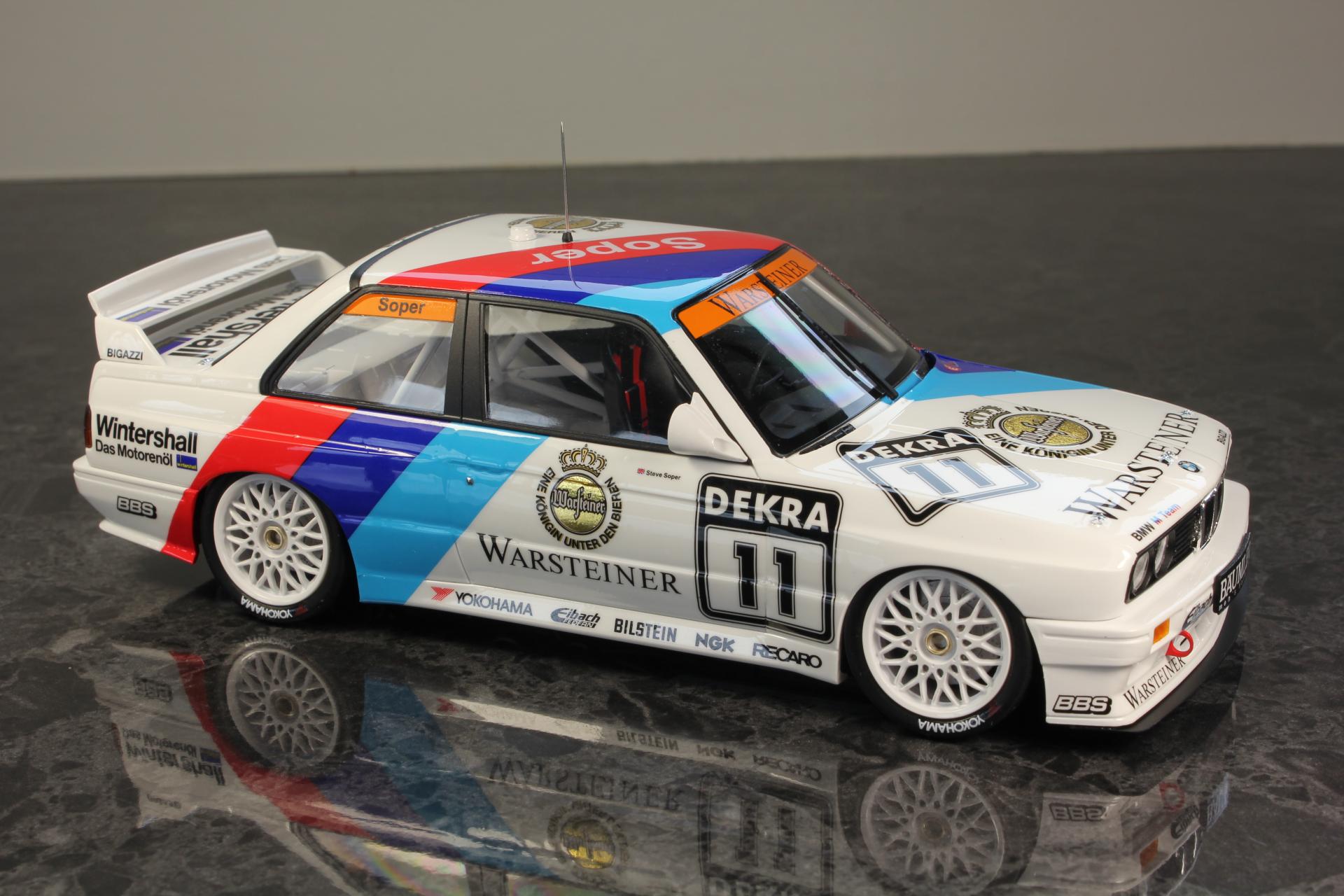

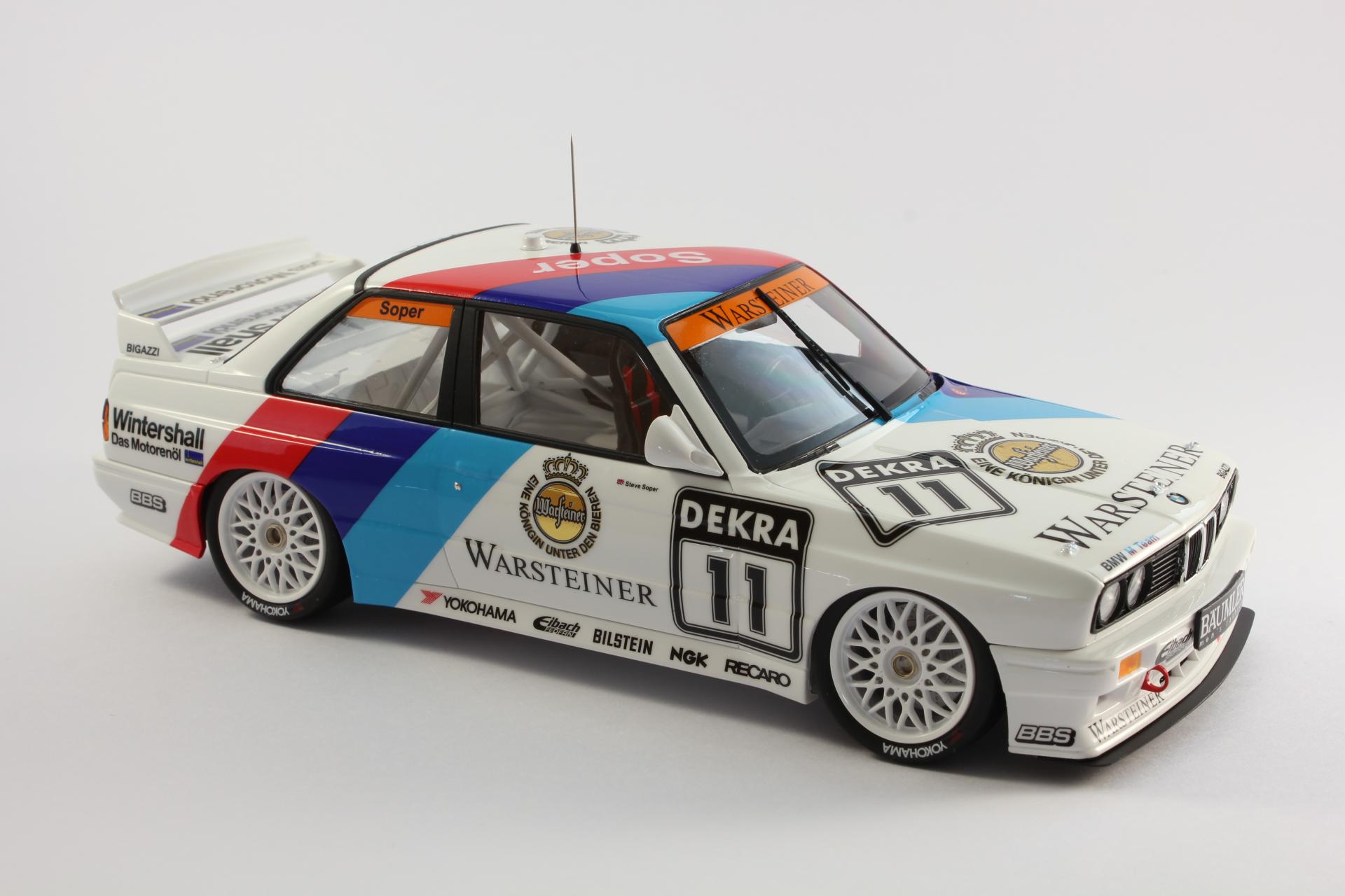

Gidday, Thanks for the comments. The decals were not so bad (a couple I had trouble with). All the colours were painted on btw. The main issue is getting the body onto the chassis at the front (warped), and also the wheelbase or gap between wheel arches are different on each side which was tricky to fix.
