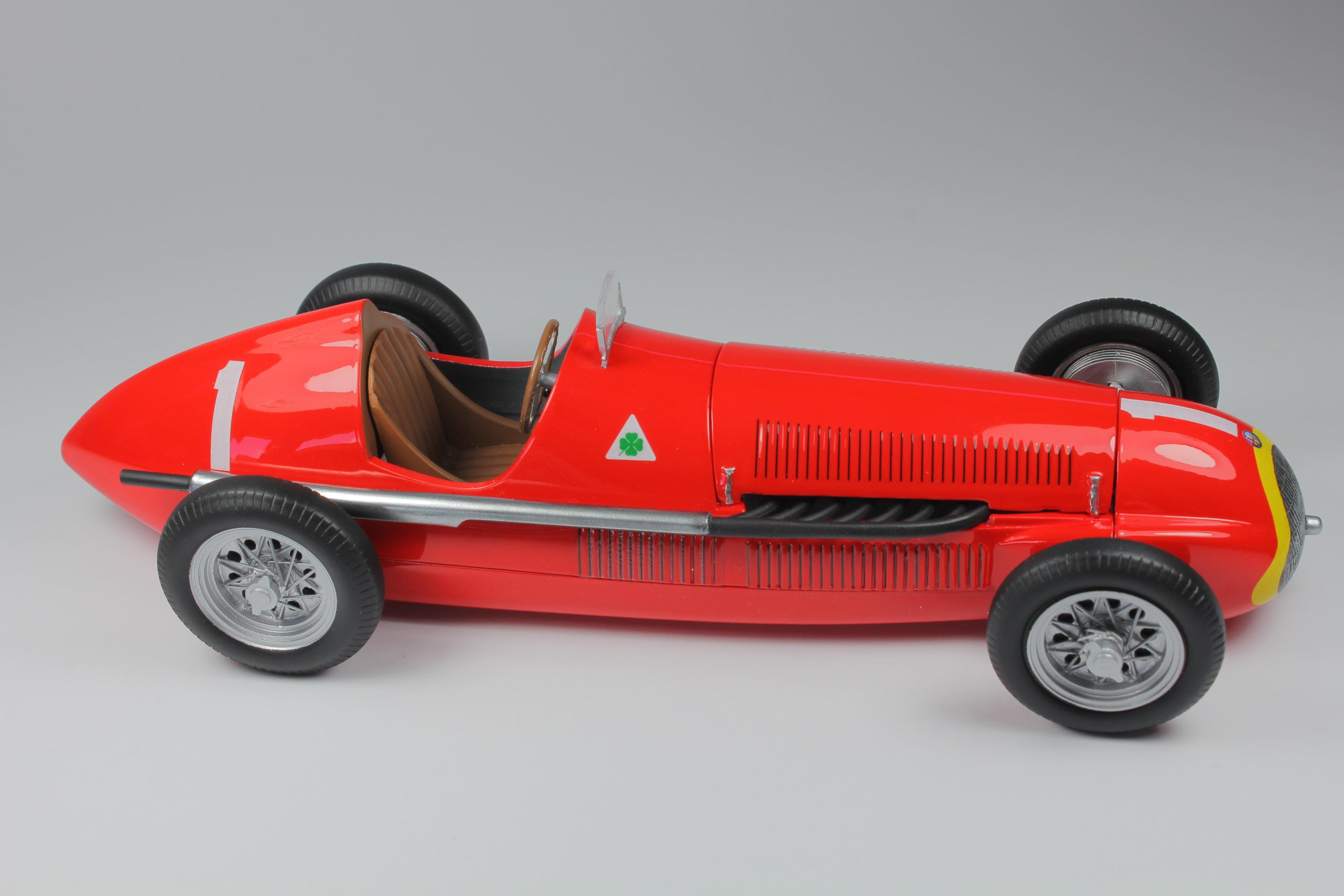

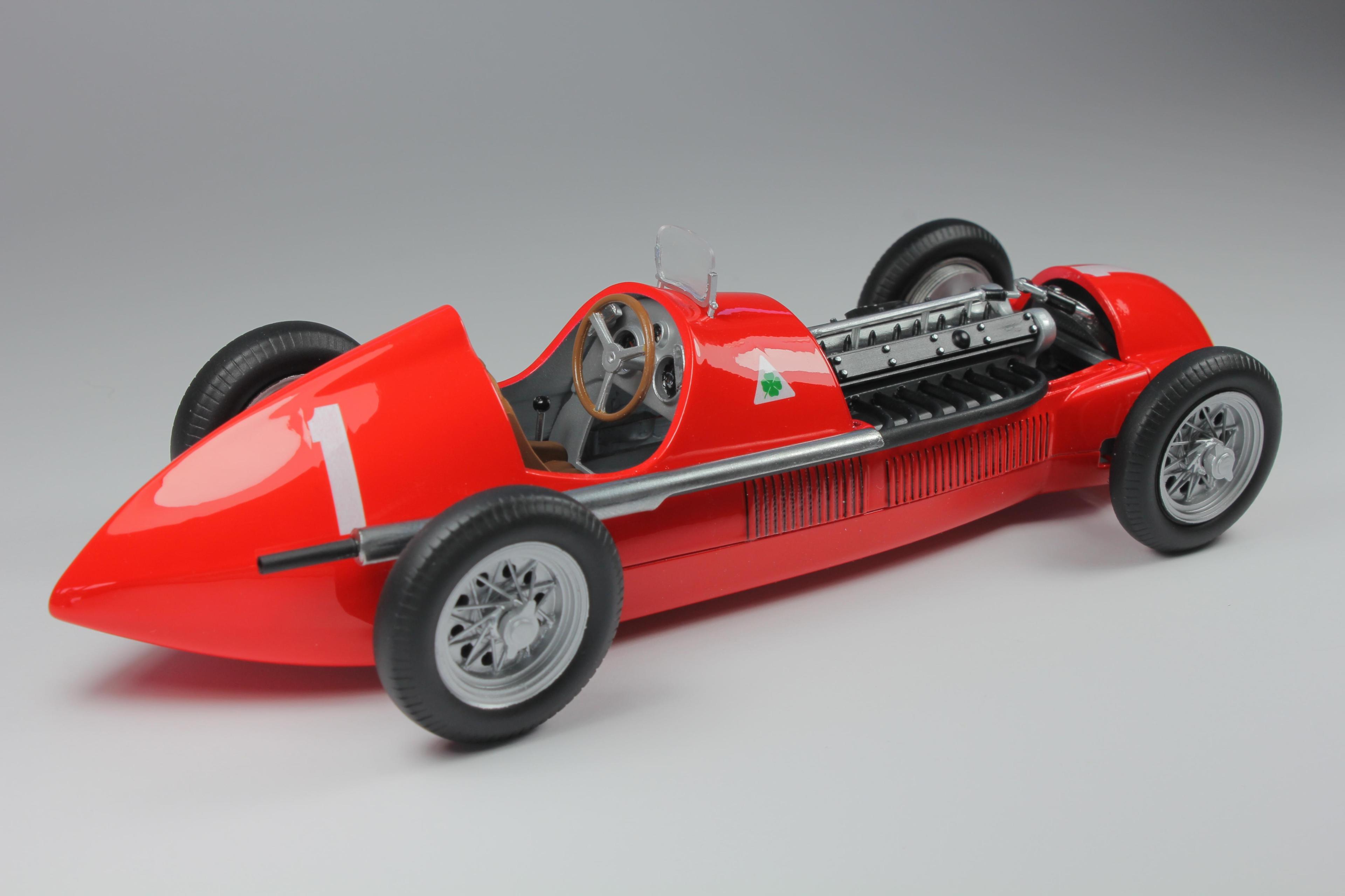

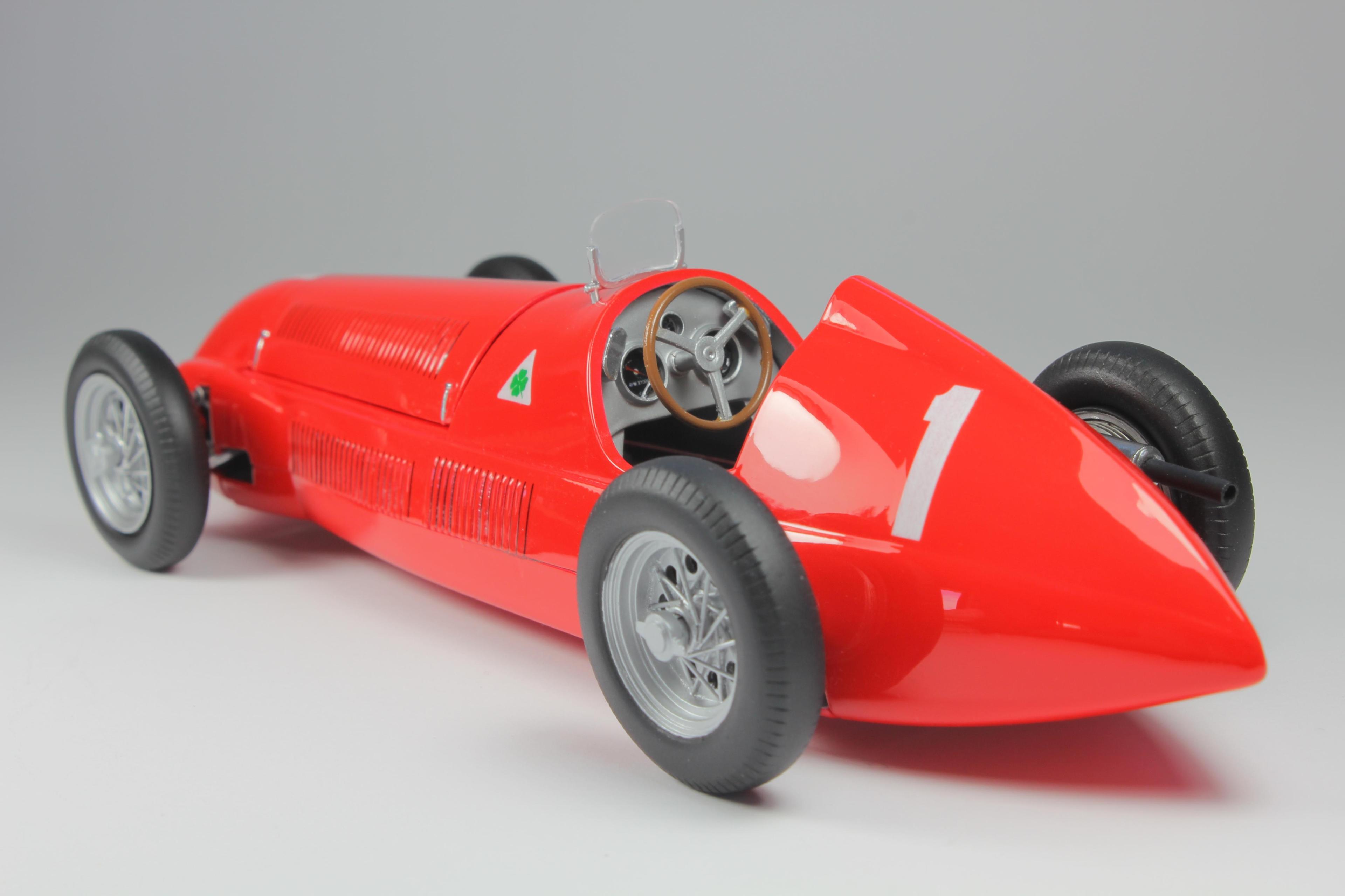

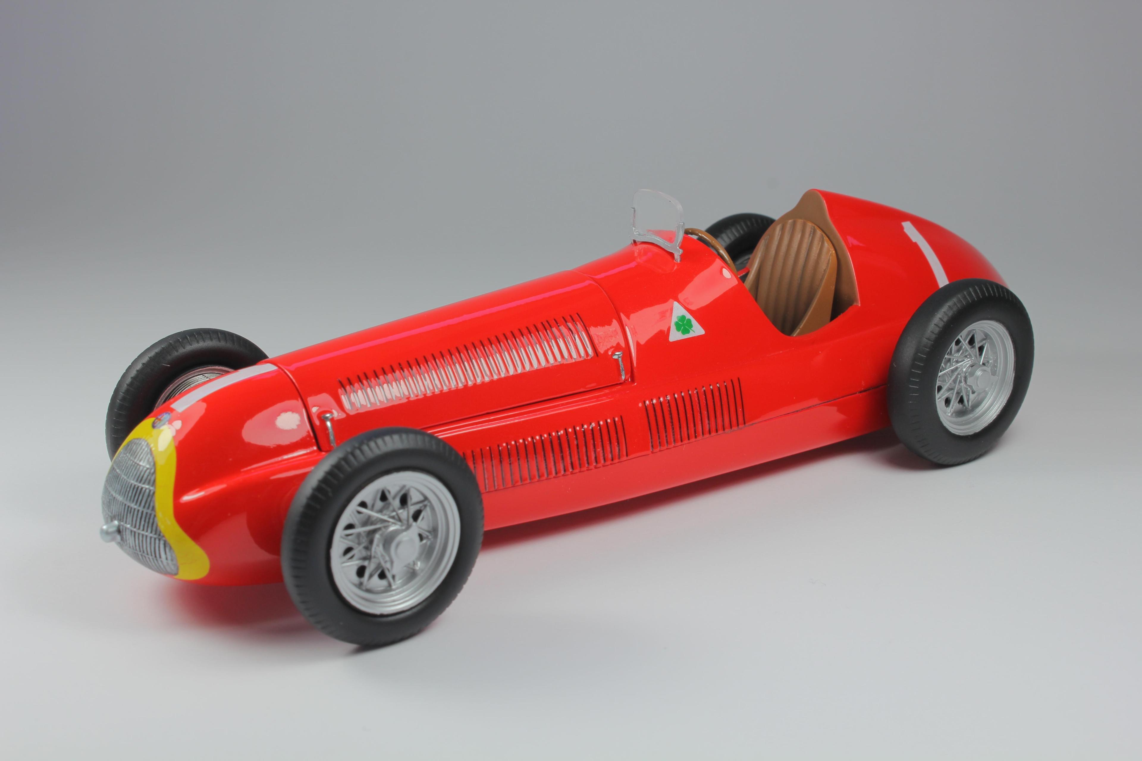

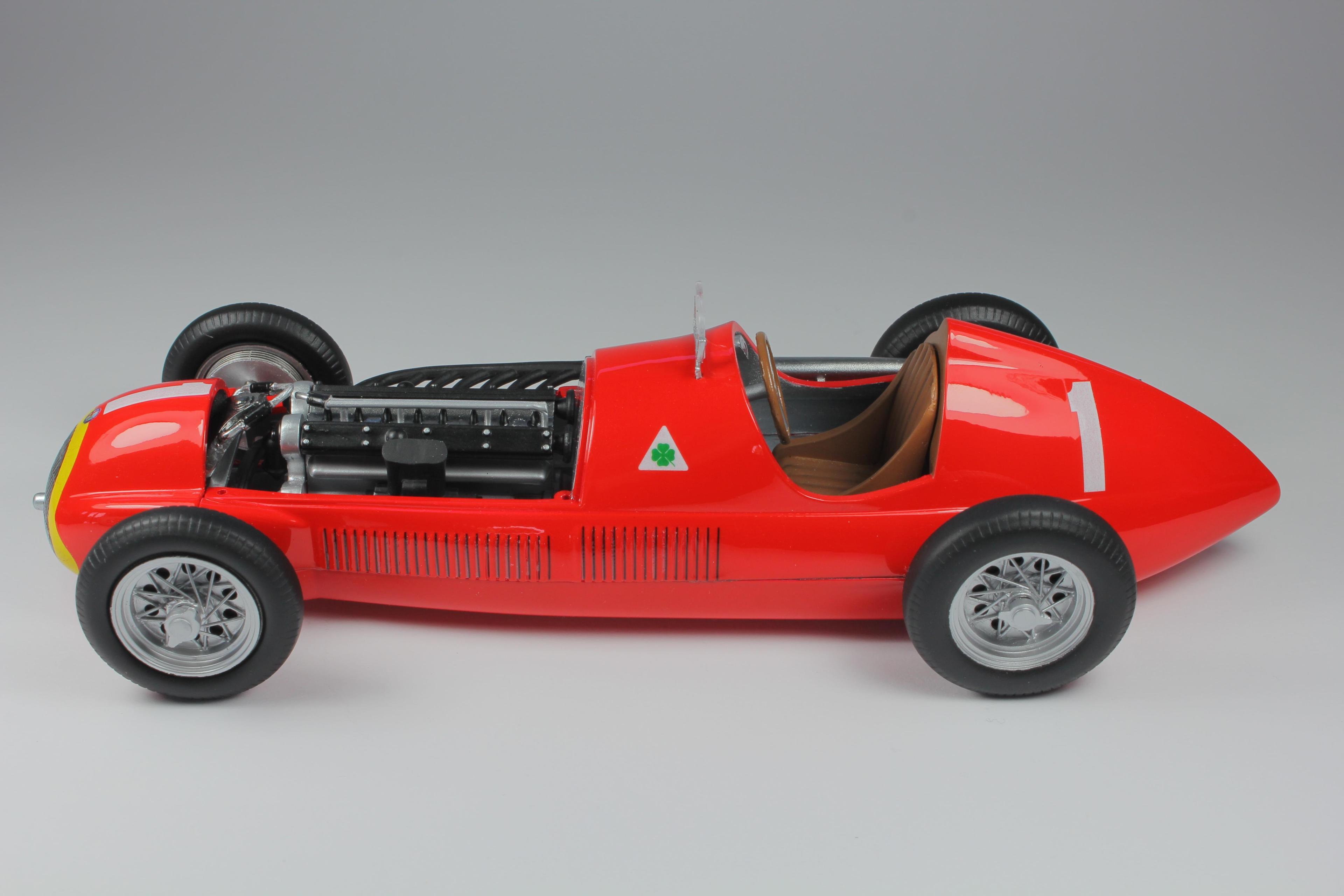

Will we ever see the Revell Datsun 510 racer again? Thanks
Finished Alfa 158. Basic kit but tricky to make nice. I also added spokes to the wheels. Tamiya LP Italian Red and 2k clear.
