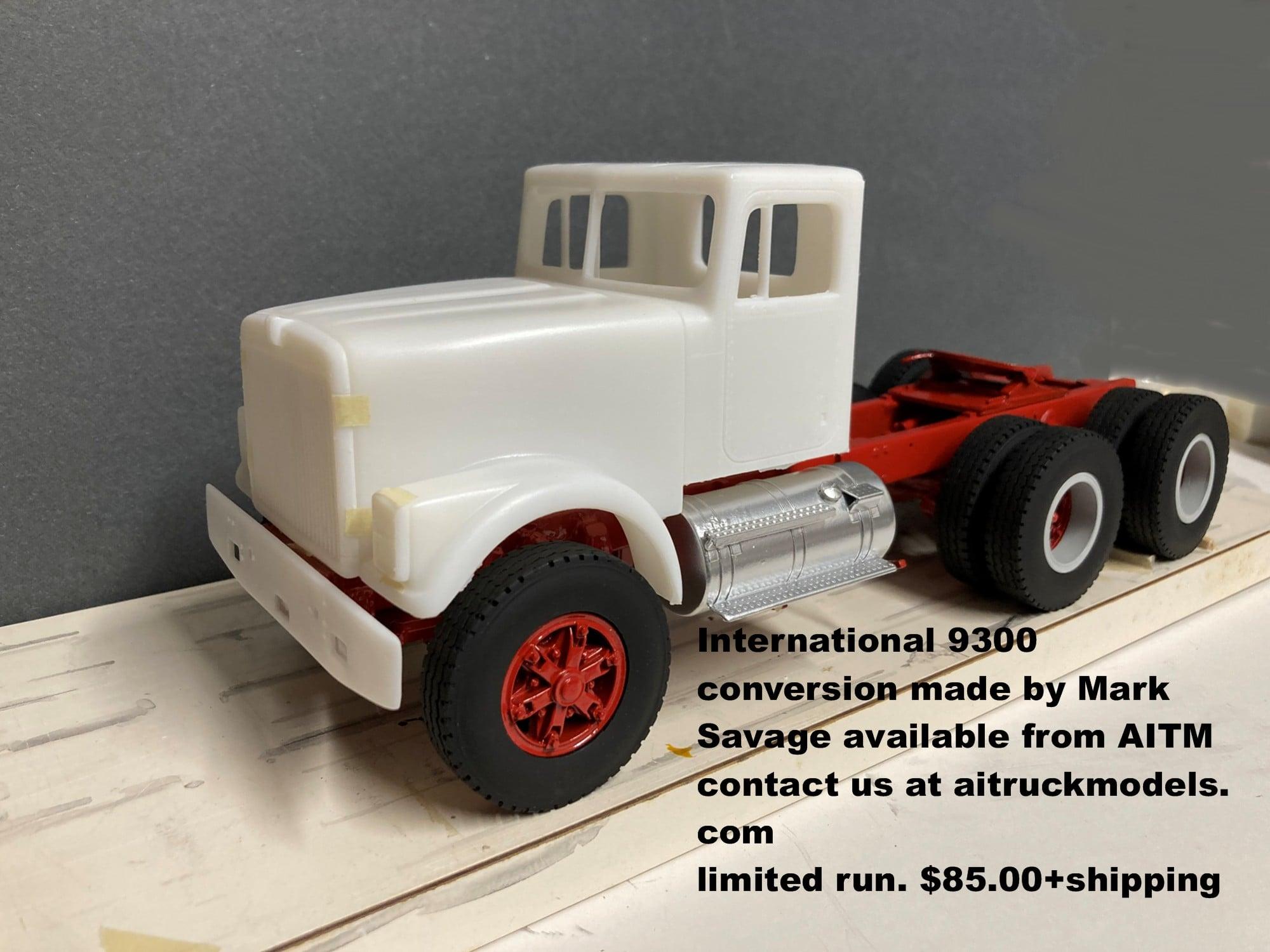

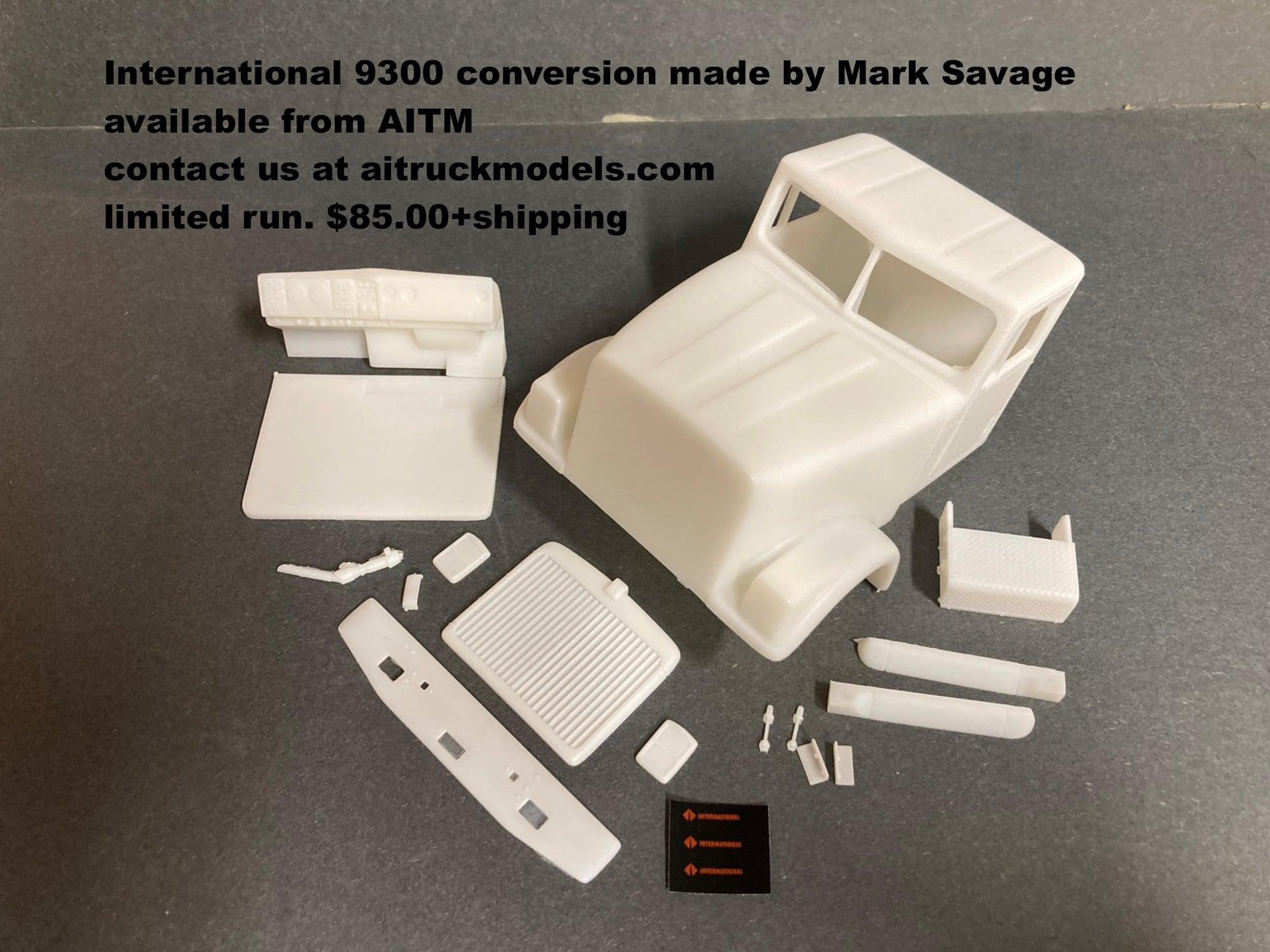

International 9300 resin cabs.
yh70 replied to James Maynard's topic in Model Building Questions and Answers
yes he has the real one setting rusting away..its 1/25 ..great..ill be watching for it ..are you on face book ? here is a picture of the real one . -
i knew some one on here would have something negative to say about the cab..i guess u never did any resin .90% of good quality resin cabs still need a little sanding- touch up . -
that black will look great, will be watching for it. thats a great feeling to build a replica of someones truck . i built this one of my brothers old gin pole truck. -
you very welcome...use the 4300 for a donor kit.. also u may ck with Dave at Models by Dave he may have a visor of that style .. Models by Dave -
yes u in luck..conversion by Mark Salvage and sold by Dave at A.I.T.M. ..it may not be on his web site yet , just call Dave and ask for it ...American Industrial Truck Models – Resin Model Truck Conversion Kits and Parts for 1:25th Scale -
