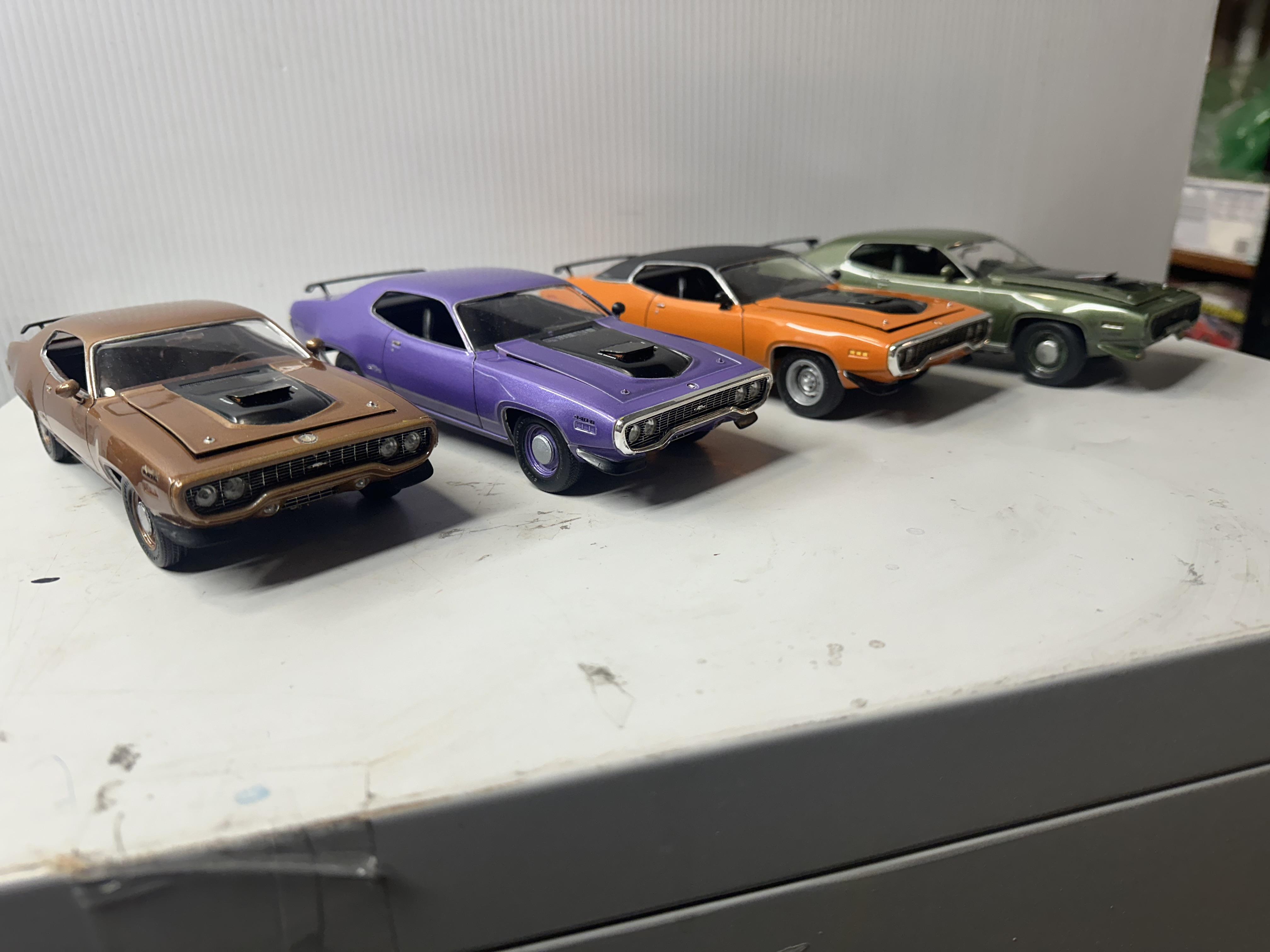

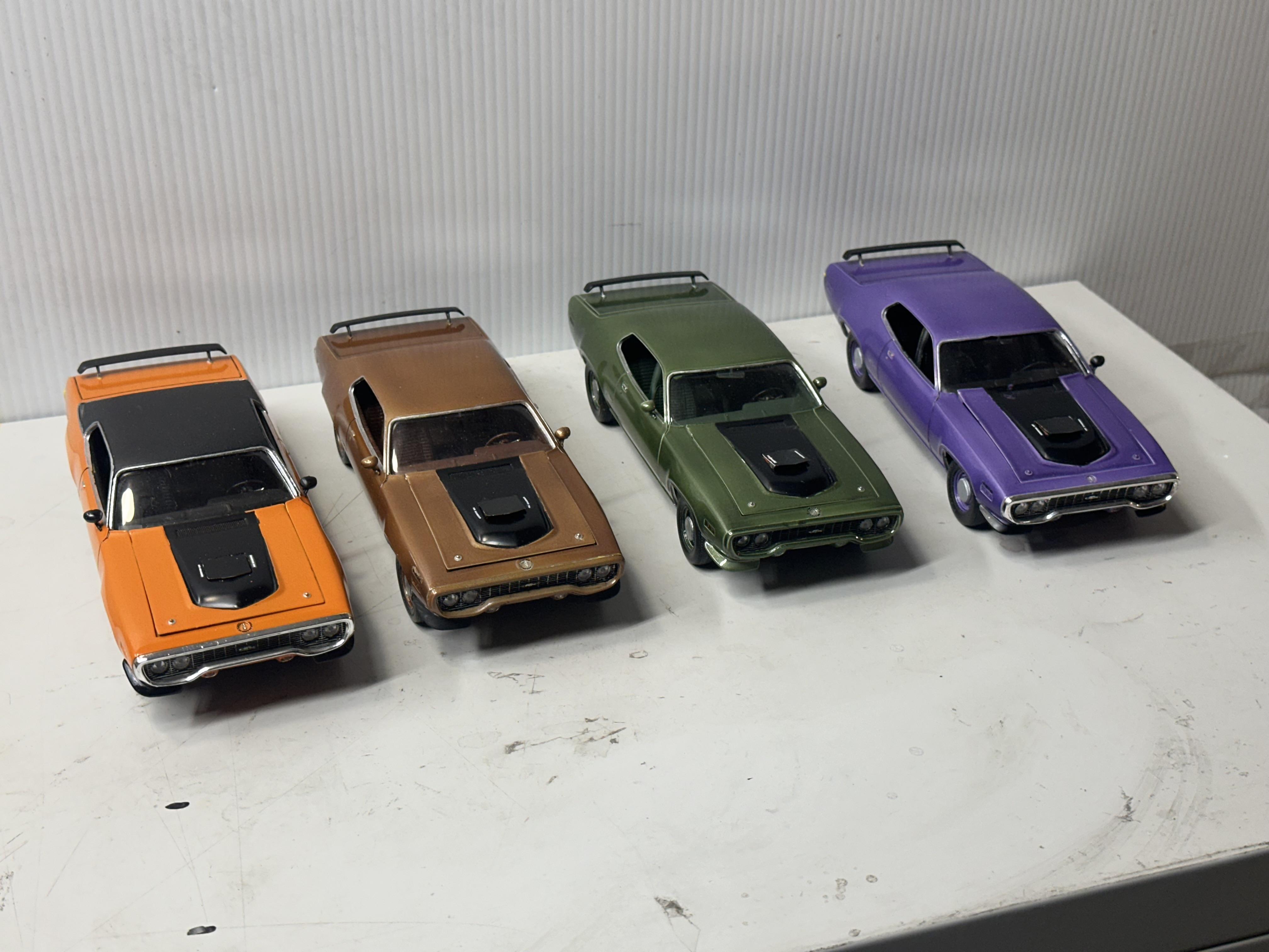

thats a good question,i guess probably about 10, basically they will be in the high impact/ and or my favorite colors that i like by plymouth, i did some 71 gtx"s in my top 5 colors on here a while back. the cuda colors off the top of my head are: plum purple,tawny gold,f-7 green(already shown in the completed section) citron mist, rally red, go mango, lime green, hemi orange, alpine white, and dark burnt orange, jamica blue, i may also do a limelight green, and sassy grass green. -

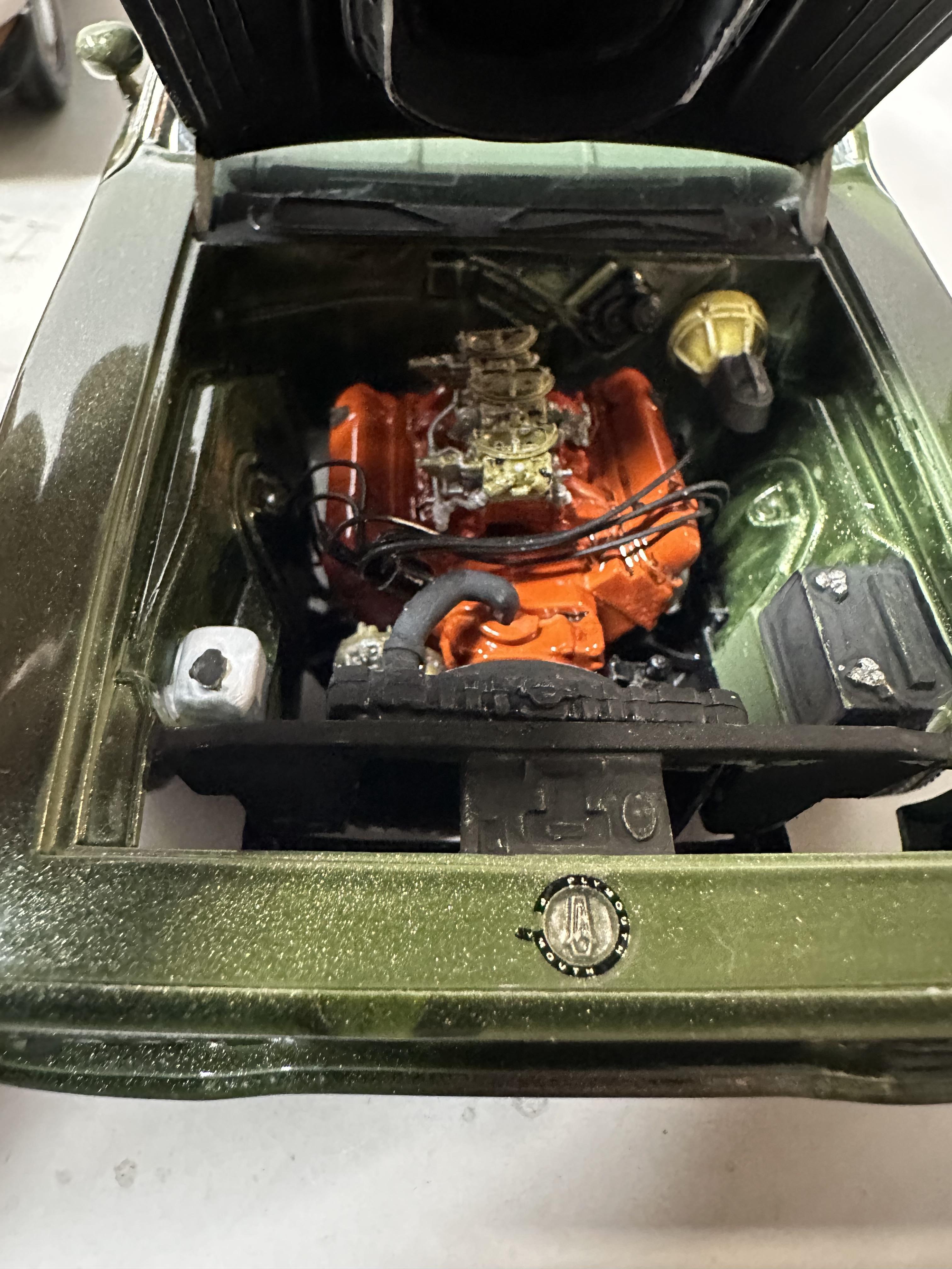

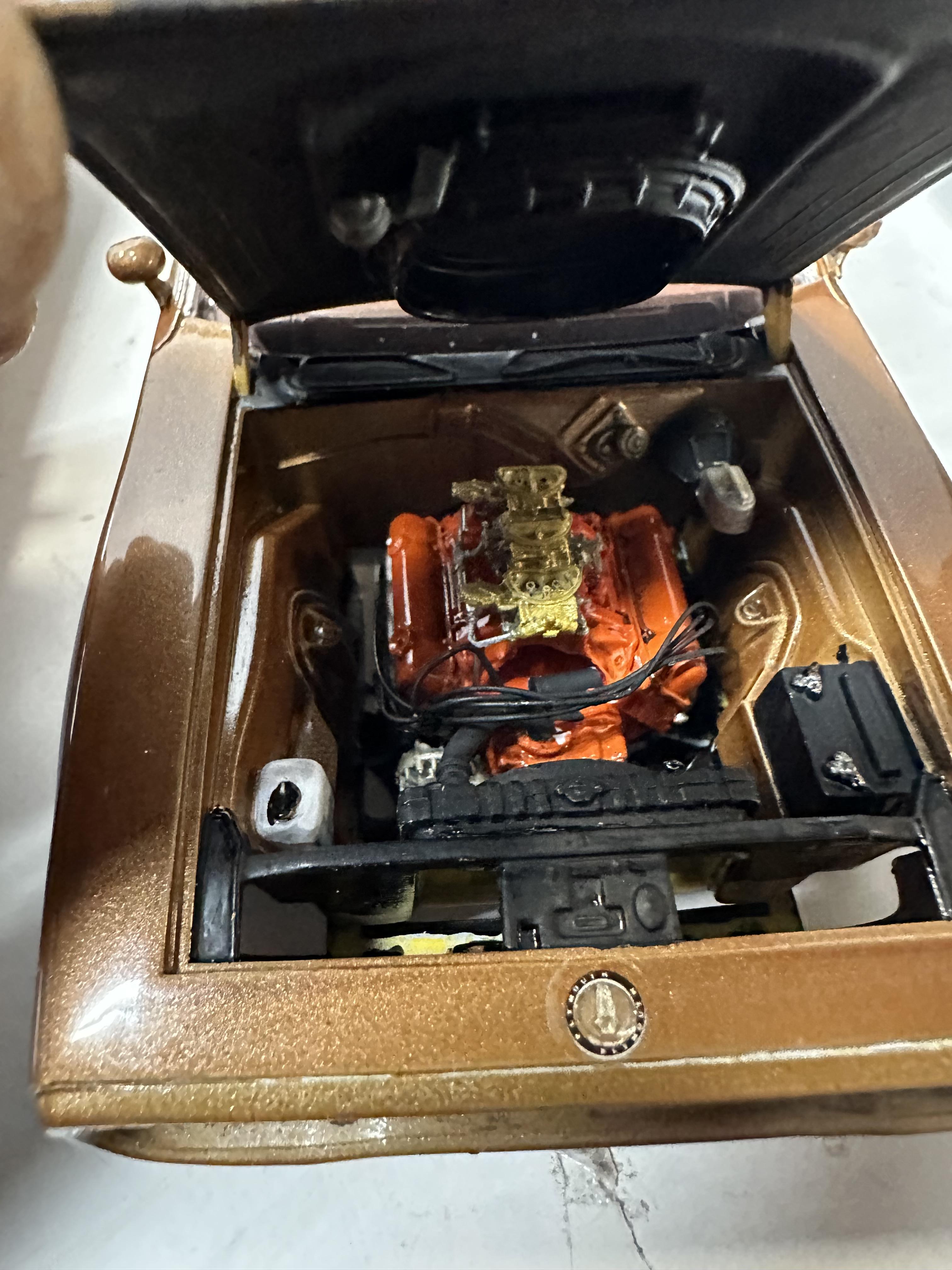

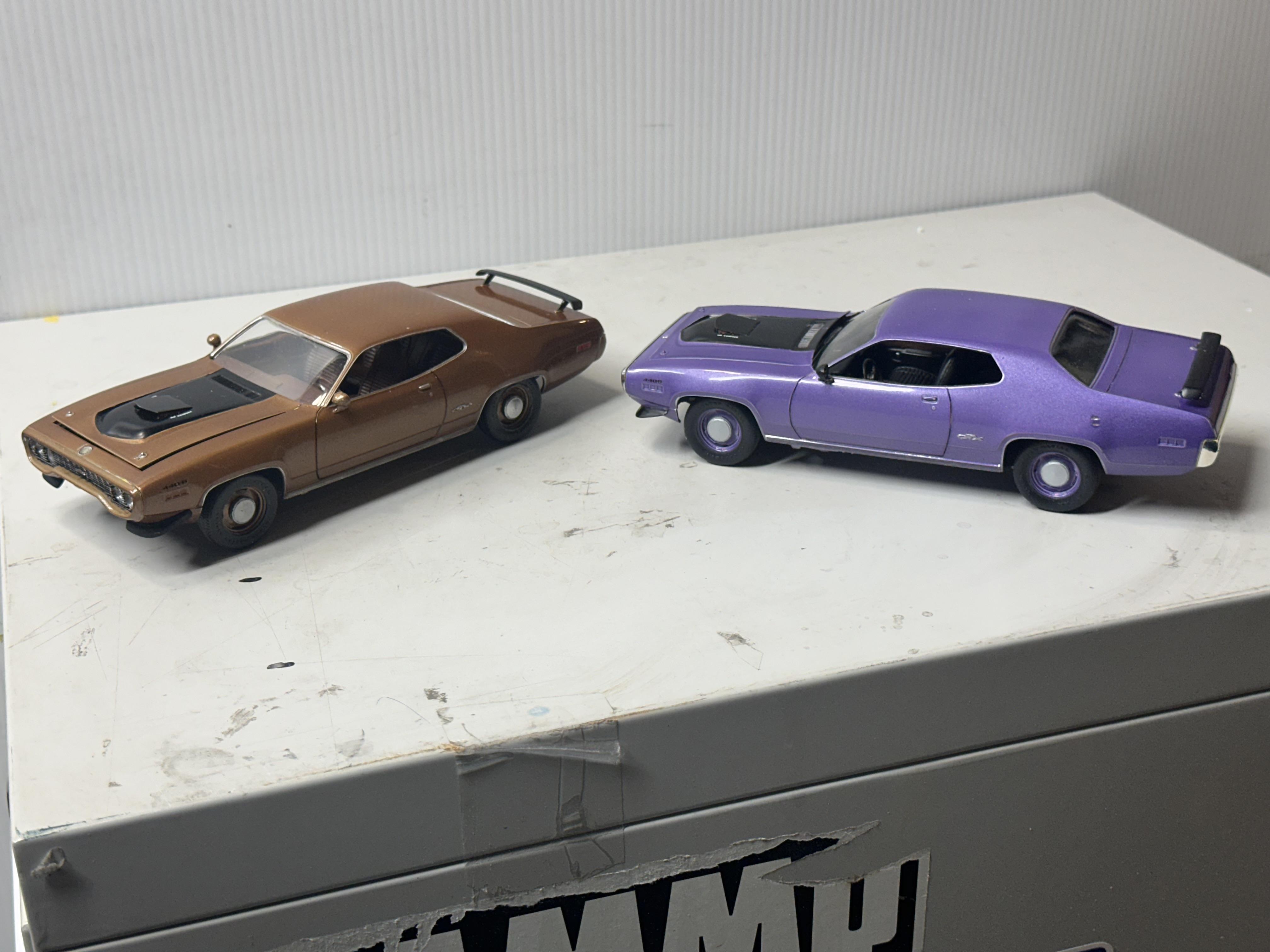

Here is the second barracuda I’m working on, this one is actually going to be a 440-6 pack car i’m using the hemi short block with a set of revell 1969 charger 440 heads and a six pack set up from Iceman 3-d The interior is pretty much done and I am working on the engine now, I also started on the third Cuda, which is a tawny gold hemi car, my first one in the series was the F7 green 70 hemi car that was featured in under glass section. The color of this car is purple with a white vinyl top.

thank you david! i have some with vinyl tops on them and i am even throwing in a mod top on one!
Well this is a first in a series i plan to build, all cudas in high impact/ my favorite colors builds this one is F-7 ivy green by MCW enamel paint, has fireball resin carbs, detailed engine, fireball steelrims/ poverty caps, was a fun build , looking forward to doing the rest
