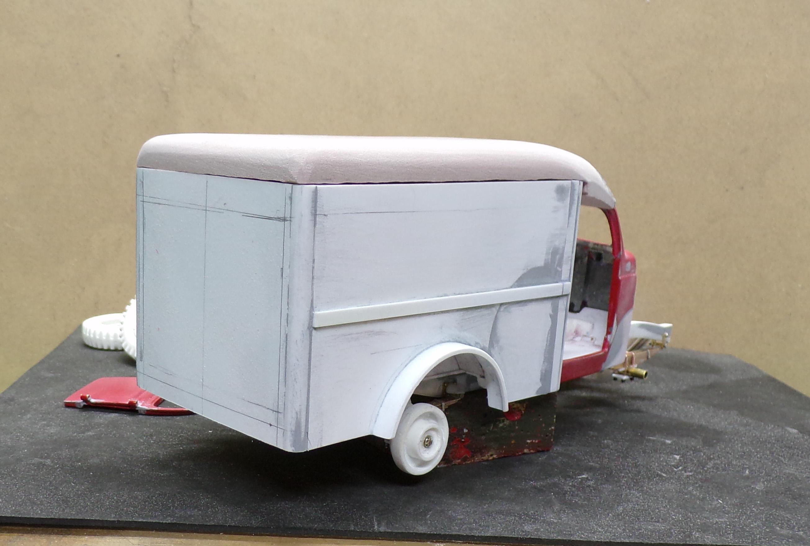

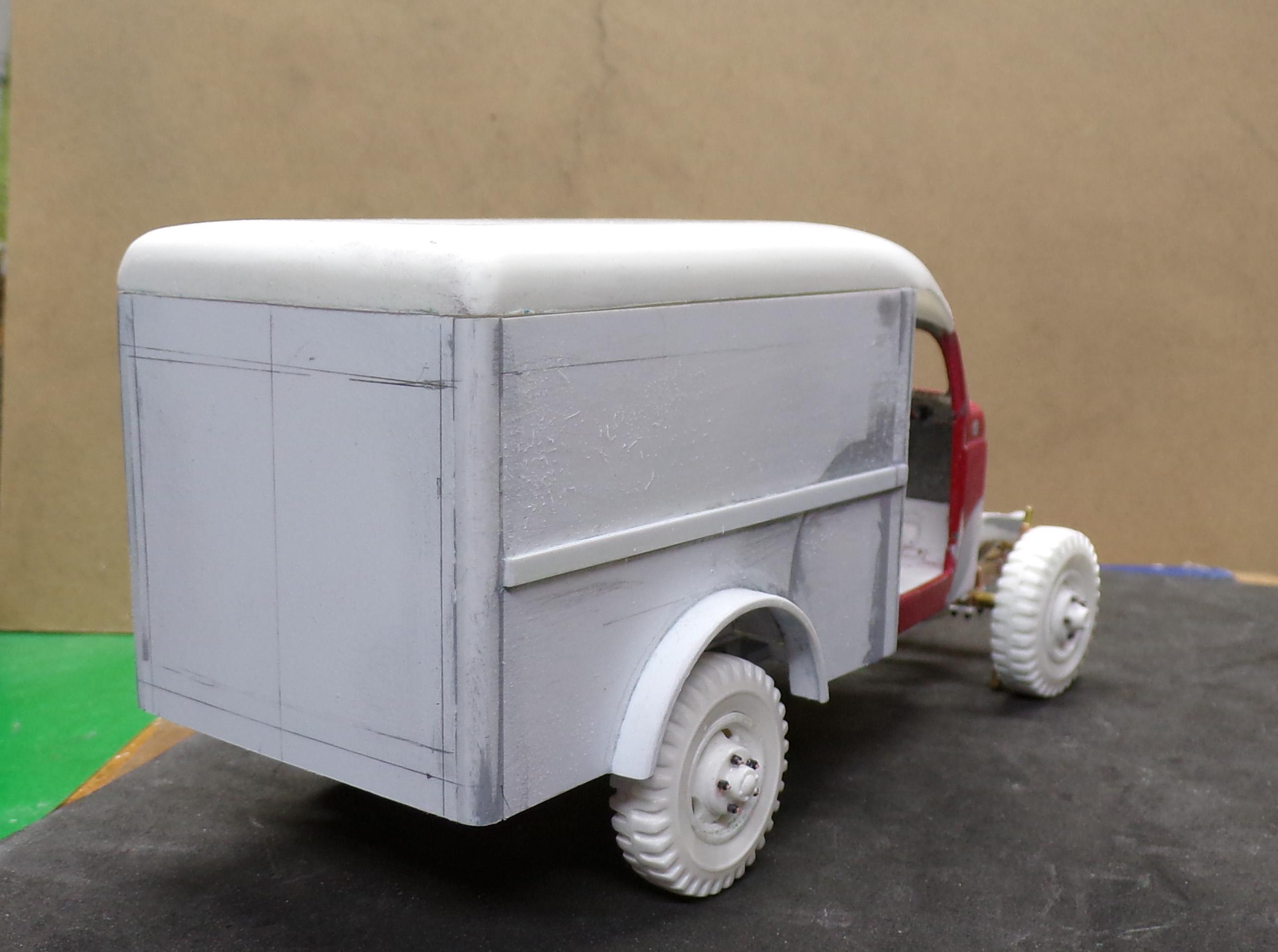

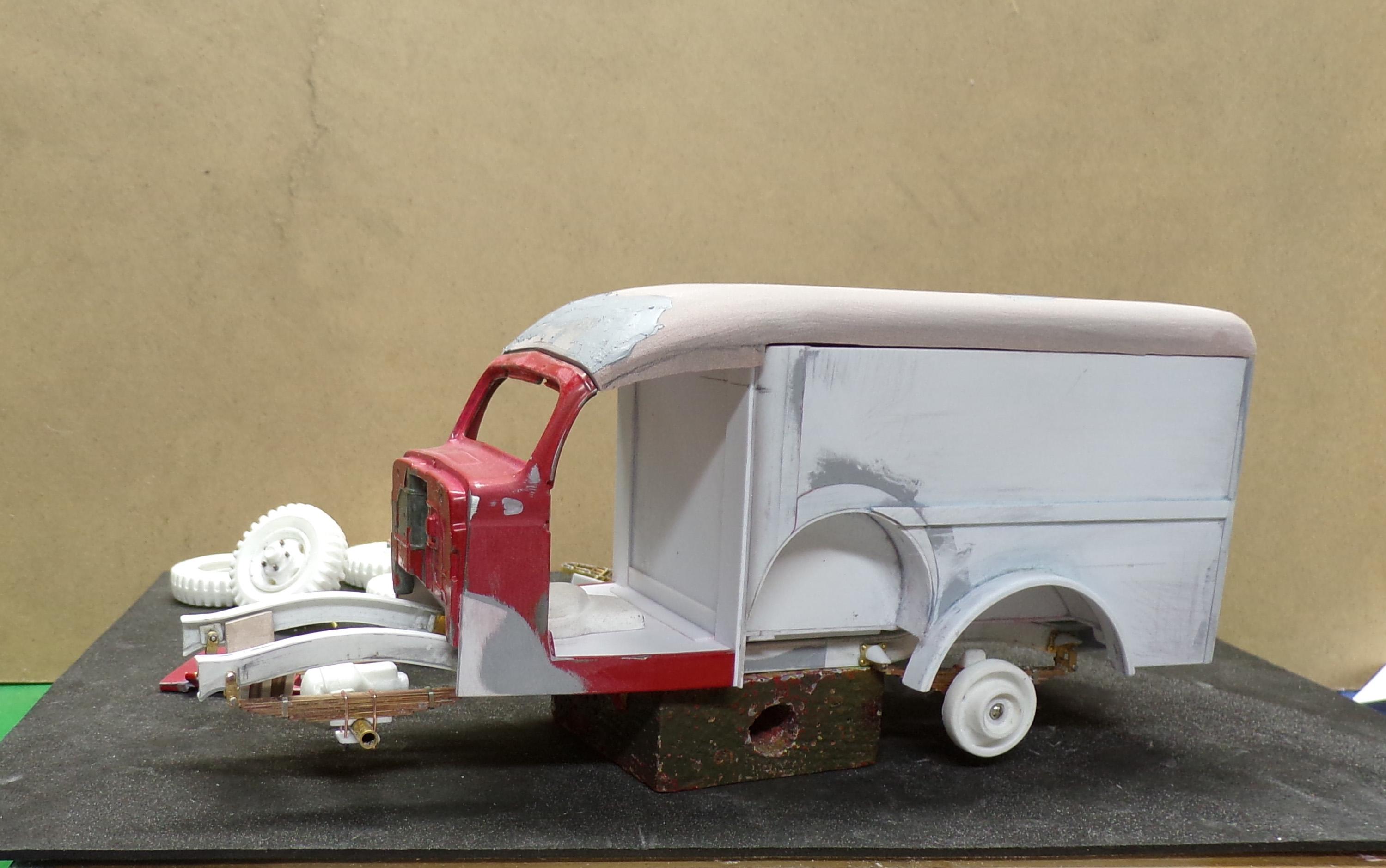

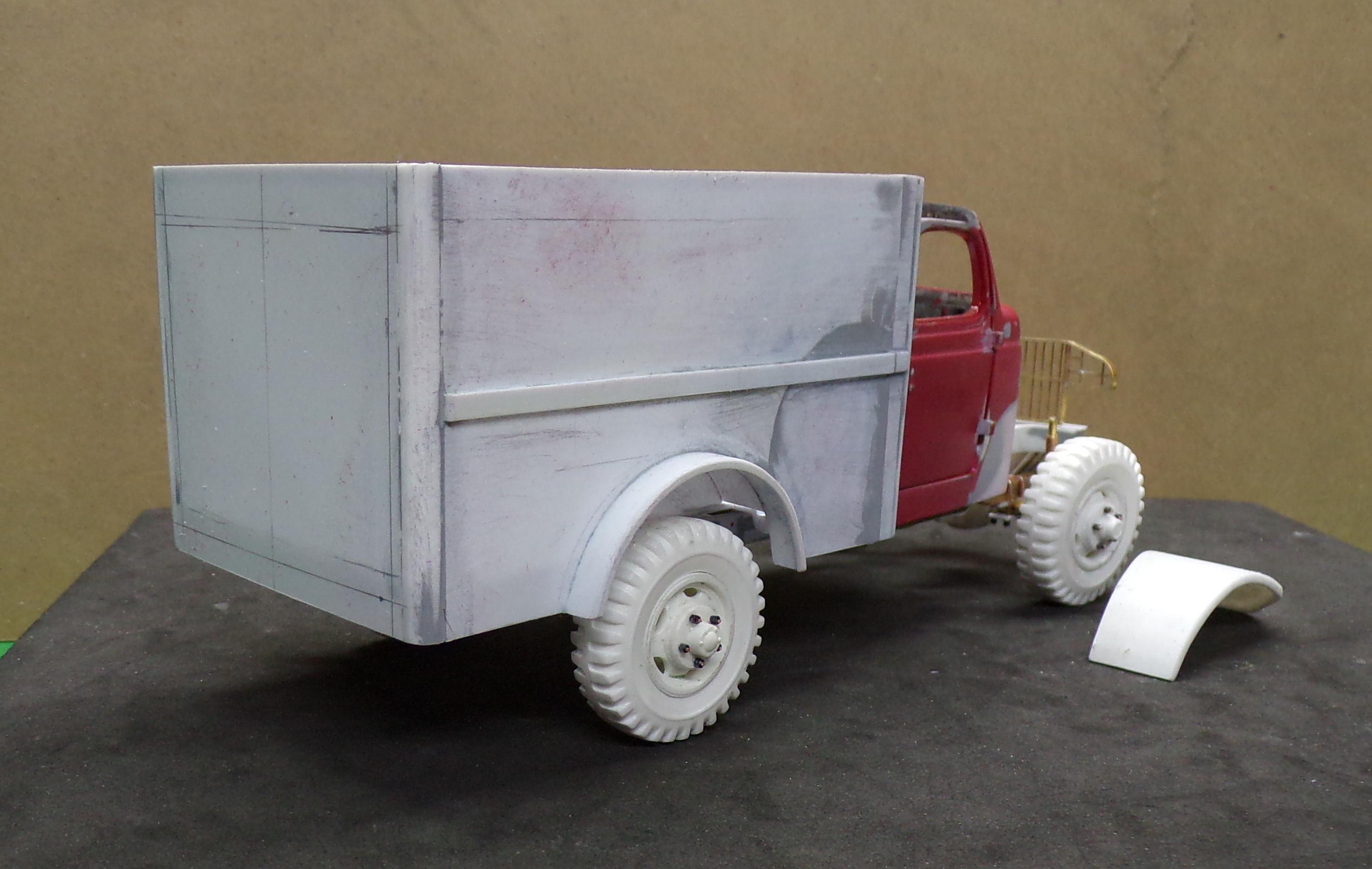

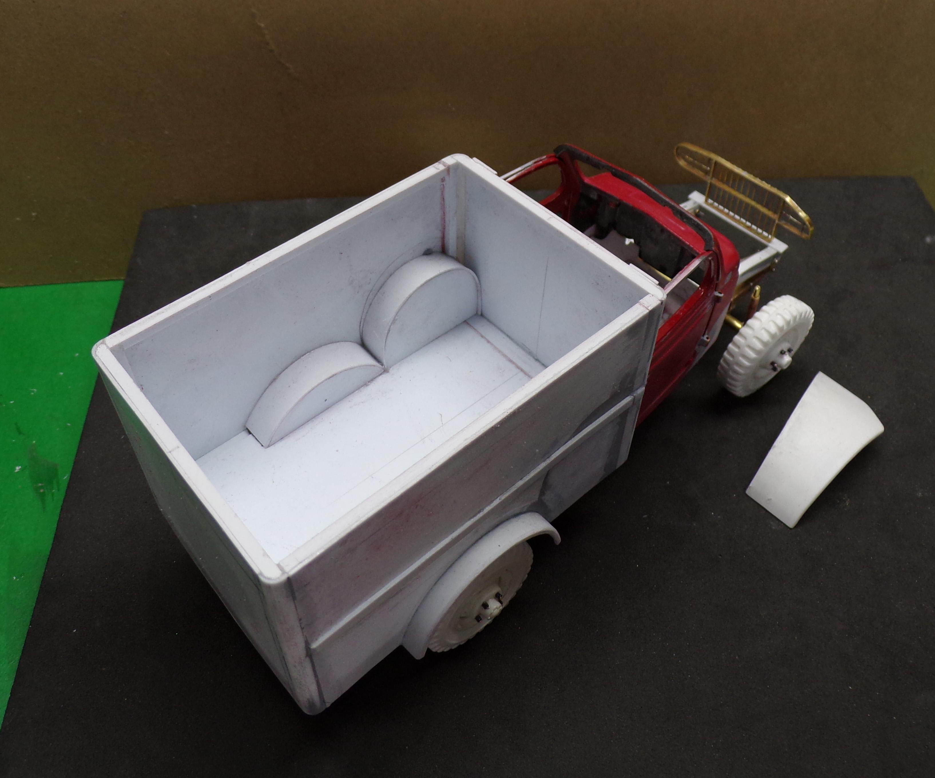

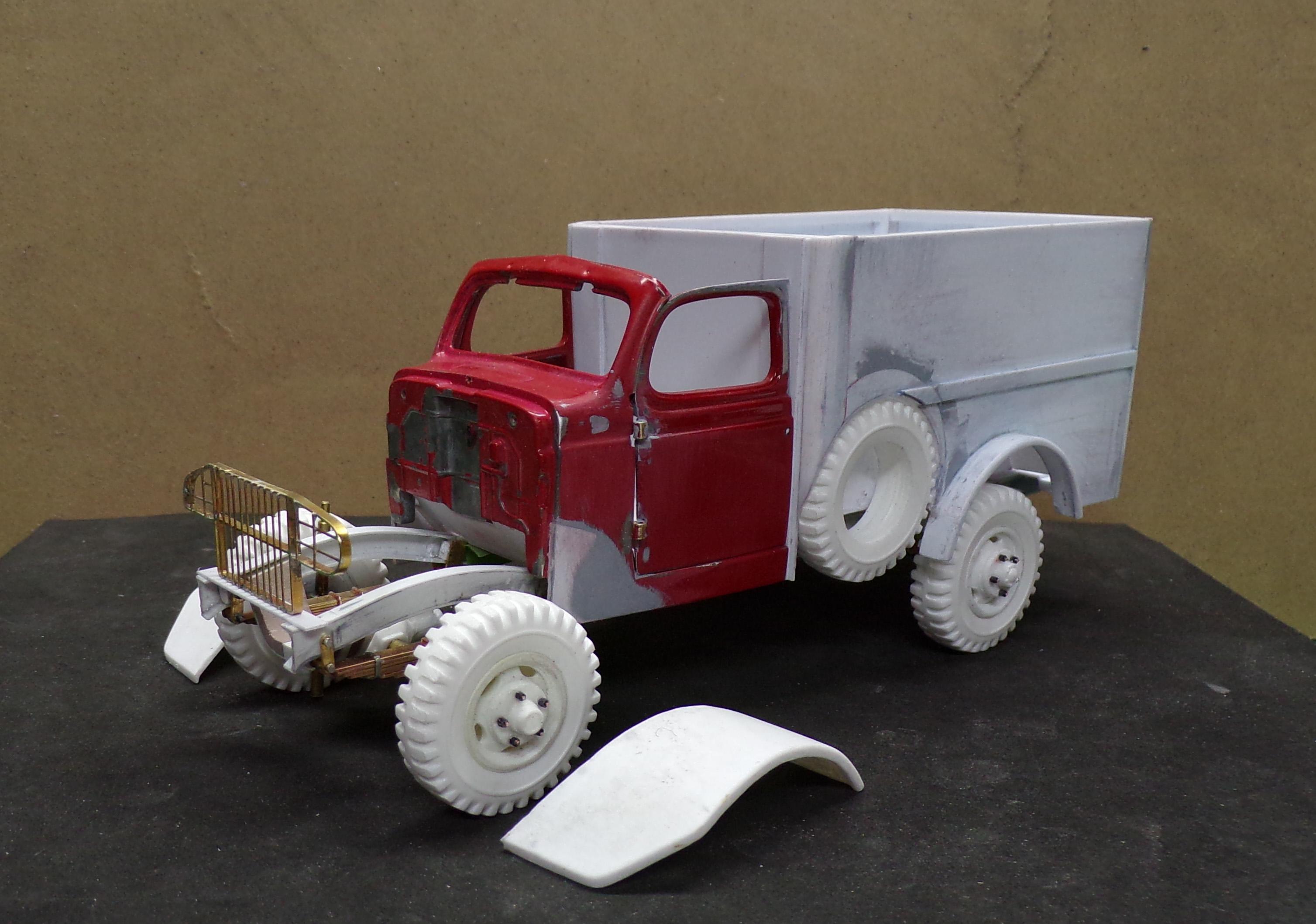

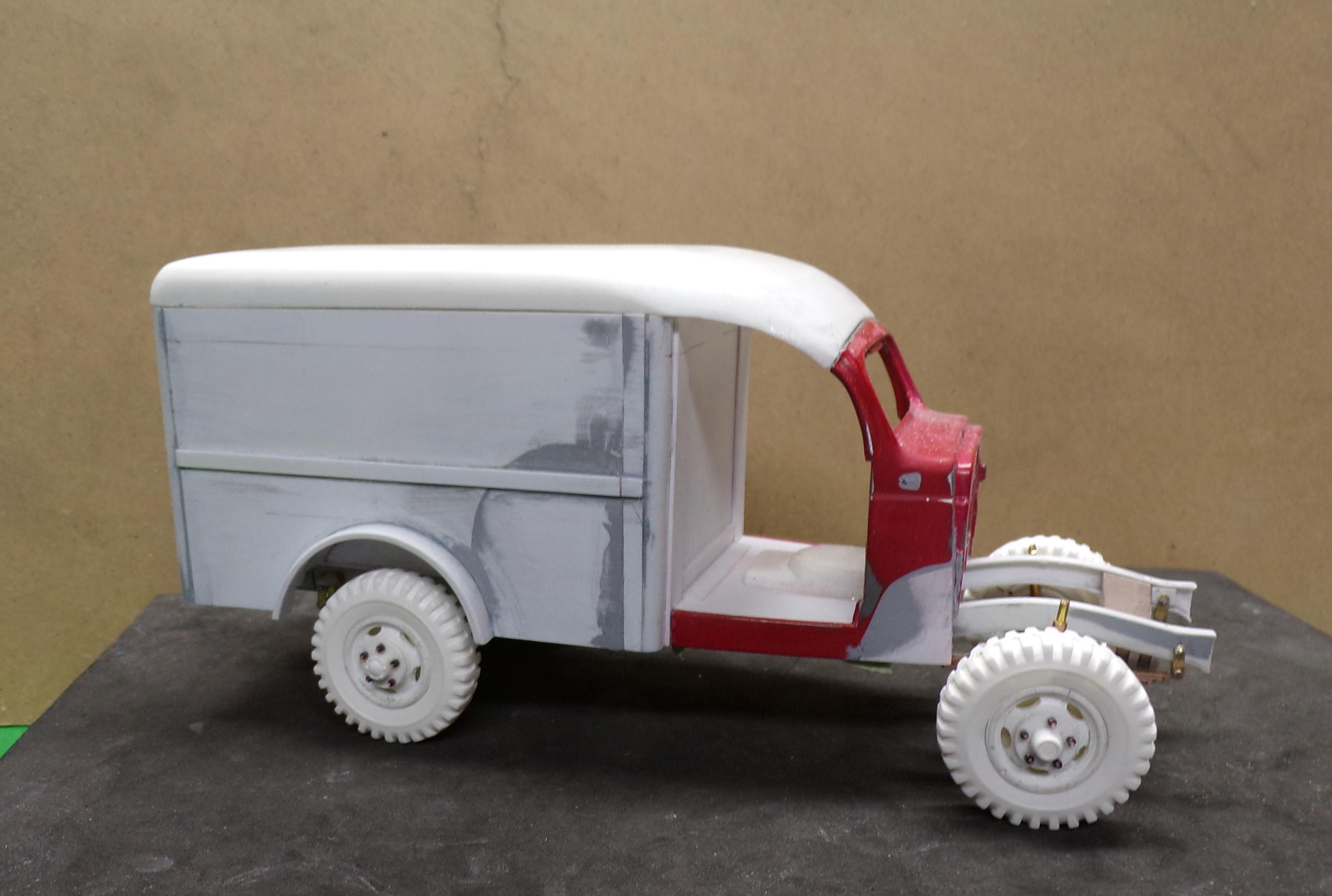

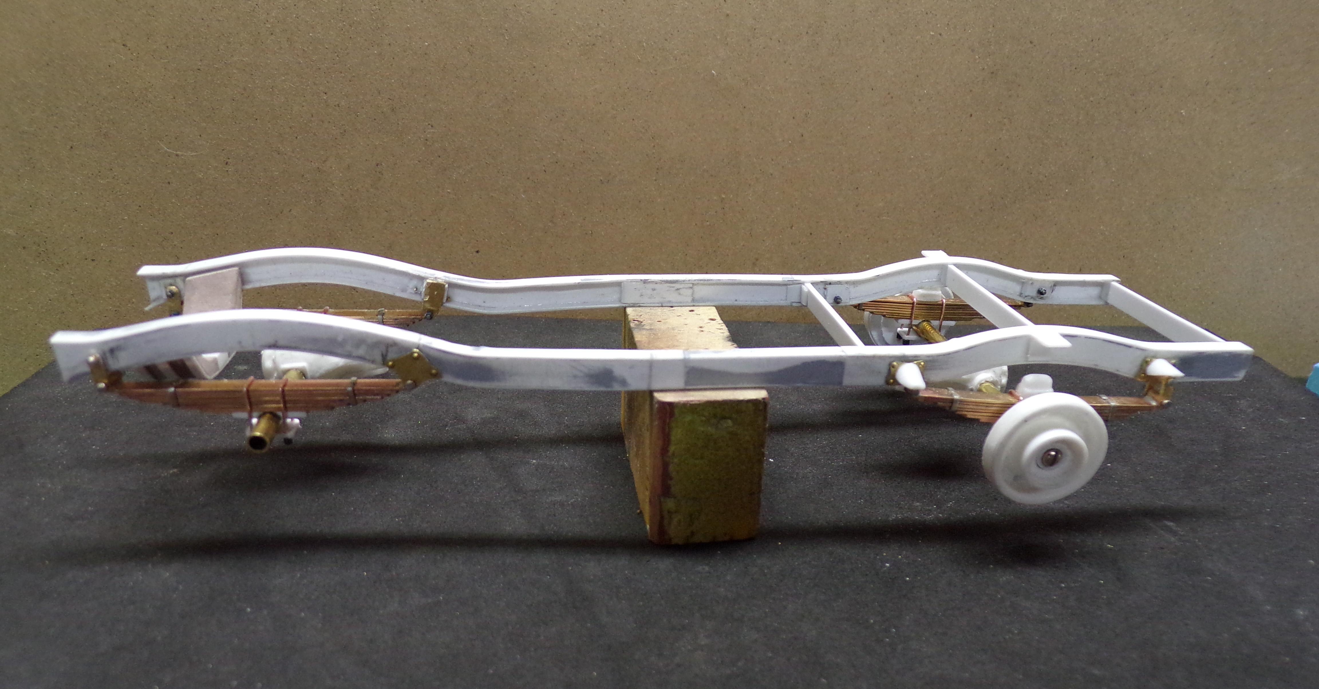

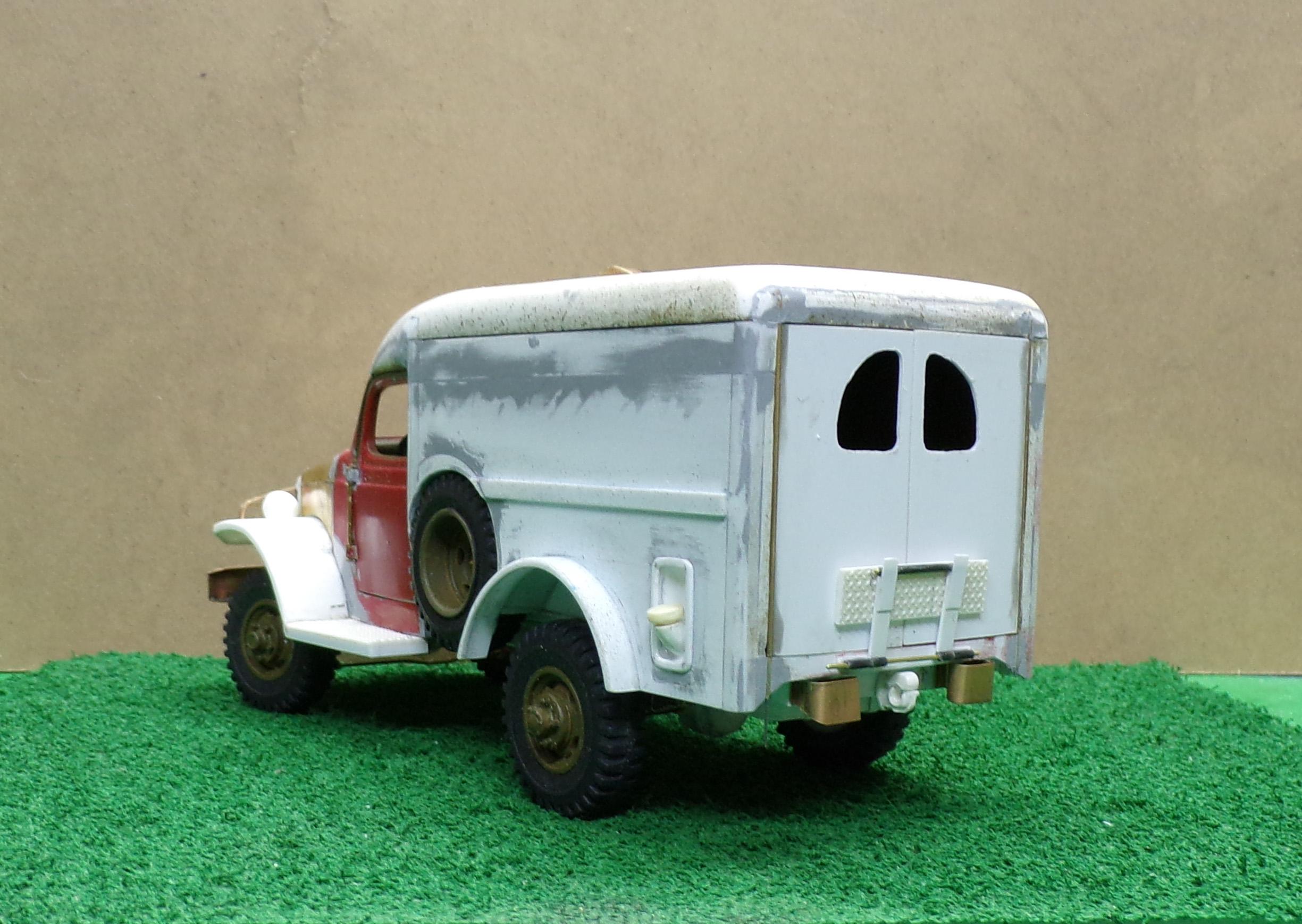

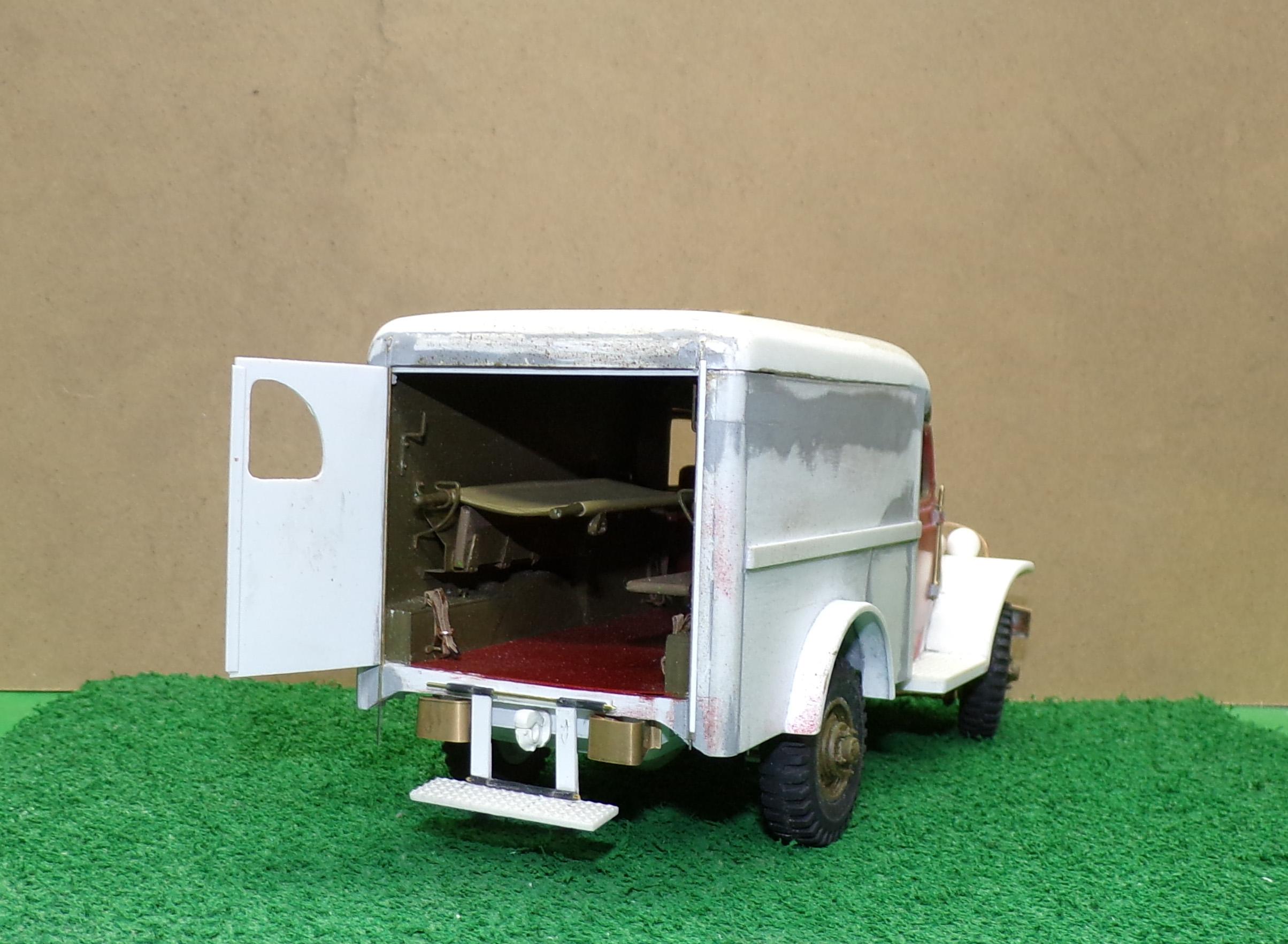

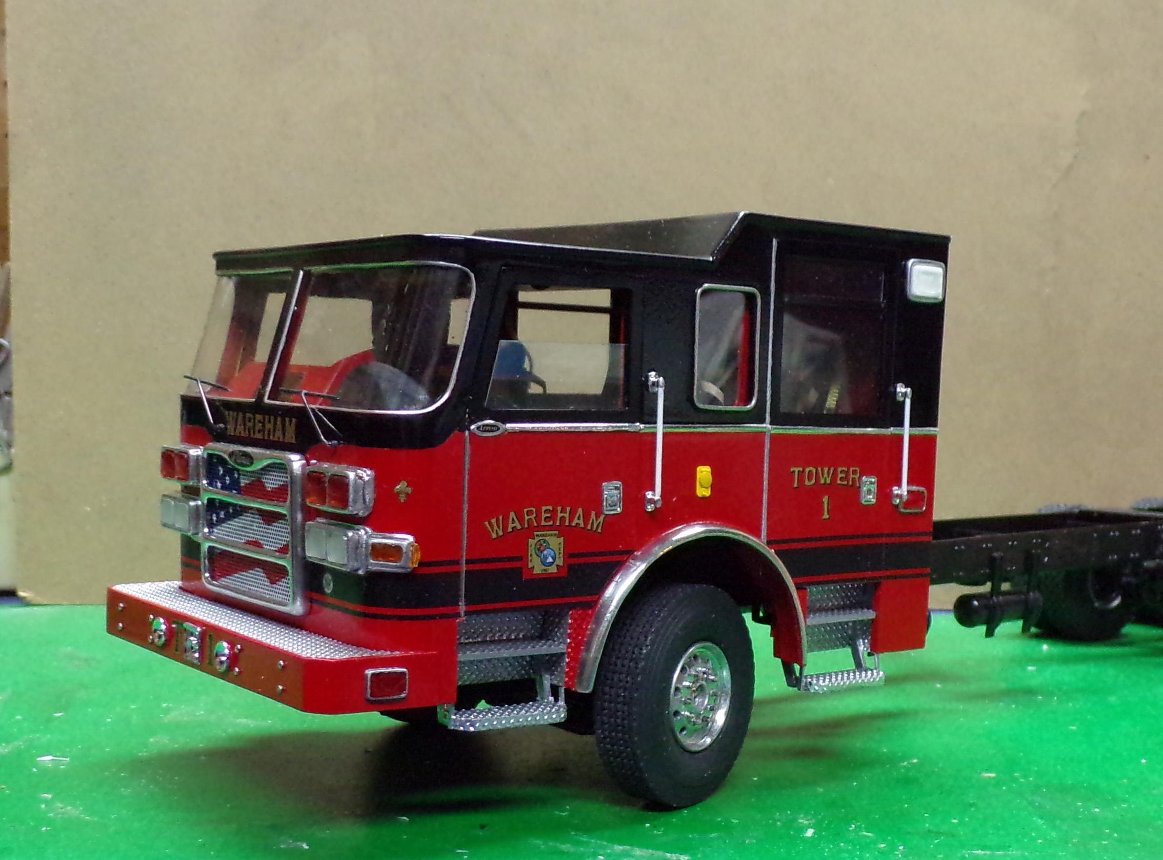

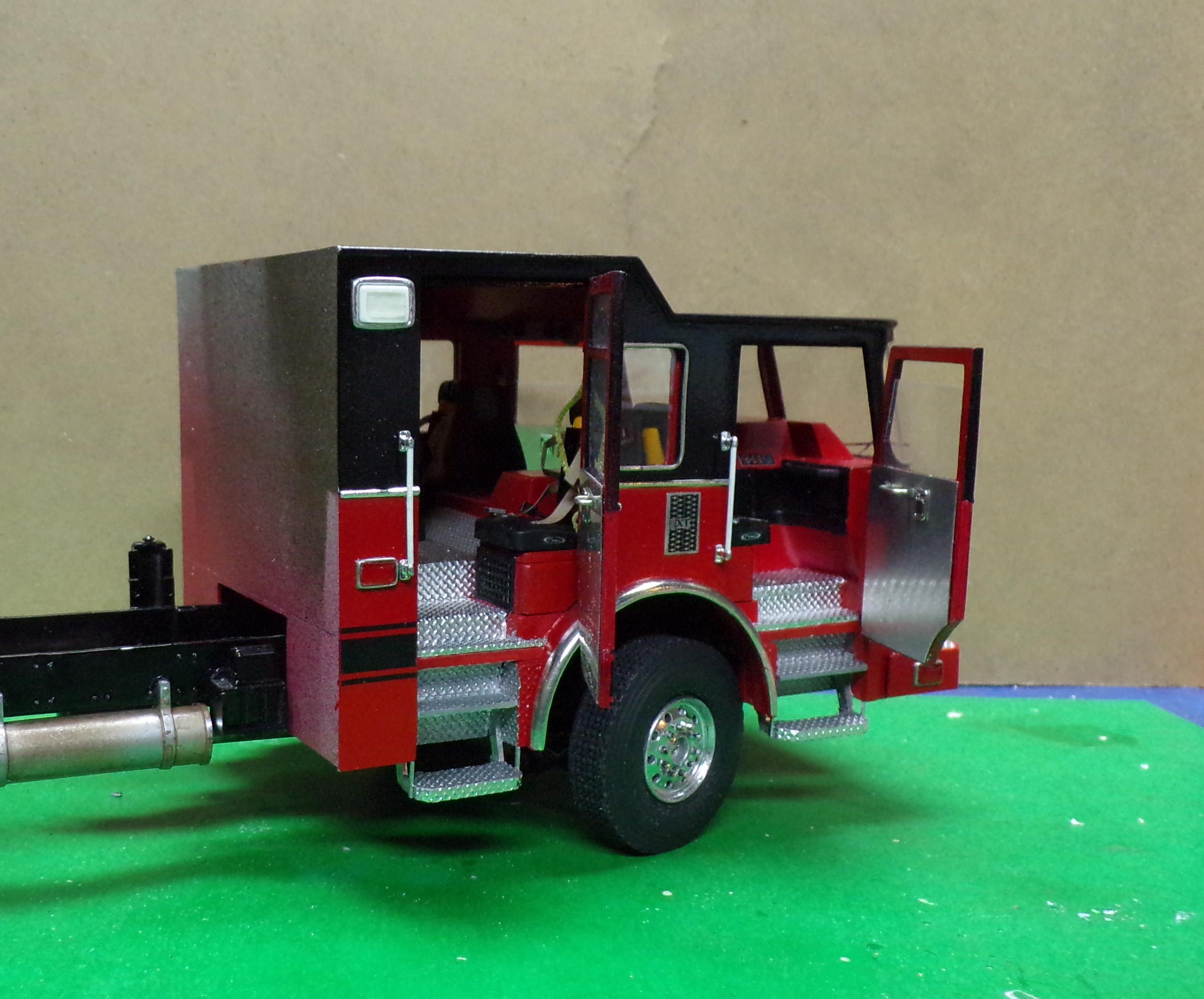

Been doing some study on the truck body. Found I have to add about 54 additional scale inches to the back of the frame. With the photos I have of the real truck in progress I have been able to break down the build into 3 components. Will be visiting the LHS tomorrow to pick up some 0.030 Evergreen sheet stock for the build. Hoping to get the basics of the body built in the next few weeks. The aerial device will take a lot of study and some visits to the FD where the truck is housed. Lots to figure out so it can be done right. Pix will come soon.

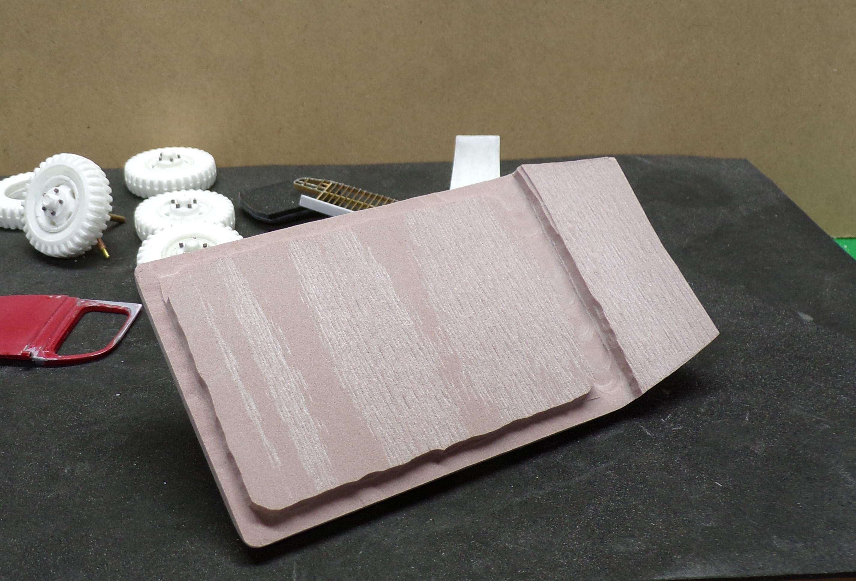

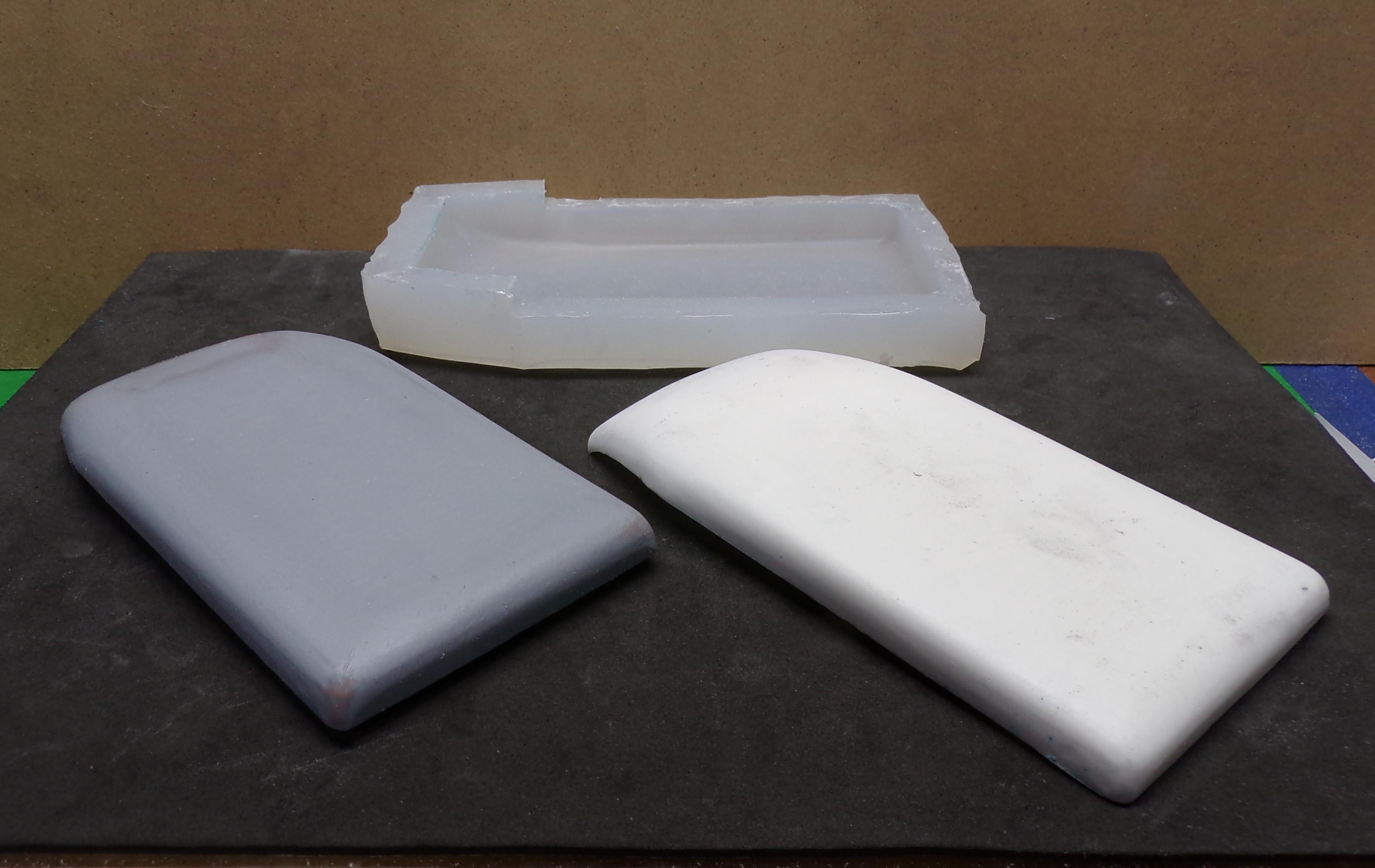

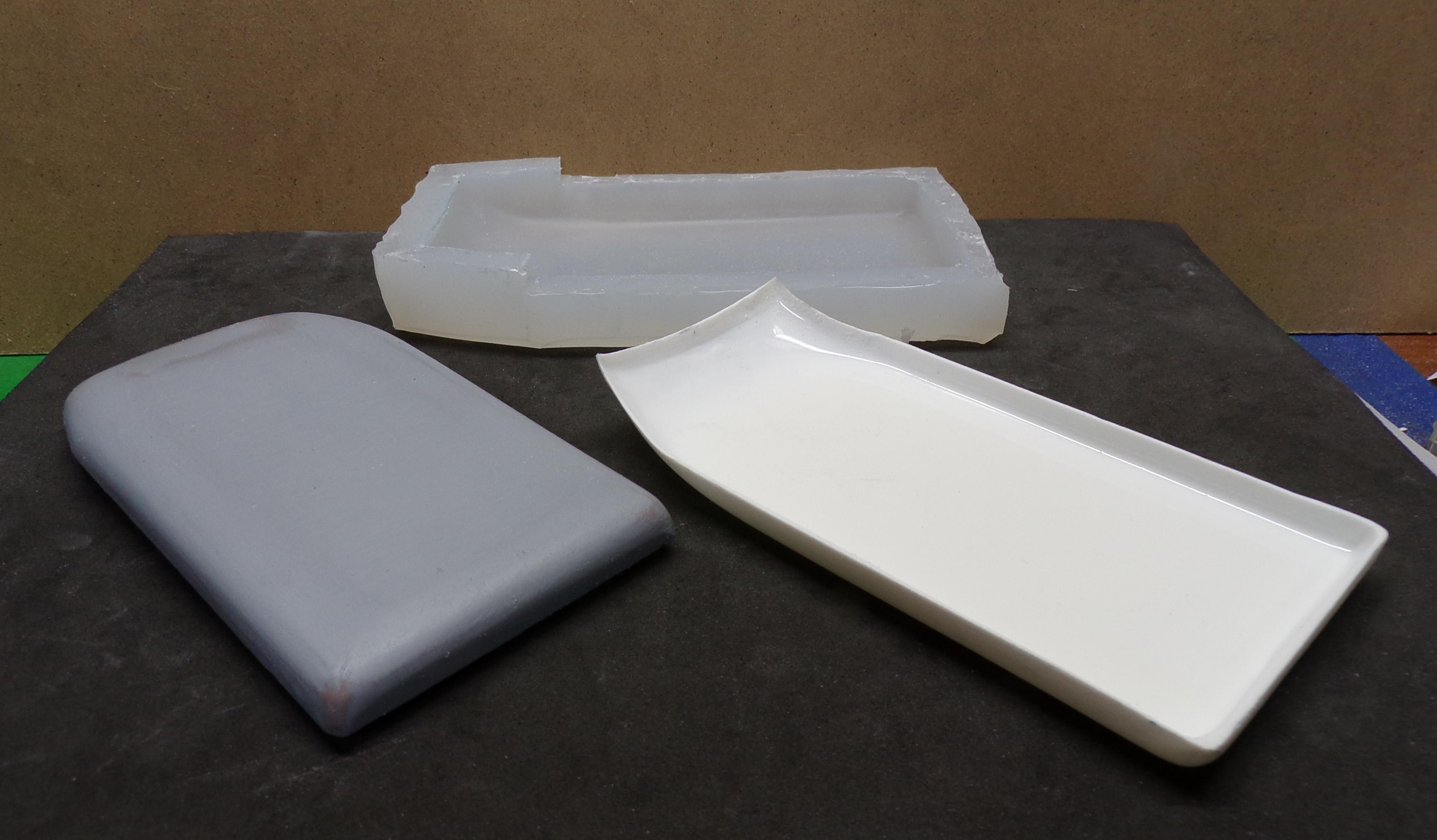

Dom: Why does the first part of the mold appear to be uneven around the tire? When you do the second pour it's good to just let the RTV move slowly against the tire and let it seek its own level. Hopefully the tire was sitting on a level surface to begin with. Just wondering.
It's more of a dabbing procedure rather than running the brush across the tissue. Yes, you do have to be careful not to tear it in the process but it does work.

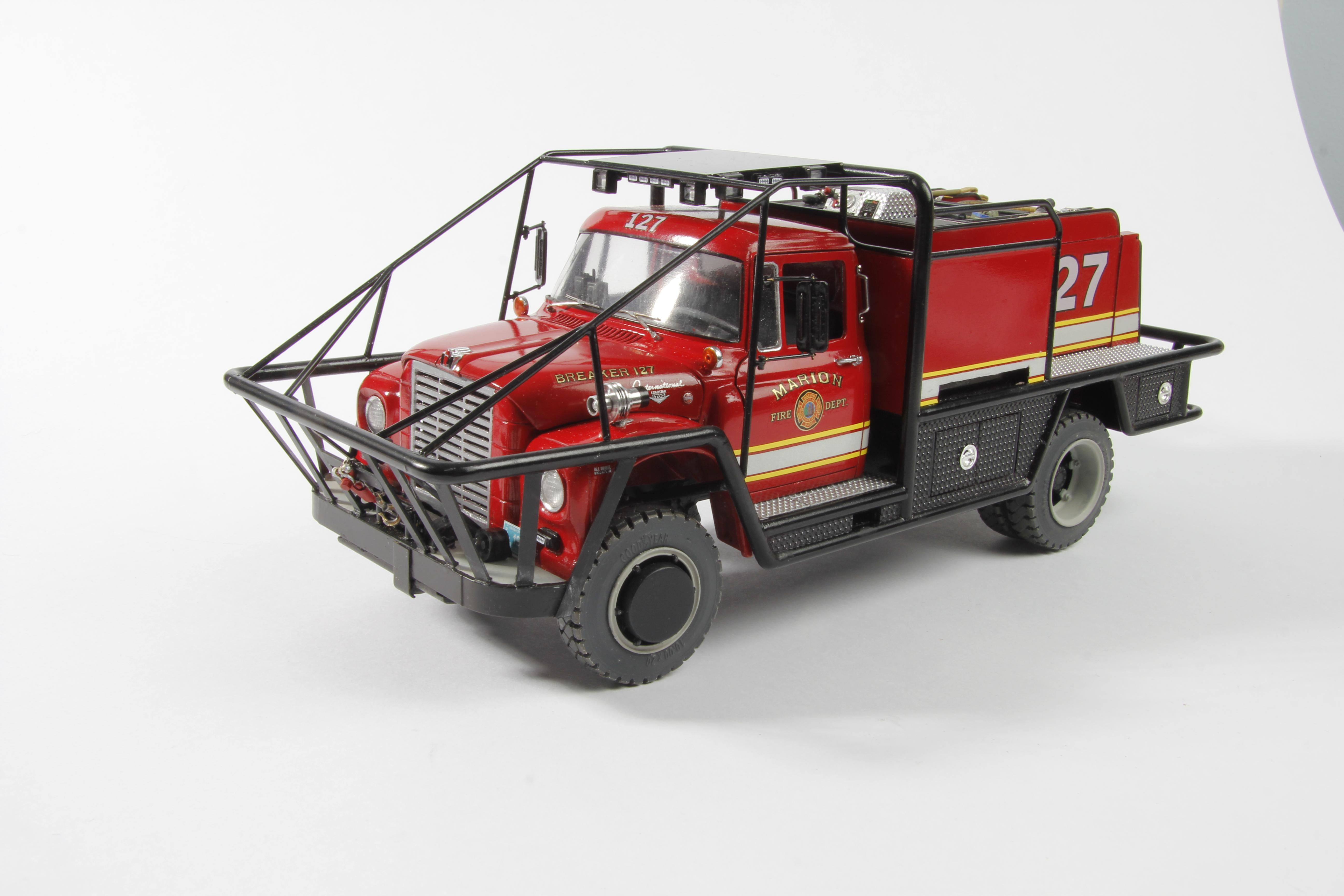

I should have taken photos of what I started with but the box art will have to do. This tractor was built up but not in good condition so I took all the pieces down, cleaned them except for the frame, which was left dirty and built a dump version. The sleeper was removed, a new back wall for the cab built, fuel tanks cut down, tool box and air tank added, new mud flaps and a new body made of Evergreen sheet and strip stock was installed. The paint on the cab is Tamiya British green. Red is Duplicolor and the body is Duplicolor primer gray. The decals were printed on ALPS. Zoet Chrome pens cleaned up some of the smaller pieces and Fusion Film was used on the modified exhaust stack. The hoist is made of aluminum tubing and the tail gate opens with the handle next to the cab. A fun restoration for a change.βΊοΈ

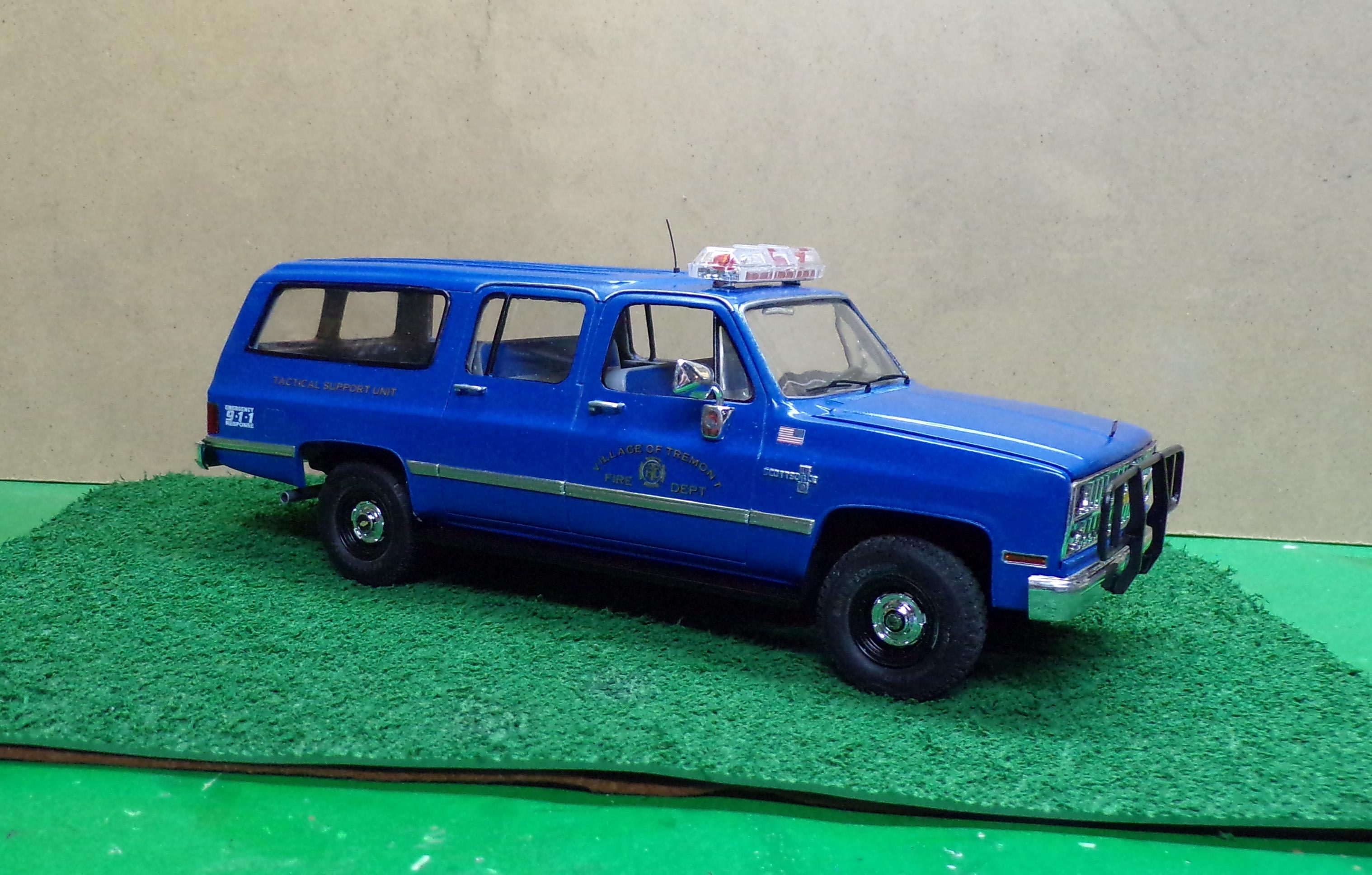

I had a friend give me a piece of reflective vinyl once that they used on real municipal vehicles. I cut it into the strips I want and lay it on. Super sticky backing so it has to go on correctly the first time but they do look nice. Here's an example. The yellow stripes are 3M tape. The white ones are the reflective vinyl.
