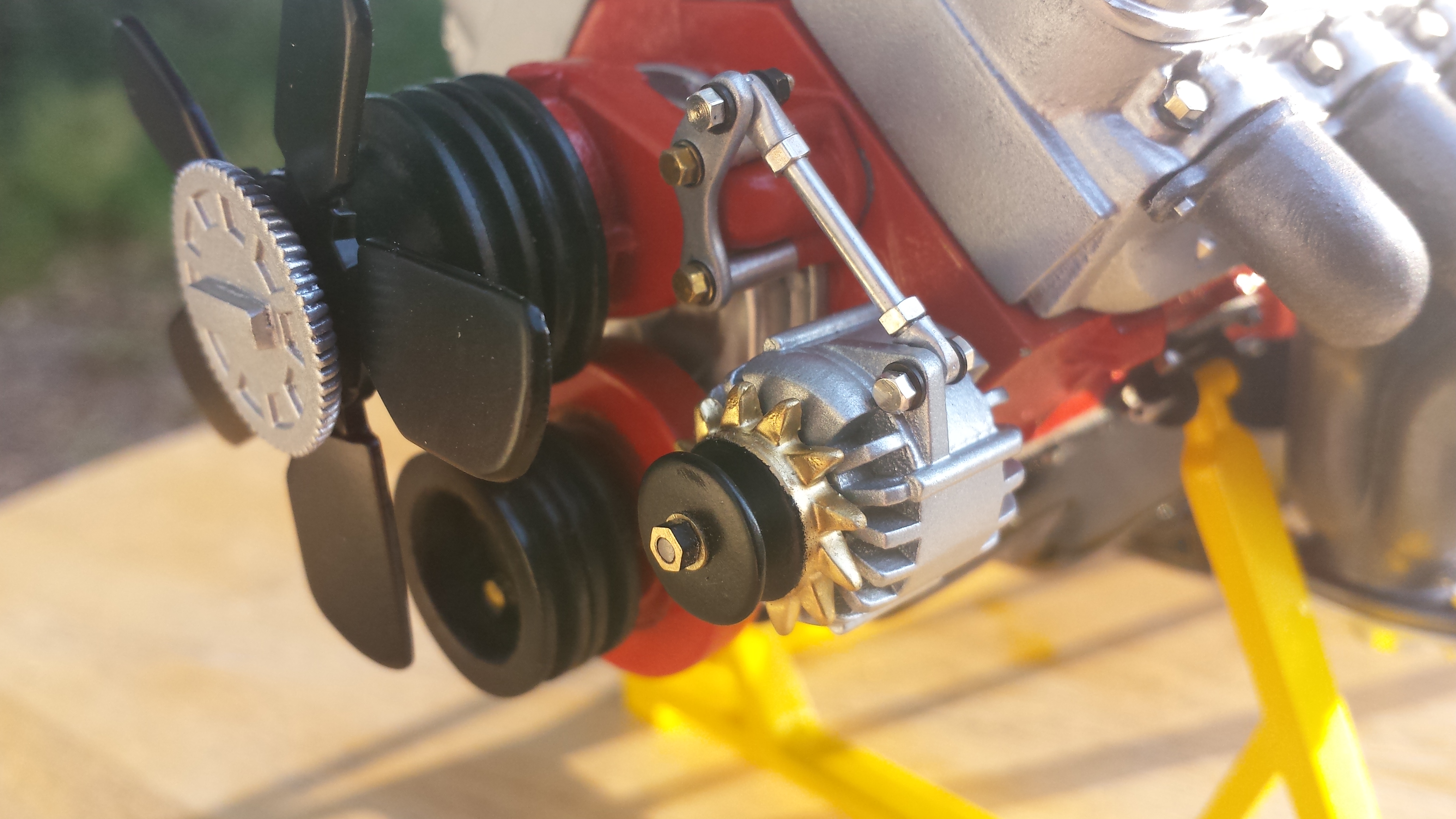

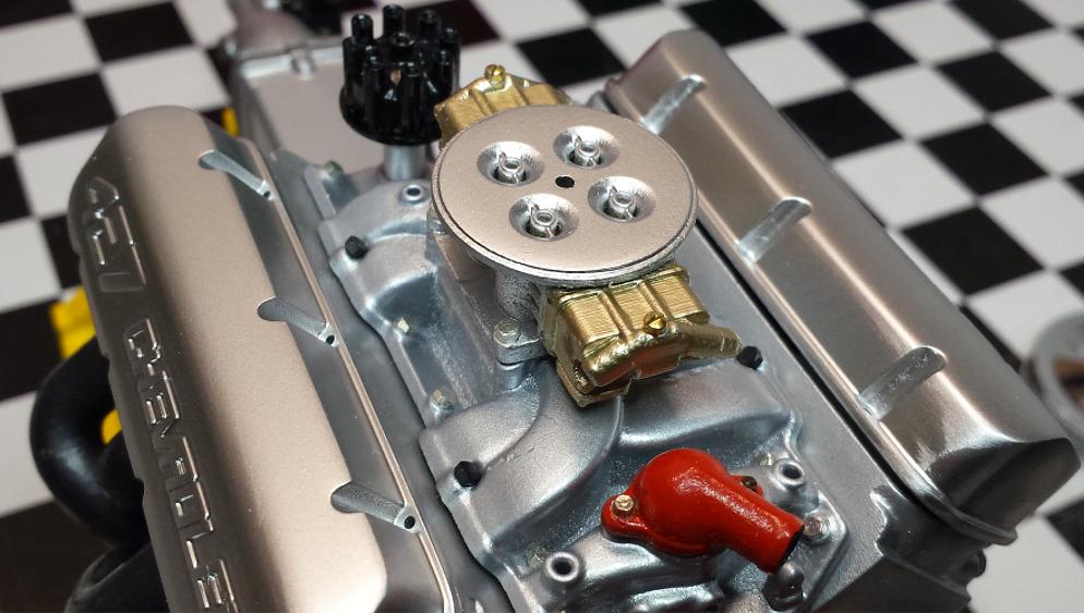

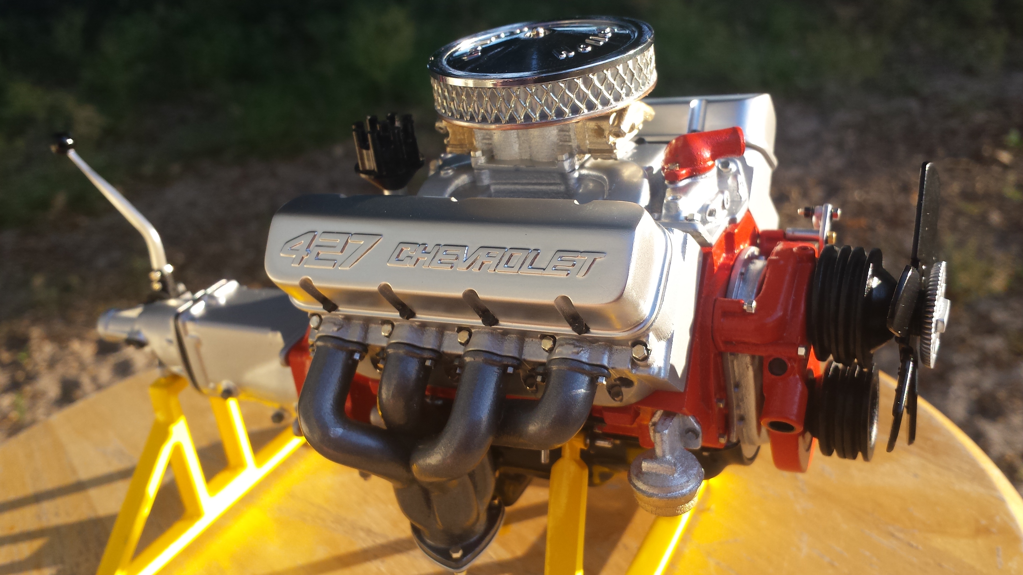

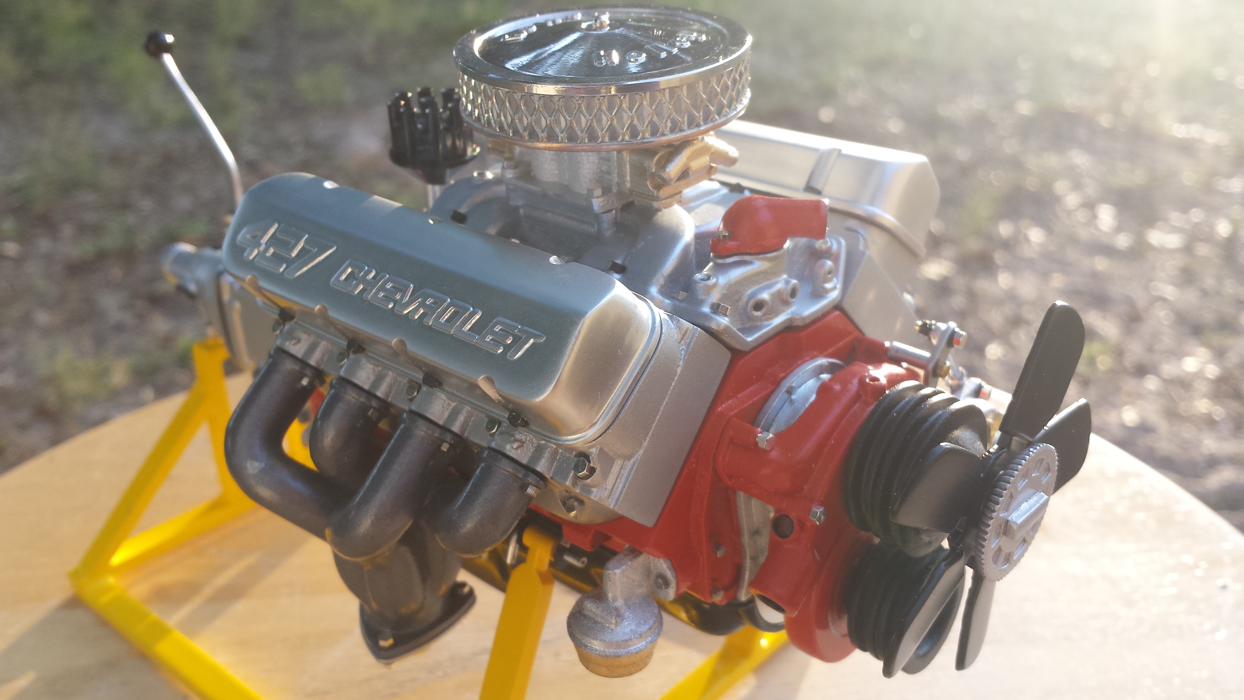

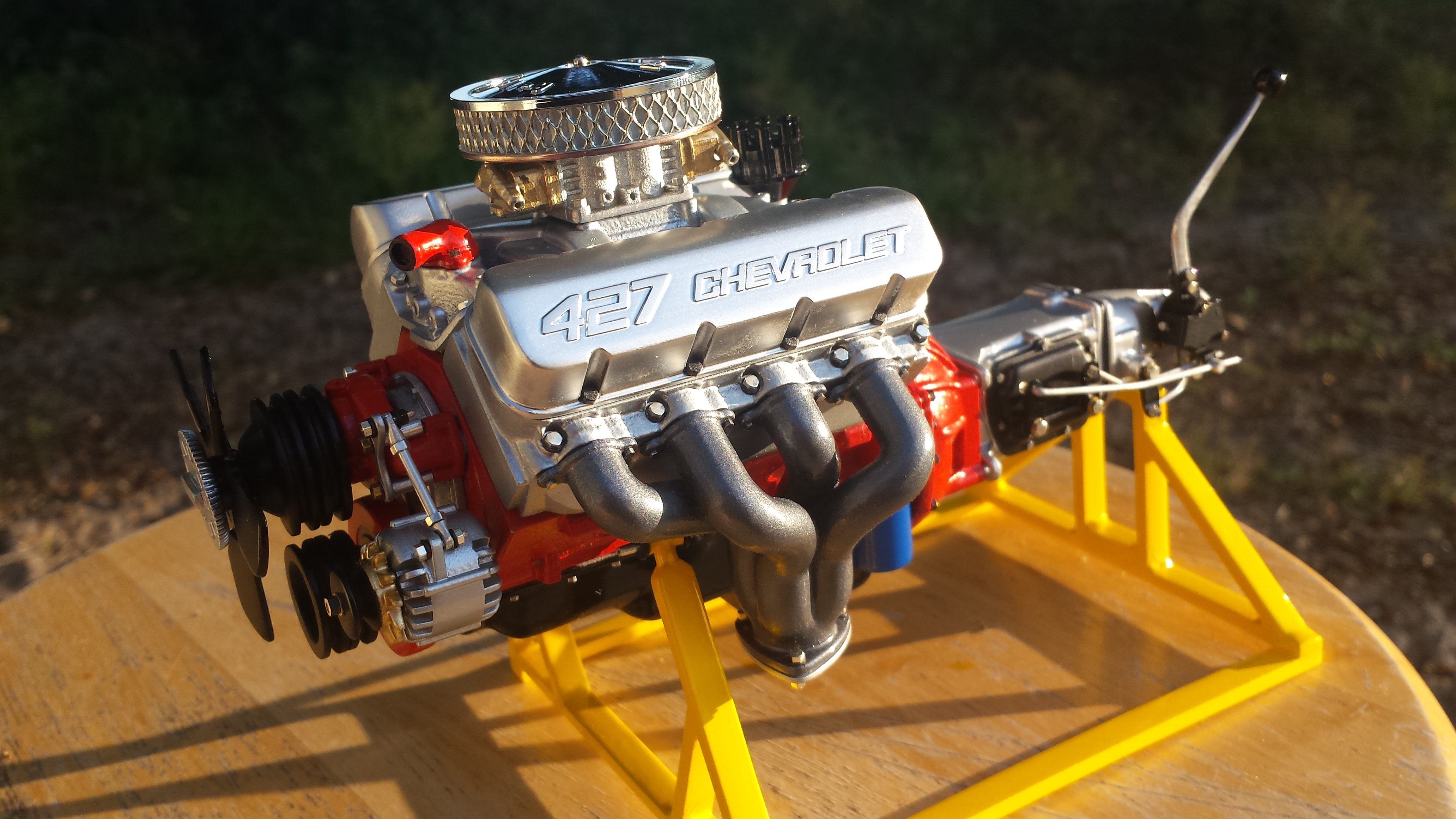

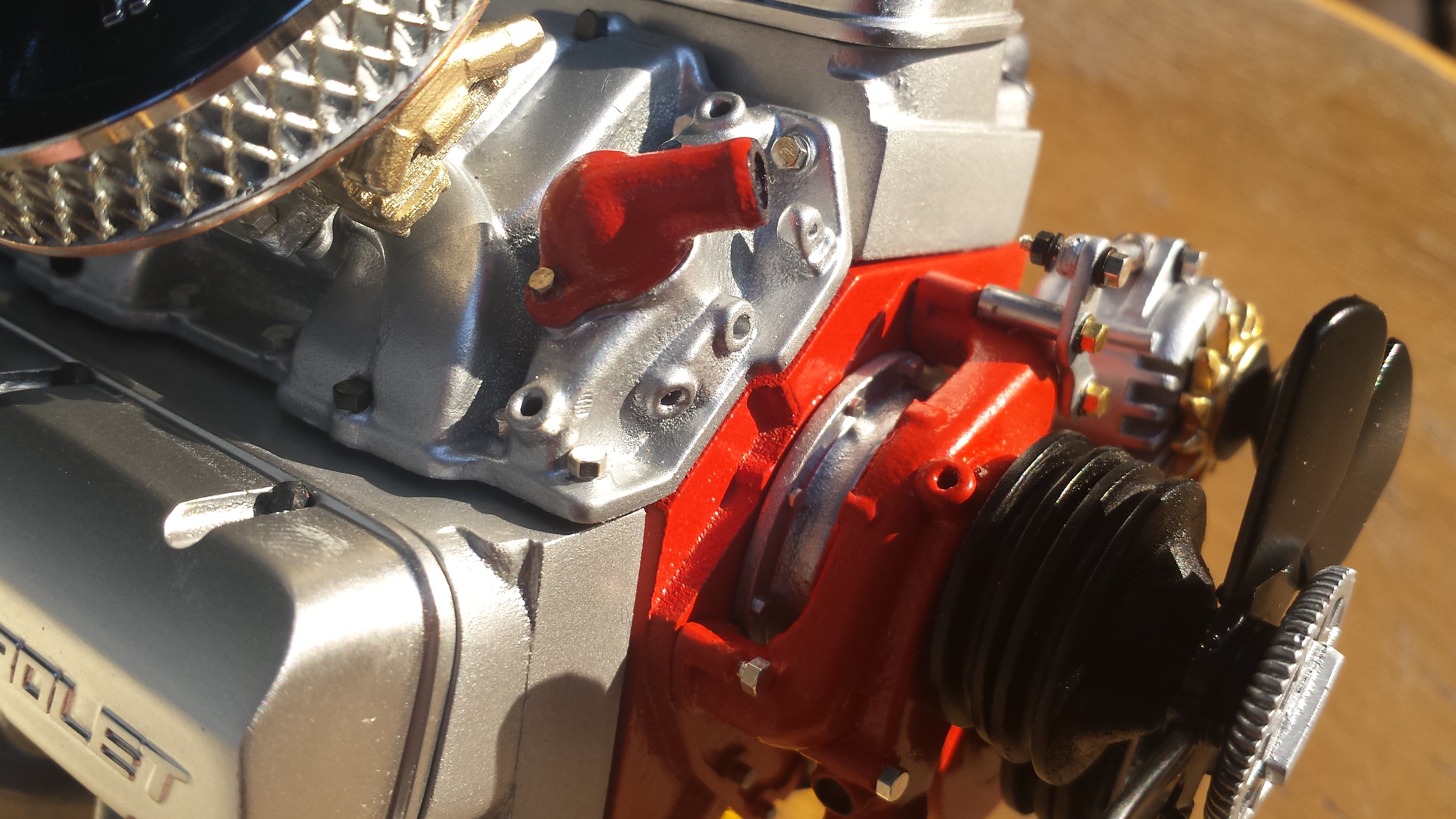

  2. Thanks guys. Test fit pulleys, made alternator bracket and adjustment rod. Almost time to start permanently attaching assemblies.

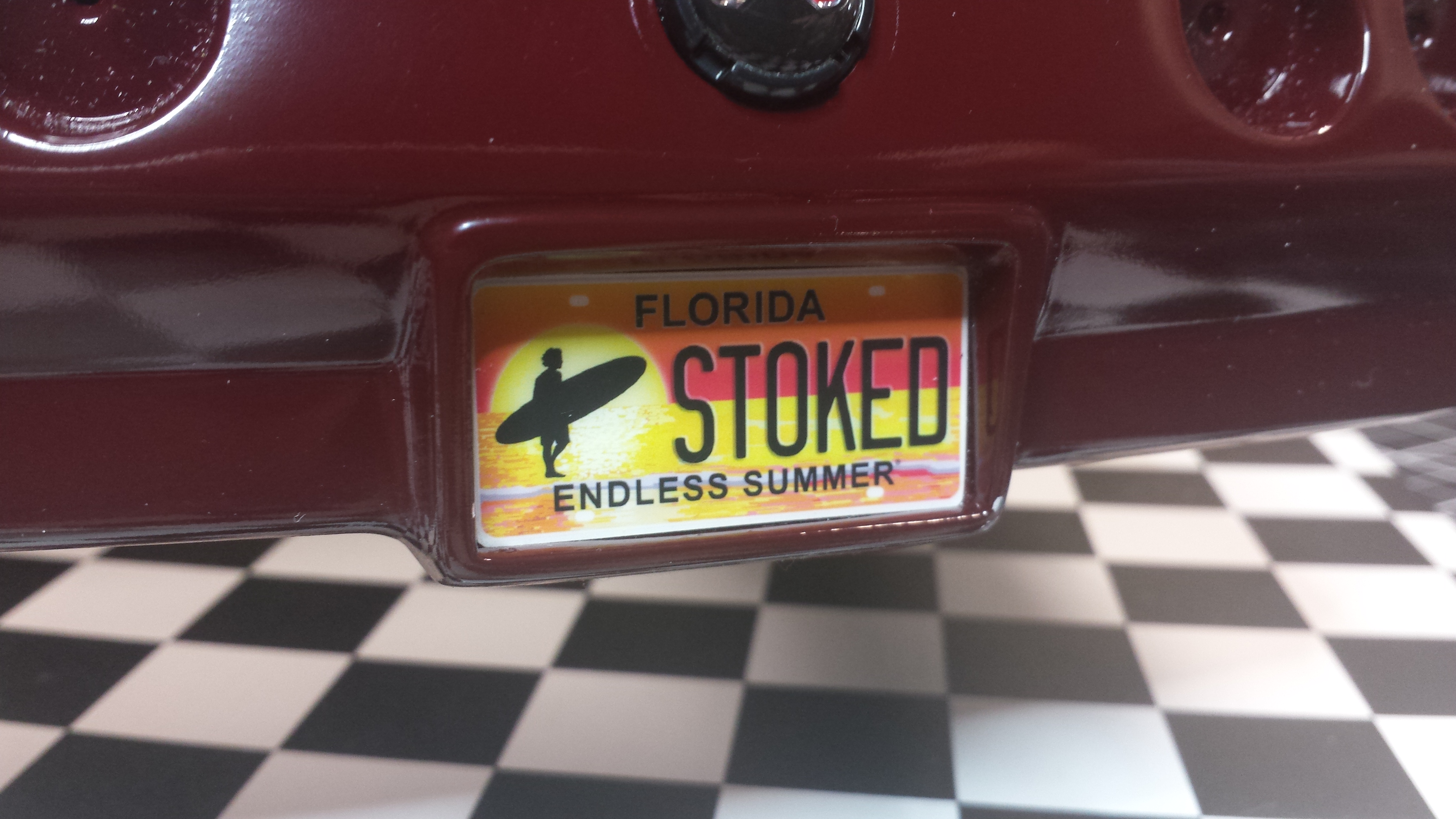

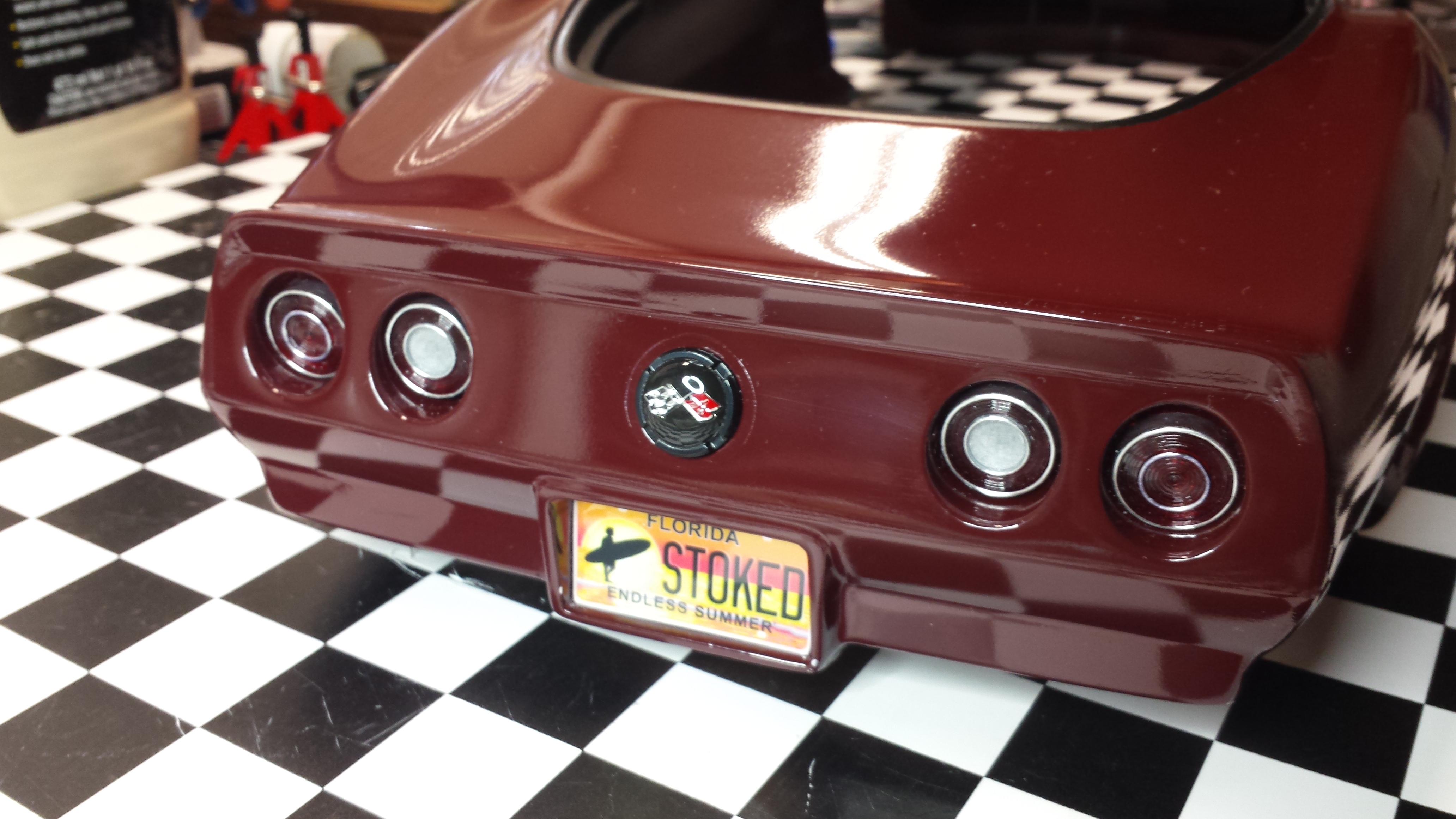

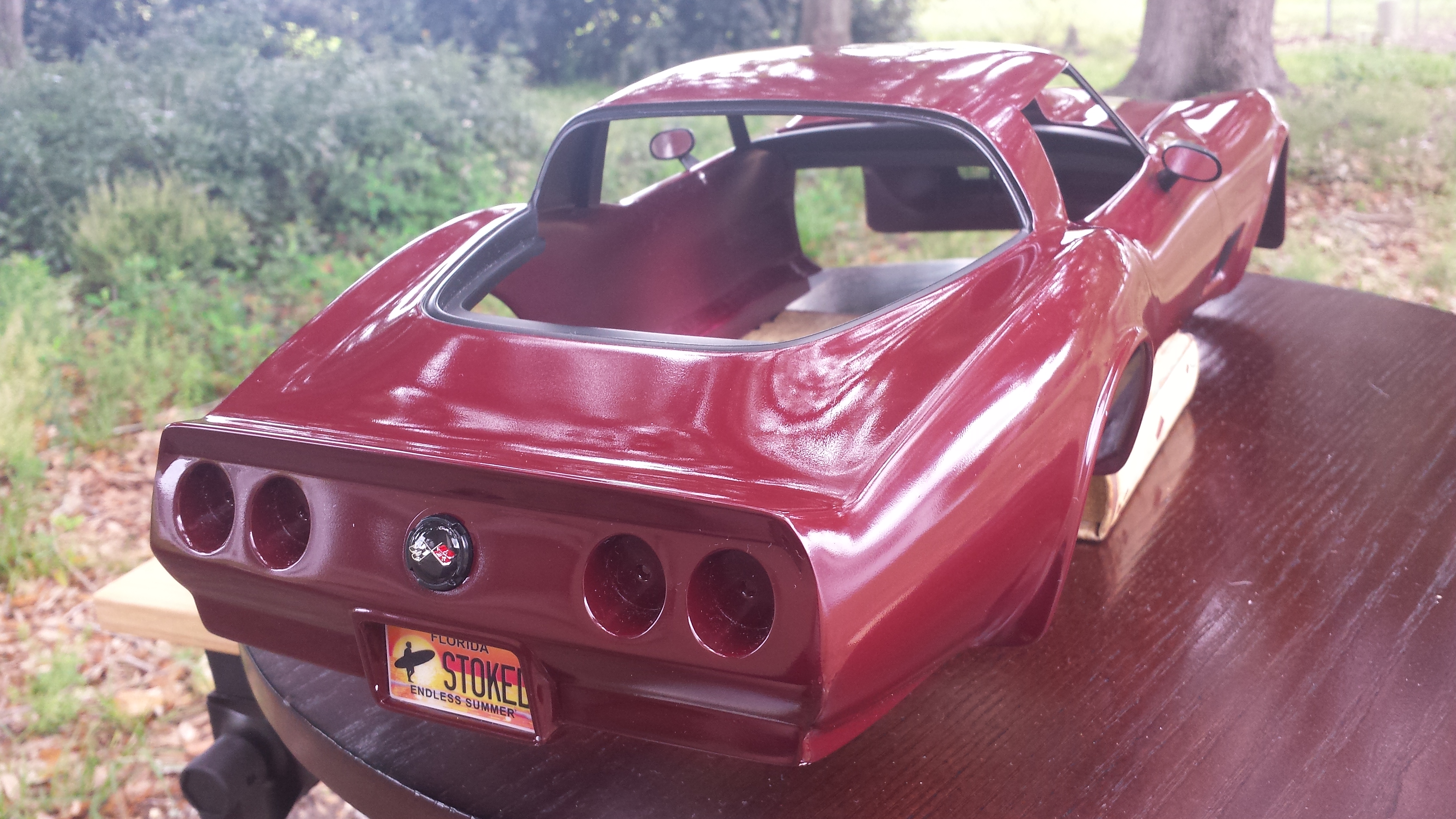

  4. I finished the tail lights last night. I tried painting the back side of the back-up light lens flat white but it looked way too white from the other side. Also, the stem that mounts the lens shows as a small clear dot in the middle. So I cut off the stem and sanded the lens back smooth. I then used a Molotow 2mm chrome pen to color the back. Much better. I used the same pen to highlight the edges of all the lights, similar to an earlier C3 Corvette. The red lens' clashed with the maroon body color without the chrome trim. Next up is the license plate.

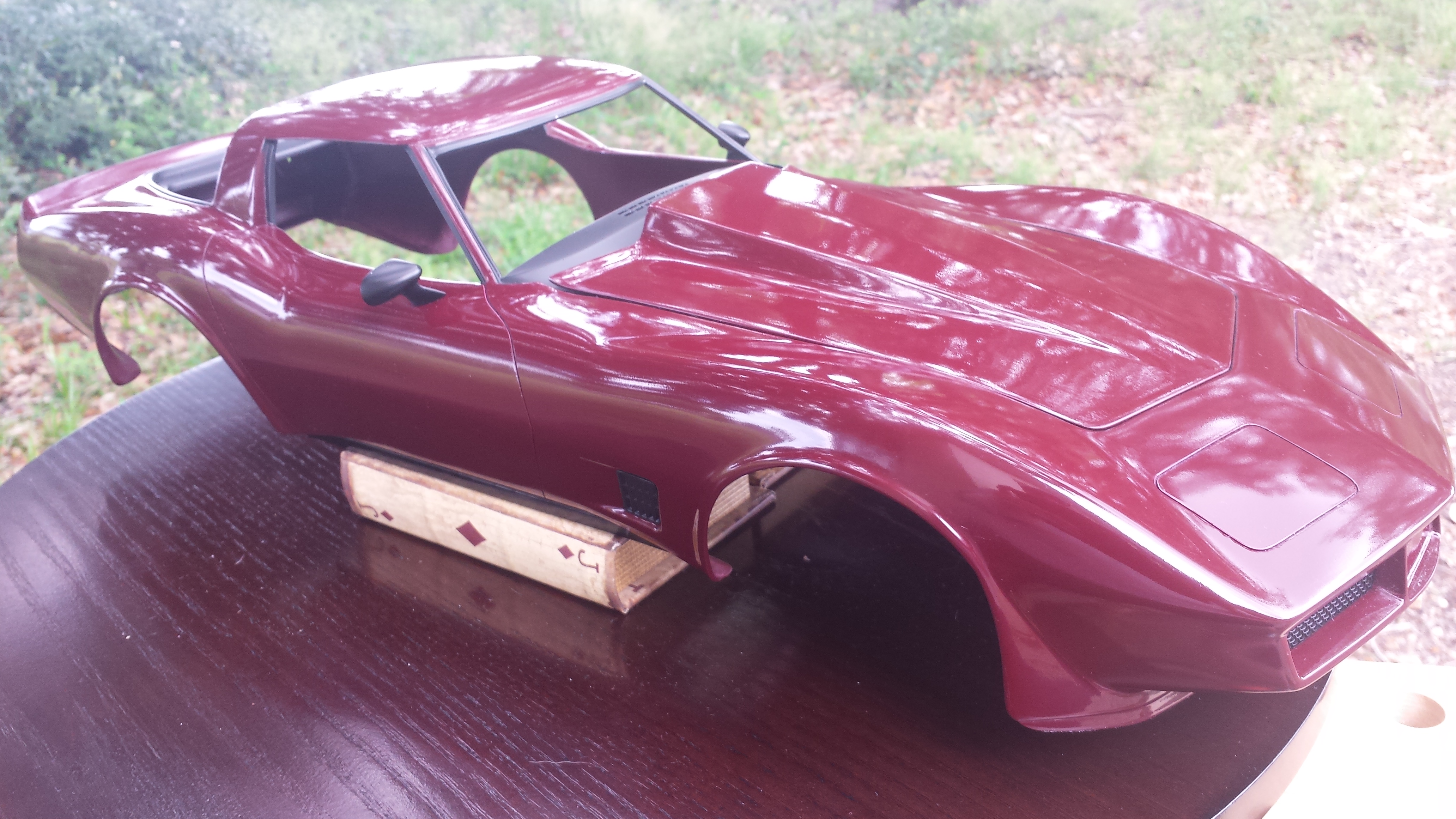

  5. The real car was photographed outdoors which greatly effects how it looks. Personally, I think it looks closer to TS 16 Yellow. The Corvette below is painted Camel Yellow and under fluorescent lighting it looks close to the photo. Chrome Yellow to me is close to school bus yellow.
  6. I use Tamiya TS colors from a can exclusively. They are a synthetic lacquer and are very forgiving. Problems with the finer colors showing scratches, you may want to use the Tamiya Gray primer (regular - not fine). It is much thicker than the Fine White or Fine Gray. Check out my big scale Corvette in the Big Boyz section. This was done with TS11 Maroon and no clear coat. I don't go higher than 600 grit sandpaper between coats. Instead, I try to avoid dust on the final coat and use Meguiars #7 Show Car Wax to smooth things out. Not perfect but works fine for me. If you let the cans sit in hot (not boiling) water prior to using you will have minimal issues. And shake, shake, shake between passes. I hope this helps.

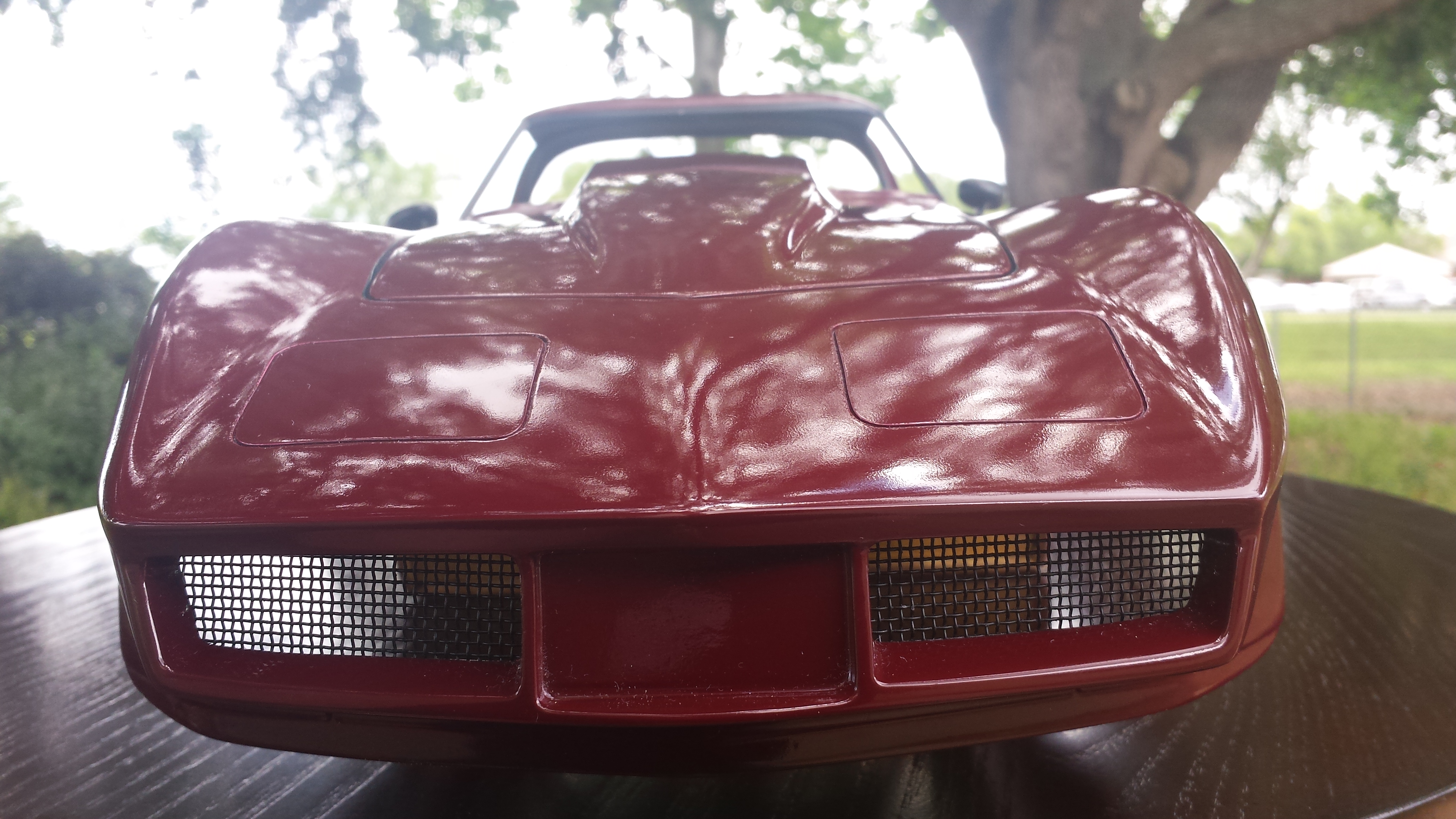

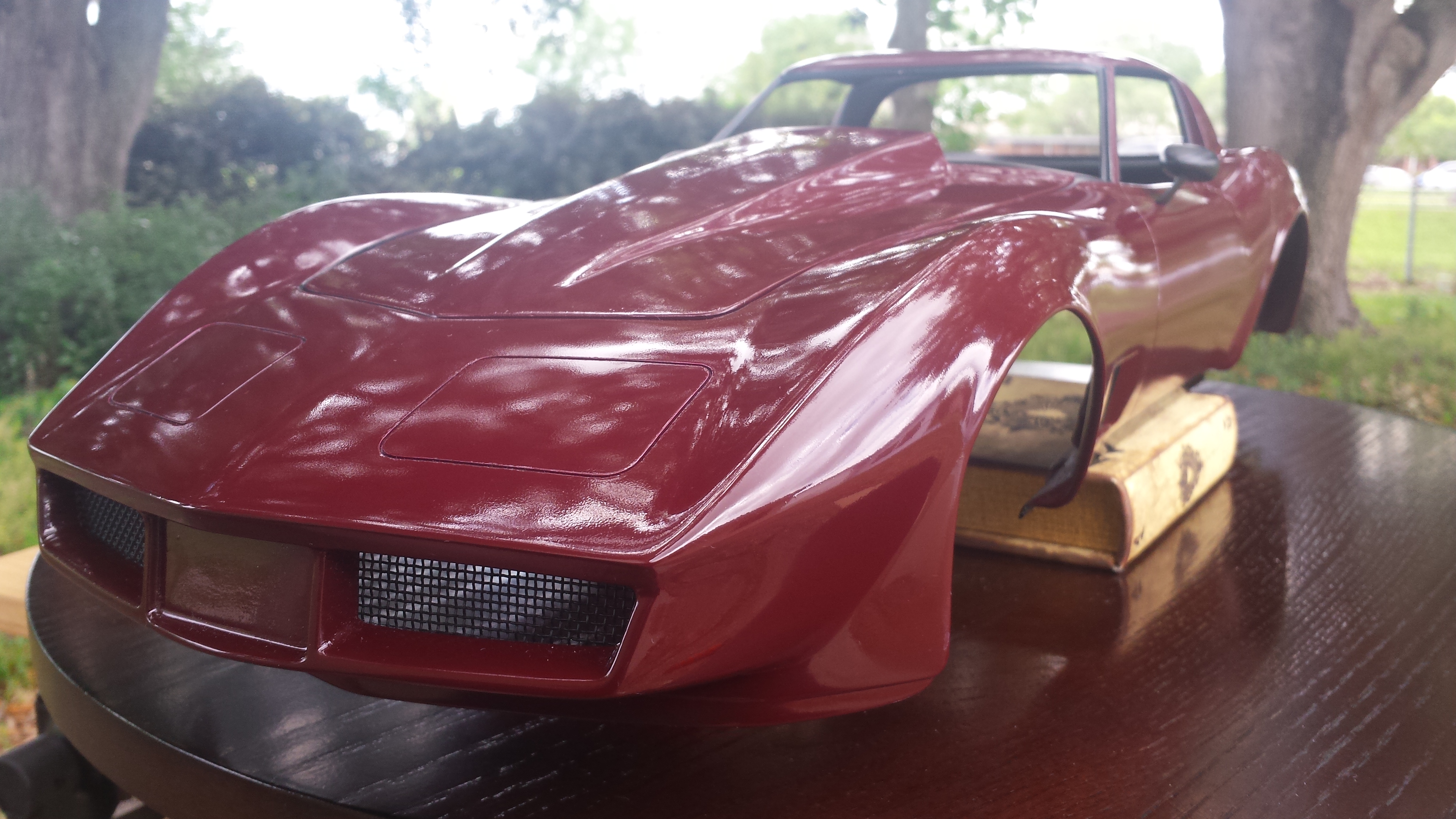

  8. And here are the outdoor shots which show more contrast and detail.

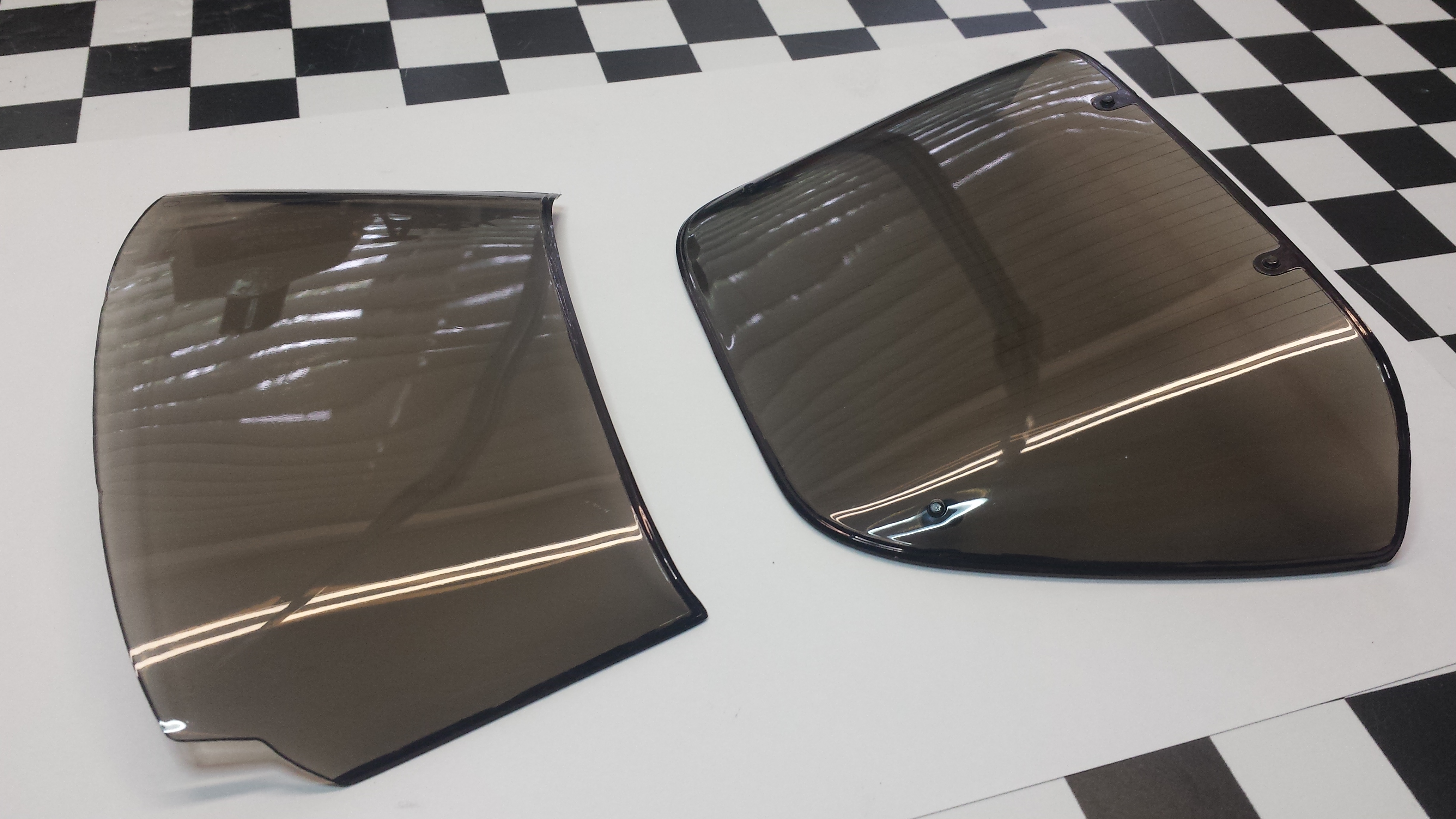

  9. here is the window glass, after using a black Sharpie on the edges...

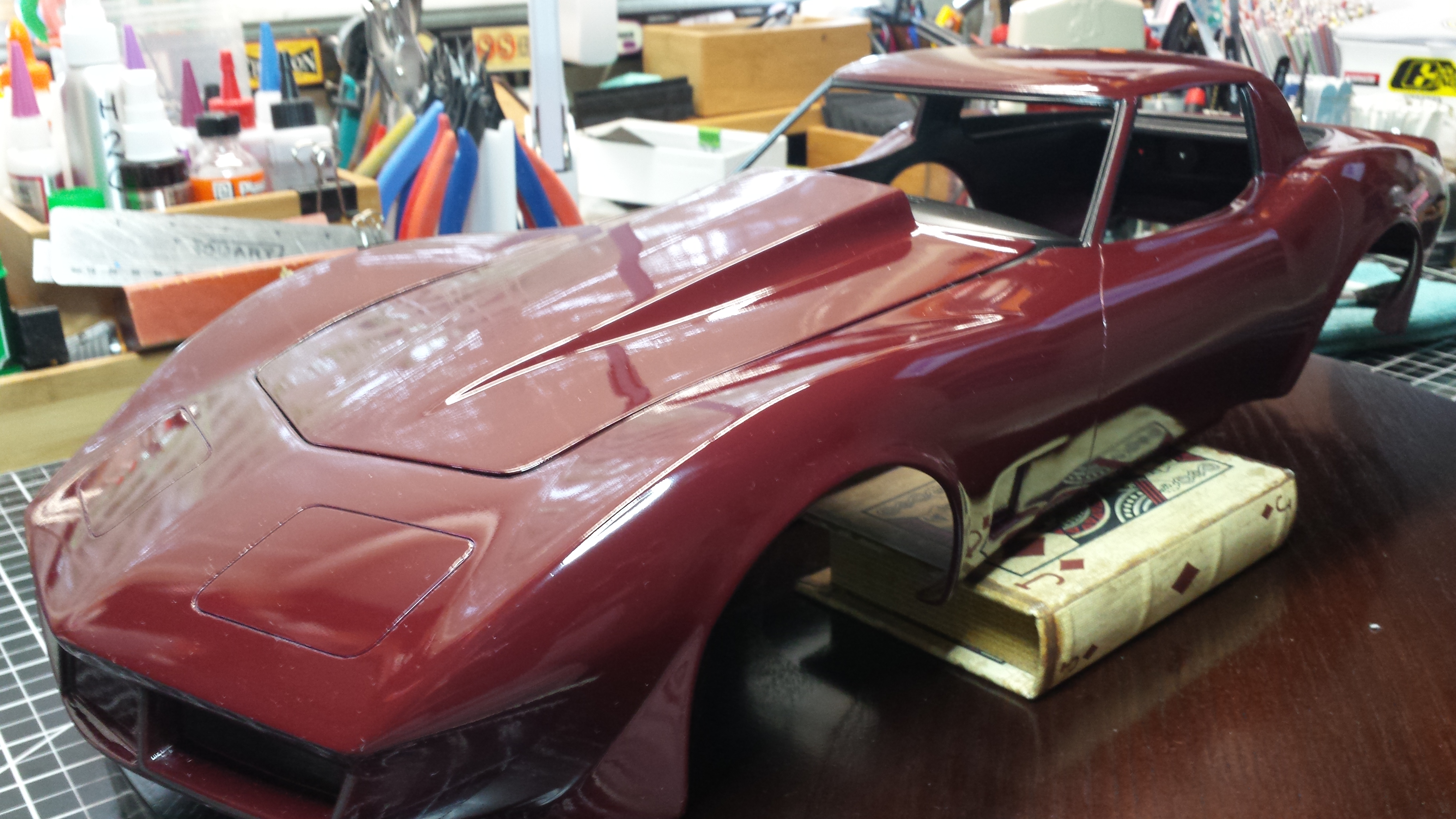

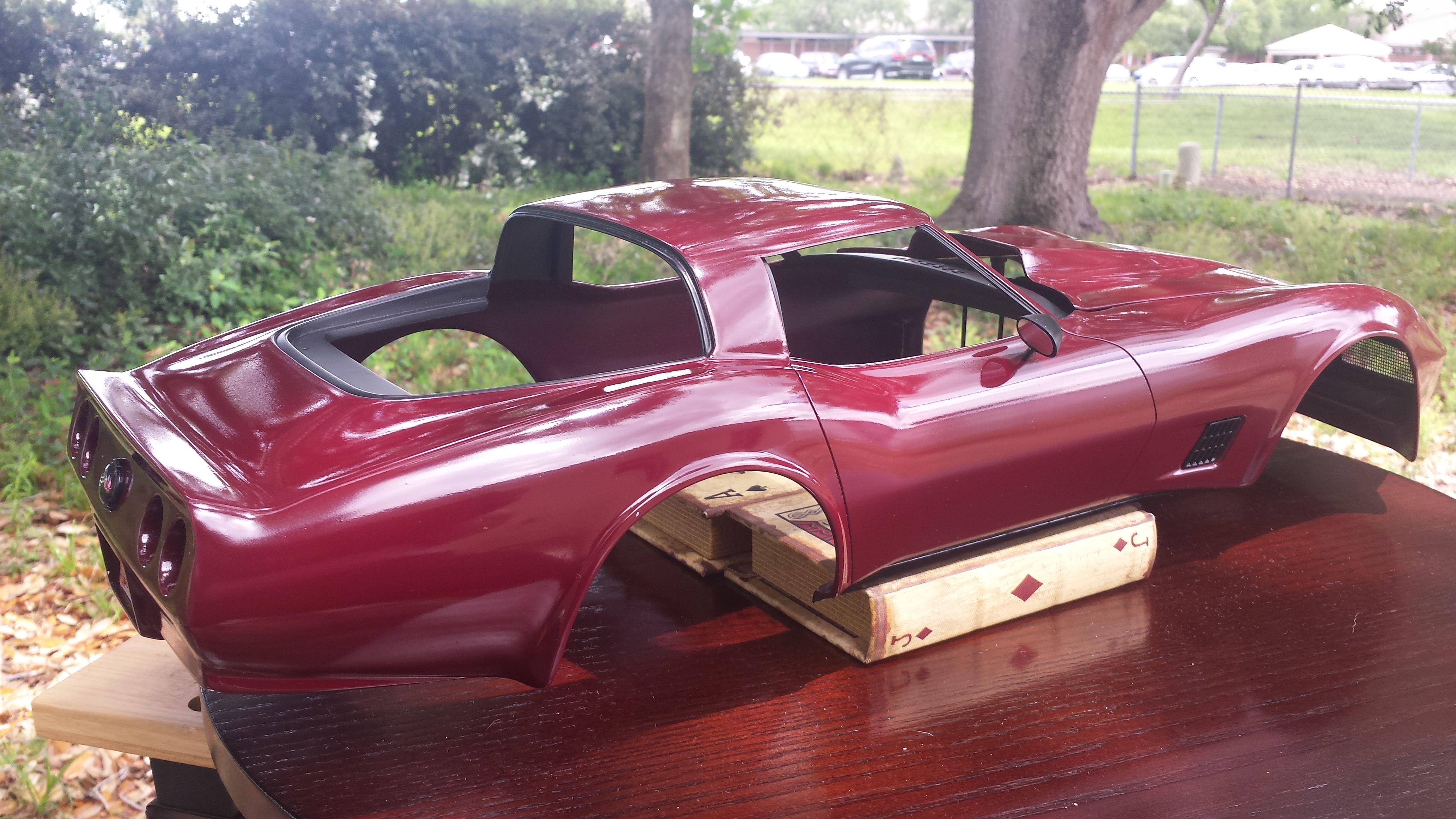

  10. I finished mounting the rocker panels, side scoops, front grill mesh and 'gascap'. The license plates (from MINIPL8S) are test fir on;e and will be mounted with mini-hardware. I may make rims also. I couldn't adjust the light to where I could get a good shot of the rocker panels and side scoops. I'll try and get some outdoor shots tomorrow, I also added some details to the tail lights and they should be ready to mount tomorrow I forgot that I won't be installing the window glass until final assembly. This is because I added studs to the body, interior and chassis that will securely join these sub-assemblies later with nuts. I'll be sure to point this out later.

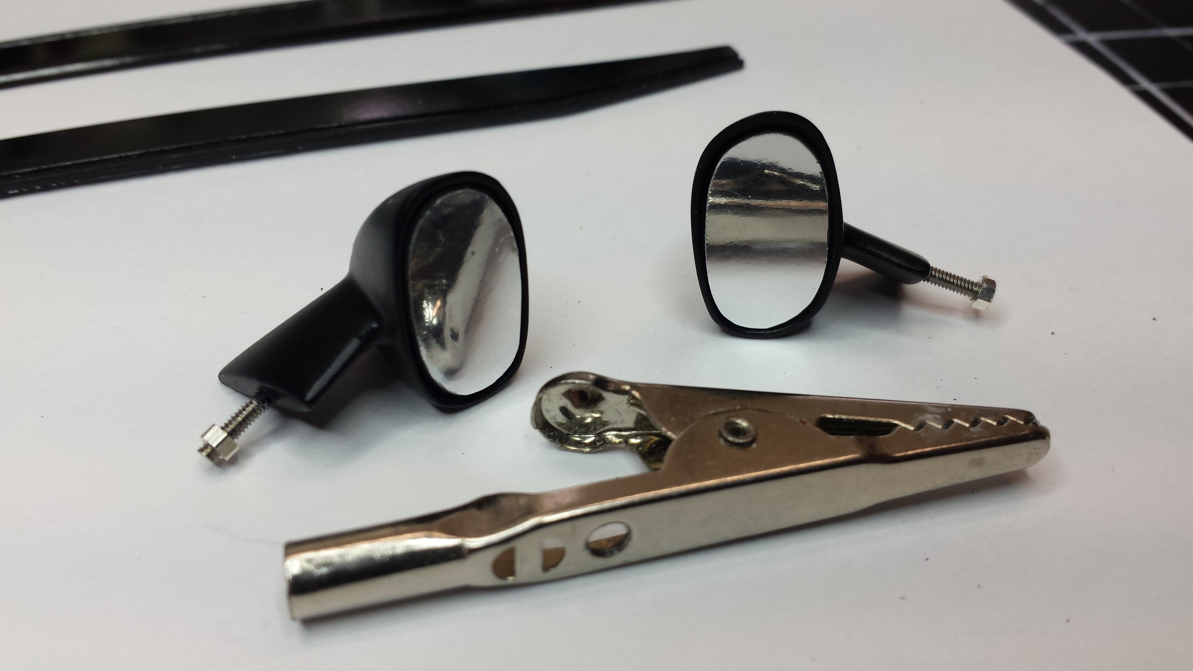

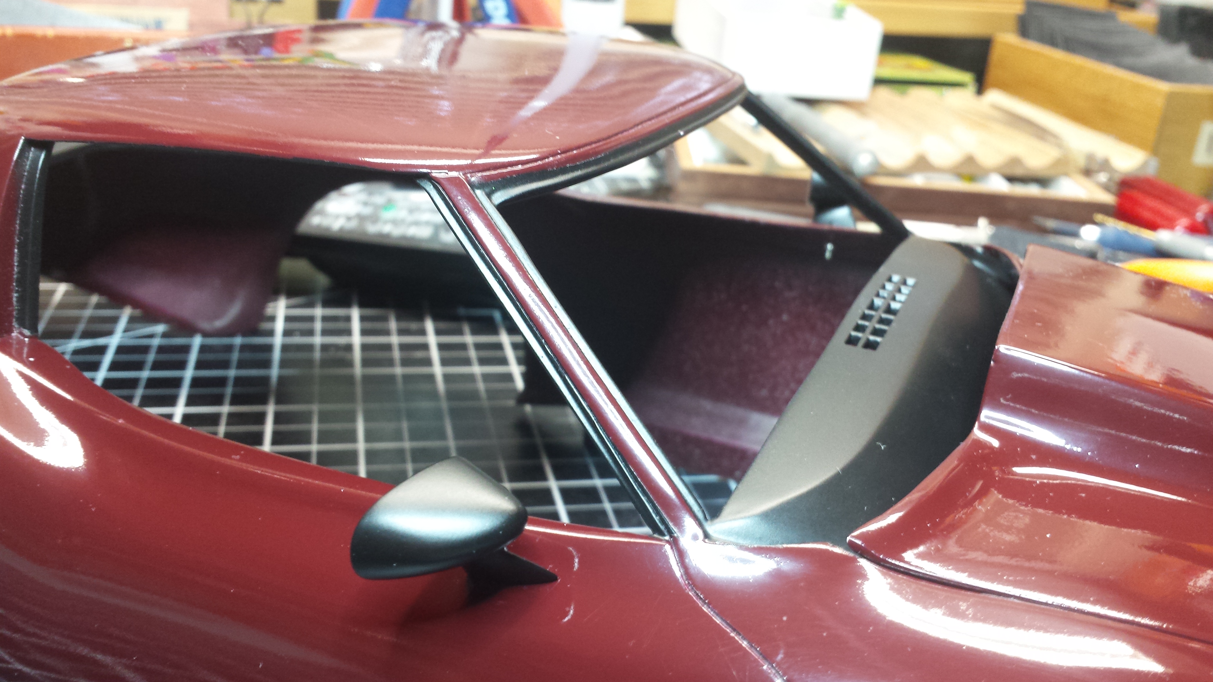

  11. Thanks Bruce. I ran into very a minor snag with the mirrors. For some reason the Monogram engineers decided to put the mirror glass on the aluminum sprue instead of the chrome meaniung there was absolutely no reflection. I sanded the face and edges of the mirrors smooth and then glued some craft store mirror paper (ususally in the scrapbooking section of your LHS) and then used a black sharpie on the edges. I then glued the faces to the mirror body using black CA. Check out the new reflection... Note the 0-80 studs & nut on the mirror body which is how the mirrors will cleanly attach to the body.

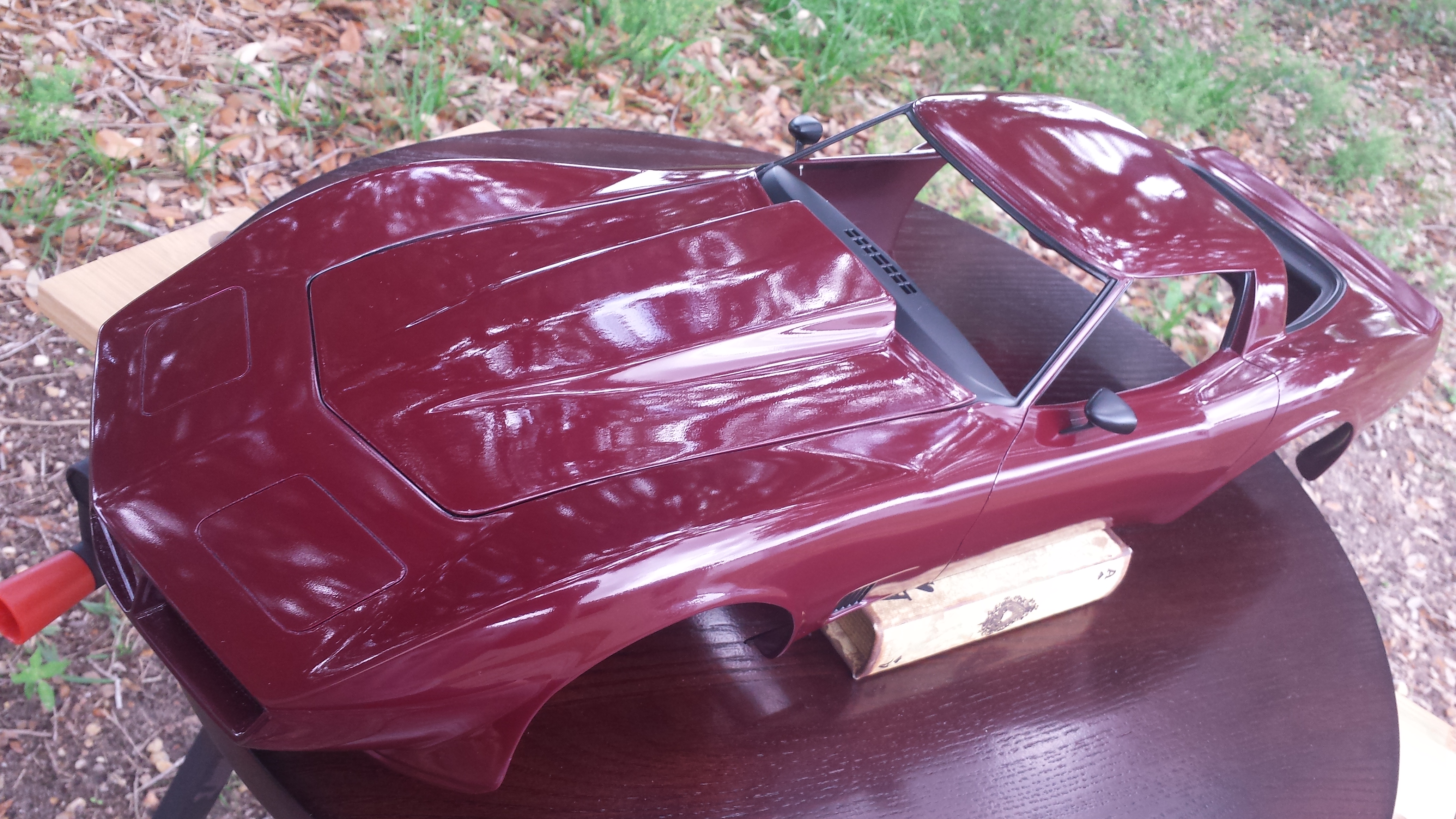

  12. Update. I finished painting all the trim on the body and then polished with Meguairs #7 Show Car Wax. I also finished painting the mirrors (matt black), rocker panels (gloss black) and side air scoops (matt black). I should be able to attach those items and the window glass by tomorrow.

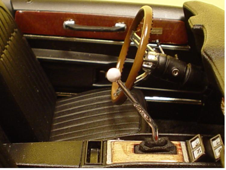

  13. Thanks Todd...Is that your 1:1 Camaro? I like the color. I built this one about ten years ago and did the wood dash thing then but it was before I developed my current process. It started to rain when I started taking pictures but I decided to just keep shooting. The effect worked I think.

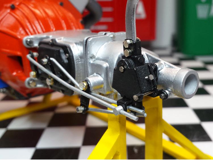

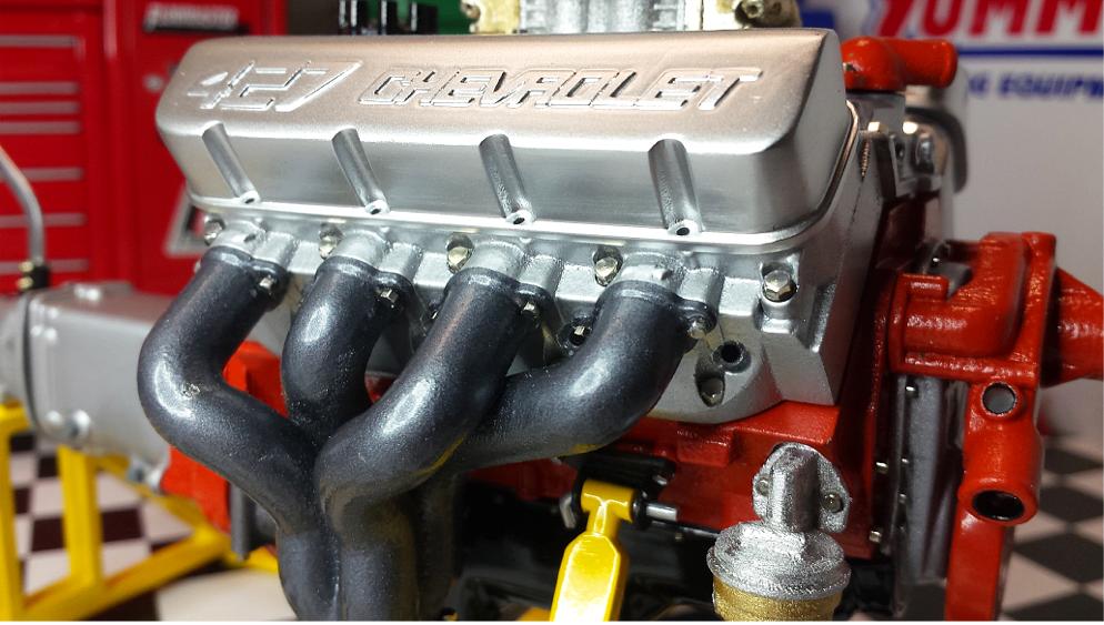

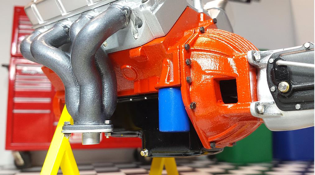

  14. some more detail work on the Muncie tranny and added bolts to the oil pan.

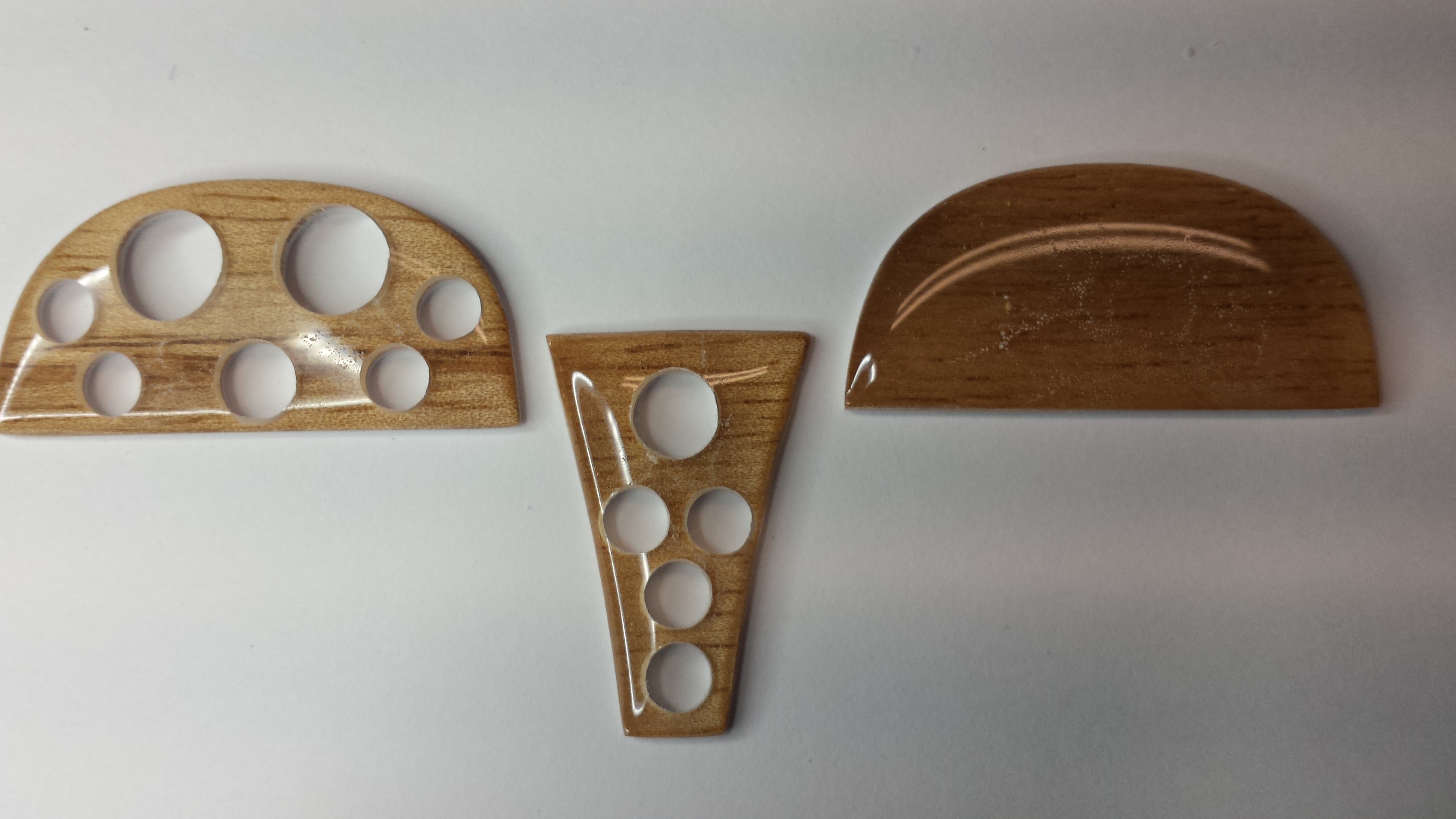

  15. Nice job John. I thought it was the Tall T when I first saw it. Here is my WIP for the Lindy T, a chopped and channeled extended cab pickup.

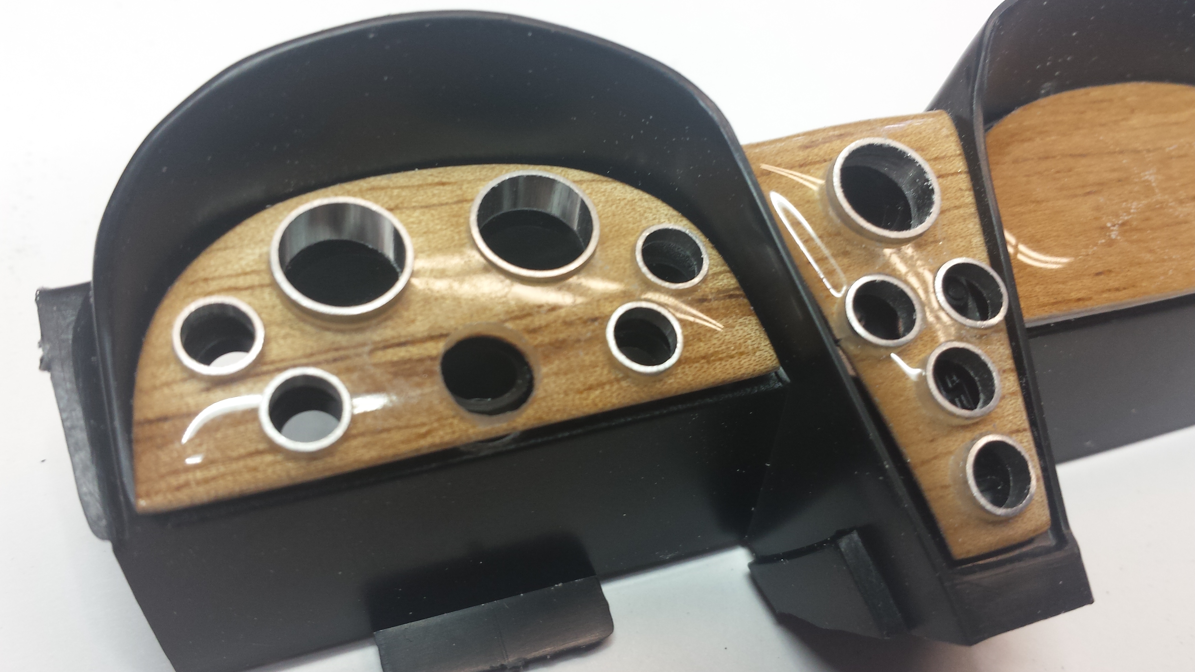

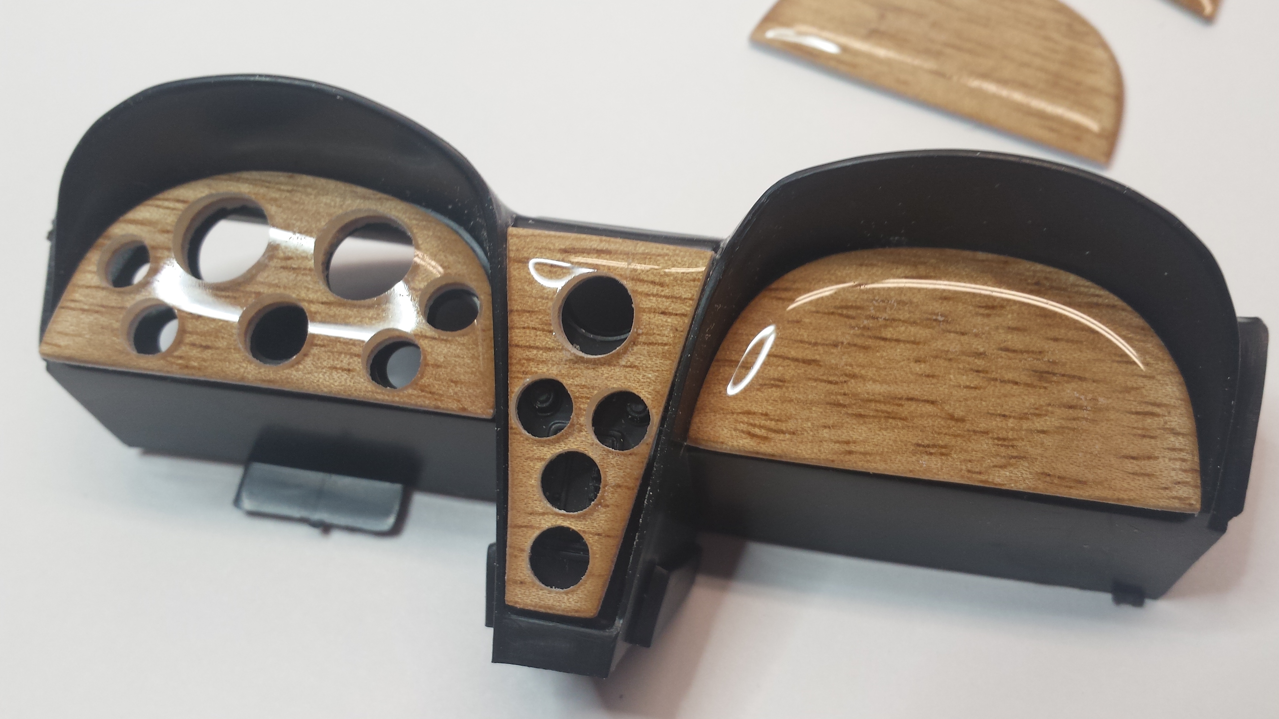

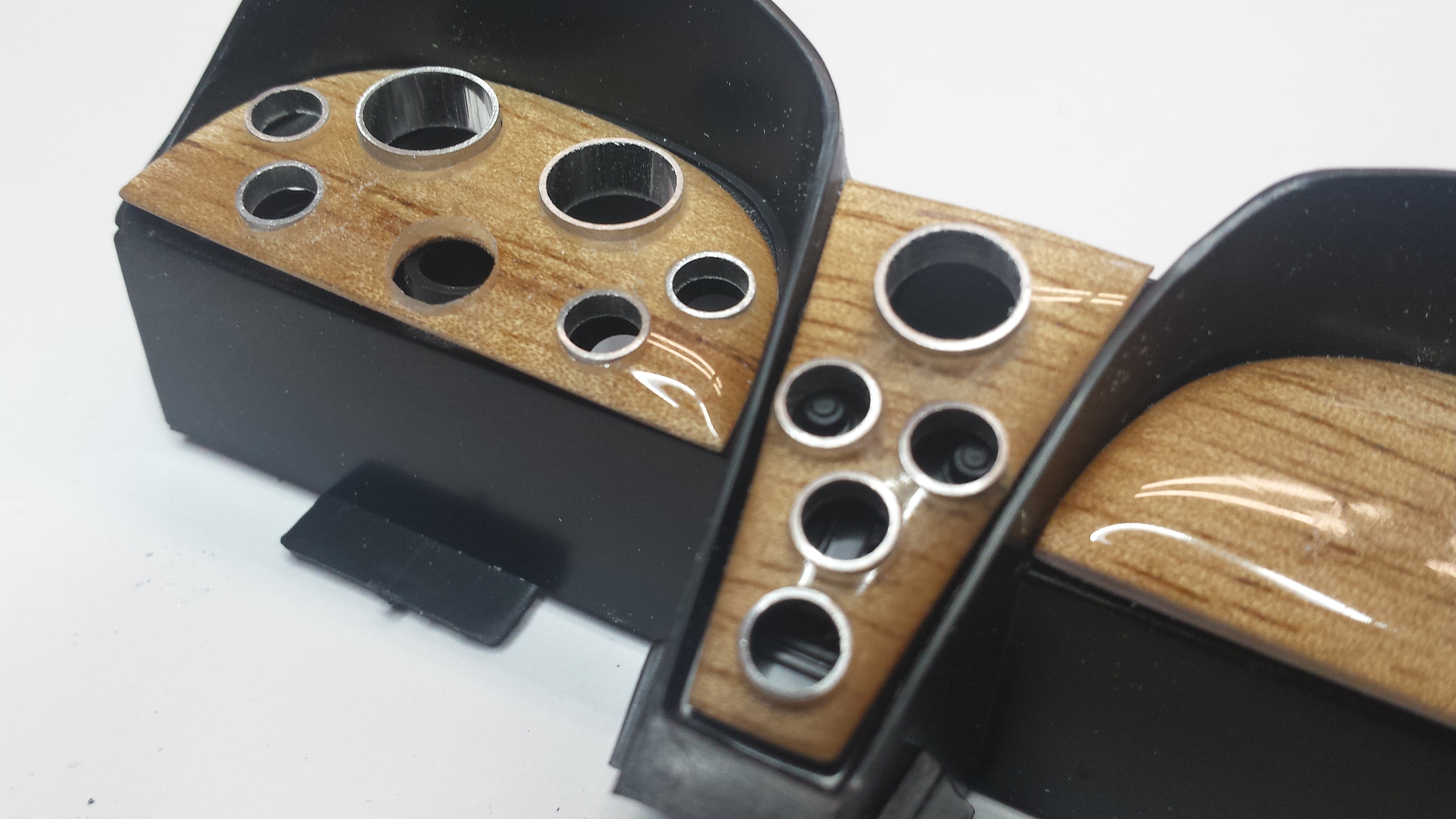

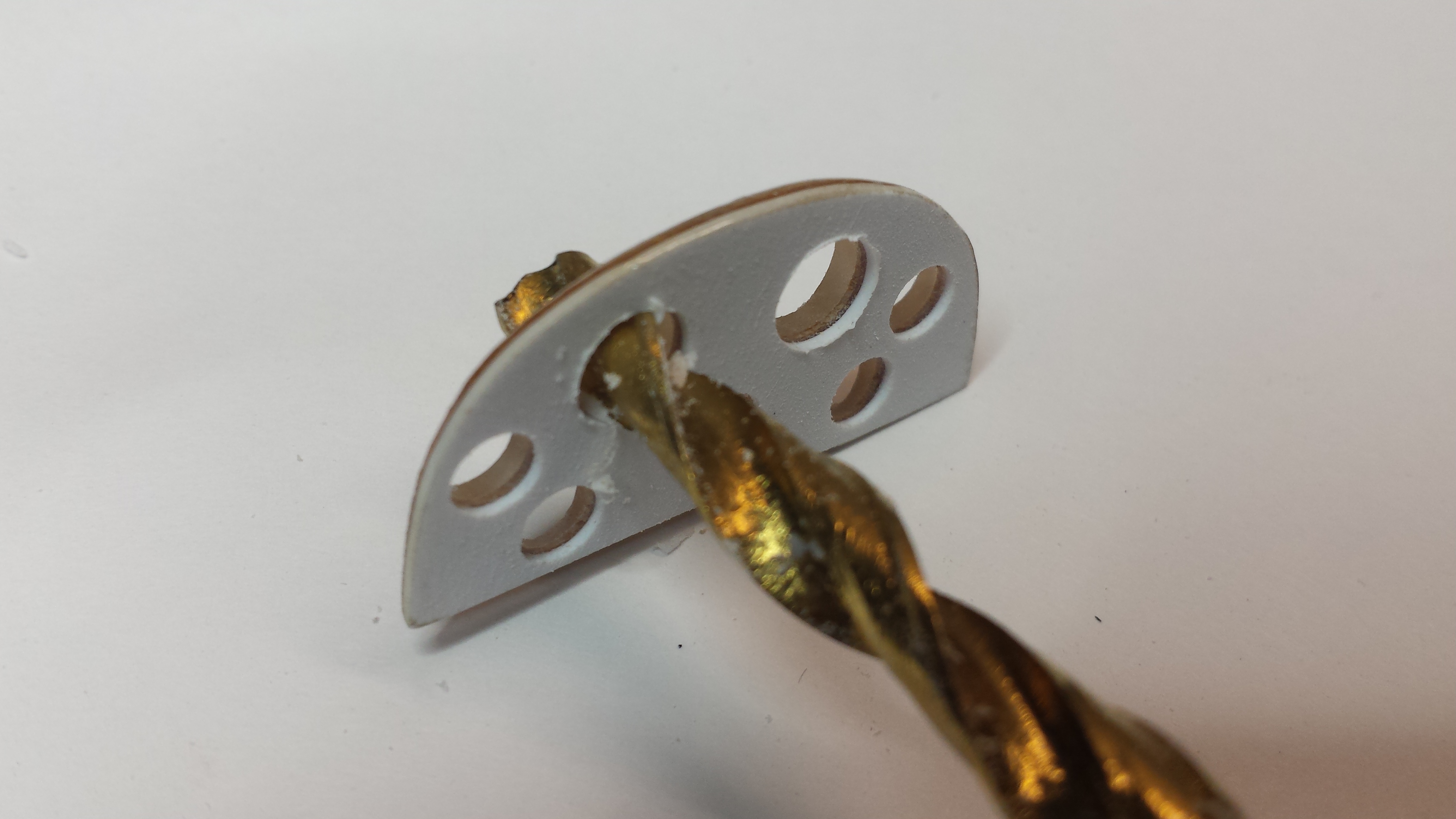

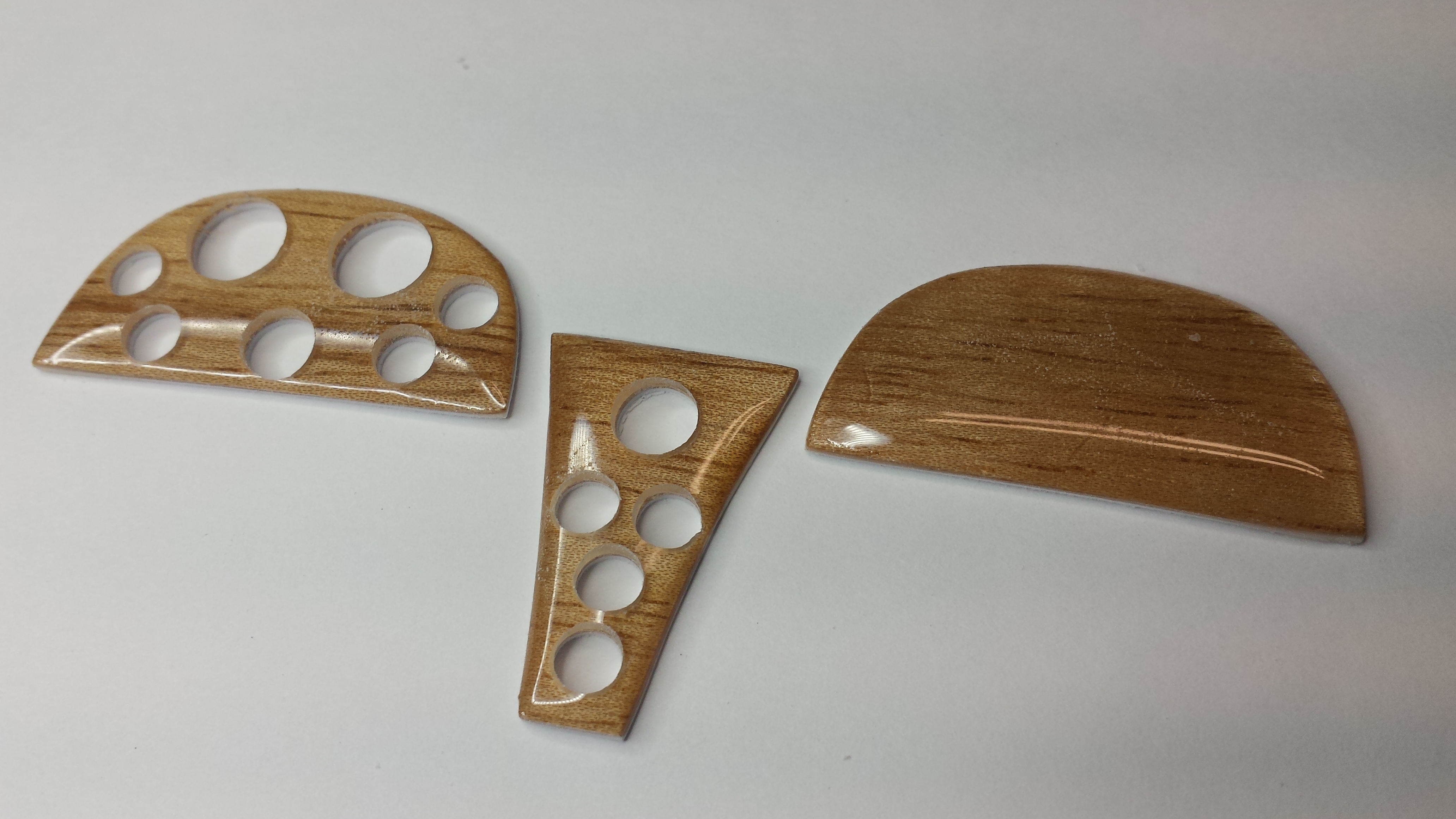

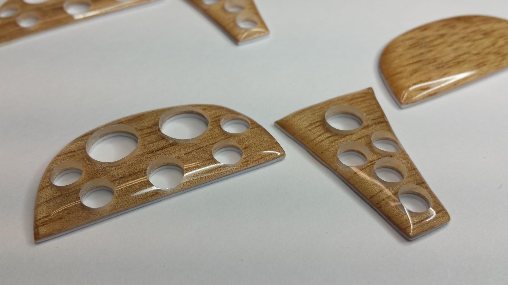

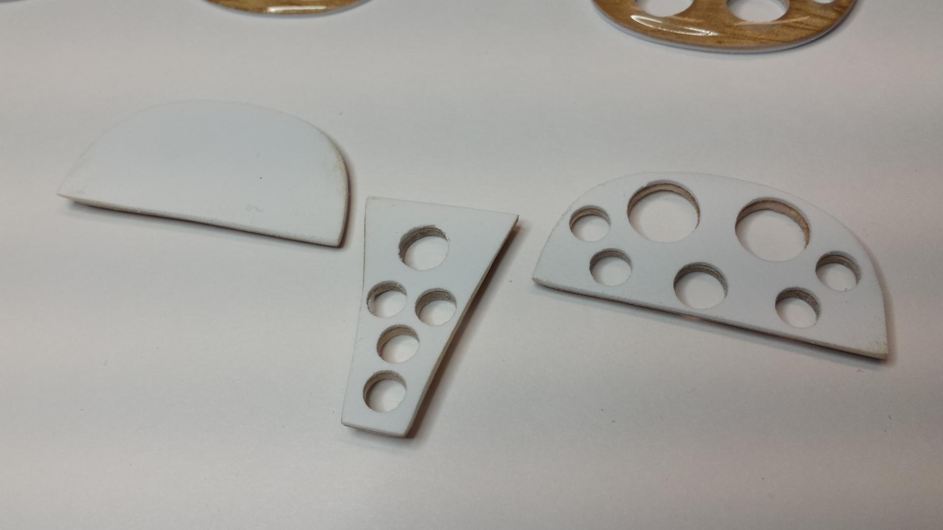

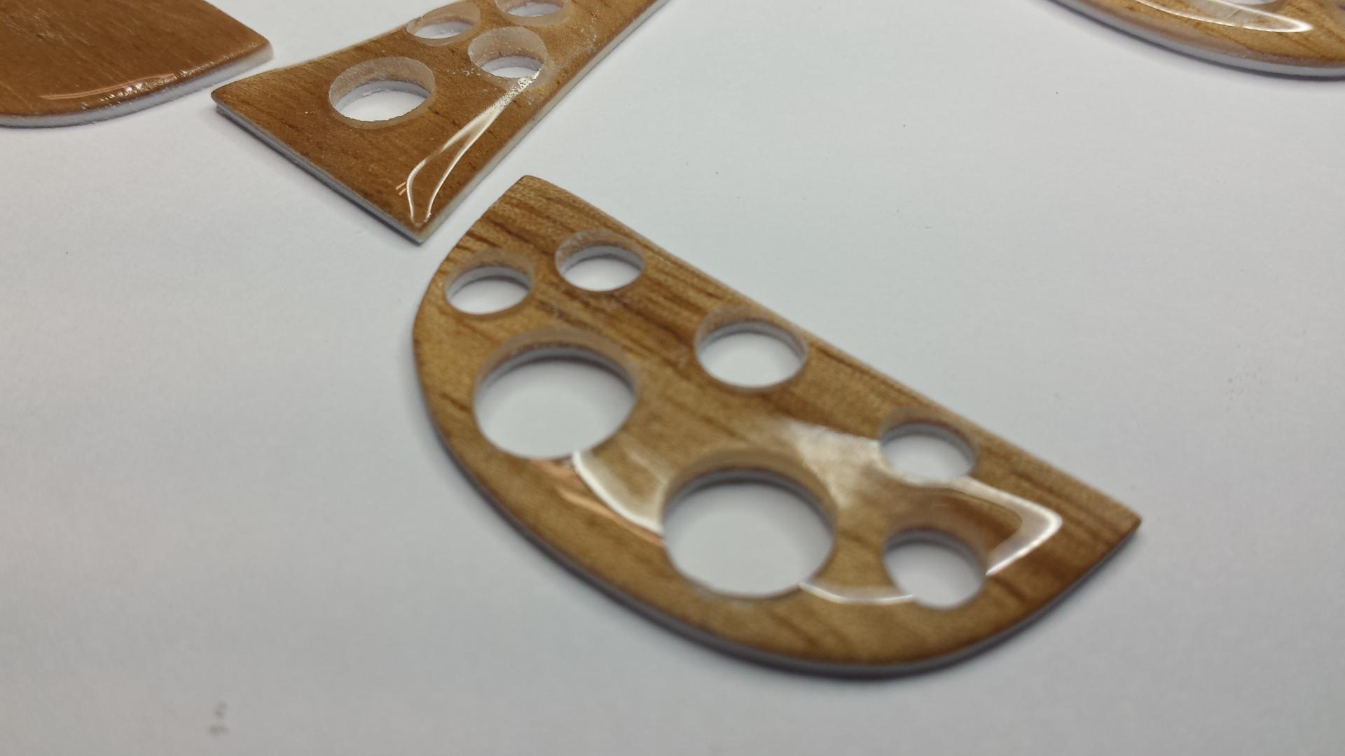

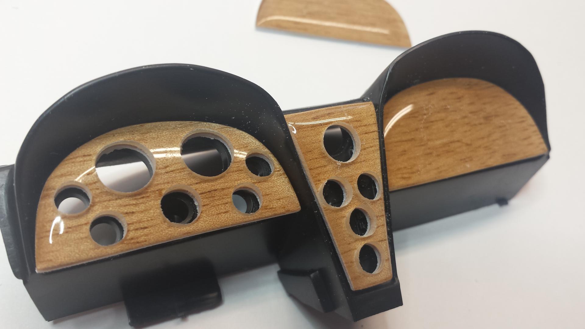

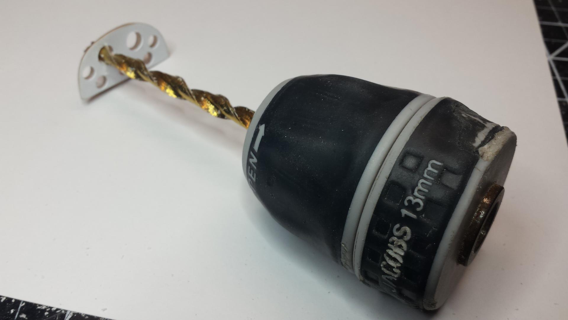

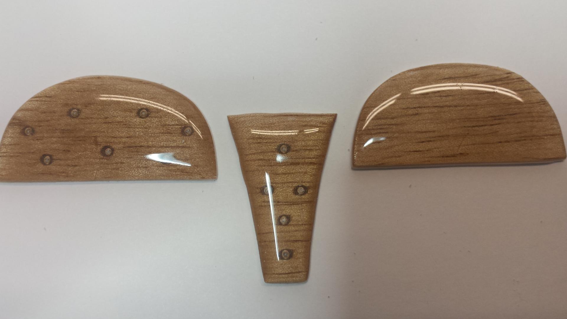

  16. Thanks Trevor. Here's what it looks like with the aluminum tube. These need to be individually fit now due to the convex shape of the dash pieces. The tubes near the outside need to be shallower than the speed & tach. The aluminum tubes are easy to work with.

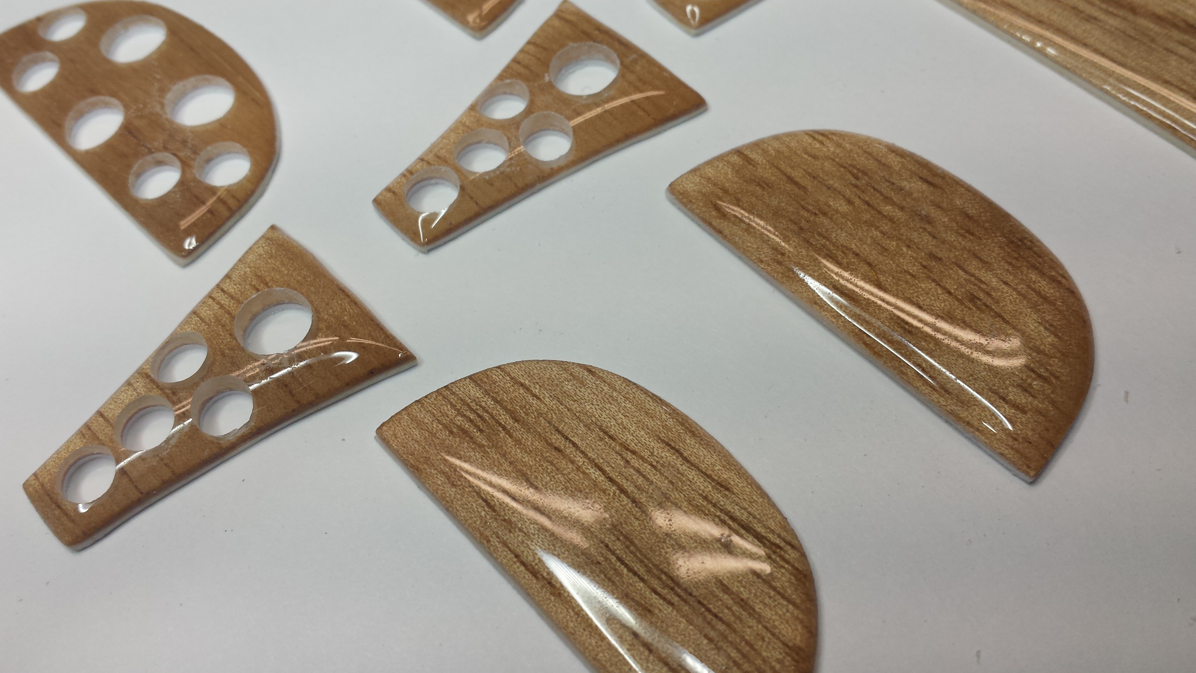

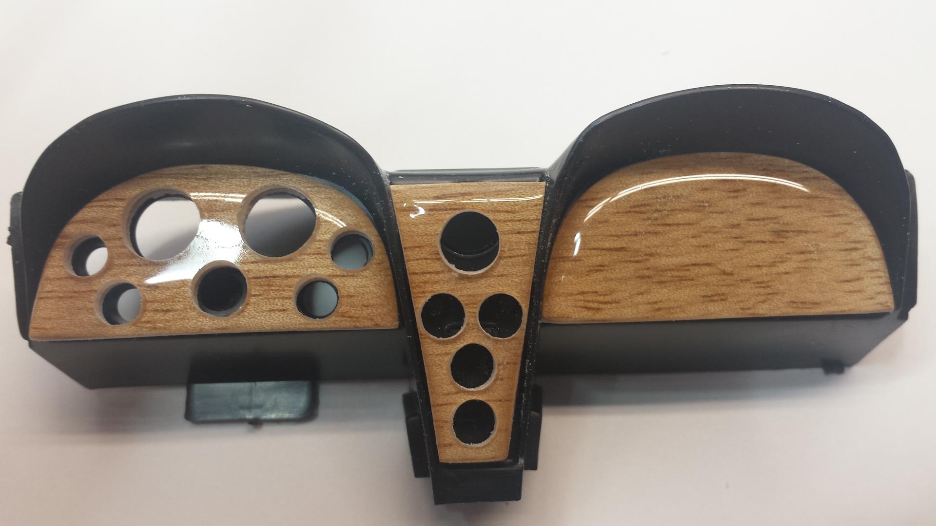

  17. Here are a few pictures with the pieces mocked up on the kit dash. From here you can visualize buttons, knobs, etc. to be added later. I've got a few other ideas too.

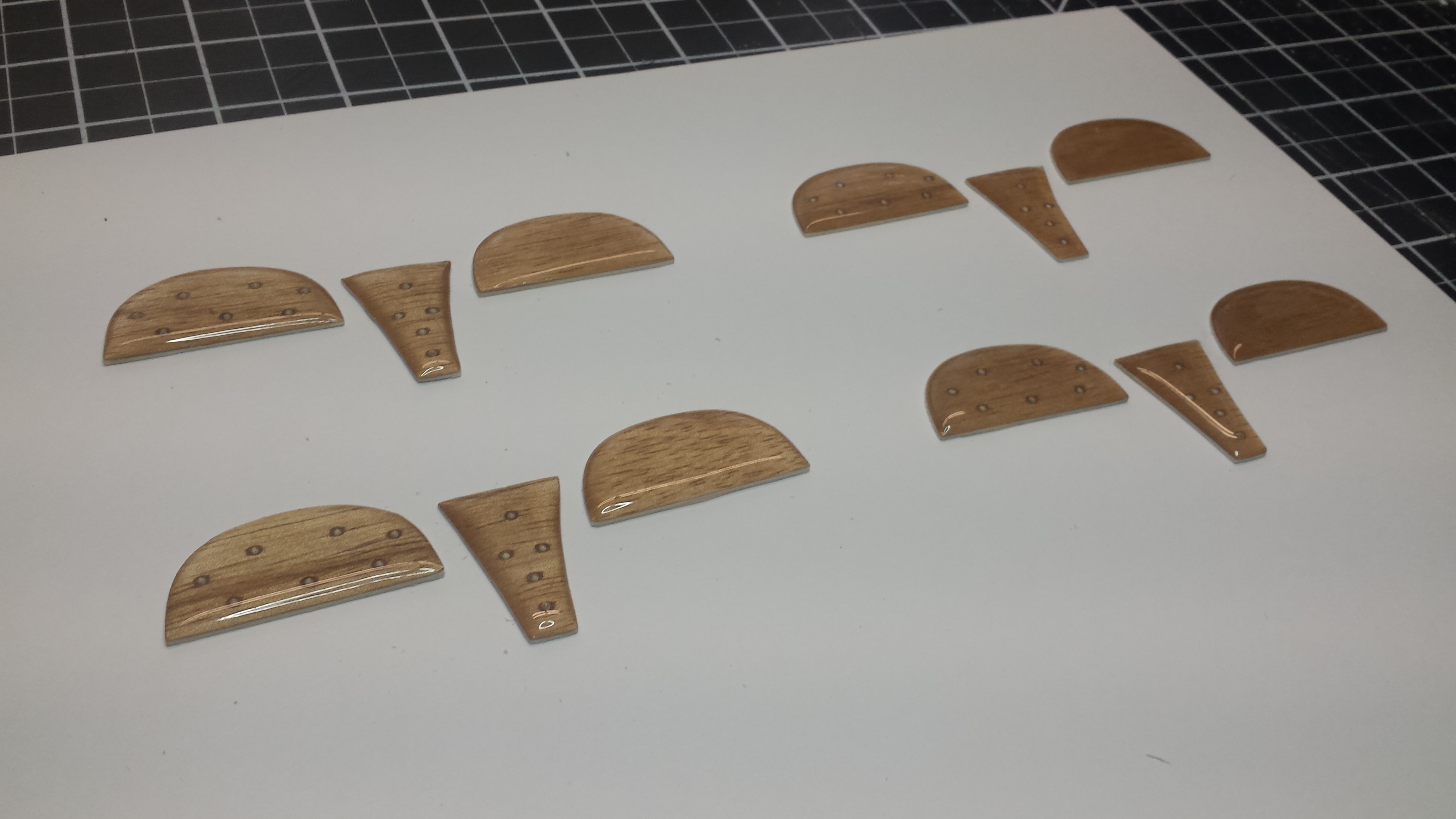

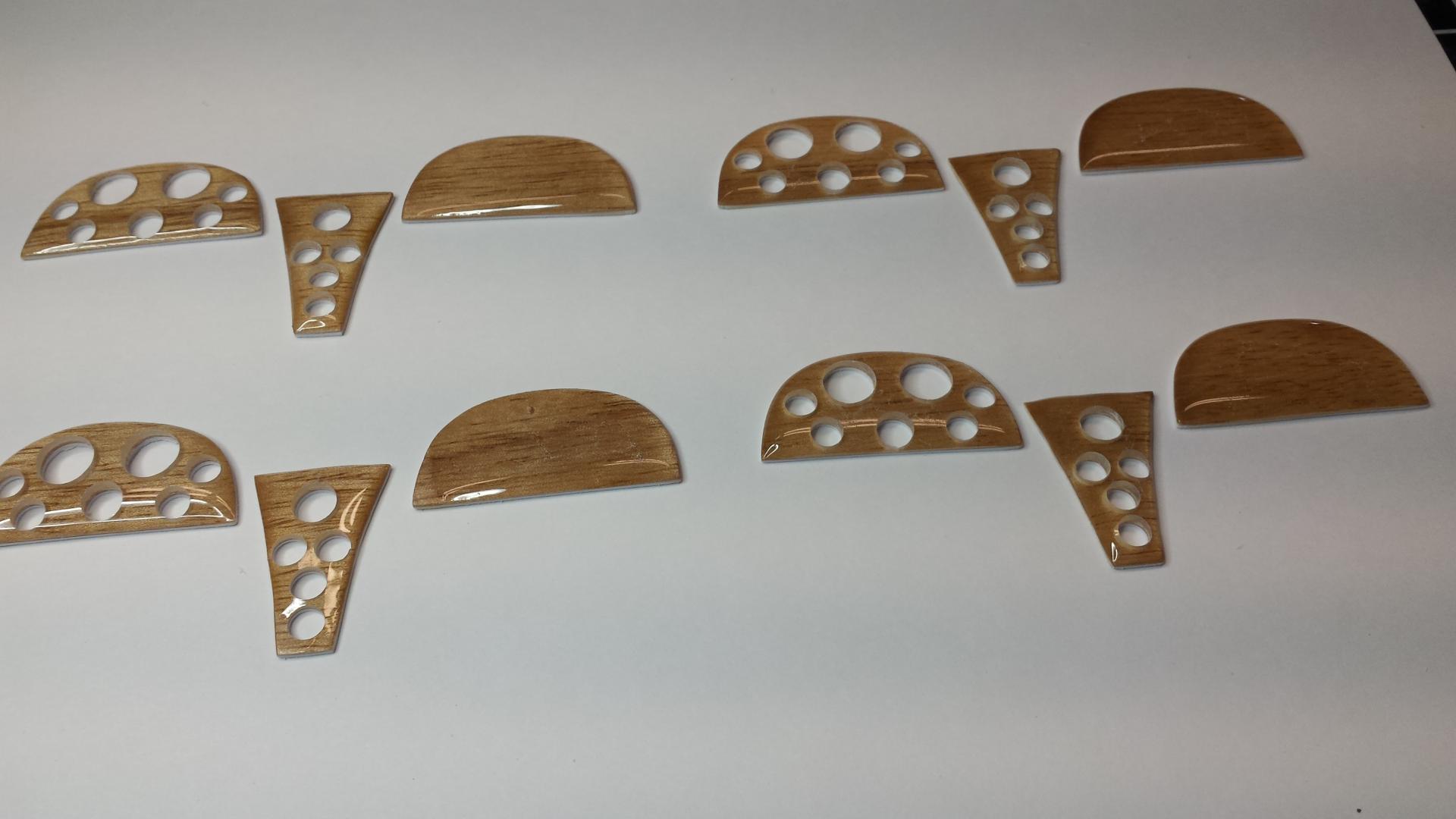

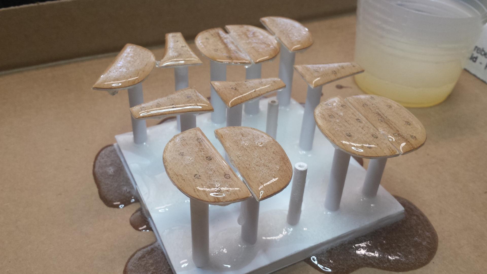

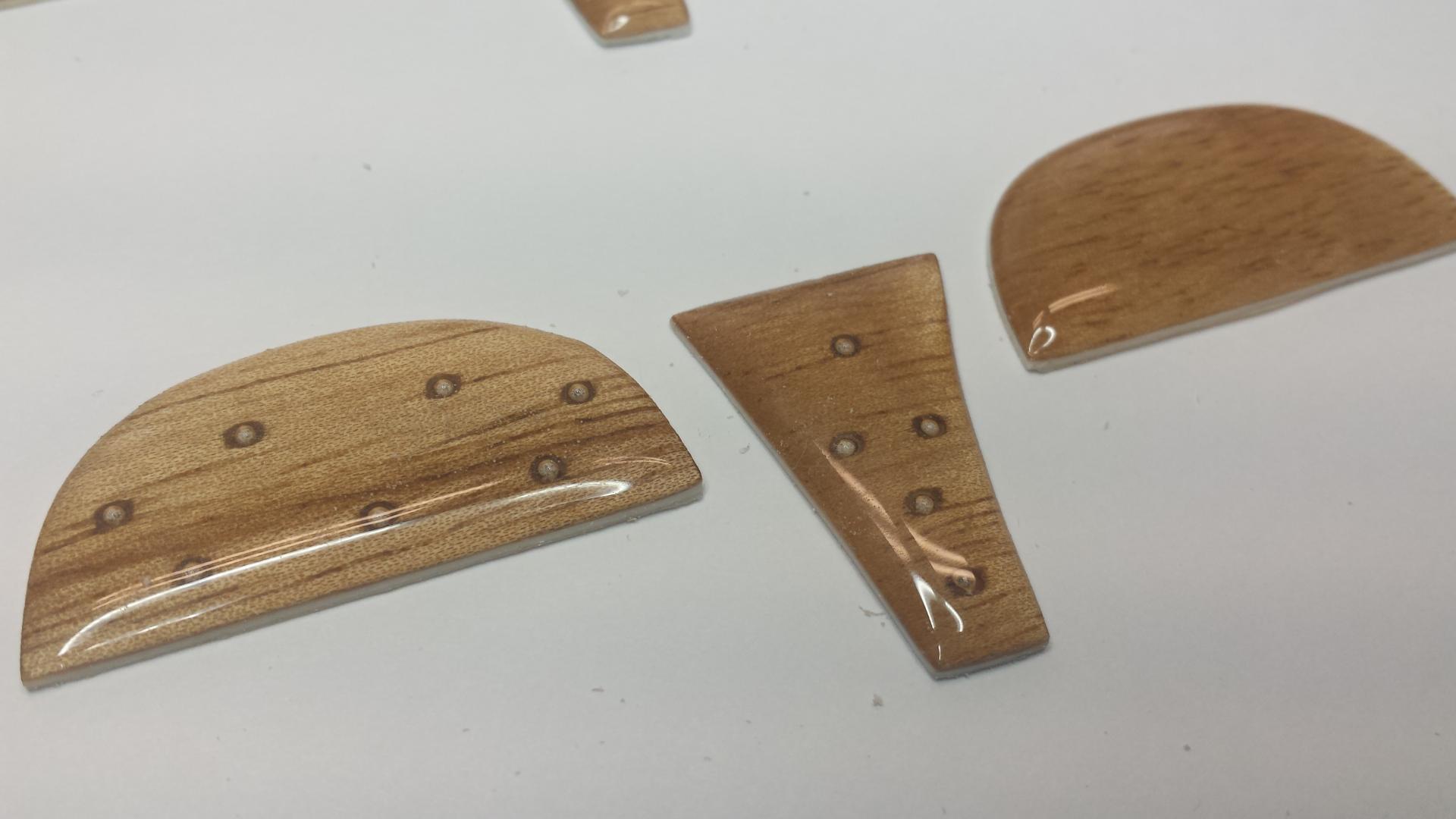

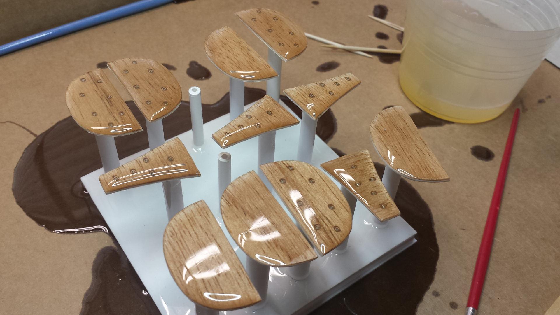

  18. And here are the results. If you wonder why I make so many it's mostly because of the set-up time involved. You also might want a few extras and some turn out to be seconds (including some of these). Worst case you have extras for future builds. Eventually I will carefully peel off the .030 plastic sheet from the back of each wood piece. Once everything has been drilled you can do so. I'll explain this later. Next I will cut and fit the aluminum tube.
  19. Now we need to drill through and locate every hole. I'm using 3 nominal sizes of K & S Aluminum for the gauge bezels - 3/16", 1/4" and 5/16". You must drill slowly by hand starting with around a 1/16" bit and working up bit by bit until you reach 3/16" which is the minimum that all holes will be. From here continue drilling the Tach & Speedo and clock holes. The clock is the large hole at the top of the center section. It gets drilled out to 1/4". I found the larger holes easier to drill using a hand held chuck.
