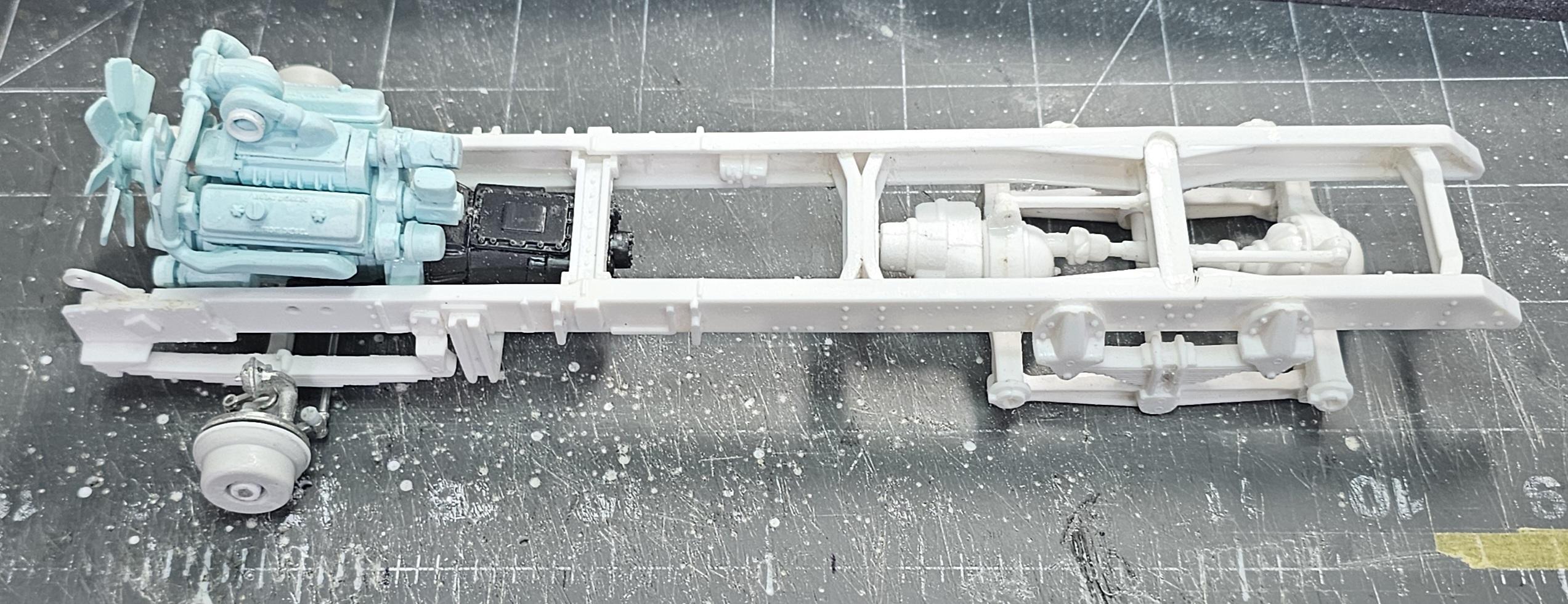

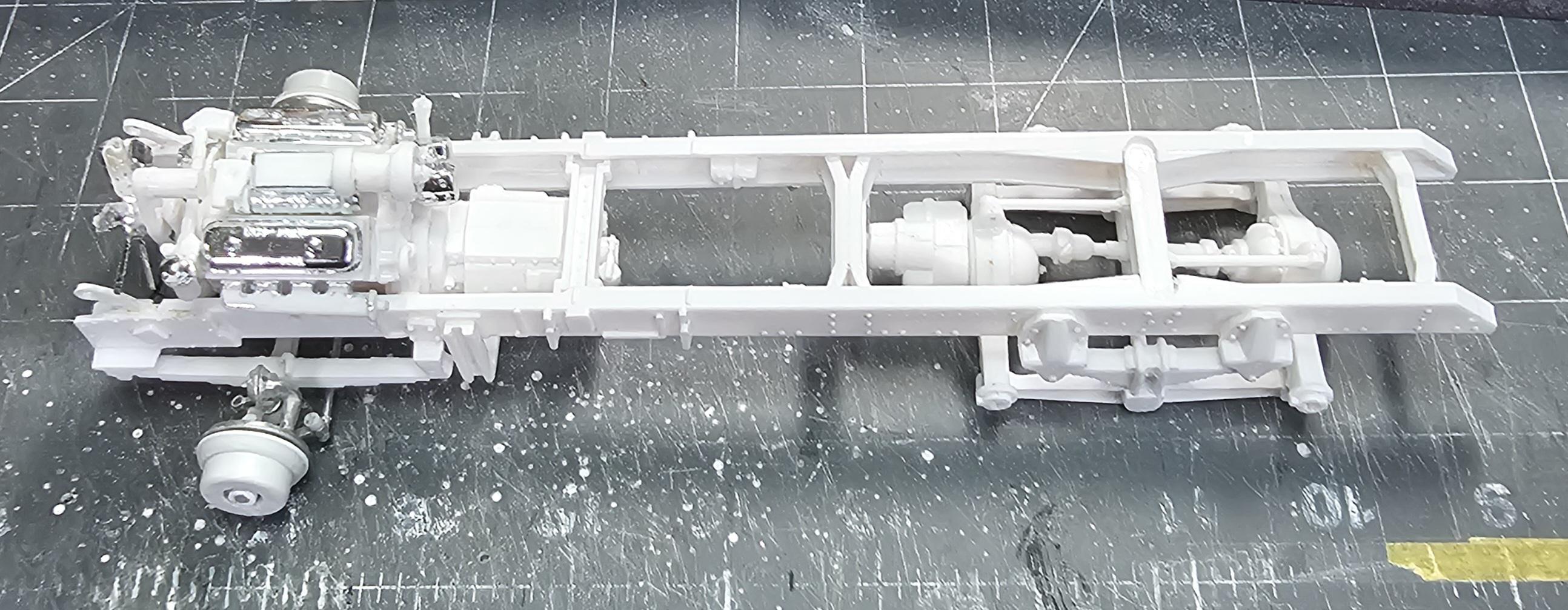

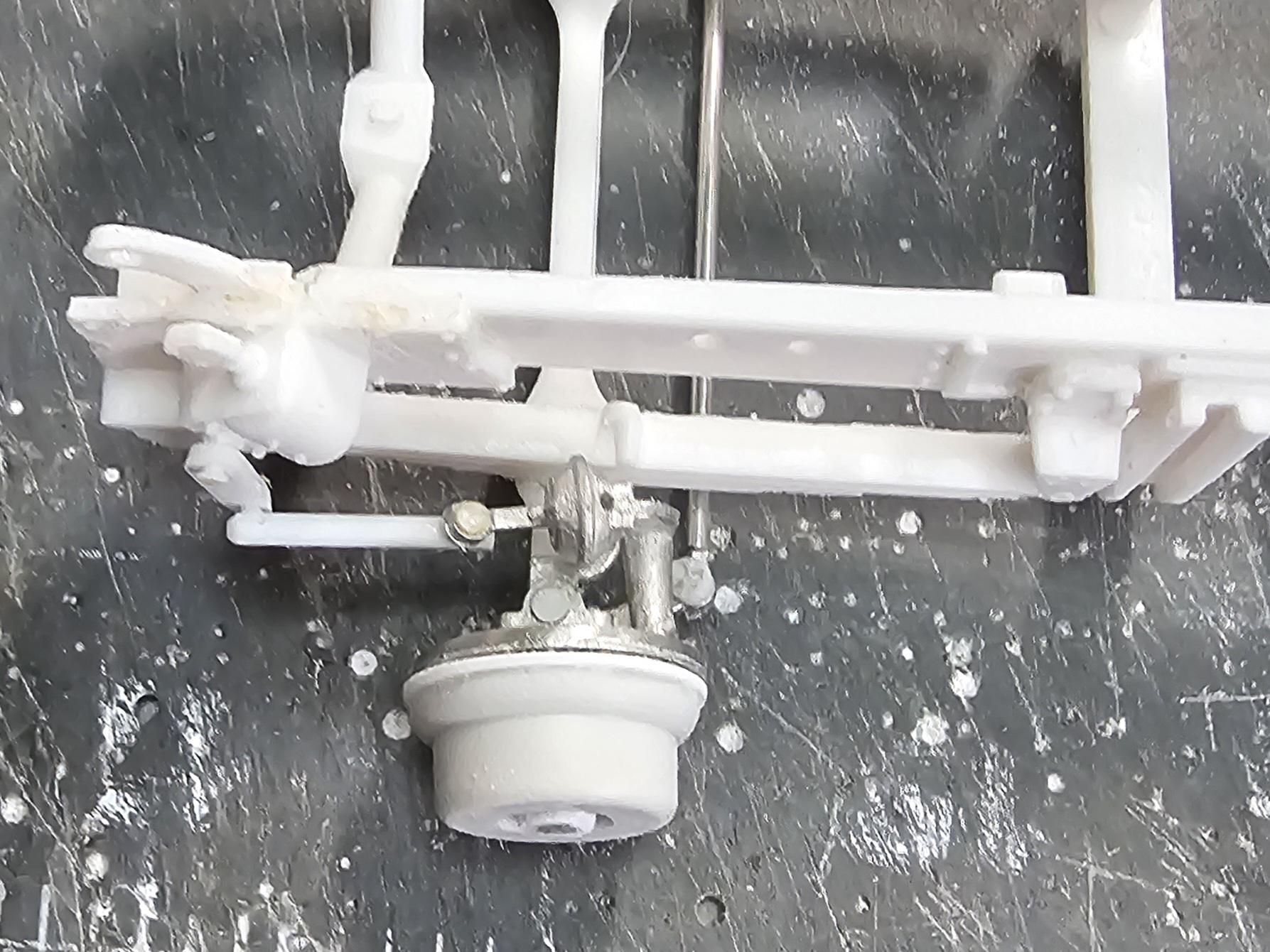

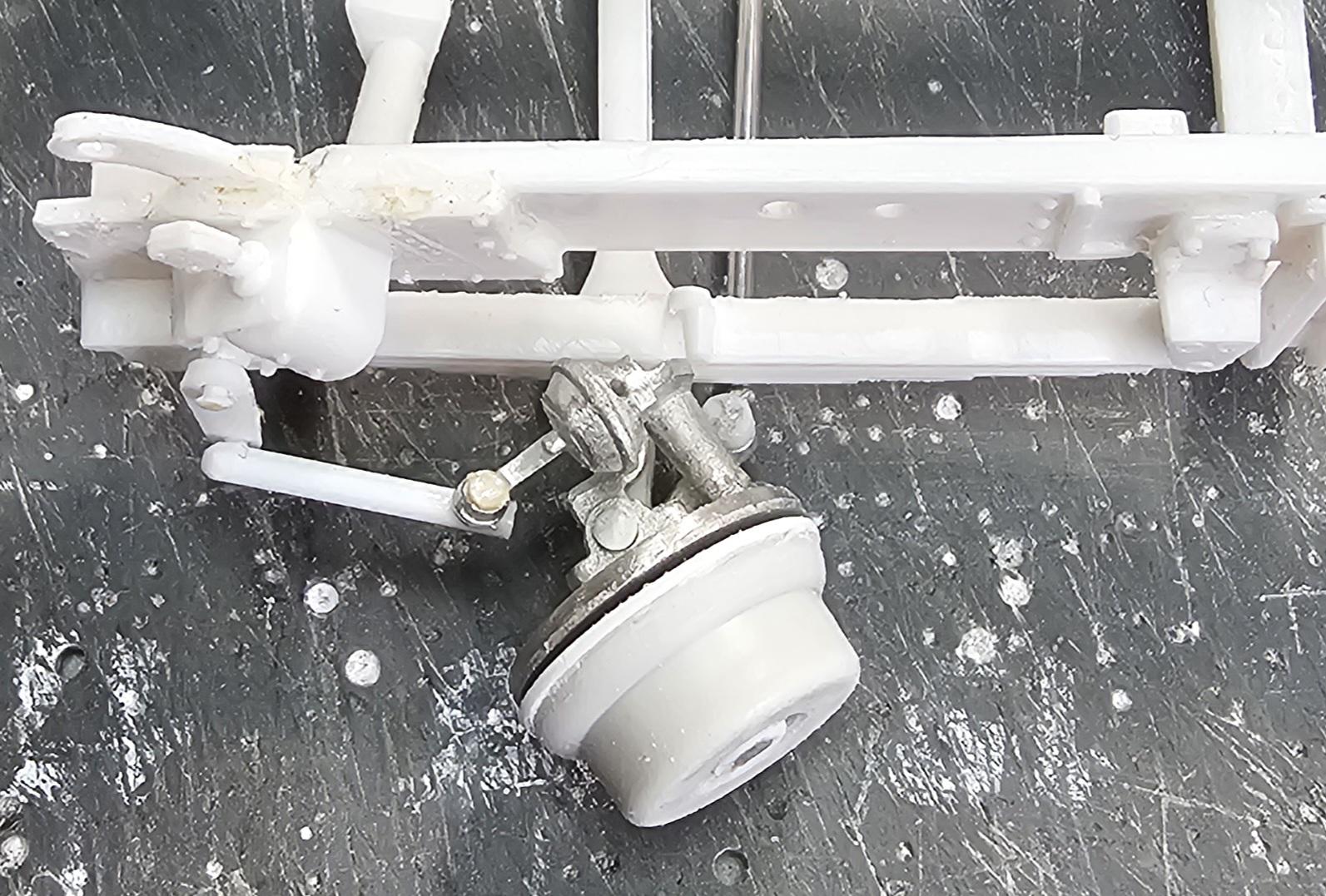

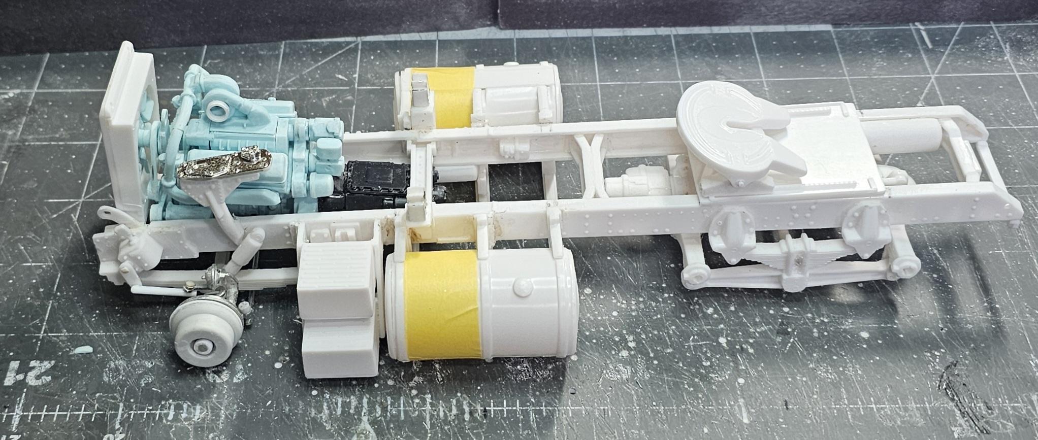

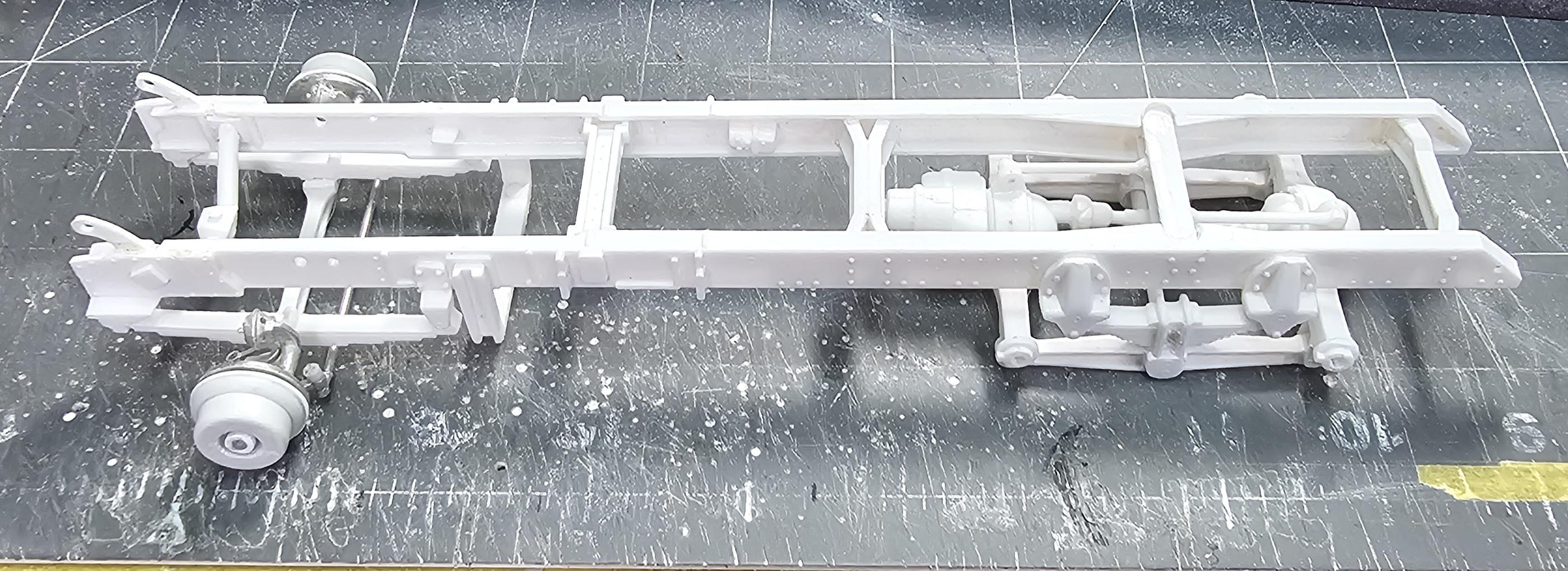

Hey all I got some more work done on this monster yesterday. This view shows the 12V71-TT painted in DD Alpine Green. The other side. This is the first coat. This view shows the engine sitting in the frame along with the radiator and cab. This view shows the almost finished hood sitting in place on the truck. I still have to putty up the seam and sand smoth. This view shows how I altered the two hoods. First I cut approximately 15.5 inches off of the rear of one hood. Then I cut along each side of the center rib from the rear to about 5mm from the front on the otherhood. I then removed a thin wedge from both sides, trimed and sanded the edges. I then heated the front area of the hood so I could squeeze the hood together at the rear so I could glue back together. I then glued the 15.5" piece onto the hood I took the wedges out of and voila! Longer hood. This view shows the engine detail painted. The other side of the engine. Top front view of the engine with fan. Still have weathering to do on this. This view shows the "Brownie" painted. Another view of the Brownie. Rear view of the Brownie. This view shows the front axle I plan on using for this build. I did order a 1/24th axle also because I'm not sure the 1/25 one will be wide enough.🤔😉 Ron G
Hey all I'm back...lol. I had to modify the DD 12V71-TT. The turbos were sticking up to high. I had to drop them down about 5mm. This way I can get the hood to clear them and fit a air intake pipe system. Here are some pictures for yous to perose. This view shows the lower intake plumbing. I need to shorten the intake pipe about 3mm so I can add the intake plumbing to the air cleaner. This view shows the engine in the frame with the cab in place. This view shows that I have to add 15" to the rear of the hood. Well that's it for now be back soon with more updates. Ron G
