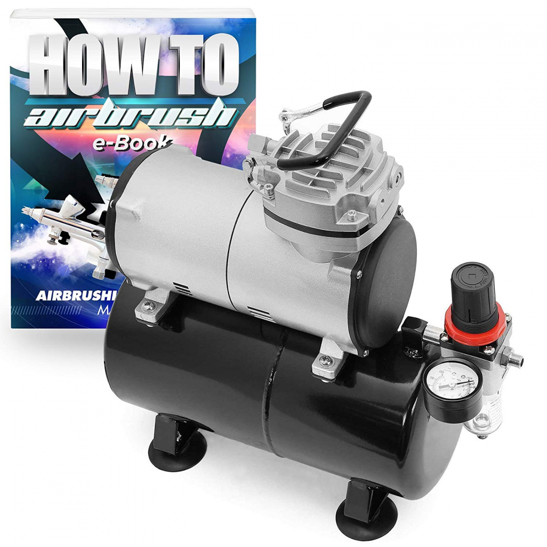

FWIW all of Donn Yost's award winning models were painted with a Paasche H and either a #3 needle or #5. those are heavy needs and nozzles, .7 and up. Just sayin. This kit is $57 at Amazon. I'm not hinting just showing it. -

REload the page the photo was slow loading, it's the next post up from the one you quoted and I don't want it to show up again if I paste it over again. It's a Point Zero with tank and water trap for $98. And it on Prime. -

That compressor is Amazons choice , it's not on prime but has free shipping anyway. Really the water trap should be away from the compressor anyway to give air time to recondense or the water in the air I should say. I have a trap to use attached to the side of my booth, it's a Point Zero that I got from Amazon for I think $10. But I have such a large volume of air to tap into that I don't get water in my line, the tank on the compressor might so I just drain it there. That Point Zero trap is well made fwiw. If you're going to Amazon anyway, look around you might find one with a water trap on it but that isn't how I would plumb mine. -

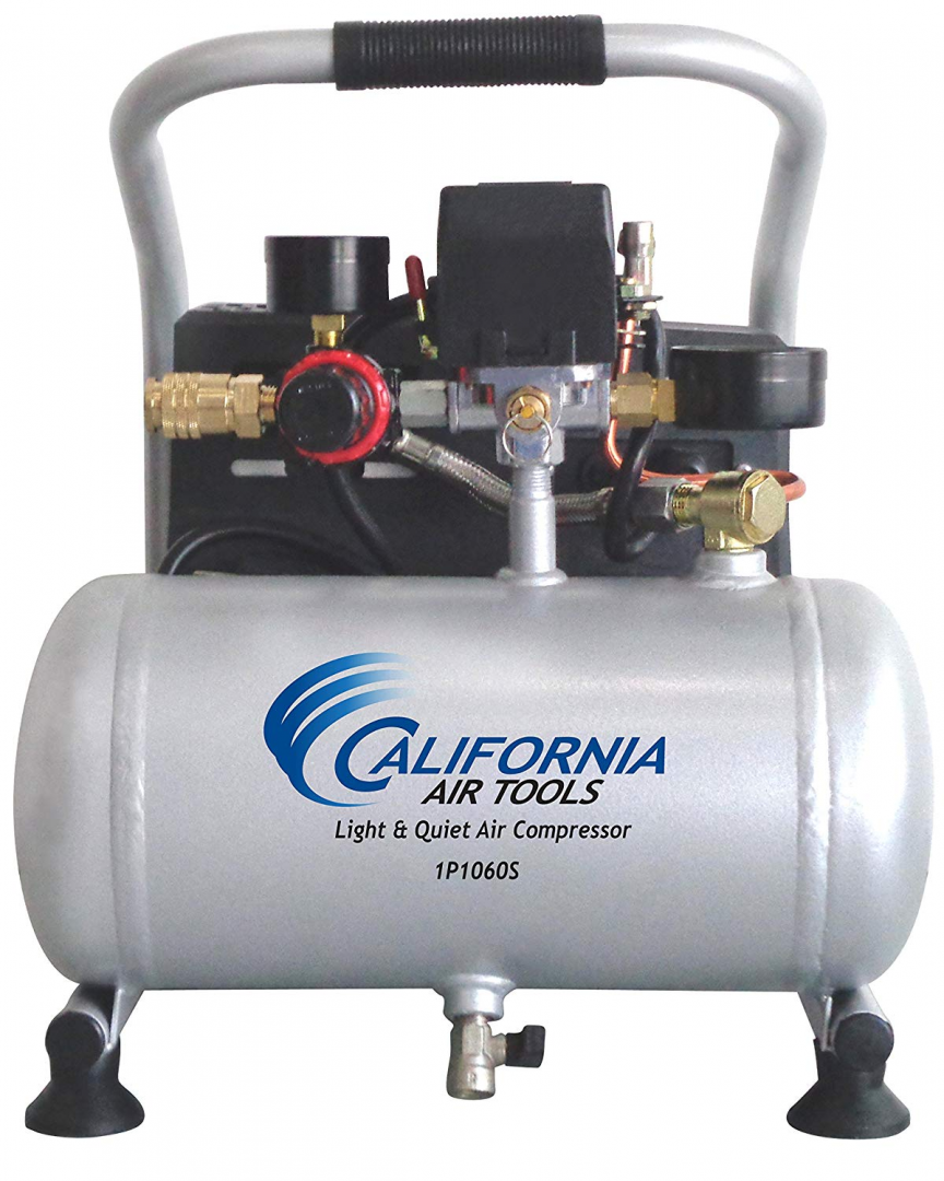

Hah, I use a Husky 8 gal compressor. I have it for light car repairs and running my lvlp spray guns and also nail guns. Noisy as all get out ! But I can air it up and proceed to paint a whole model with an airbrush before it needs air again, air it up and good to go when ever. I want to plumb my basement for air too because I do wood turning down there and need a blast of air in my hollow forms. Some folks are liking the quiet series Cambel Hausfield they sell at Walmart but I think it more money than the CAT. -

A lot of people like the California Air Tools one, it's quiet not too pricey. The one I'm thinking of is around $108 and has the on board air tank, available at Amazon .Also direct from CAT. -
