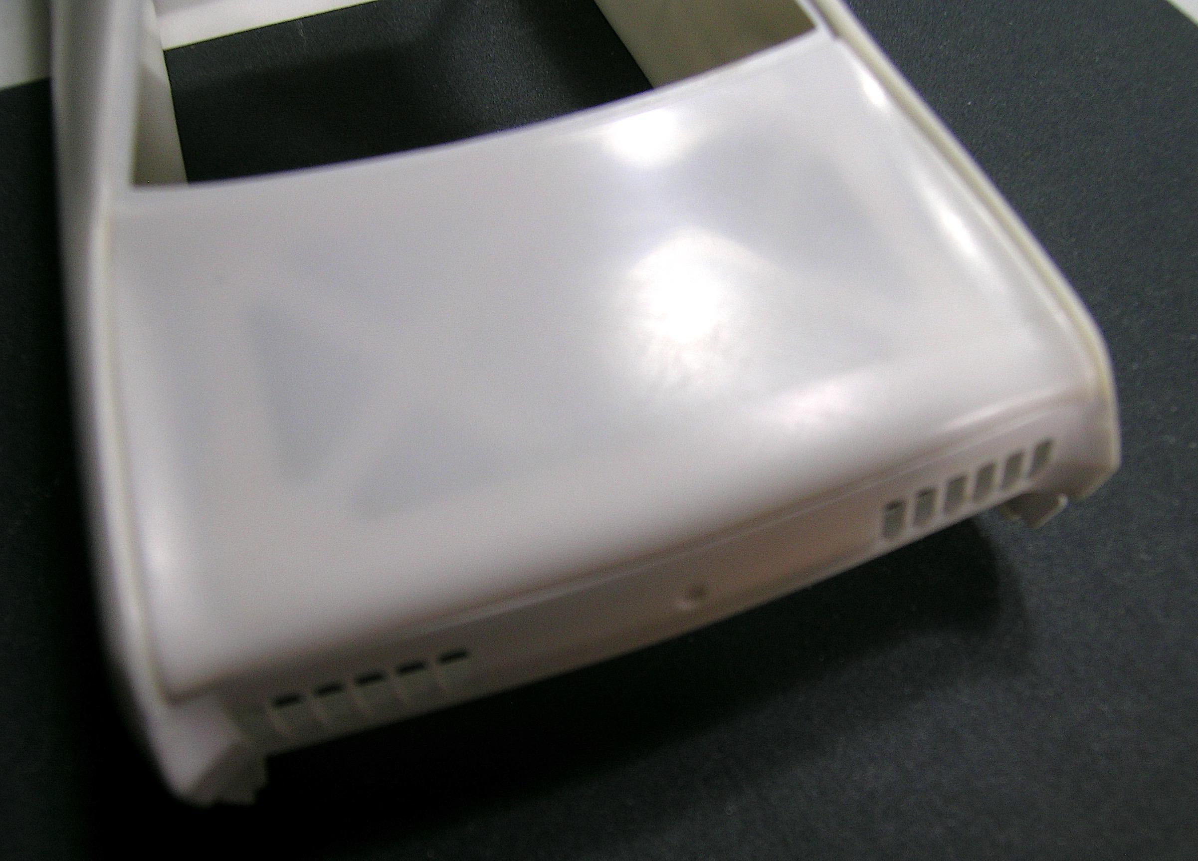

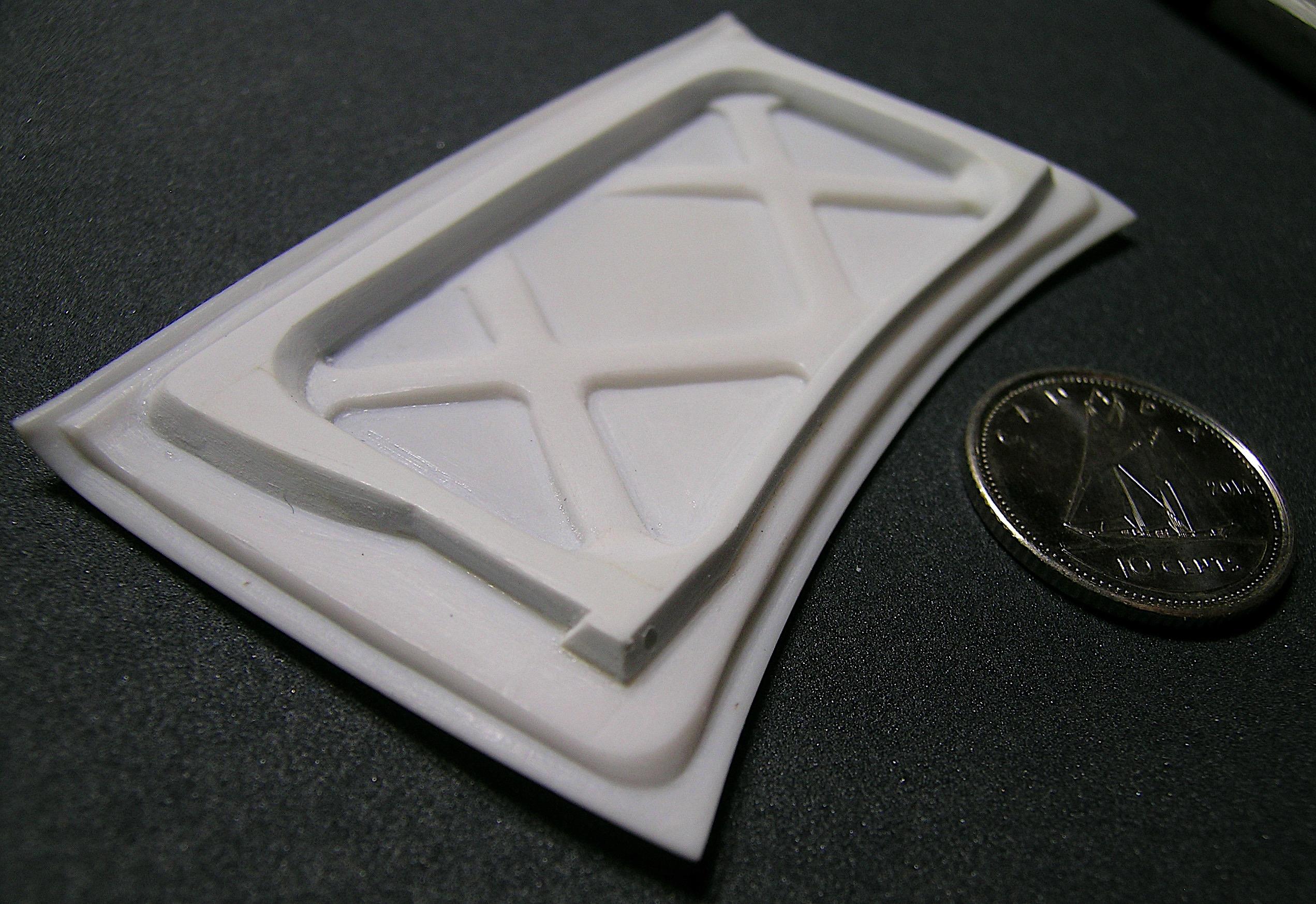

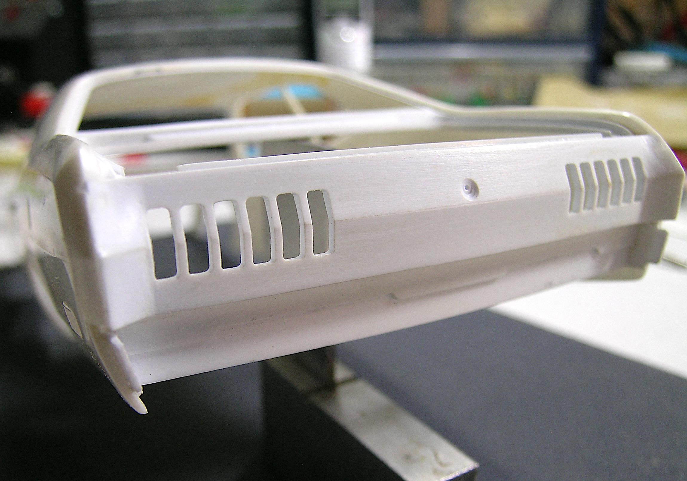

Hi Ron, thanks for your comments and kind words my friend ! The trunk lid appears to be rather thin in the photo but the Duster's plastic is less opaque than Evergreen styrene. I'm not worried about warping, a good coat of primer should provide good protection and even though it looks thin in some places, the plastic is still about 0.020 inches thick at its thinnest. Francis -

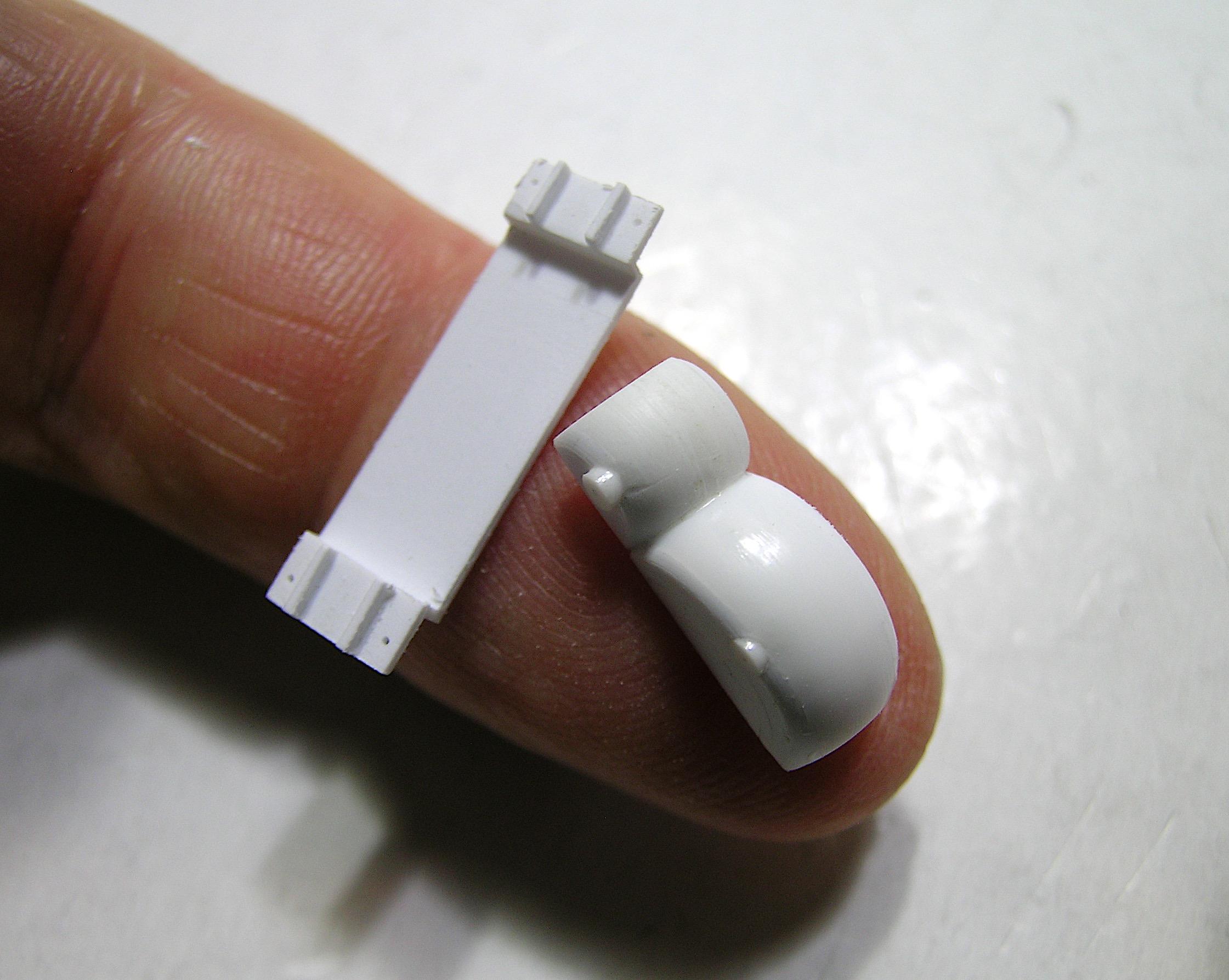

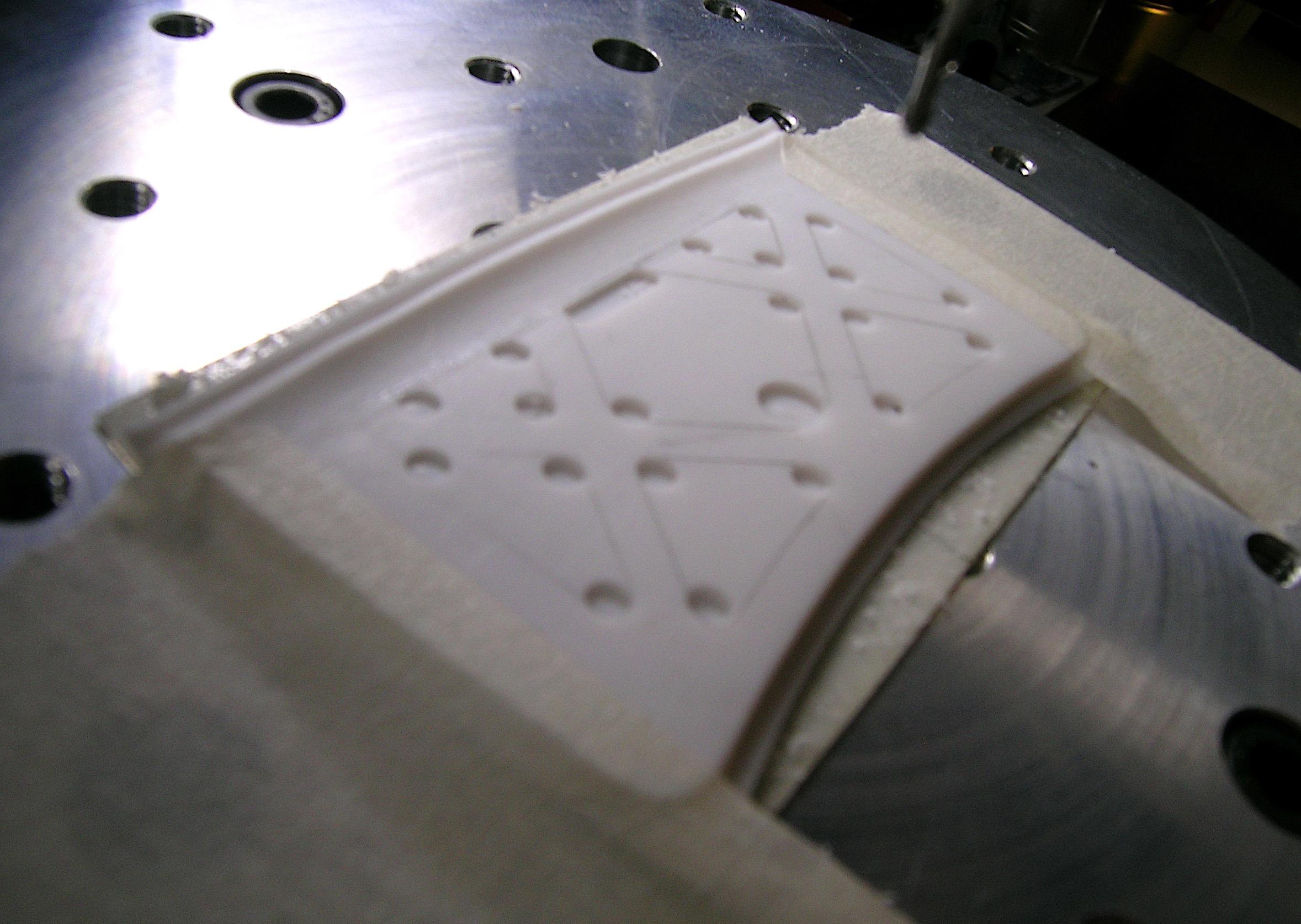

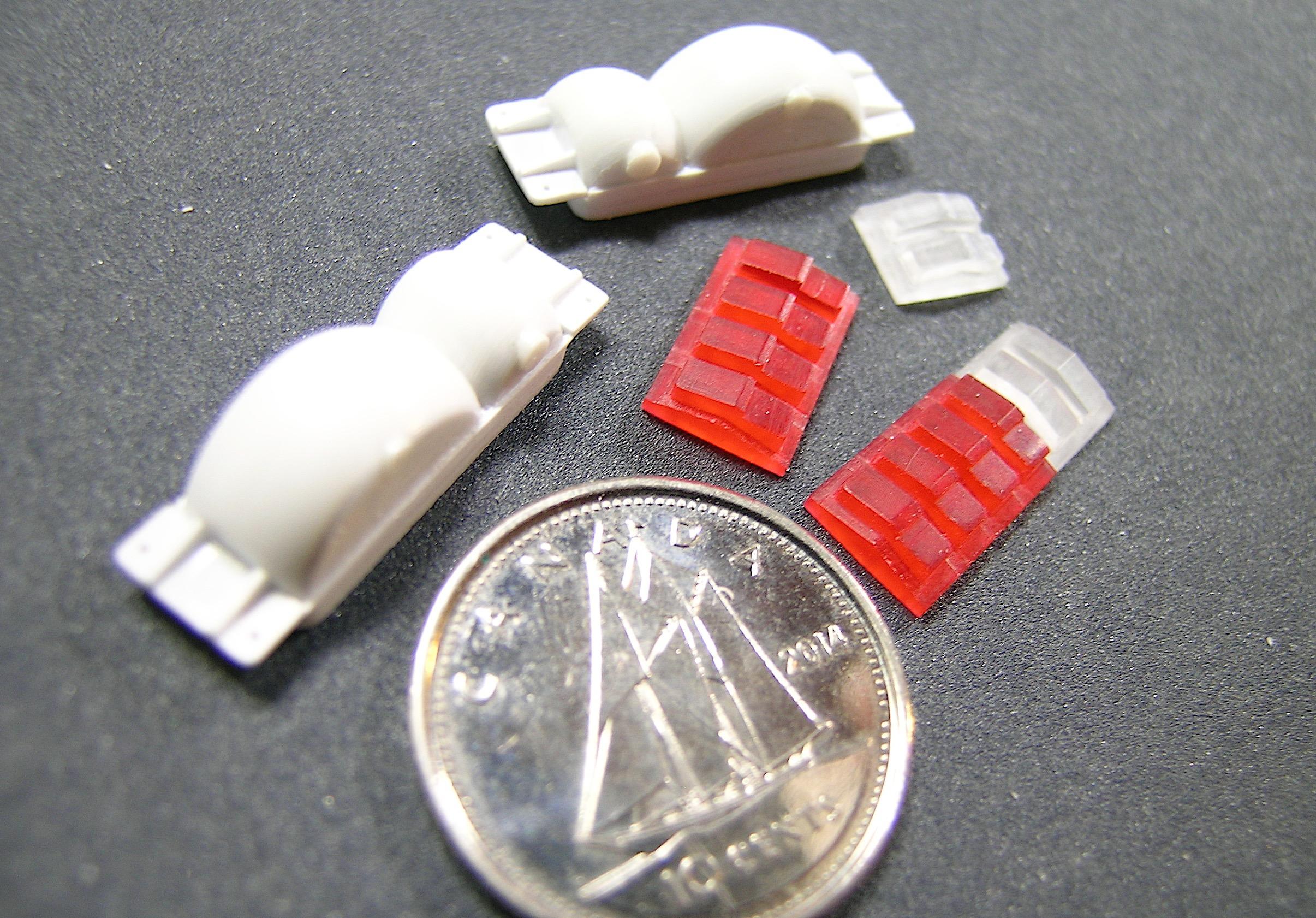

Hello everyone, Now that much of the rear body detailing has been done or is well underway, it's time to move on to making the front grille. I've been thinking about building this car for a while, but resin grille offers for the 72 are rare and their details unsatisfactory to my taste. I have a good plan and some ideas to build it, my first intention was to modify the grille of the 71 to convert it into that of the 72 but after much reflection, I decided to build it from scratch because they are too different. The grille of the 71 will only serve as a guide for the position and size of the headlights and the proportion of the turn signals. Speaking of turn signals, this is the first part I tackled and here is what I made, I hope you'll like it but I have to say I'm pretty happy with the result. It will be a lot of work but I hope to have something more substantial to show you in the next few days. One thing is for sure, it will be a bit more difficult to make than the simplistic grille of my D100 pickup but as much distinctive so please be patient as I have a lot of expectations, towards myself and I will proceed with a lot of precautions. Comments are welcome. See you soon, Francis A good picture I found on the internet. I started with a round styrene rod. With a little more refinement... I drilled a small hole for two reasons, stay tuned... After a little sanding and filing. I machined the lenses from clear acrylic like for the back-up lights. I wanted to do the cross lines with aluminum but it's very, very small so I decided to paint them with a Molotow pen. The central elements are made of aluminum. Both sides are made. A little test, I think it should do the trick. I will probably have more adjustments to make when they are inserted into the grille. -

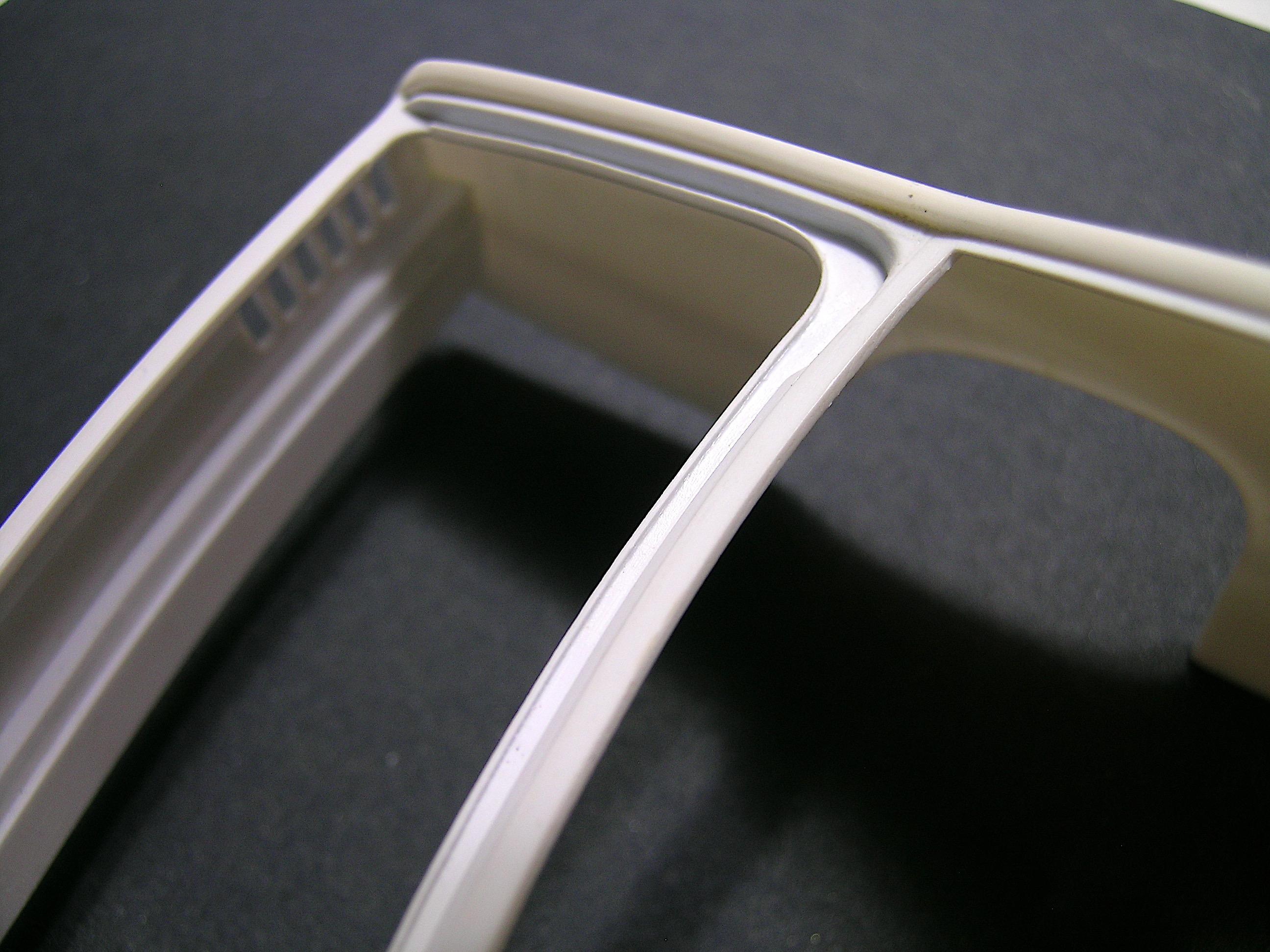

Hello everyone, Progress resumed on the bodywork and I concentrated on correcting (at the front) and improving (at the rear) the wheel openings. It looks pretty easy to do but I had to be very careful not to touch the subtle straight line that simulates the center fold of the body. The rear fenders needed the small lip at the top of the fender softened and rounded, but the front openings needed more work. I enlarged the opening by about the same thickness as the styrene strip I added (to keep the original size), and this was used to recreate the lip after correcting the shape of the top. I also corrected the rear shape to be more angular and closer to the door rather than going down in an almost straight line. For those who are familiar with this body model, I hope that my corrections will pass the test, it is not easy to recreate exactly because the body is more curved towards the inside than the scale model which must be able to be ejected from the mold. Comments and suggestions are welcome, as usual, and work on the body and its components continues. Francis The modified back fenders. From a different angle. The target for the front fender shape. The original body before modification. I first removed the same thickness of plastic as the styrene strip I added and sanded (filed) at an angle to create the shape between the center fold and the wheel opening. You can see more clearly (I hope...) the shape I have made between the lip and the center fold. From this angle you can see the corrected shape on the back between the wheel opening and the door. I corrected the front where the valance will be attached. I also engraved a line to simulate the front fender extension. -

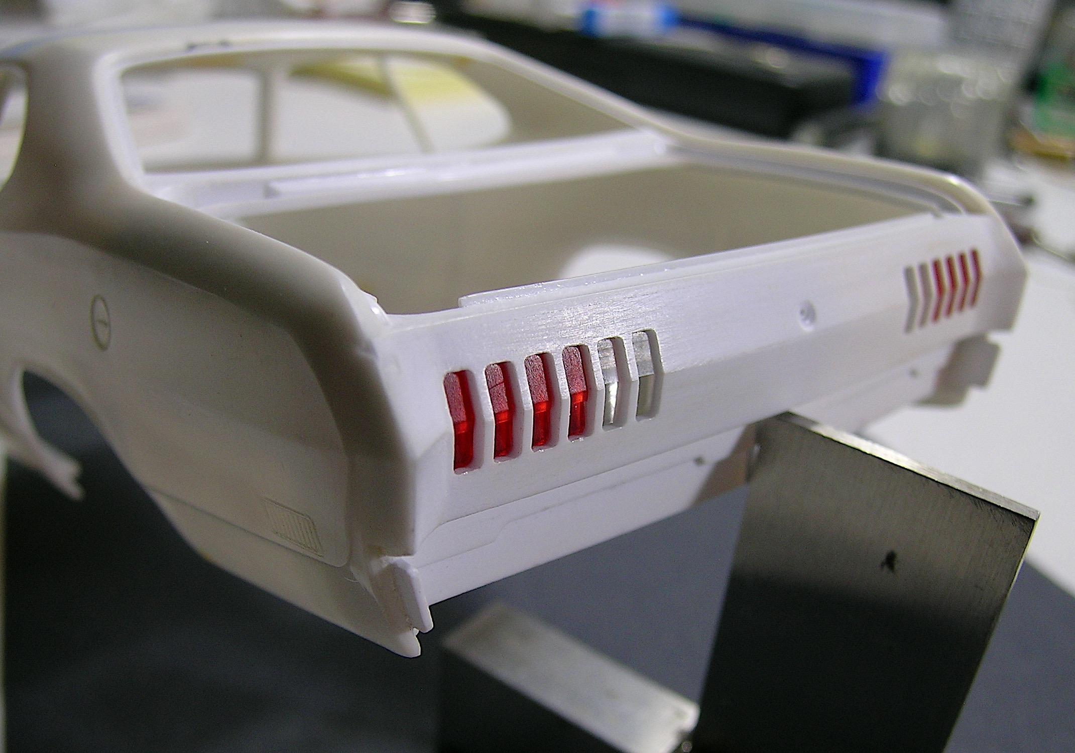

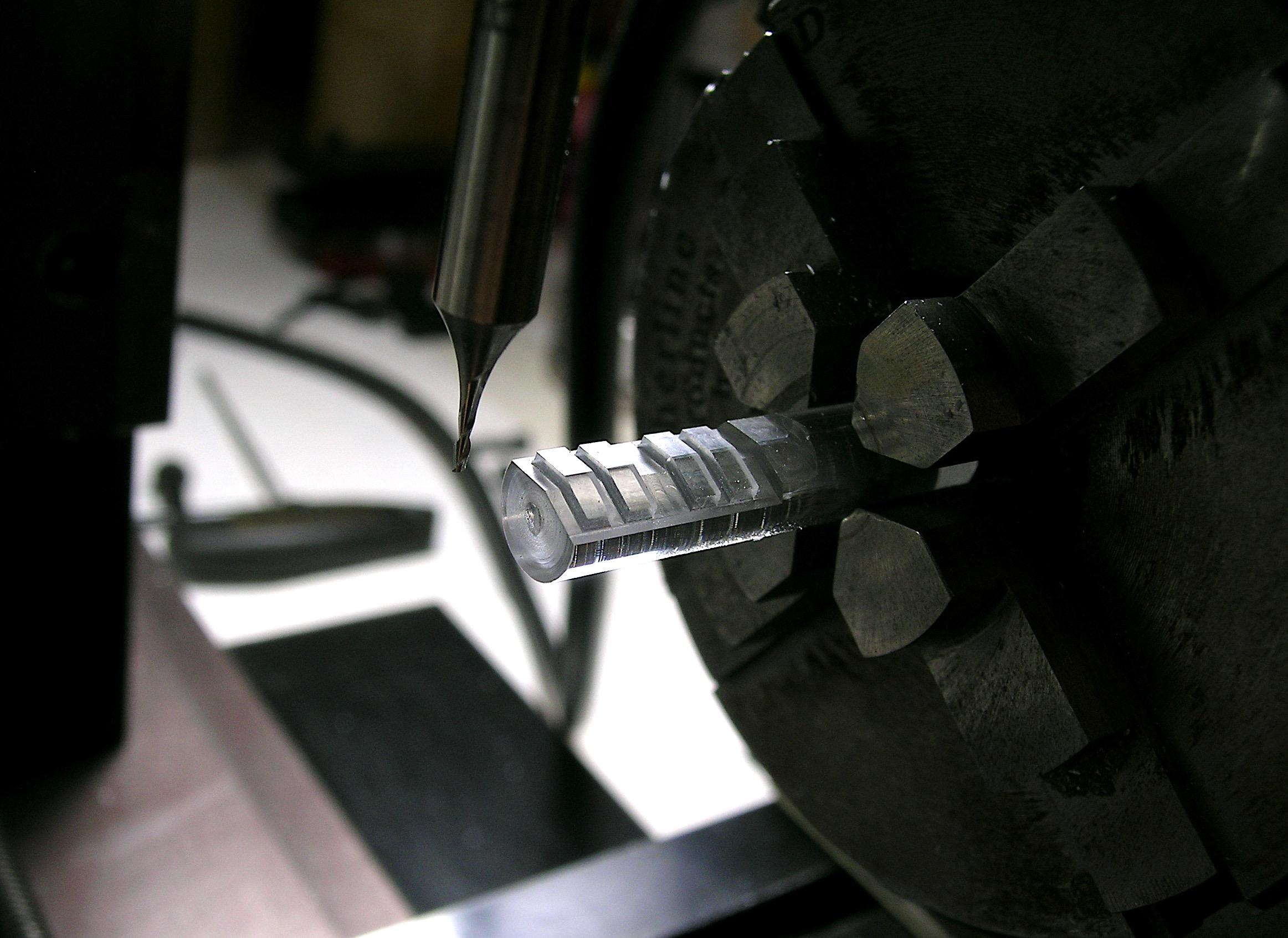

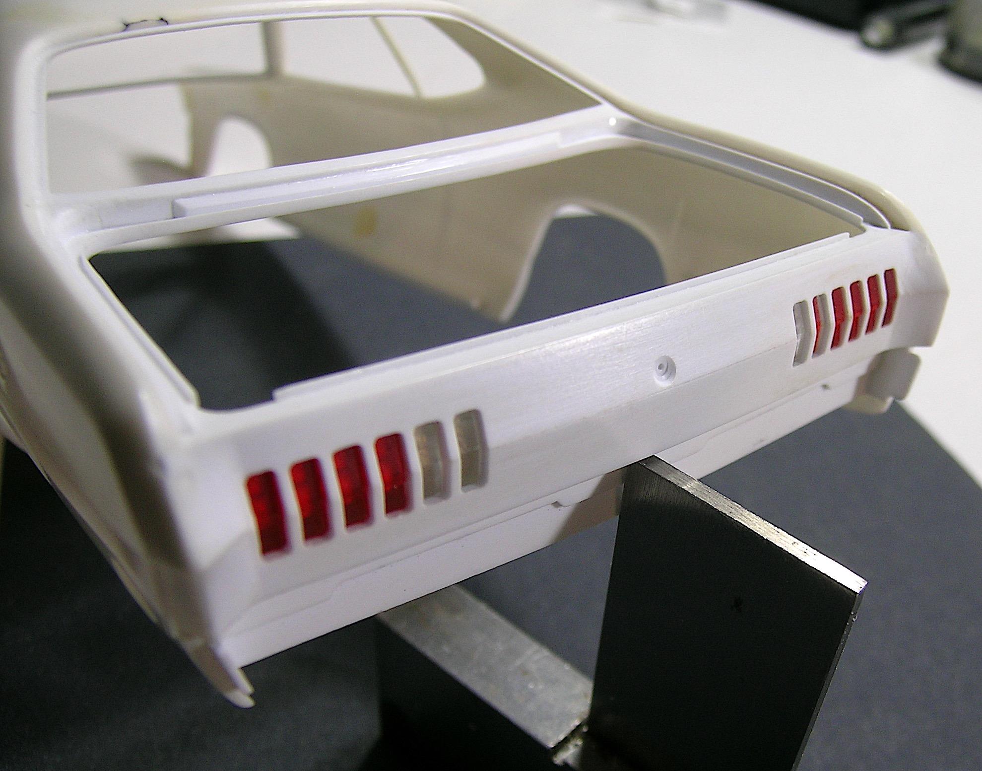

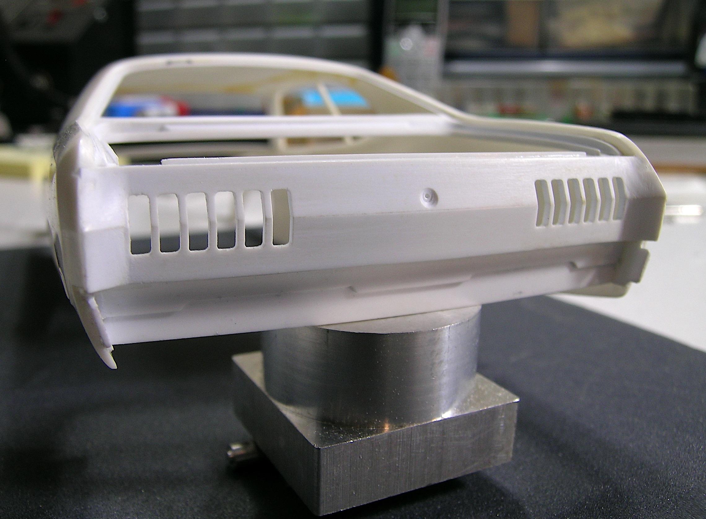

Thanks to all you guys for taking the time to comment on my latest update. I know this isn't the most difficult or spectacular part I've done so far, but I thought it was relevant to show how the tail lights would be mounted. I'm moving slowly but I'm trying to anticipate the next steps by not making elements too hastily that would have to be redone later in the build. This has happened to me several times with my pickup and it has delayed my progress not to mention the risk of ruining other components attached to it. I also take the time to evaluate the pros and cons of using plastic or soft metal (brass or aluminum) for certain parts to get the best detail, knowing that most of these parts will be painted over in the end. I have made good progress with the rear part of the vehicle and I intend to start working on the front, including modifying the wheel opening, making front valance and the grille. I've been thinking about a way to make the grille for a long time and I can't wait to take action and make it happen. I hope to be back soon with new and more substantial progress. Francis -

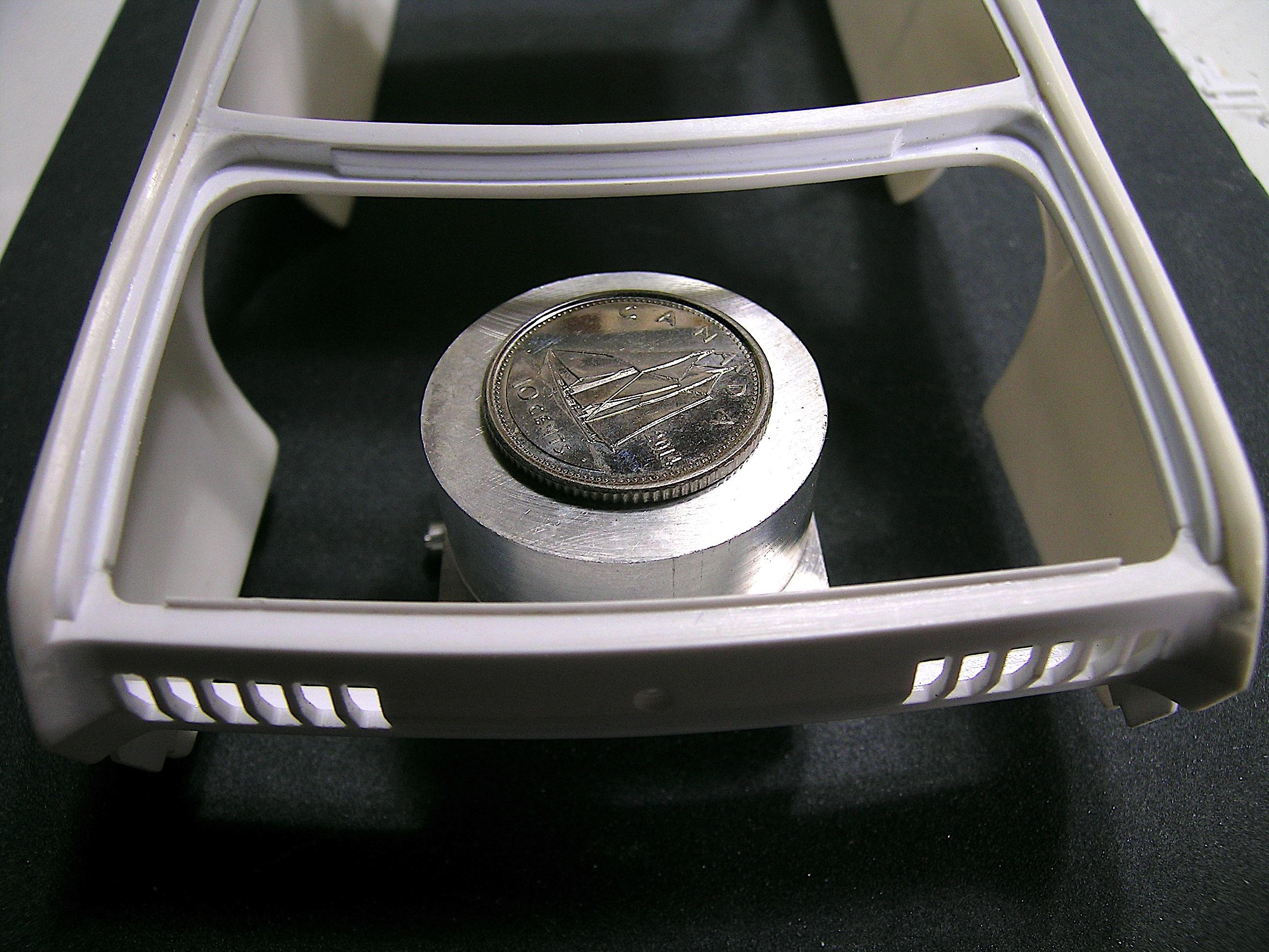

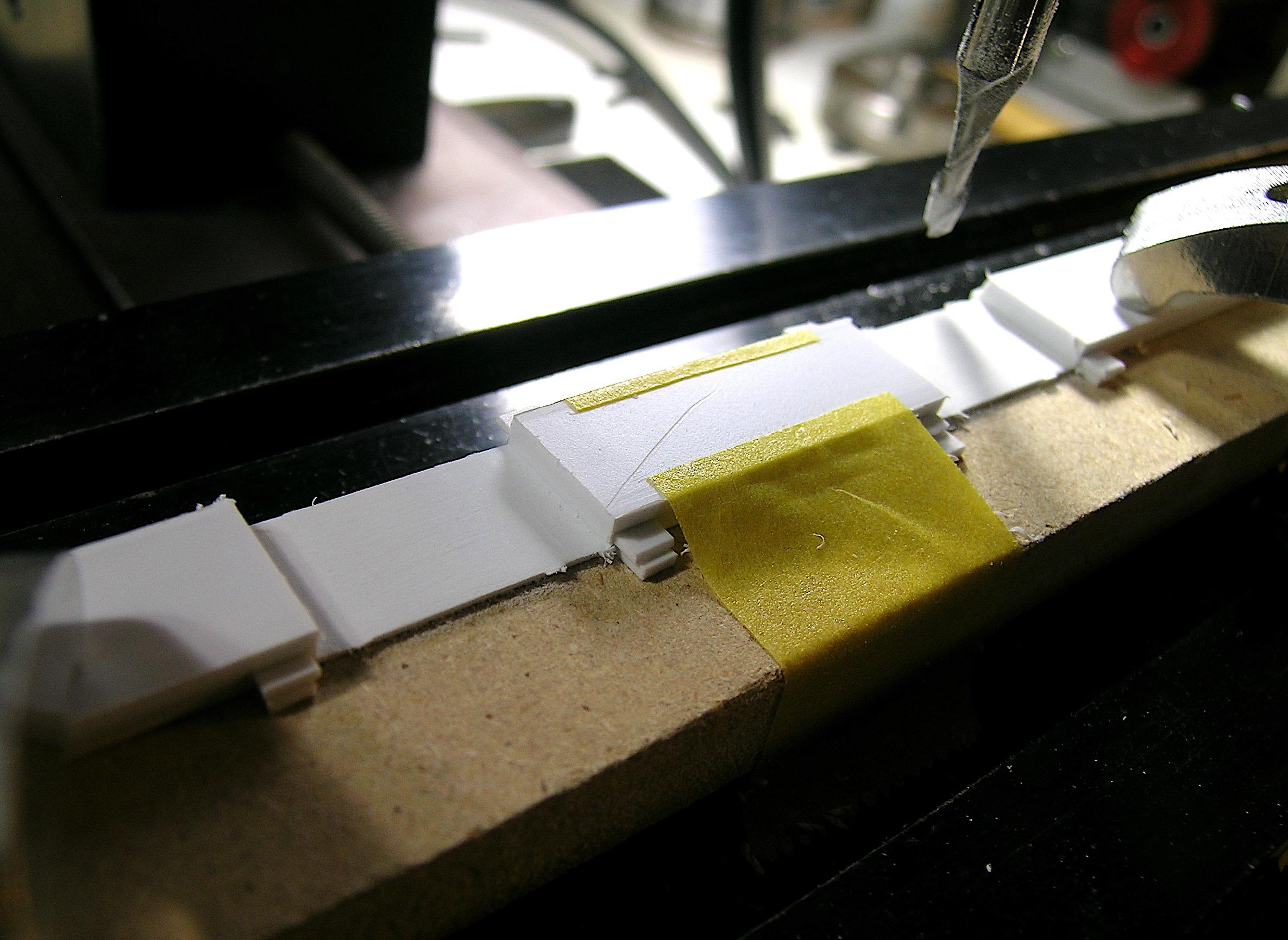

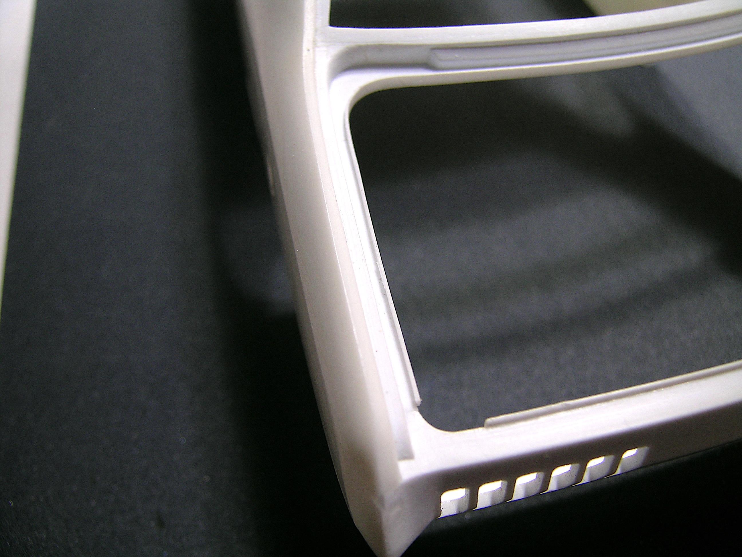

Hello Everyone, The last two weeks were not very productive due to the holiday season, and the fact that I worked because the plant was not closed. I still found some time to do a few things and today I'm going to show you the brackets I made for the rear light bezel. I chose brass in order to have thin and rigid parts since 0.010" Styrene would have been too fragile. Plus, it will appeal to fans of this material so there will definitely be some brass in this project! ? I'll be back soon with more stuff and a happy new year to all ! Francis The part I tried to reproduce. I made the opening and soldered to a brass strip to simulate the fold. Both pieces are fabricated but need a little sanding. The brackets are spot welded on the real car, but I made mine to fit between the 2 Styrene strips. View from under. This picture is a little less blurry I think. With the bezels in place. I will drill holes in the brackets to add small bolts to hold the bezels to them. -
