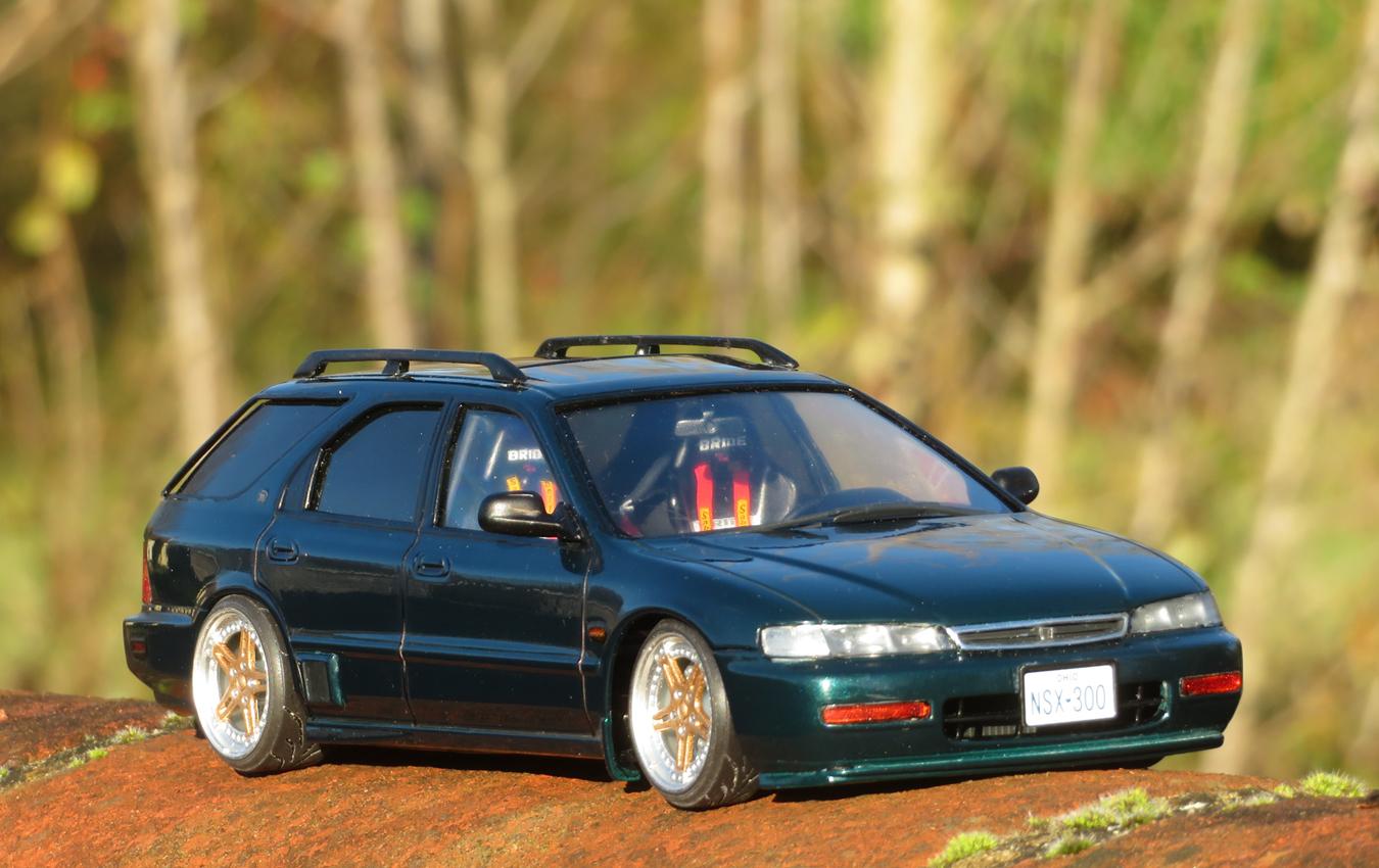

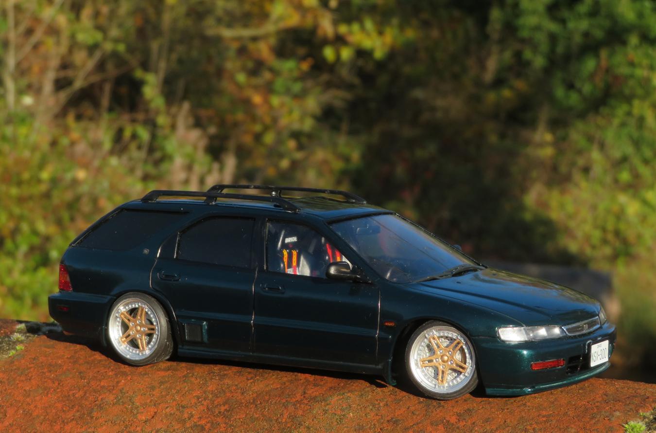

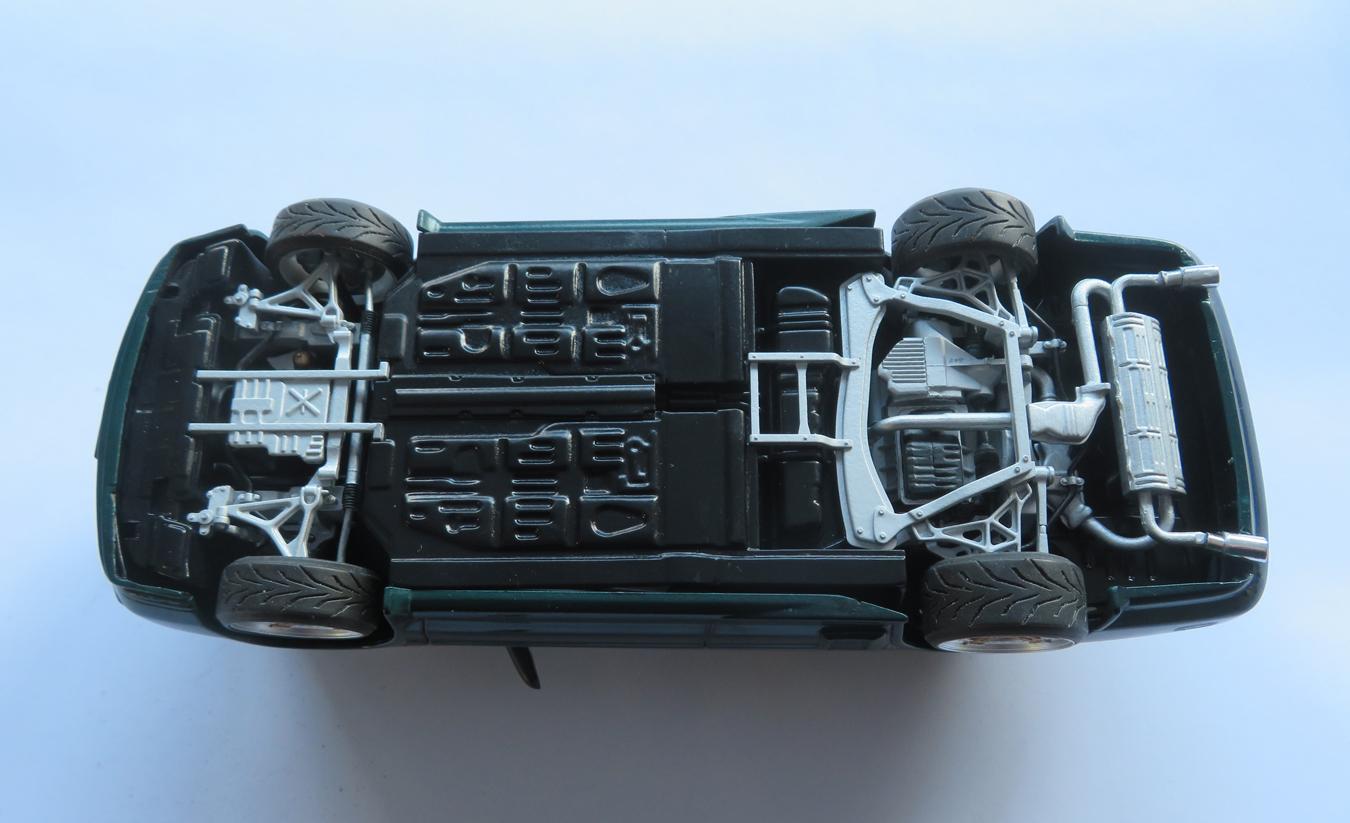

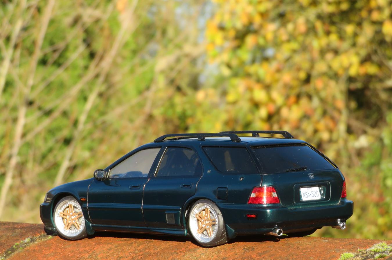

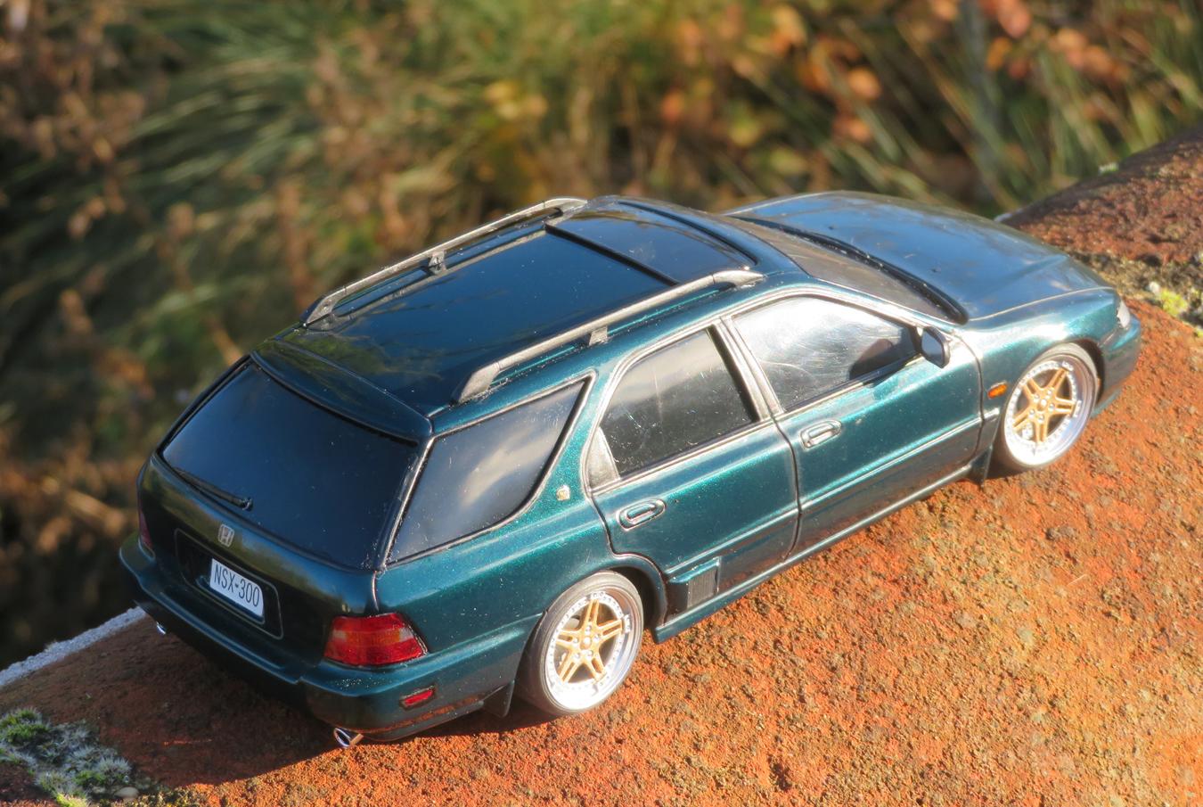

Another one makes it to the starting line.... Aoshima 1996 Honda Accord Wagon, on Tamiya Honda NSX floorpan complete with the mid-mounted V6 engine and suspension front and rear. Like a bigger, more sophisticated version of things like the Renault 5 Turbo or Clio V6. Bodywork largely standard, just a lip spoiler added to the bottom of the front bumper and side vents taken from a Monogram Chevy Citation. Paintwork is BMW Boston Green and clearcoat straight from Halfords automotive cans onto a generic grey primer. The colour is close to Honda's Sherwood Green of the time. Fujimi aftermarket 18" BRS M10 wheels, with staggered tyres from a Scale Productions set. Brake discs came with the Fujimi wheel set. Fujimi accessory tailpipes were grafted onto the ends of the NSX exhaust system , with an extra slot cut into the bumper for the dual outlets. Rather neatly the Accord kit includes two sets of glass, one clear and the other tinted, so it was easy to incorporate privacy glass to avoid anyone noticing what was different in the back. The NSX floorpan was stretched by around 8mm (8 scale inches), and its width was trimmed towards the back end. I had to extend the length of the rear overhang to suit the Accord, but at the front end it worked out just right. I was able to utilise the full NSX suspension front and rear, why change what Honda had worked so hard to develop? If anything I imagine the longer wheelbase will make it even more stable. This is where I did most of the work, and now it's the bit that's hardest to see. But I suppose that's the point of a sleeper isn't it? Added an aftermarket sports filter, which together with a bit of remapping and gentle tuning to focus on reliability rather than massive power I'd expect to give around 350-400BHP. I added the Scale Production NOS bottle for a bit of extra go when needed in an emergency. Interior tub was taken from the NSX complete with the LHD dashboard (to ensure good visibility for overtaking), with the side panels removed as I've kept those from the Accord inside the doors. Added Bride seats by Hobby Design with belt decals from a Belkits Opel Manta. Rollcage was cut down from a Tamiya Toyota Corolla rally car, which also donated a fire extinguisher. Folding engine bay cover fabricated from sheet styrene, with the rear of the loadbay cut from the Accord's original interior tub. All ready for the start, hopefully looking like little more than a nicely modified Accord Wagon and not something with the heart of a high-performance but docile supercar.

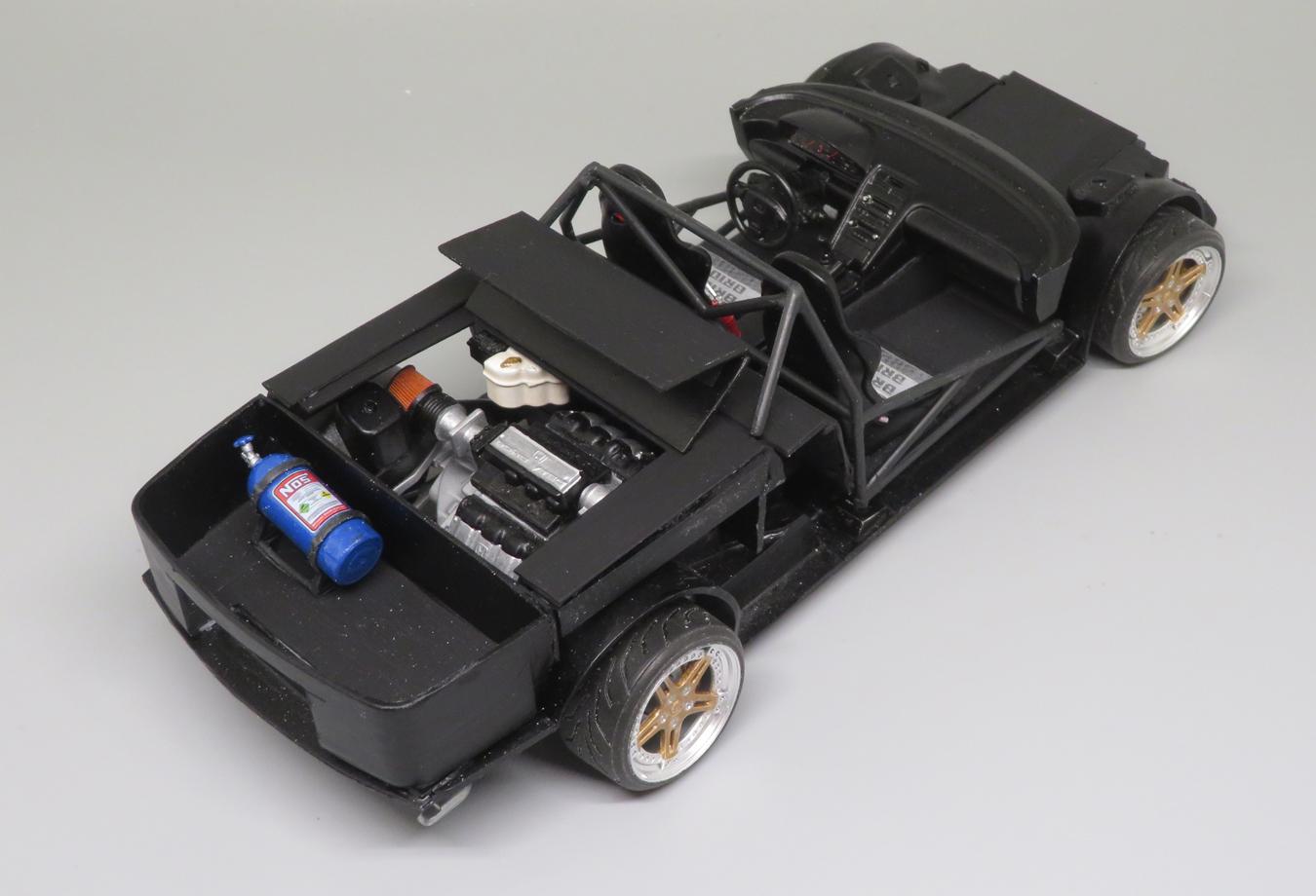

Final shots to come in the completed builds thread, but I'm there with my Accord/NSX mutation: For the engine bay cover I took inspiration from the folding boot floor in my 1:1 daily driver. With it opening up like this I figured they could access the engine either through the rear doors, or the tailgate. And it's a Honda, so why would they need to look very often?! And with it closed for normal running. Still got some loadbay at the rear plus there'd be space under the bonnet (sorry, hood). Got a final bit of cleaning-up to do before I get some better completed shots, but I can rest easy knowing I've got it finished two days before the deadline. Exhaust tailpipes have since been fitted, unusually they were the last thing whereas I normally make it the licence plates. -

More progress on the Honda, I'm managing to do something every day: Largely complete on the interior. Bride decals came with the Hobby Design aftermarket seats, belt decalsfrom a Belkits Manta rally car. Real material and PE fittings would have been the ideal, but not something I have time to do at present. Need to fabricate some form of engine cover. Rear loadbay painted-up, made use of the space to add the NOS bottle. Might be necessary when that little bit of extra go would be useful? Not quite there yet on the wheel fitment, and I need to get the brakes in place. Inner portions of the wheels have been trimmed and lights/indicators have since been fitted as I had some PVA out. Have made a start on the external window trim painting, that's to be finished when I have some daylight at the weekend. Not seen is the mocked-up rollcage (hence the PVA). That was quite a fiddle, but I need it to be complete to see how well it will fit and what needs to be removed. It's from a Corolla rally car and it seems like it might might just work (or at least part of it anyway). -
