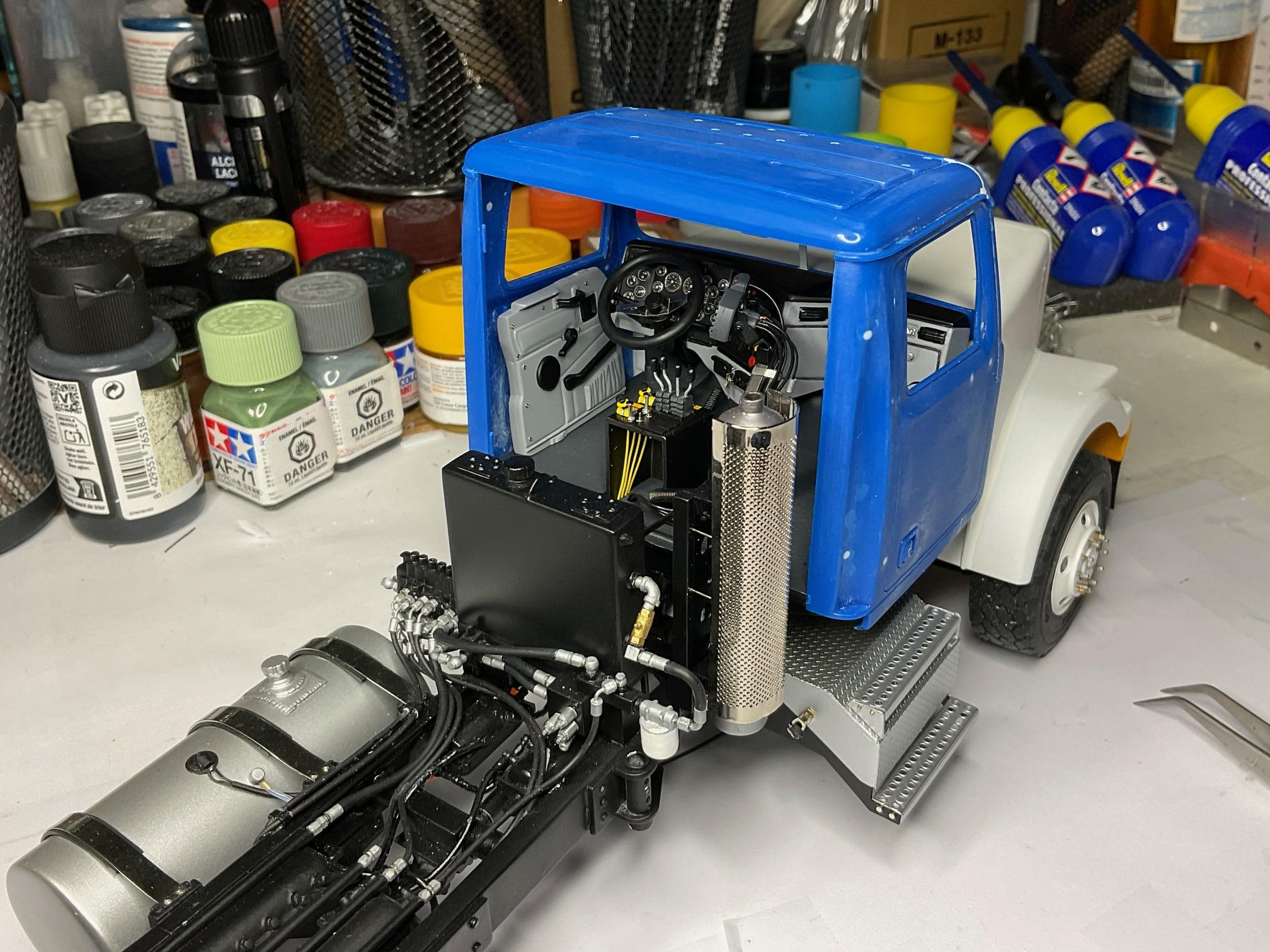

Worked most of the day today, on firewall items - making a few more loom clamps, the AC/heater manifold, and attaching the rest of the harnesses I had previously made. Don't know about you, but getting to the end of an intense day like this leaves me wondering where all the time went, so quickly. Little details sure take a long time! Made up the AC/heater manifold and wired it back to 'somewhere'! Four more fittings need to be made to hook up the AC lines to/from the receiver/dryer, and the two heater lines. Looking at the fittings on the overflow tank, I know they are not correct, but I didn't have it in me to wait for another order of parts to arrive before carrying on - Most of this was seen mounted on the temporary firewall, back in March (?), but it looks a little neater laid out on top of the painted firewall - An upright view - all the loose ends look a bit chaotic, but I do have destinations for all of them! - A final check at the end of the day - the hood is being held in place, tight to the cab and the hood support brackets on the firewall still line up with the supports on the hood - pretty happy with that! - Still some work to do on the firewall - some pass through air lines, just below the ECM and more air lines that exit the cab on the driver's side slope of the floor pan. Then need to think about getting all this on the truck! -

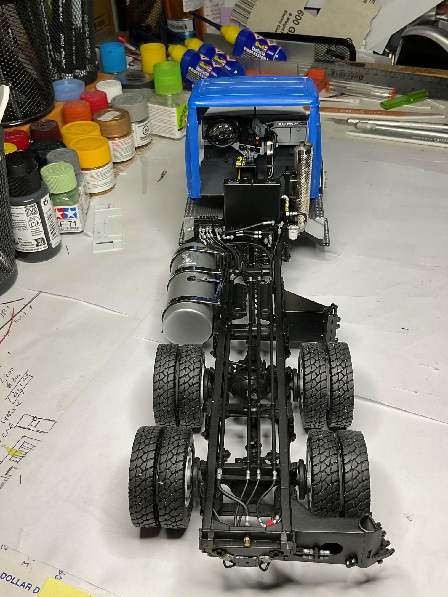

Burning the midnight (1:00am?) oil tonight. Got started this afternoon working on the cab, hoping to have door cards, seats and day cab panel on by dinner time. I did manage that, and got a start on the firewall bits, too. Adding in some down time for dinner, by the time various hoses were made, paint drilled out of mounting holes on firewall, gluing a few things in place, and running one of the wiring runs, it was midnight! Door cards and driver’s seat in place - again with the repetitive pics, but I wanted one showing the door card glued in - Ran the two supply lines for the air valves in the control tower, up from under cab - This turned out to mostly be a test to see if the CA glue would hold the plastic ‘air lines’ in place, as these won’t be visible at all when closed up - I’m using Gopher ignition wire for the lines - Day cab panel glued in place, finally! - Didn’t get away Scott free with this process - I test fit the panel half a dozen times and it always looked good, but once glue was in play, didn’t seem to fit as tight. Don’t know if the unpainted portion of the edge can be covered up ok without a big mess. And, while holding the cab in two hands, to put some pressure on panel, I cracked the opening around the air intake plenum - Lots of time for this bit of progress, but got the coolant overflow tank, the fuse box, and my version of the harness from the fuse box down to the Power Distribution Box glued in place. When cab is mounted on frame there is a red cable from the starter to attach to this box as well - Tomorrow, I want to work on installing the group of three control modules on the driver’s side of the firewall, the AC/heater manifold, the hood support brackets, and the ECM. Need to make a few more clamps to hold some of those harnesses in place. It all had a place on the test firewall, back when, so hope everything plays nice tomorrow, and I don’t break anything else! -

Everything can't be a milestone, but it felt like it today - got the headliner and interior 'tub'/floor pan glued inside the cab! Also spent a good bit of time making the brass fittings (basically just brass tube bits) that pass through the cab for the air lines from the control tower to the air over hydraulic valve manifold that sits beside the hydraulic tank. I used epoxy to set the headliner in place and the epoxied the front wall of the interior tub to the back of the firewall - a flange on the dog house enclosure has always been the main locator for the interior to the firewall. I didn't epoxy the back edge yet to the cab edges - that will be done when the day cab panel finally goes in. Used more of the RC heat shield tape for lining of the dog house- For some 'fittings', I cut short, brass sections from .7mm tube, all the same length, and epoxied them from the back side, locating them flush with the inside pass through plate, so each tube section was the same length on the outside - From back on page 24, this is a sample of the air lines that need to be fabricated and attached to the valve manifold - The Auslowe day cab panel didn't come with glass - I found a decent section of some thin, plastic packaging, cut a templated piece out and epoxied the rear window in place - I want to get going on the firewall attachments next - the hood supports, coolant overflow tank, fuse box, etc,. I will still need to do just a bit more work on the engine, before I can glue the cab to the cab supports. Still haven't been able to do the chrome test yet either, so that's on a wait list. Once the firewall attachments are on, and the chrome done, the cab and sander can be glued in place. Then, I will need to work with the truck on it's side (hoping not to break anything else!), to be able to run the various looms/air lines under the cab and hide their termination along either side of the frame. Some of the lines from the sander will need to be routed under the cab and up into one of the pass through tubes in the floor pan. So close - yet lots of little stuff to do! -
