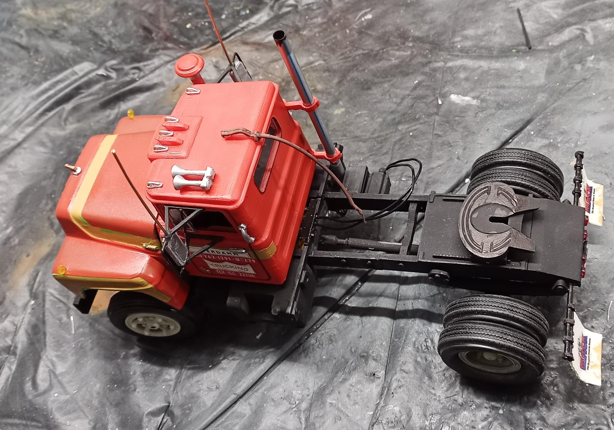

The cab in position. The long hinge rod will be replaced by two short pins that won´t be visible later. Still a long way to go. Chassis and cab still not reworked. The seam from connecting the chassis rails is still visible, the cab still shows quite a lot of waste material especially around the rivets. But I gave myself time till about Christmas to finish it. Leaves a comfortable time window. -
