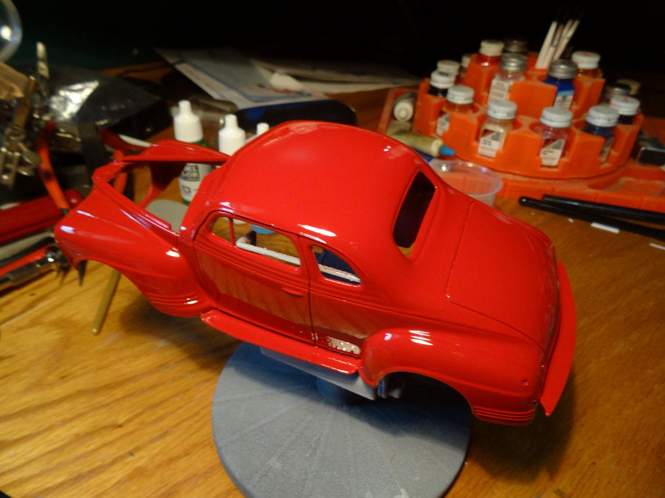

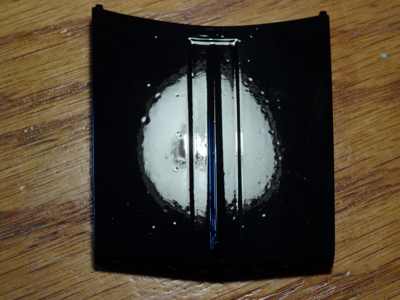

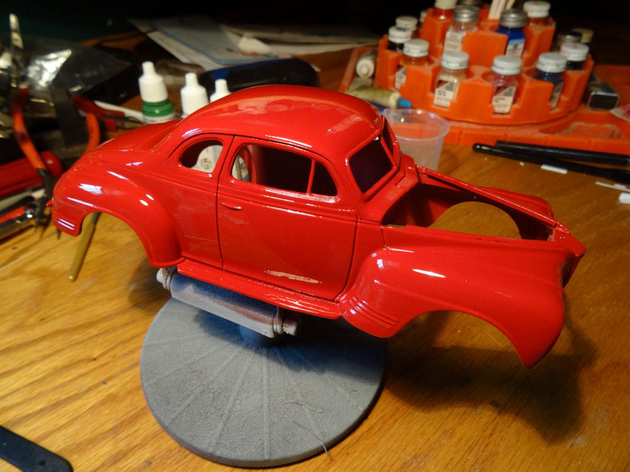

Finally getting ahead of the clear-coat. Gave me a hard time as I explained on my 41 Plymouth build so I won't get into that here. In a nutshell the paint is Tamiya primer, followed by a coat of Createx Opaque Black topped off with some Wicked Black (semi-opaque) and finished with some automotive 2K clear from Kirker. Initially the hood came out loaded with fish-eyes. ? After some wet sanding a couple more coats of 2K I think we got it resolved. Still have some wet sanding to do and a final polish. I want to tone the shine down a bit anyway. I'm not sure why the hood looks so dusty in the last shot, maybe I need to clean the camera lens.? Thanks for dropping by.

You can't wipe down this Wicked paint with alcohol, that's the problem. If you wipe it down with most anything you can wipe it off. You can't sand it either. If you sand it you have to apply more paint before you can clearcoat.

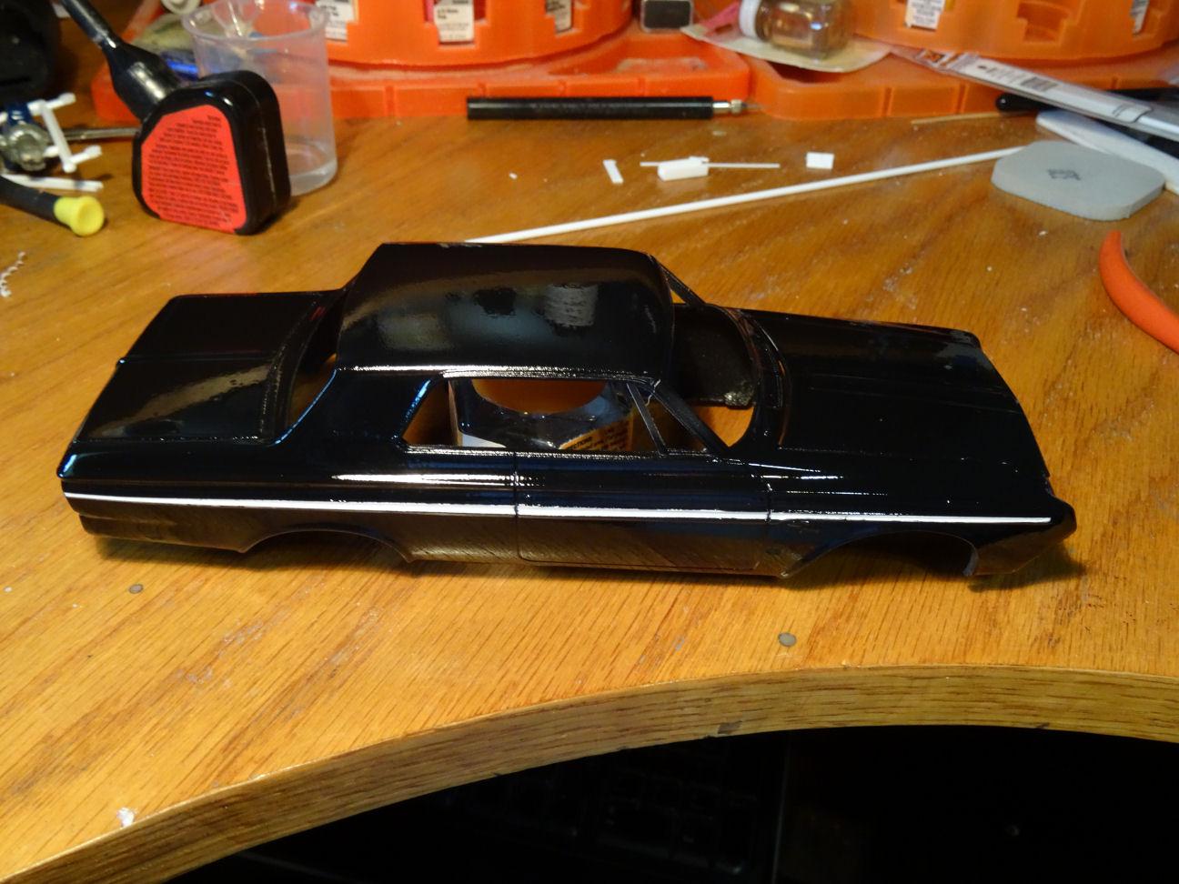

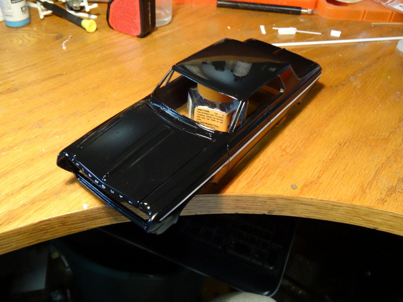

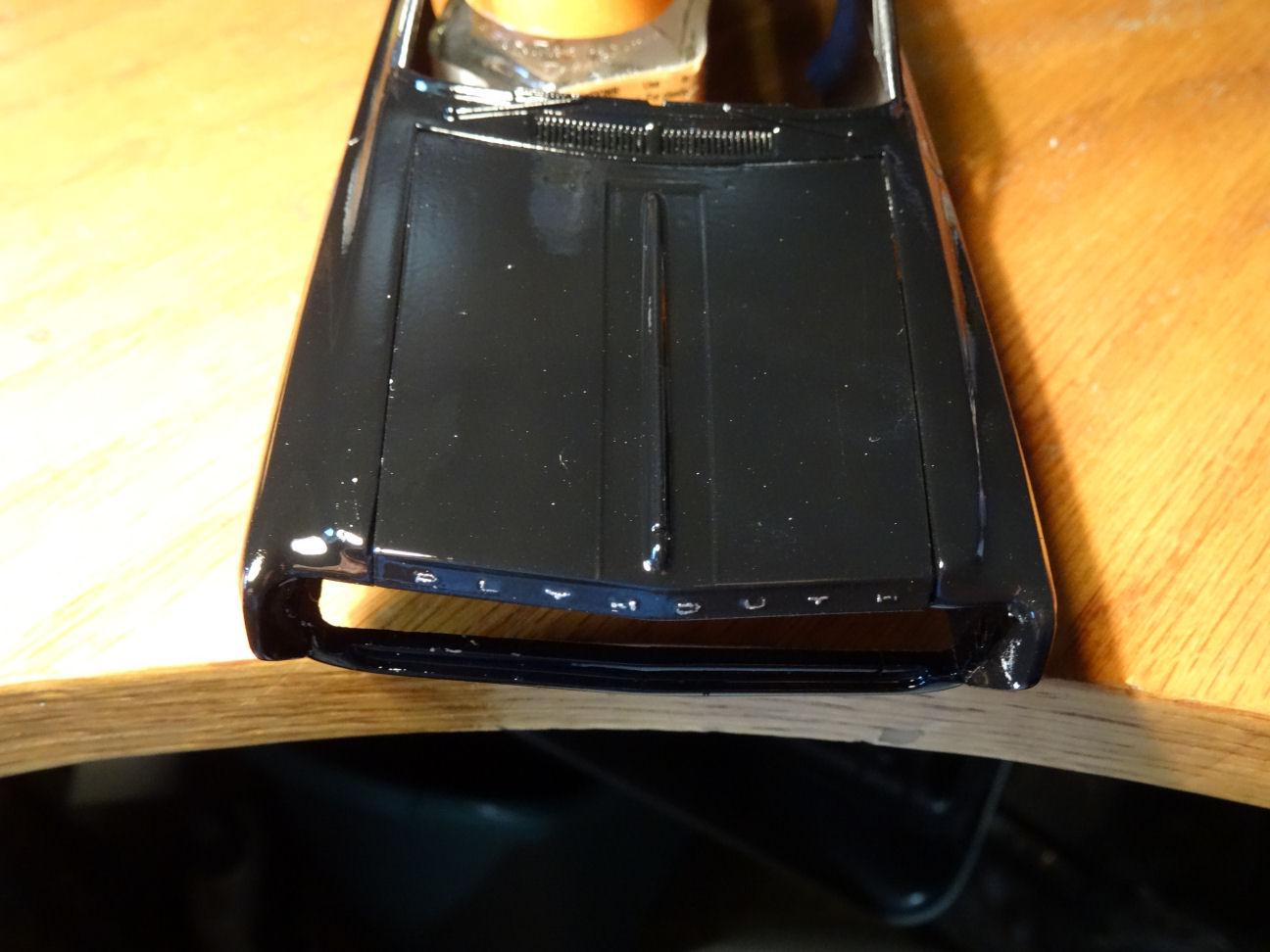

Usually fish-eyes are from dirt or oil on the surface which keeps the paint from adhering in that spot. But in the case of this Wicked paint I'm thinking it's something else. It's funny that both hoods from the Fairlane and Fury have got it the worst and the roof and the trunk lid have a bit of it. All the sides are good. So I'm thinking it's more an incompatibility with the paint and the clear. But it didn't do it on the 41. Same brand of paint so go figure. The paint has been dry for a few weeks on all of them so that shouldn't be the issue. Hopefully a bit of sanding and another coat will solve the problem. Don't want to have to start all over.
Finally starting to see the light at the end of the tunnel. After fighting with a clear coat finally got a combination that worked. Had to give up on the Tamiya because, as you saw, it just ate up the Wicked Paint. Tried some Testors Clear. Out of the can it went on too heavy. Decanted and sprayed it with an airbrush and it was OK but I couldn't lay down a nice smooth coat no mater what I tried. Different pressures, different guns, It finally clogged my gun so I gave up and dug out some 2K automotive clear from the garage. Will need a little polishing but I think it works. I also sprayed my 68 Fairlane and 63 1/2 Plymouth. I had some issues with them and the 2K with some fish-eyes. ? Haven't had problems with fish-eyes since spraying enamel back in the 80's. Hopefully I can sand that out tomorrow and make headway on those two. ??
