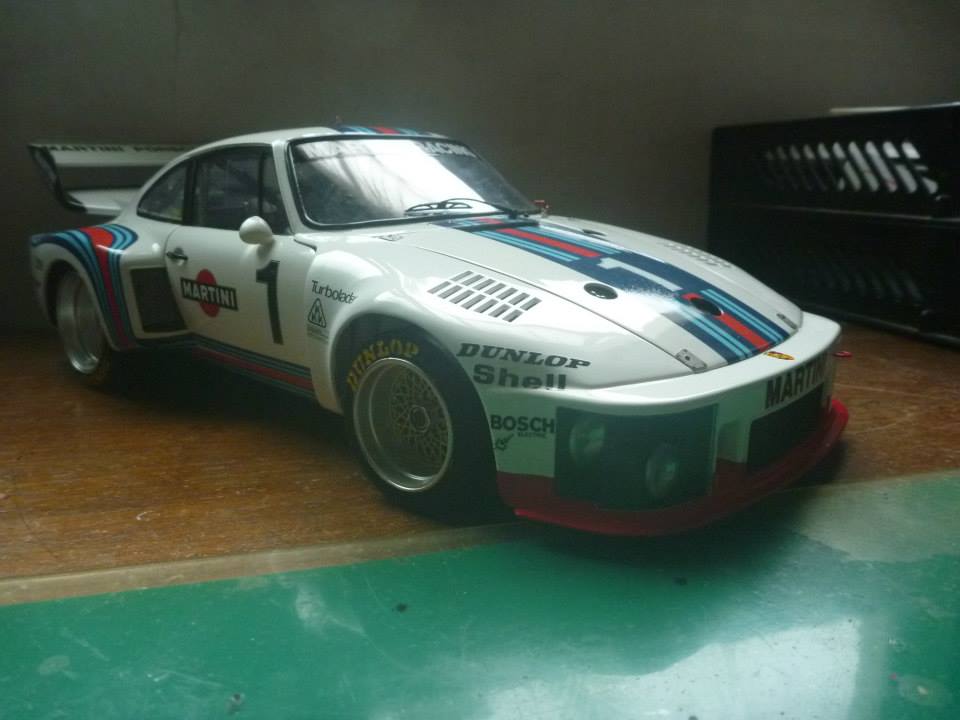

Move this car to the underglass and big boyz section already. But one more thing I did to it is the tires. Scrubbed it up. Need to go shop for some aftermarket tire valves and glue some weight on the rims. This car is basically done. -

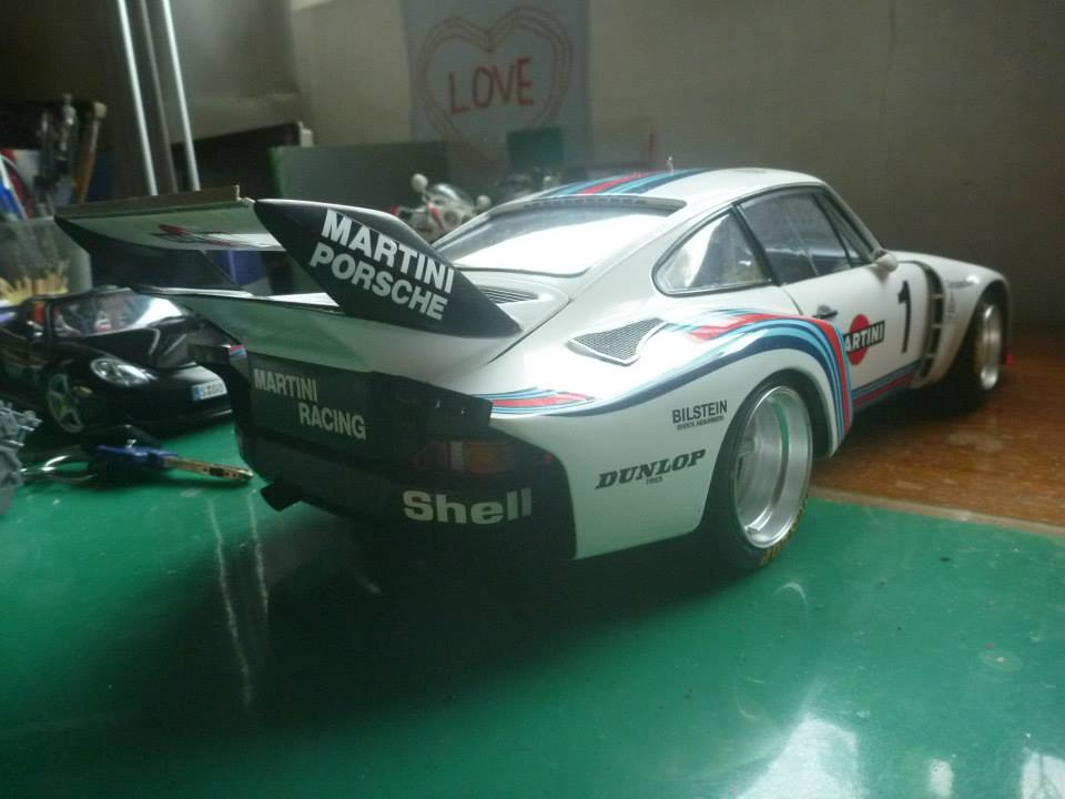

this one is in WIP and under glass section. But this really belong in the big boyz section. A tamiya kit that i struggle to finish in 5 years due to laziness, the actually time of build is about 3 weeks. Did add and modify a few things on the way and slightly weathered it. Still tweaking it a but it is close enough to be featured now. Thanks for looking.

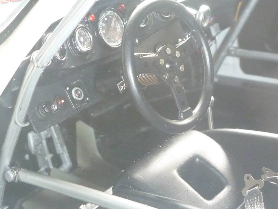

I added a lot of stuff in the dash and weathered it. I used quite a bit of PE screw head on the dash and build lens cover for the instrument. Also drilled a cover on top of the dash for venting purpose and wired up the fuse box. Other than that, it's all from the kit. The picture is the dash during WIP. not all done yet but close enough.
Time to move this over to this section. This has been WIp for way too long. Anyways a re-issue Tamiya 1/12 Porsche 935 with PE kit and Cartograph decals. A very superior kit considering it is done in the 70's. Few minor issues and modifications to make it what it is today. The sad part is that some of the decals are layed on with blemish and this kit is all about the Martini colors. But still quite an enjoyable build. Thanks for viewing.

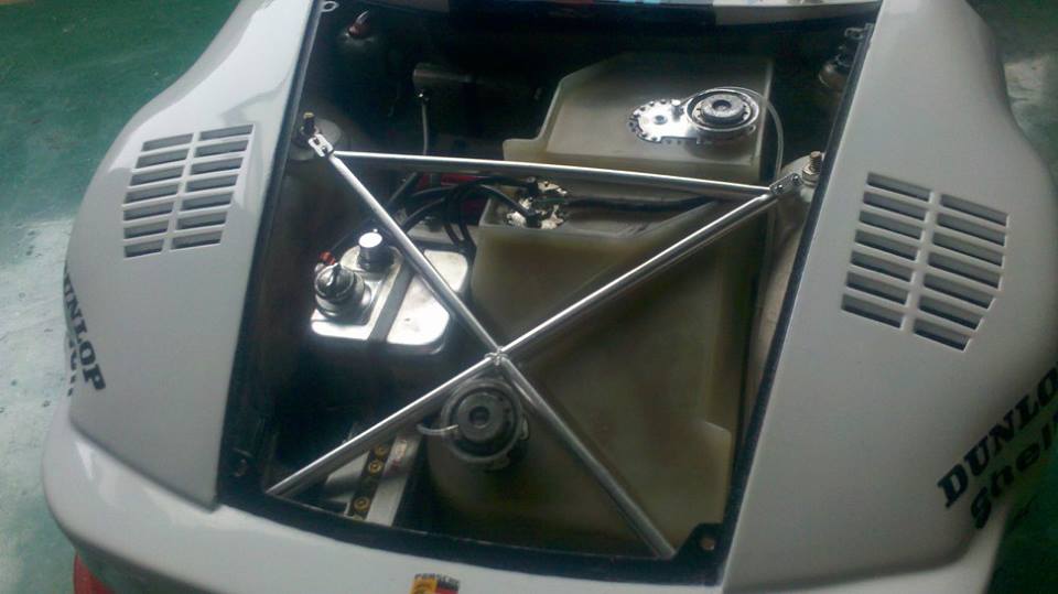

Large kit has issues just like small kit has it's own set of limitation. But with these big scale, the details can really be brought out to shine.Just a few small details to be put on and then some tweaking then I will call this car done, Pulled out my 1/12 Rosso NSX already. that one is up next. And thinking of some crazy stuff to do it. In truth, this kit is so well engineered especially it came out in the late 70's.The few issues with this kit, the window frame engineering is sort of strange and difficult to put on. Some of the rubber pieces are weak (they tend to break into pieces), I disconnect the steering since it wouldn't last past a few turns. If the steering gears and linkage can be built in metal, then it will be amazing. Other than that, it is great kit. -
