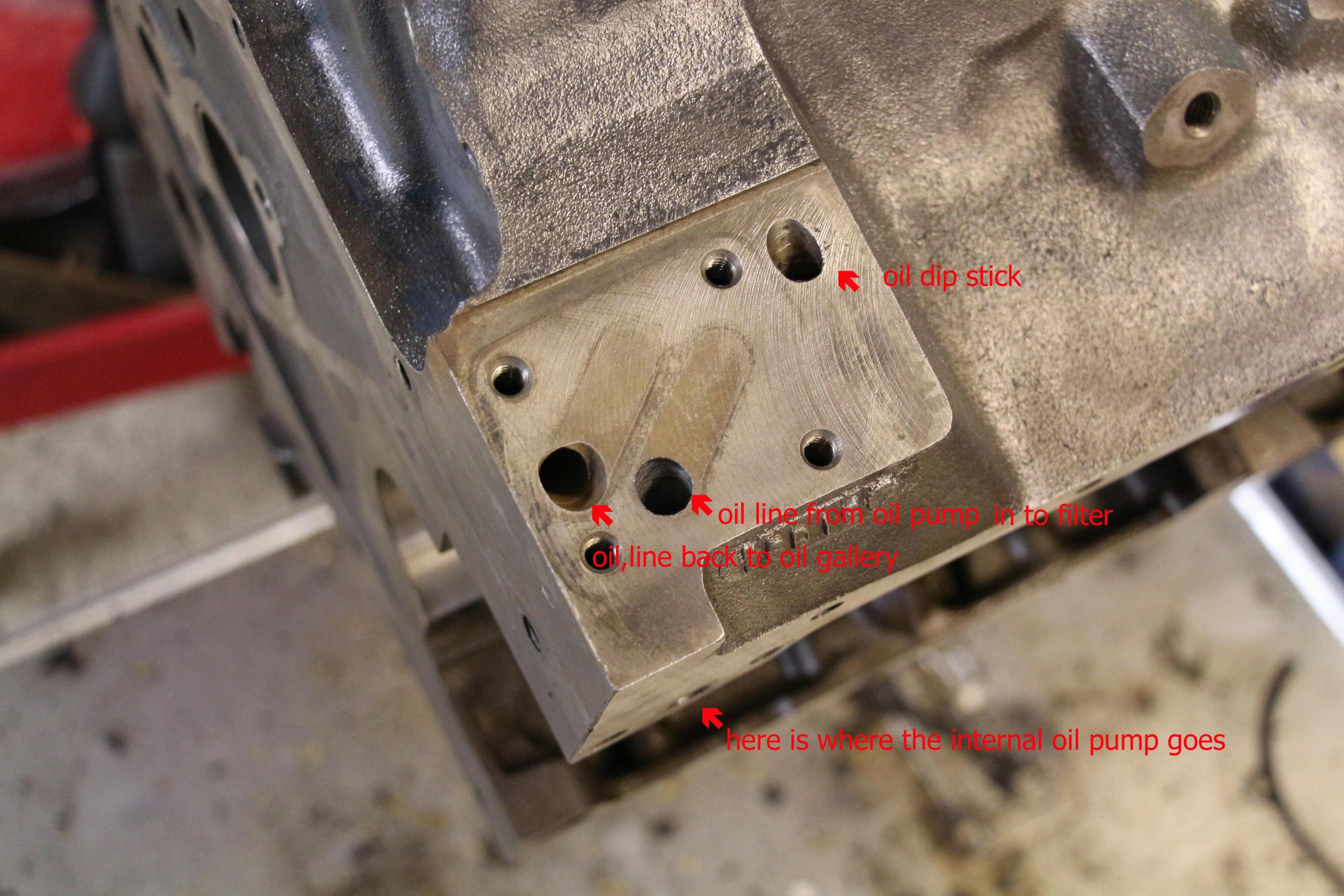

The aluminum colored cover w/four bolts is where the oil filter adapter/housing usually are as it's a separate piece on the FE, and this plate seems to be just a block off plate, behind that plate it's only two oil passages, one comes from the oil pump and goes in to the filter and the other one goes back into the oil gallery inside the block...so it's just like a loop and nothing more fancy than that. Sometimes remote oil filters are used and there are a couple different adapters for that, and they are bolted at the same place as the reguar filter adapter/housing. You can't put an external oil pump at this spot (like on a Mopar 383-440 RB and Hemi) as you don't have any way to drive it, the oil pump on a FE is internal and driven with an axle from the cam shaft and distributor right above it. The Mopar RB oil pump are on the outside of the block and is also driven from the cam shaft and distributor but the axle for the pump goes all the way through the engine block to the outside pump. Here is a picture of the 390 engine I'm rebuilding right now for my 1963½ Galaxie to explain how it looks like behind that block off plate.
