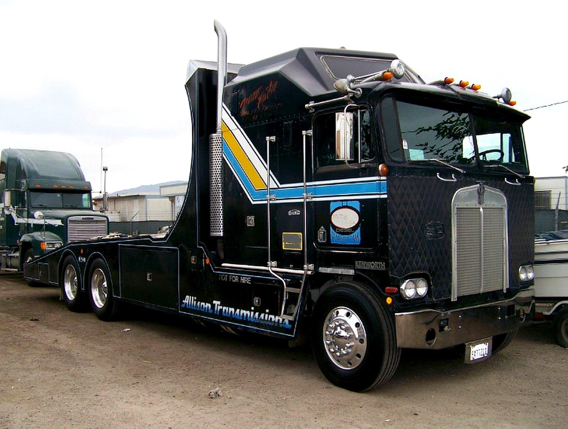

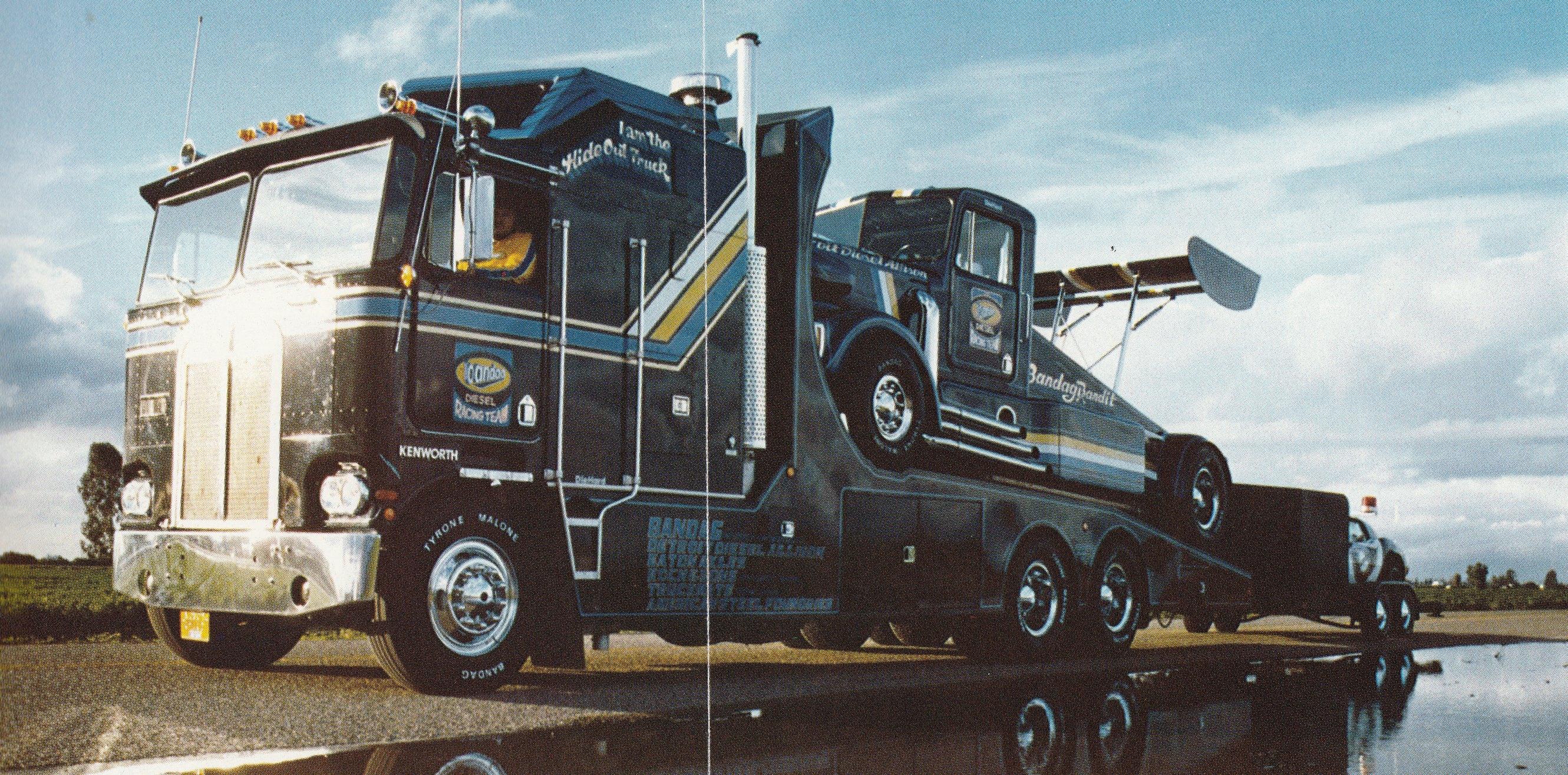

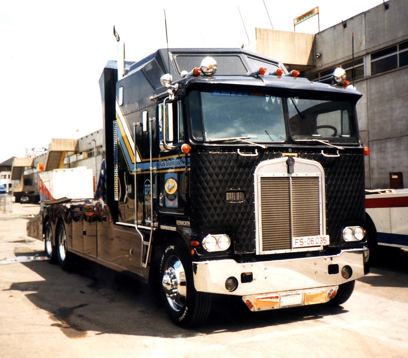

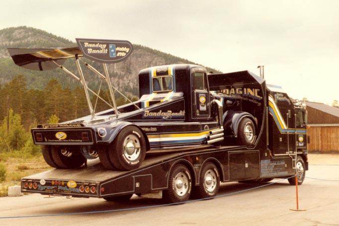

  16. I thought the Torsion Bar went out when the AG100 came, well you learn something every day, I have also read somewhere that a well maintained Torsion Bar rode at least as good as the early AG100. I know Tyrone Malone had the old KW 4-bag on the Boss Truck Of America wich was a 1971 model and on the 1970 Mama Truck transporter as well. The 1976 Papa Truck Transporter had the Torsion Bar and the 1978 Hideout Truck Transporter had the AG100 wich appearantly was new for that year, the 1974 Super Boss and 1978 Bandag Bandit Racing Trucks both had Torsion Bar single drive. Peterbilt's first air ride, the Western Unit Stabilaire, was as I hear quite rough too like the old KW 4-bag, but the later Air Leaf was much better, the Stabilaire was taken over by Freightliner and was called Airliner.
  17. I was going through the MTDG Facebook group just now and noticed a thing regarding the Malone trucks in a thread where Ben Wicker shows the correct style 5-hole Truck Mate wheels he has done the master for and sold by Jamie at Mo'luminum, I'm not a member on Facebook so I give out the information I have here. Someone there said the Hideout Truck had Alcoa 10-hole wheels at one time when Malone had it and they were covered up with Truck Mate stainless steel wheel covers...that's not really the case, Malone was sponsored by Truck Mate (wich is still around) and the Hideout Truck had the stainless steel wheel covers at one time, but under these wheel covers it still has the Truck Mate chromed 5-hole wheels with the same tube tires as before, even the Bandag Bandit had the same wheel covers on the rear wheels at that time...the wheels on most of the Malone trucks was later changed to chromed 2-hole wheels and 24.5" size tubeless tires. I don't think Truck Mate had any 10-hole aluminum wheels at that time and the only pictures I have seen where the Hideout Truck has had 10-hole Alcoas are from after Malone himself had passed and the truck was sold and when the truck was found again not that many years ago. Bridgestone who now owns the Bandag Brand was approached and offered to buy the truck so they could pair it up with the Bandag Bandit they allready have again (sits at the Iowa 80 Truck Stop Museum), a representative from Bridgestone came to California where the truck was and looked at it, they considered to do it but they changed their mind and finally declined...Gary Ries from Hastings MN has since bought the Hideout Truck and is going to restore it like he did with the Papa Truck Transporter he had bought earlier, he also owns the Super Boss, the Whale Truck and trailer, the Hurricane, the Defiance wheel stander Freightliner and the Smokey Bear Corvette from the Malone stable...Gary also tried to buy the Boss Truck Of America some time ago, the truck sits in Texas somewhere but that deal didn't go through, it's in pieces and the owner wants too much for it. Here are some pictures to show what wheels the Hideout Truck has had over the years. First the early Bandag version from approximately 1979-80 with the chromed Truck Mate wheels and tube tires, the first Thermo King version from 1978 did also have these wheels and I have posted a picture of that version earlier in this thread. A version with the Stainless Wheel Covers some years later, around 1981 or so, note that the Bandag Bandit has the same wheel covers on the rear wheels and that truck hasn't had anything else than tube style tires under it's life and it still has. An even later version some years later 1988-89 where Malone had changed to 2-hole chromed wheels with tubeless tires and a different paint job. This picture shows an even later version with the 2-hole wheels and the paint job is changed slightly again, more texts and the outlines of the white yellow and blue stripes on the cab are white instead of gold. Finally the version when the truck was found again in 2009 before Gary Reis bought it, the paint job is still nearly the same as in the picture above but now it has 10-hole Alcoa wheels.
