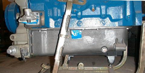

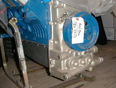

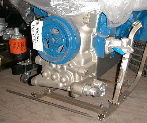

Here is a couple of pictures of the Ford FE dry sump system used in the GT40 Mk II and Mk IV, it's different from the Boss 429 setup as the pump is driven internally inside the special aluminum front cover, the rest of the oil pan is magnesium. This is the GT40 Mk II but the later Mk IIB had the oil reservoir at the rear of the car instead of at the front, the scavenge pump in this picture is wrong as that's where the oil filter normally goes, the in and outlets from the pump can be seen at the bottom of the front cover in the pictures above. -
302 cui is close to 5.0 litres (4.9489 to be fairly exact) so yes it's the 5.0 from 1982-2001 and it belongs to the Windsor 90 degree V8 family wich also includes the 221-260-289 and 302 and the older engines are very similar with some small differences to the later 5.0 versions. The 351 Windsor is also from the same family but as Dave said it's slightly taller and wider and the only things interchangeable with the smaller displacement engines are the heads, camshaft (different firing order tho') and some other things like oil pump, fuel pump and so forth, the crank can't be used in the smaller versions as the main bearings are wider in the 351. The 351 has the same 4.00" bore as the 289 and 302 and the crank has 3.50" stroke, the 289 has 2.87" and the 302 has 3.00" even so if you could put a 351 crank in a 302 you would get a 347 cui engine, but it doesn't work as I said so the 347 stroker kits available for the 302 takes care of that in other ways with a .040" overbore and a 3.40" crank. For did a couple more 5 litre engines, the Boss 302 from 1969-70 wich is a Windsor 302 with Cleveland style heads and the 5.0 Coyote based on the 2-3 and 4 valve Modular engines from 1991-forward and the new Boss 302 wich also is a Coyote.
