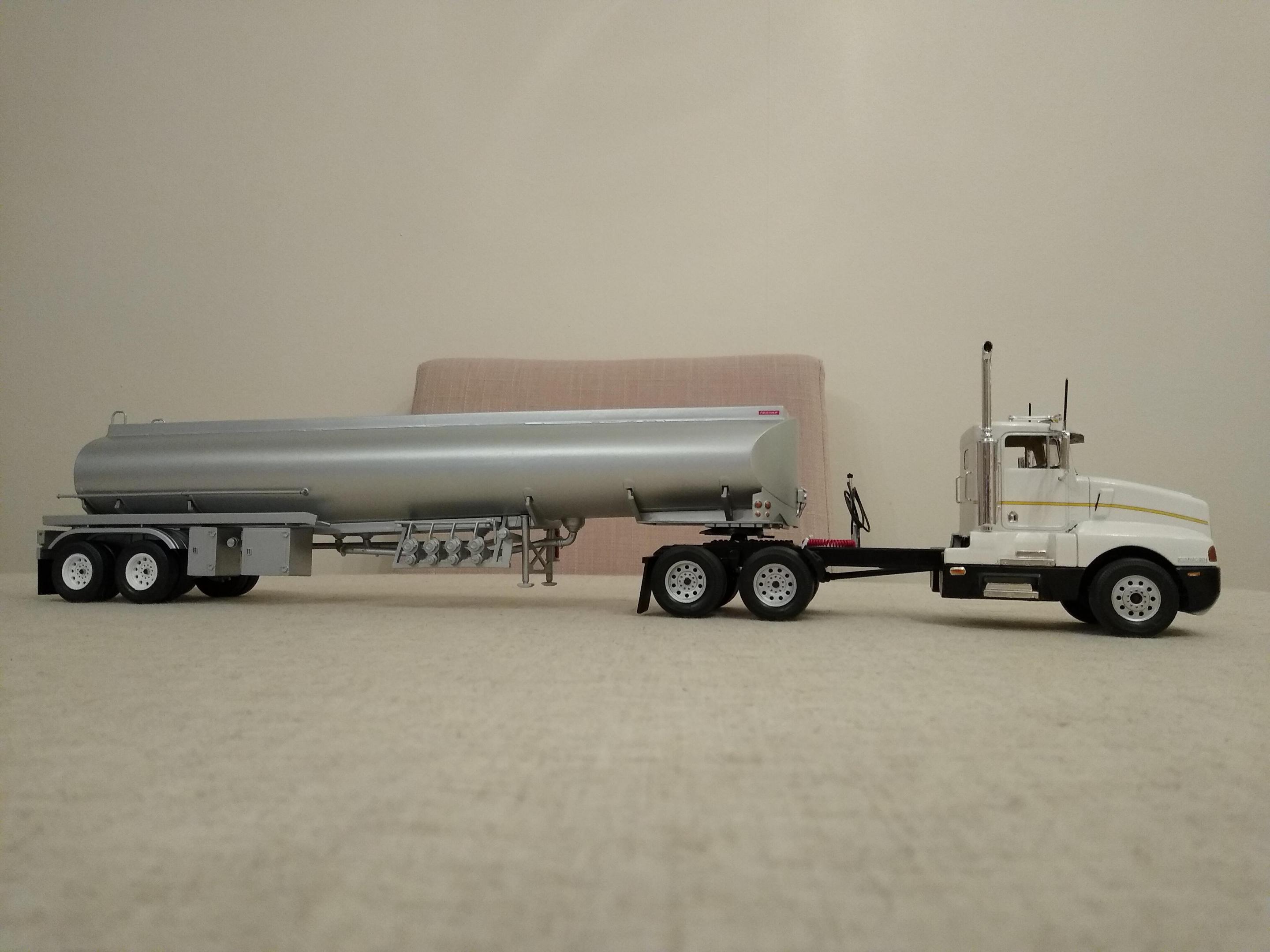

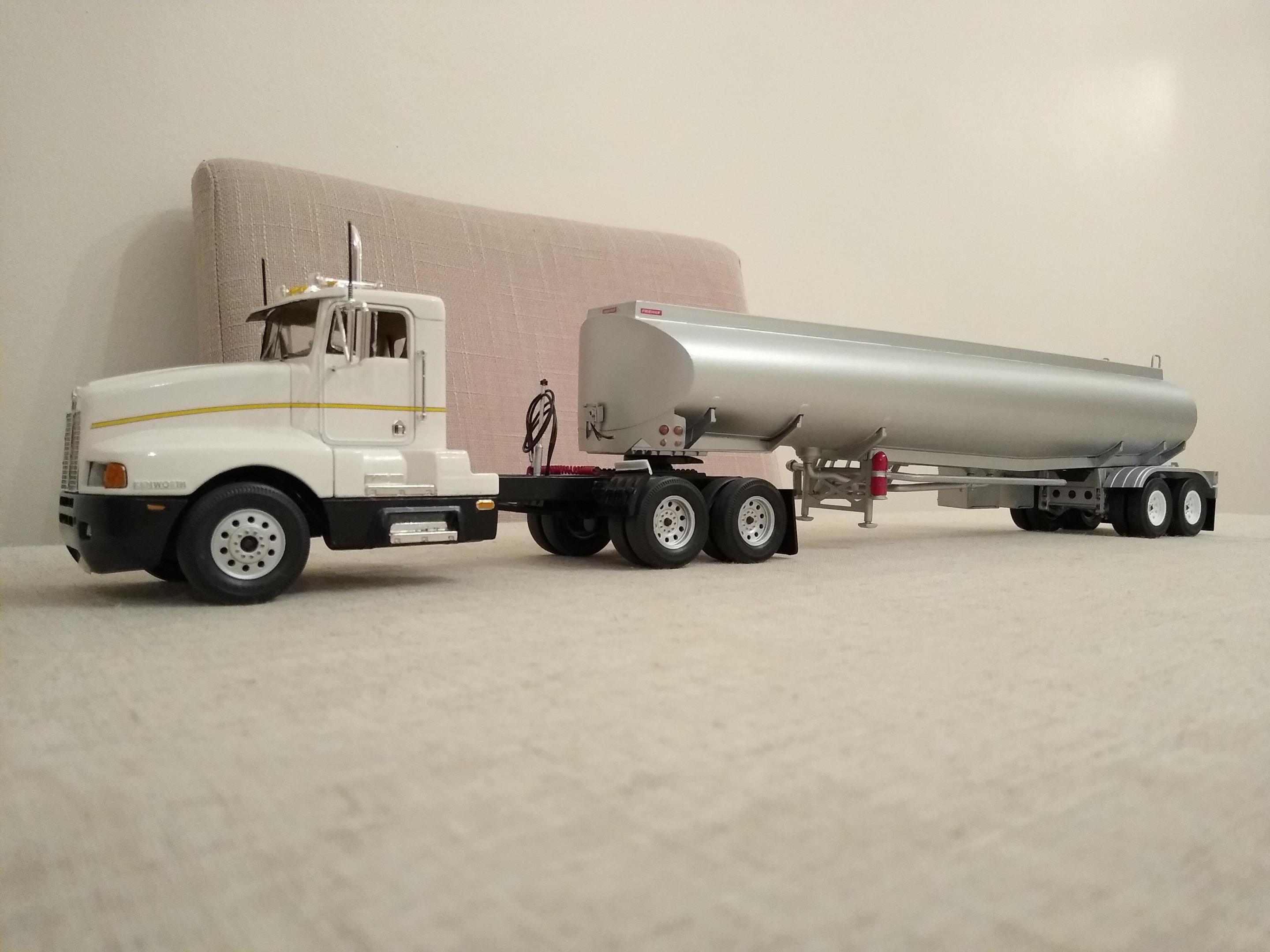

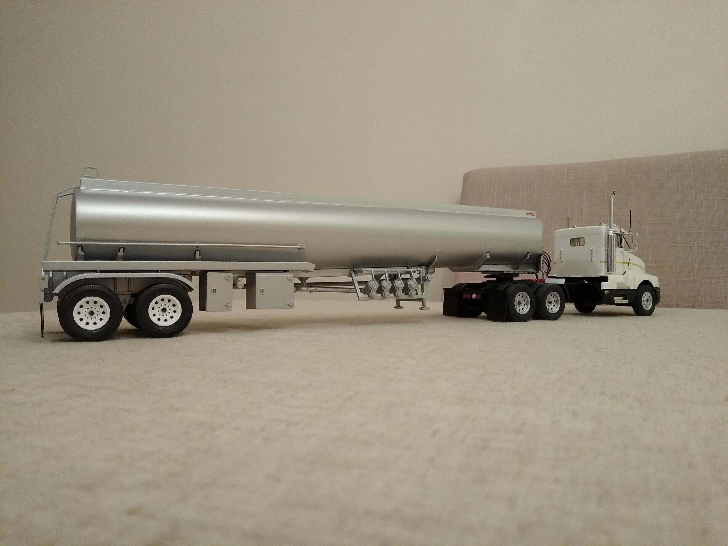

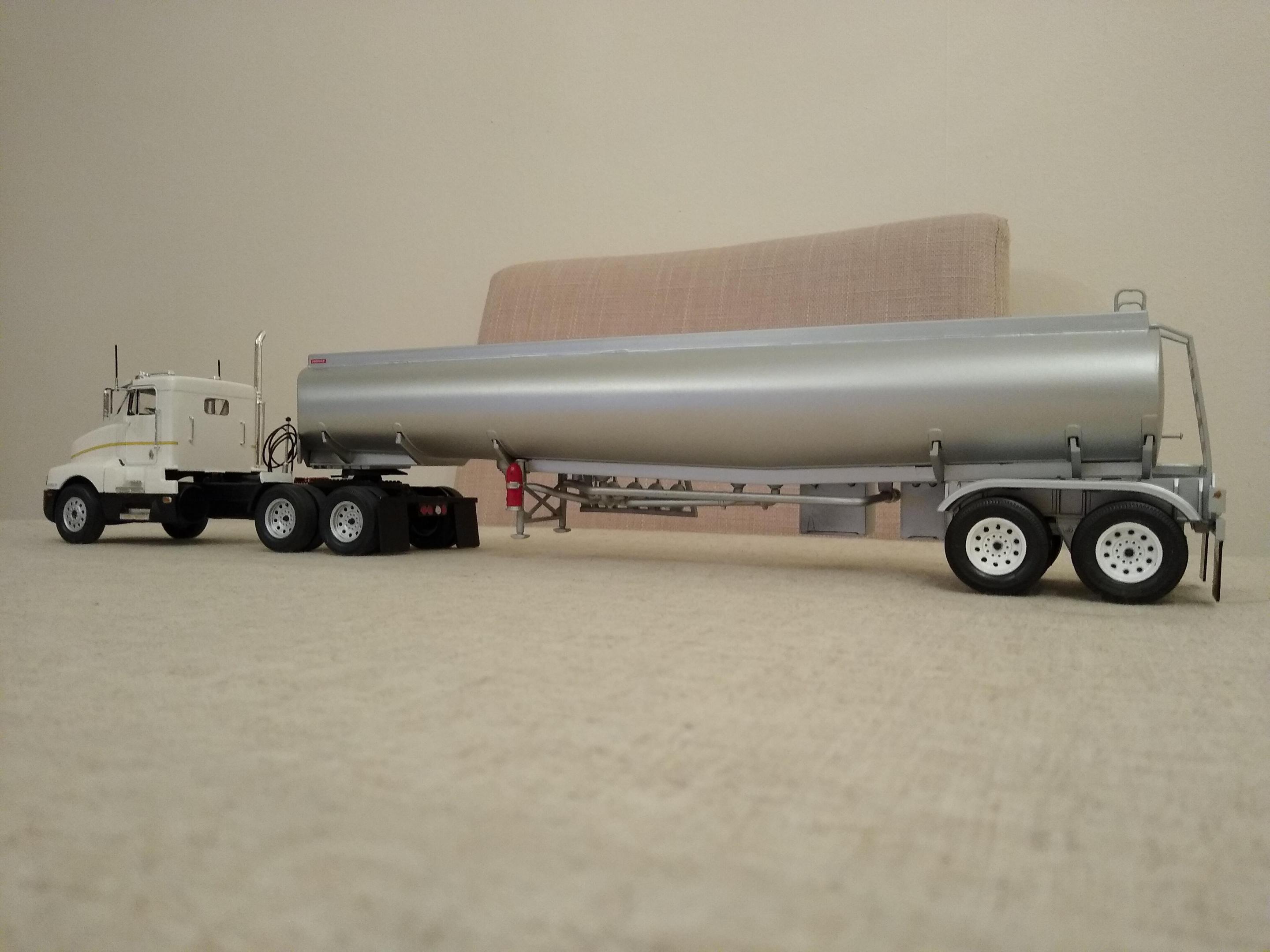

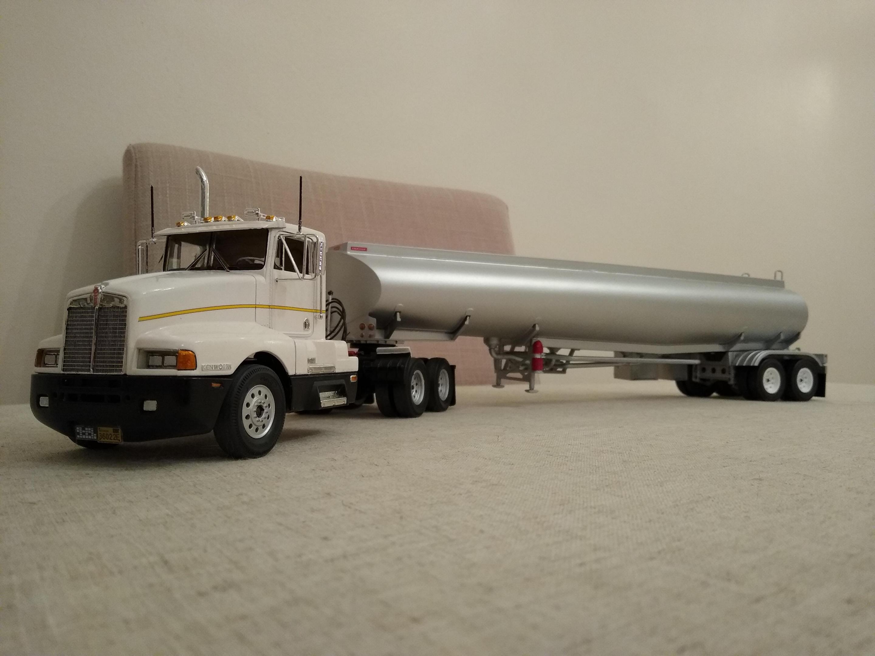

Finally finished my tanker and put it behind the T600. Looks great! Tried it behind my other tractors and it looks great even though it's a snap kit. I'm happy with it considering I almost binned it. I need to find an easy way of hooking up the airlines and electrical cable. That's being pondered as we speak. -

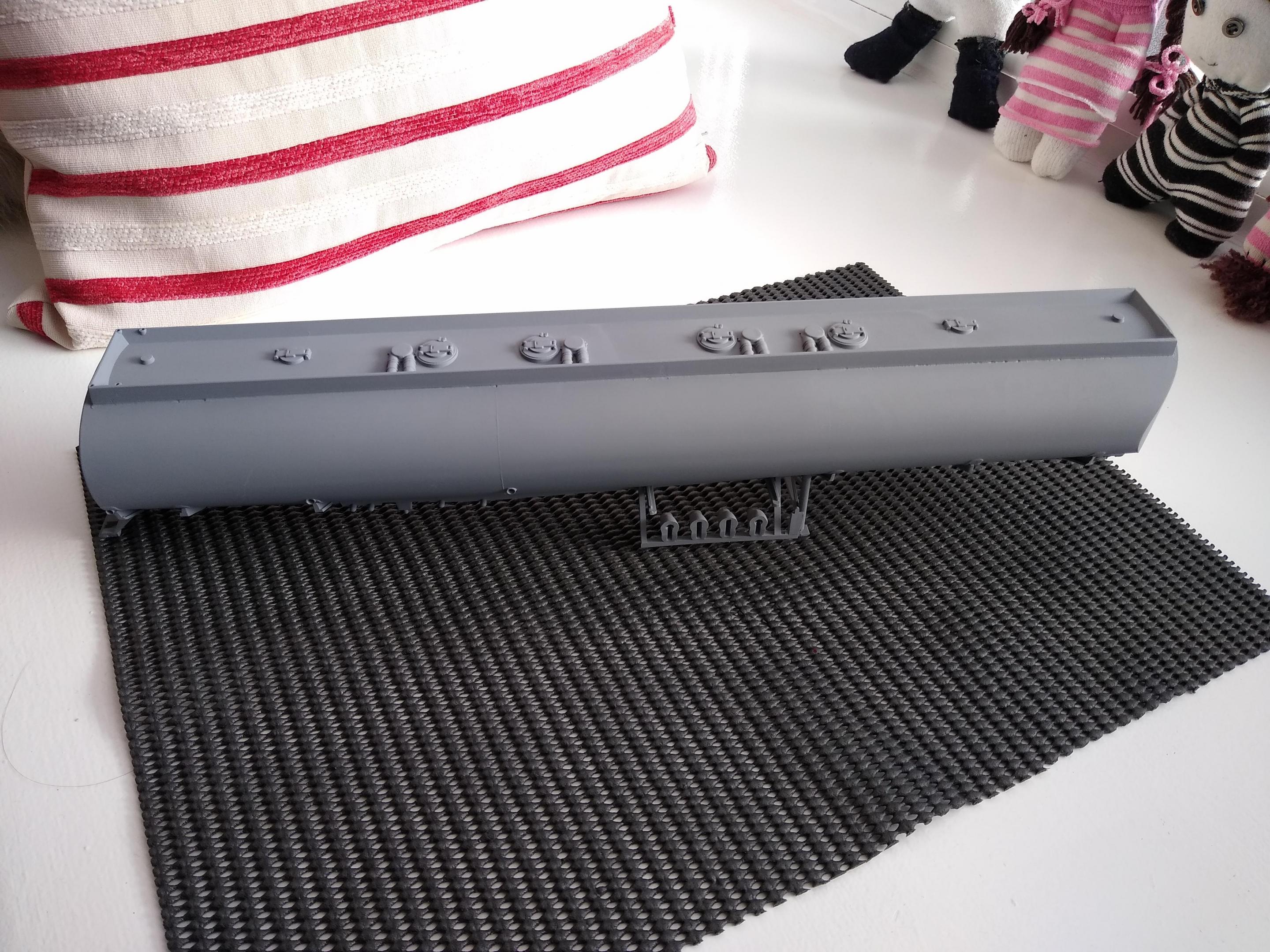

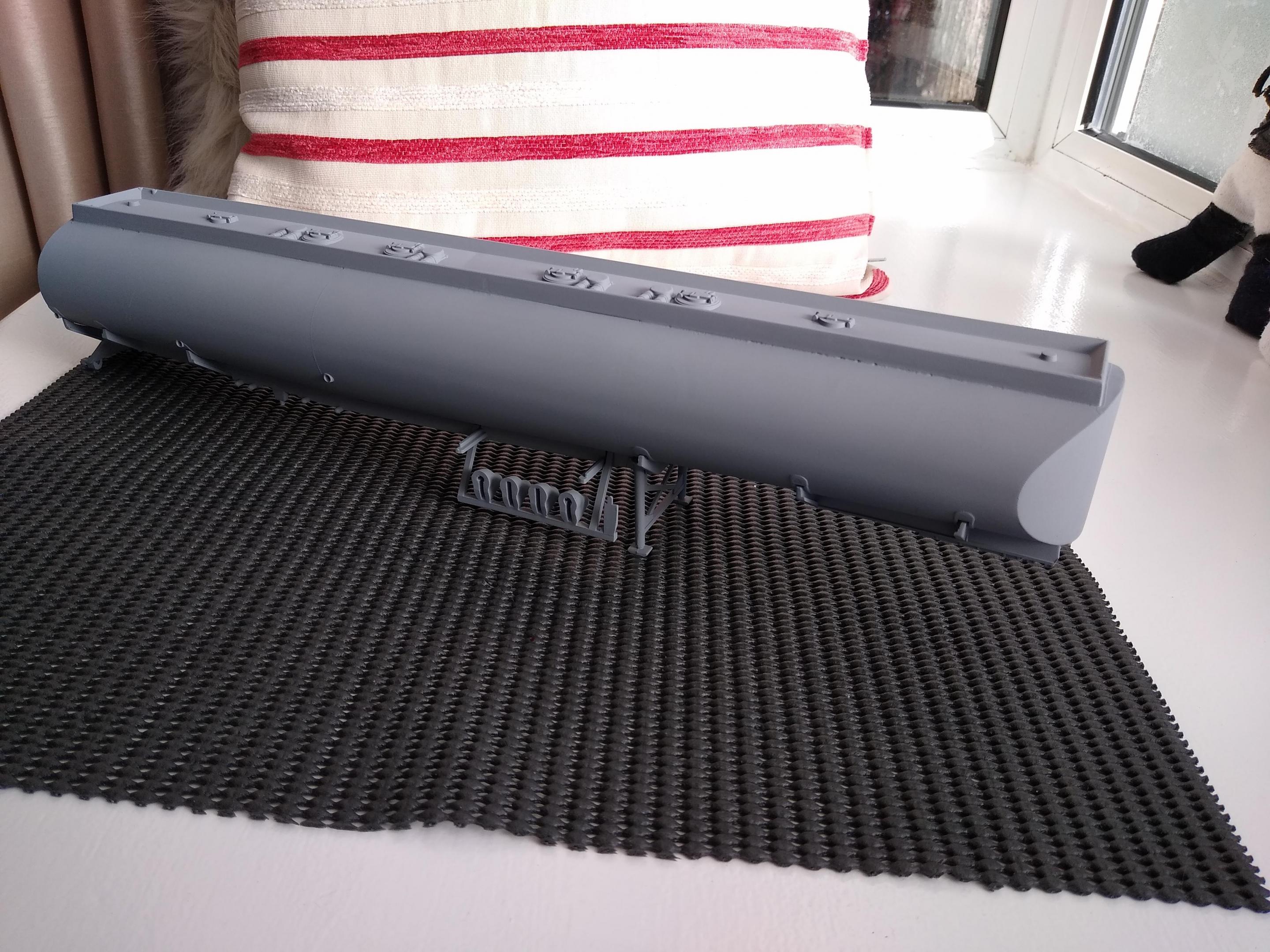

Would you believe today turned out to be beautiful, dry and warm so I bit the bullet and shot the primer on the tank! Came out ok, can't see the glue damage so I'm really relieved. Wednesday will be even better I believe so I'm going to give it a quick run with a scotchbrite pad and make it silver on Wednesday!!!! -
