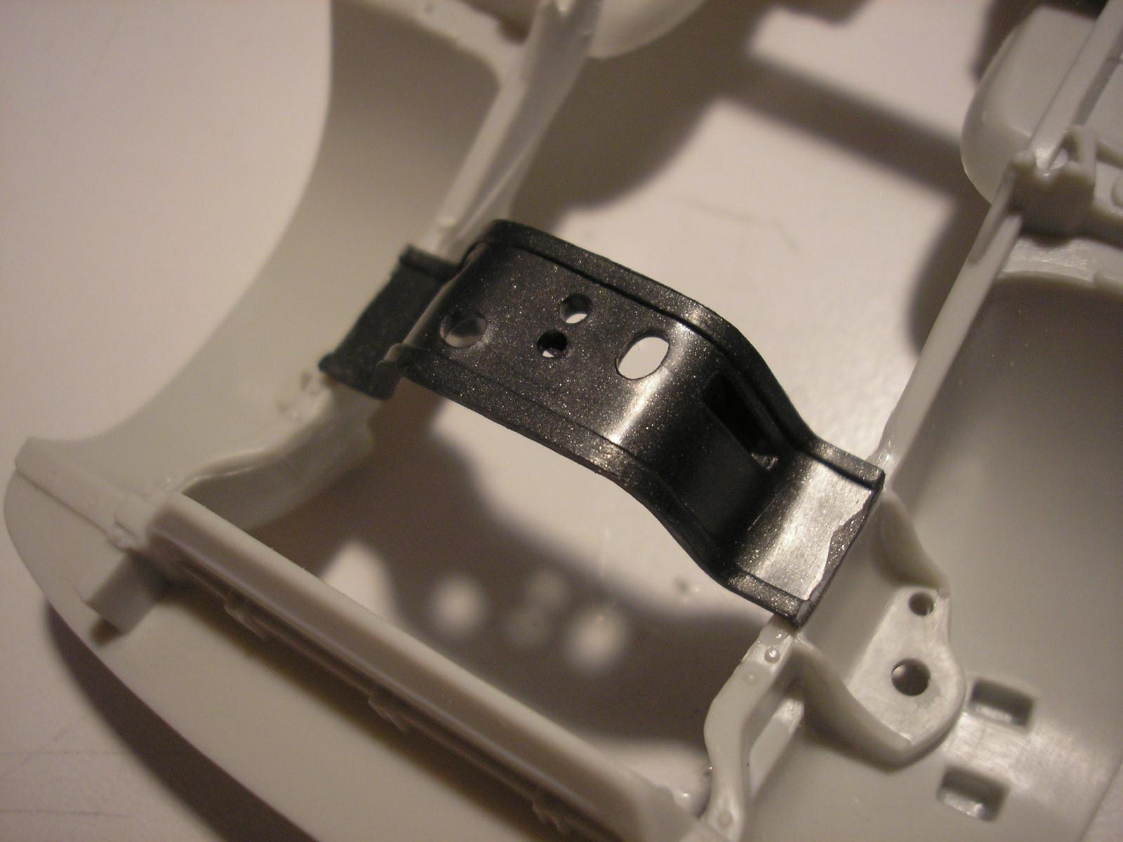

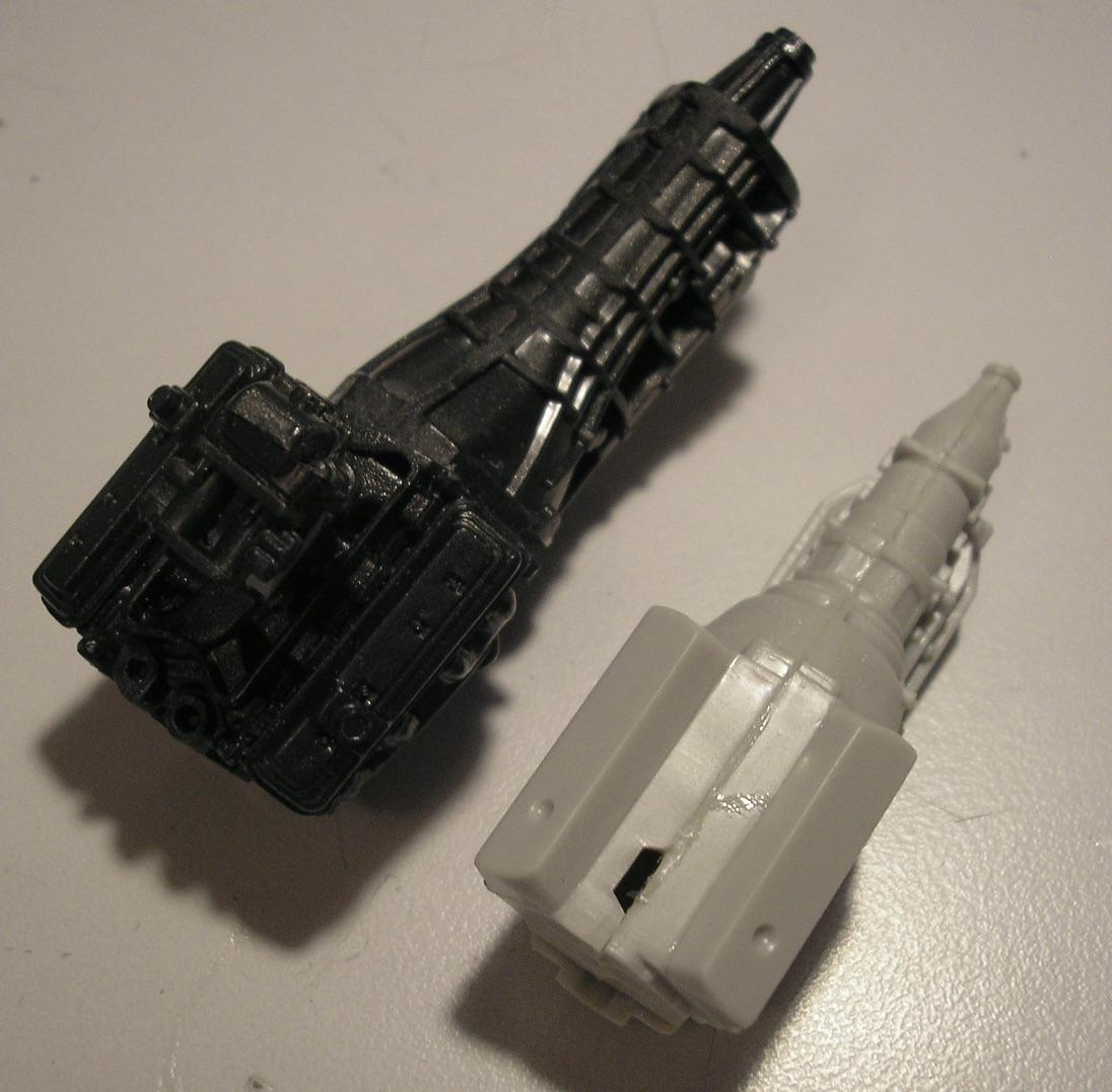

A crummy day here in Phoenix. Gray, rainy, dark, cold, (by our standards at least) and a perfect day for model building. Removed the console from the seat, and sanded off the corduroy looking upholstery texture. The interiors of these are very plain, no need for flocking with the color keyed vinyl floor mat instead of carpeting. I was running into a styrene wall trying to fit the humongous 1:24 460/E4OD in place of the little 1:25 351W/AOD combo: Until I got an idea: swap the deeper Monogram cross member on the AMT frame, thus allowing the engine to sit deeper and the suspension to sit higher at the same time. I love two-fers. That's looking more manageable. The duallie rear end and leaf springs were a near perfect fit to the AMT chassis, I made styrene tabs to mount the springs and lift blocks to get the rear end up. All pretty basic so far. -MJS

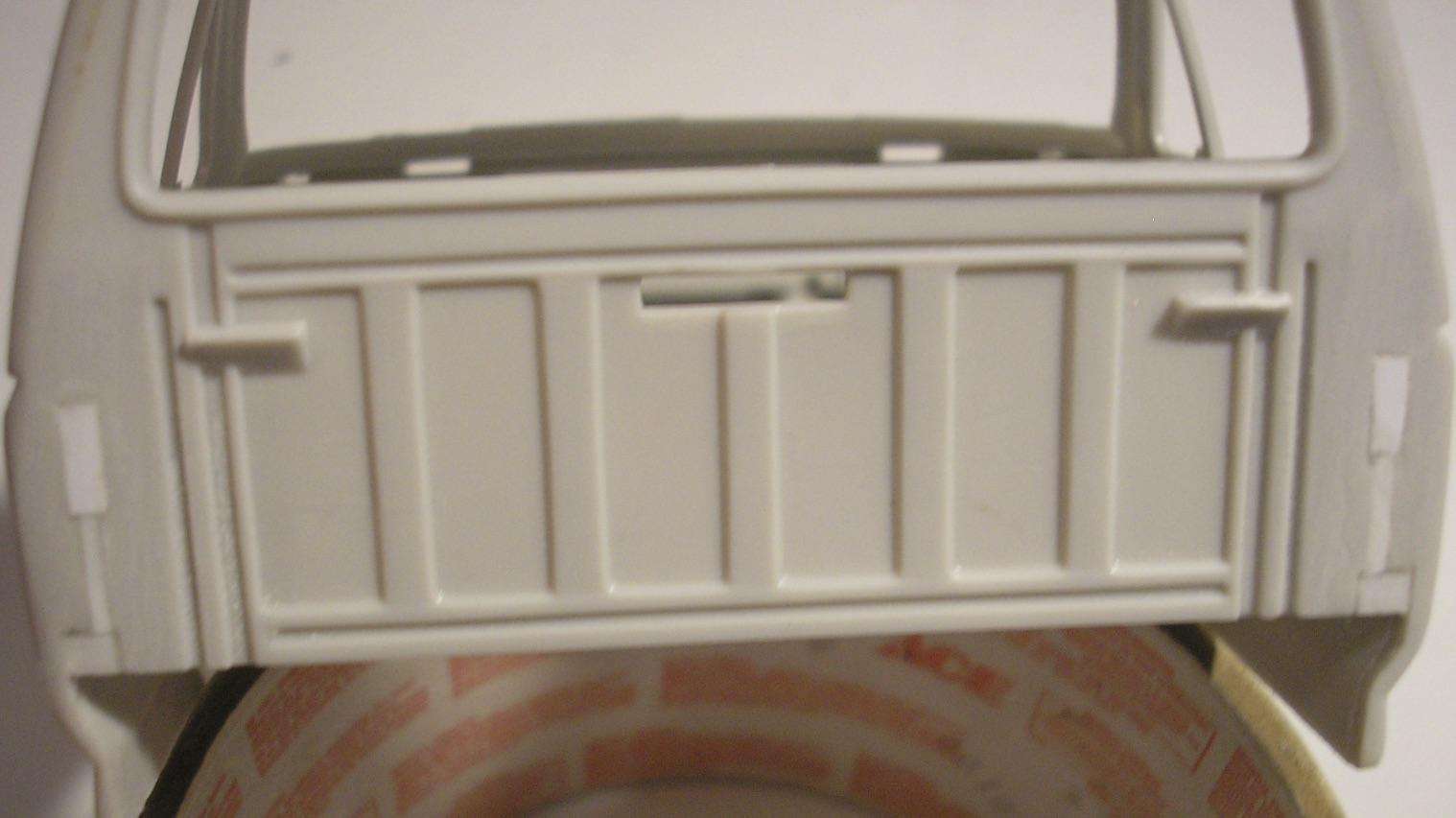

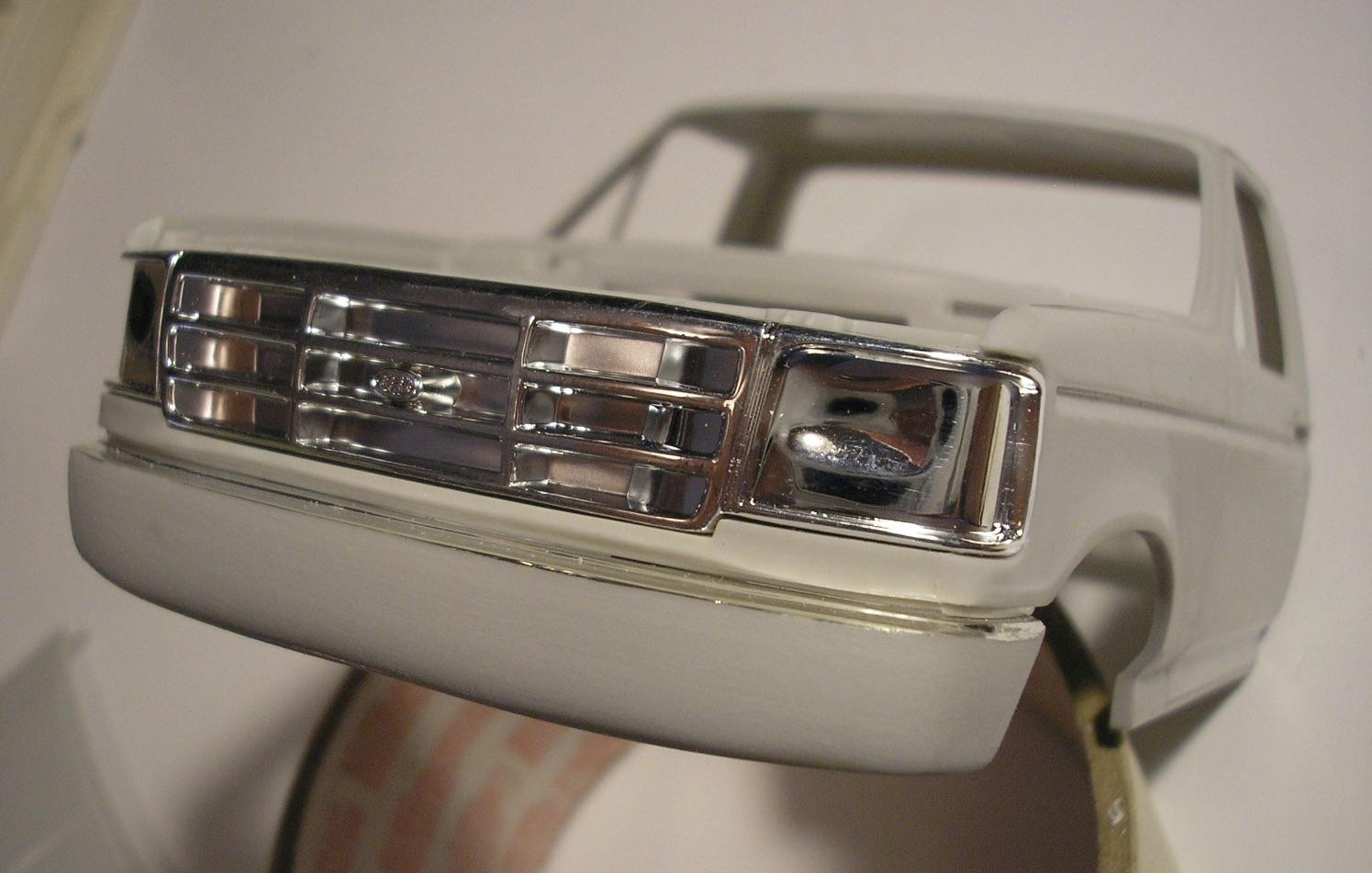

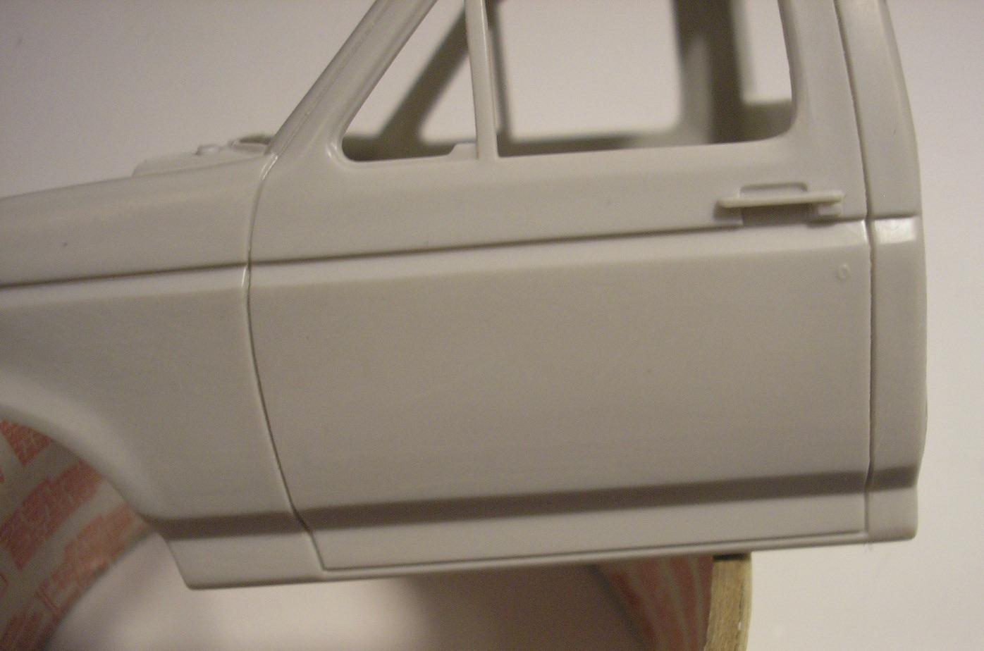

I've posted several of my builds here, but they have been from 20 years ago or longer. To mark a return from a long absence in the hobby, I decided to build something that I never did before, and to use kits and many aftermarket parts that I've had collecting dust for about as long. I've always built cars, almost never trucks, and I had these two Fords in the stash that I bought new, when they came out. Both the AMT F-150 and the Monogram F-350 dually are very nice kits that represent the real trucks well, but neither are really that interesting in box stock form. The '92-'96 is my favorite Ford truck body style ever, I like duallies, and the old standby Modelhaus service body is still available, so... Try to come up with something similar to that. One of those vehicles that you see 20 of every day, but never notice. Not a model of a particular truck, details and company logos to be determined later. I'll choose a company that I like. The first thing to do is make the fancy Lariat trim AMT cab into a plain-jane base model work truck. Shave and block sand the side trim off: Shave the bumper smooth and remove the air dam from it: And fill the bed slots on the back of the cab. This will be invisible, but I was on a roll. Since I build real cars too, this will be painted almost entirely with automotive paints that I've come to like using on my 1:1 projects. Next step: Monogram suspension, rear end, and drive train into the AMT chassis. -MJS
