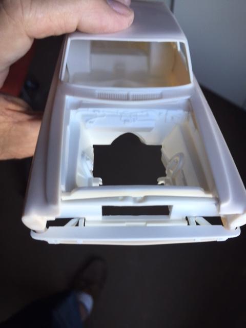

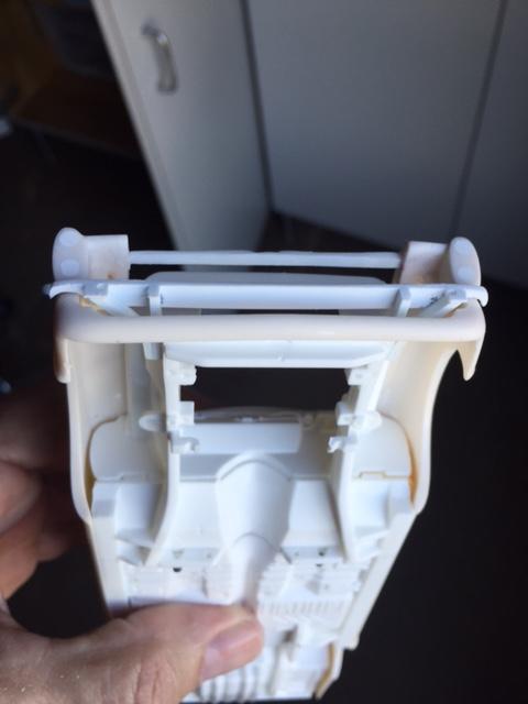

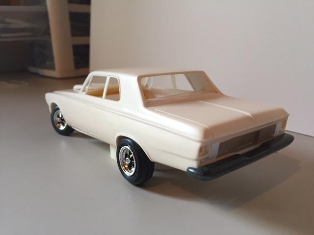

Getting closer to the finish line, here's a mock up with Keystones. The bumpers attach to the chassis with pins for positive location. Let me know what you think. Thanks

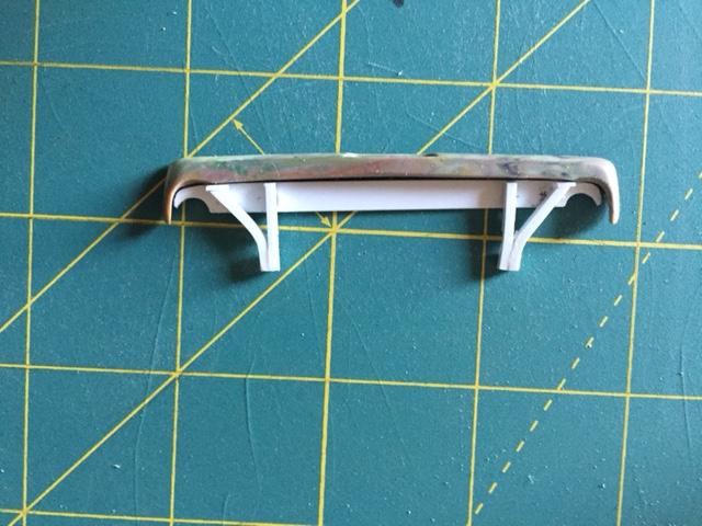

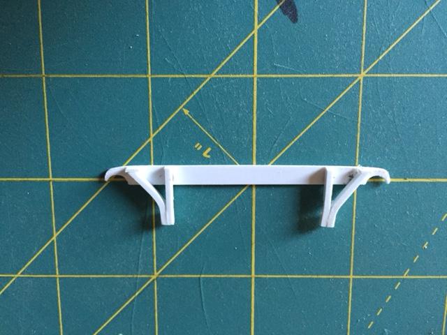

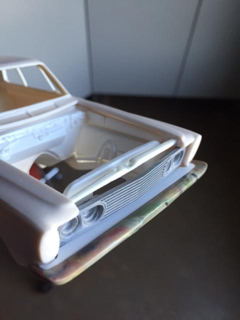

Been working towards getting my 63 Ply SS ready to send to a resin casting co (a real good one) and hopefully we can get this one as a kit. The master parts are almost done, just need one more door panel and interior alignment with body and chassis. Got the grille, bumper and bumper filler with brackets done and the locate to the chassis for positive fit. Re-did the dash board and gauge panel because I did not like the first one I made. All separate pieces and made the speaker grille from an old P/E grill. Here are the latest parts.

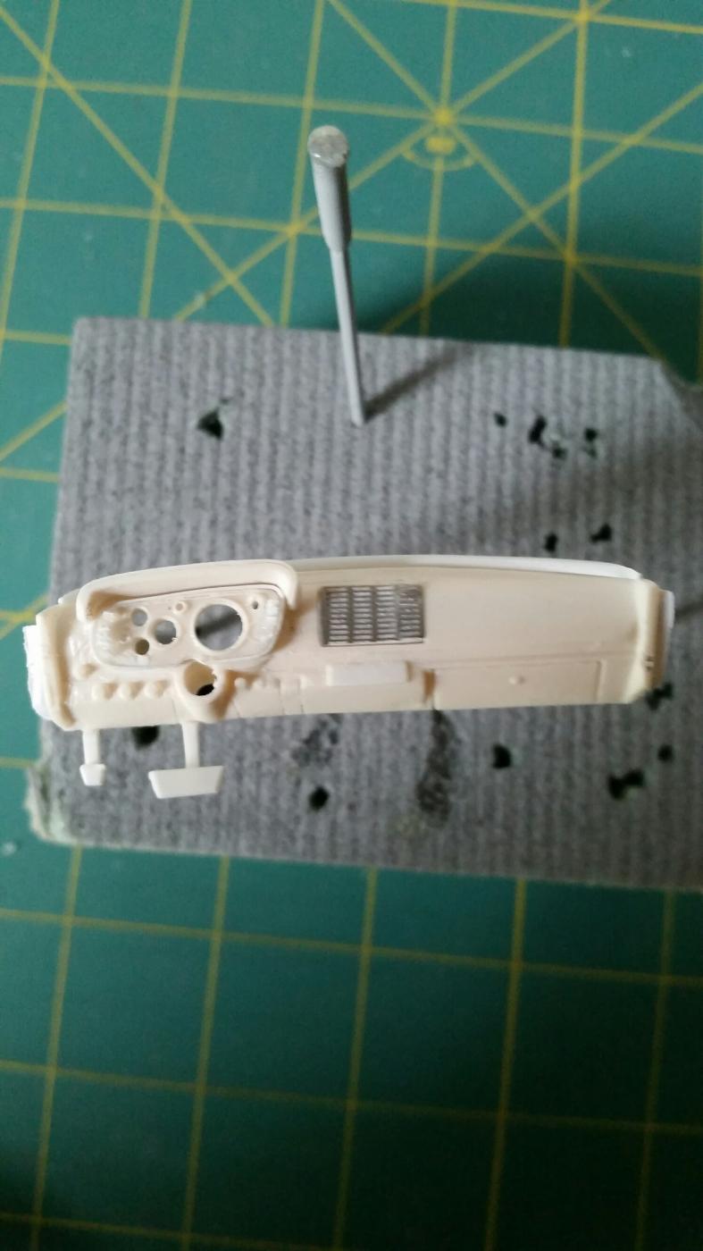

Been working on my 62 Dodge Dart dashboard, needs a little more work but I think I'm getting close to where I want it. I bought Best Model Car Part's 63 Dodge Gauge decals and the speedo decal is just right for my modified 62 gauge panel. Need to find decals for the round dials. -

I worked on the dash board, gauge panel and used an old photo etch grille to get the speaker grill close to accurate. Got the grill front splash pan and bumper done as well. This project is winding done and it will be ready soon for the resin casting. Your suggestions are welcome, thanks.

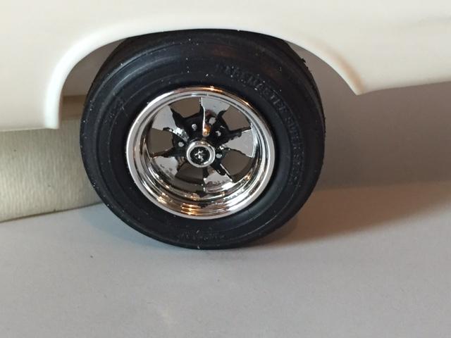

Thanks Ben. I started with MPC's 69 442 cut down and used various trim rings and rims for front and back. Drilled out the lug nuts and used M&R's resin acorn nuts. Working on getting these cast in resin.
I have been playing around with casting various factory Rallye wheels with and without trim rings and a couple of depths. I don't have the new Olds Hurst kit yet but I will see how mine resin wheels look. I'm working with a quality resin caster who is interested in my masters and hopefully will produce them

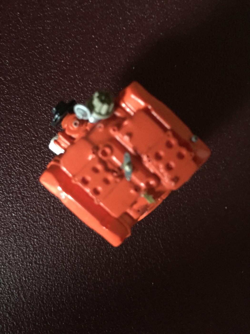

Hey John: I did this engine a couple of years ago, but I think its a mix of Tamiya orange, they offer two shades and mixed them until I got it close. Hope that helps.

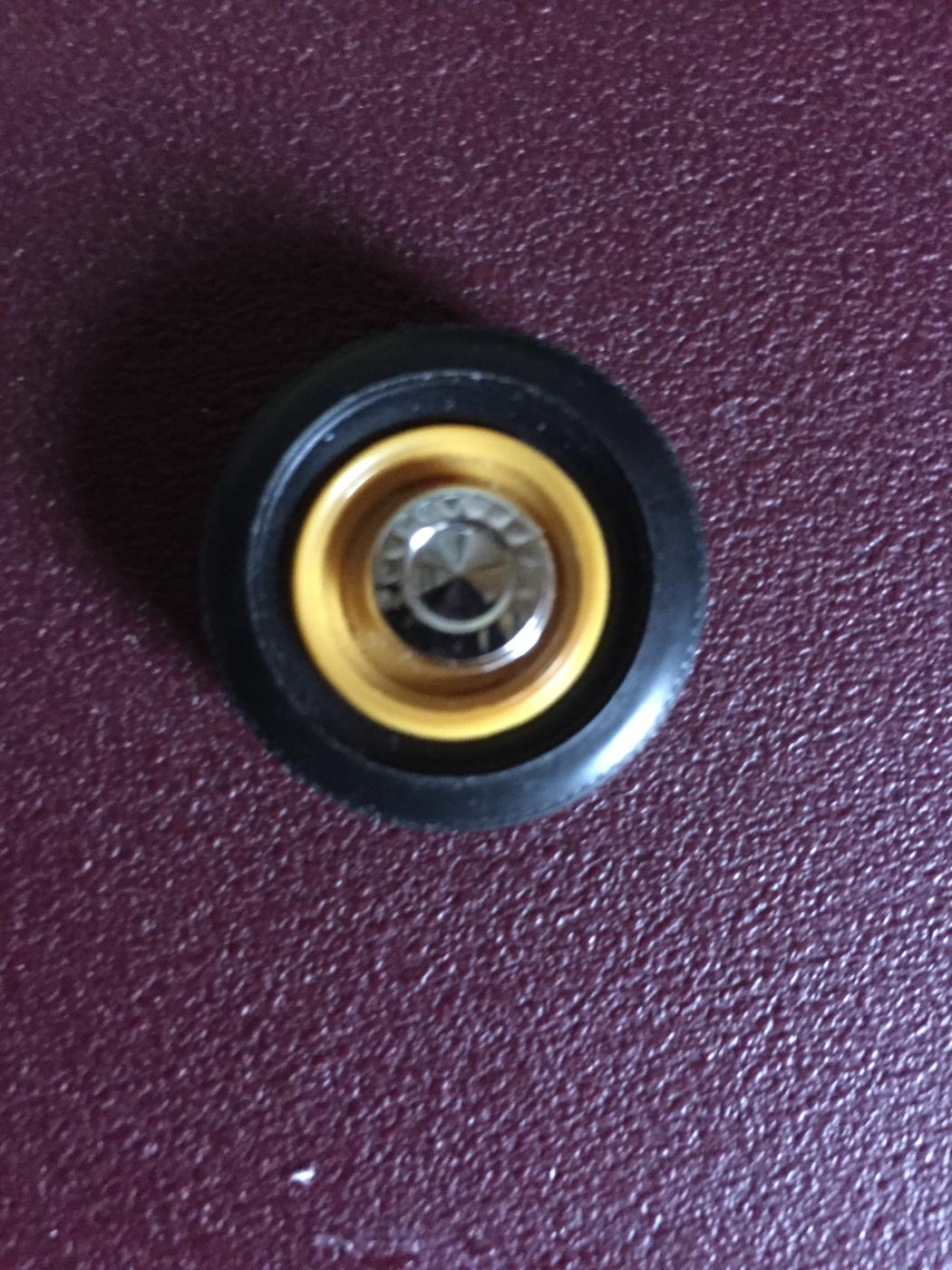

I have these hubcaps that were casted in resin, but I have them for a while and forgot where they came from. I will using them on my 63 Plymouth Savoy. -

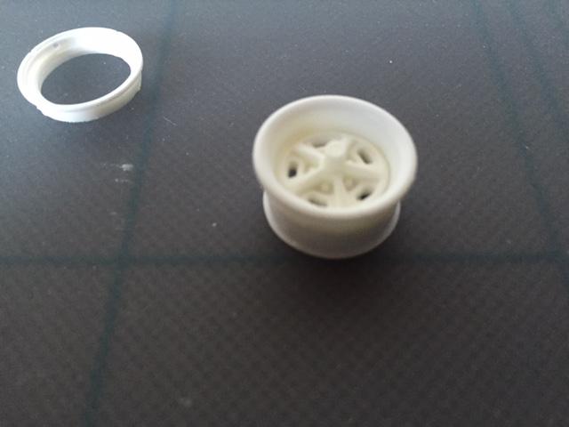

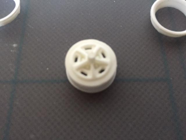

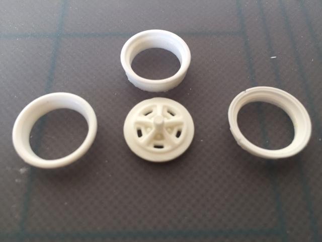

I have been working on various wheels to better detail paint them and mix-match rims and trim rings...here are the Magnum 500 wheels I have casted in resin as separate components. This way I can have Magnums with trim rings and exposed rims to chrome. -

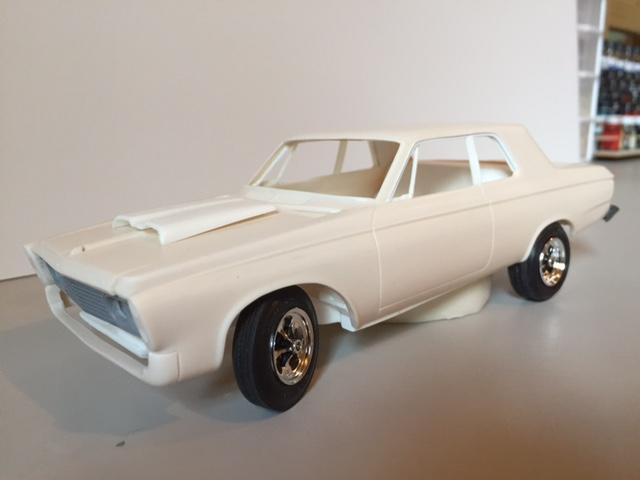

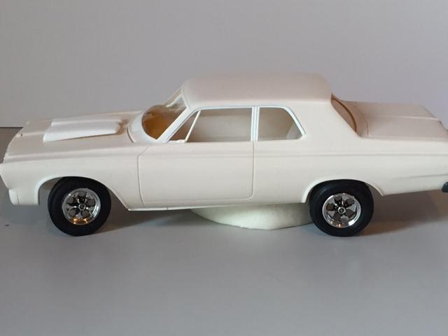

Thanks Tim, Bob and Dr Jay. I am hoping to get this one done in time for the NNL East. I'm using the Lindberg chassis but I corrected the shock mounts in the engine compartment with the prototypical correct style. The chassis had to be shortened about 3/16 and the door panels have been scribed to match the actual plain Jane interior. I may take a chance to draw up the dash gauge panel, speaker grill and scripts for photo etching, that will be tricky though. I mastered a wedge cross ram manifold to be more accurate that has the correct plugs and surface features and cast it in resin. I haven't decided on the colors yet but leaning to white with a blue interior.

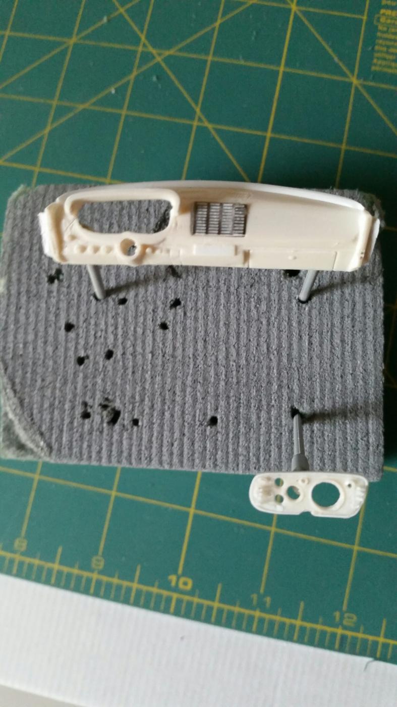

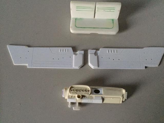

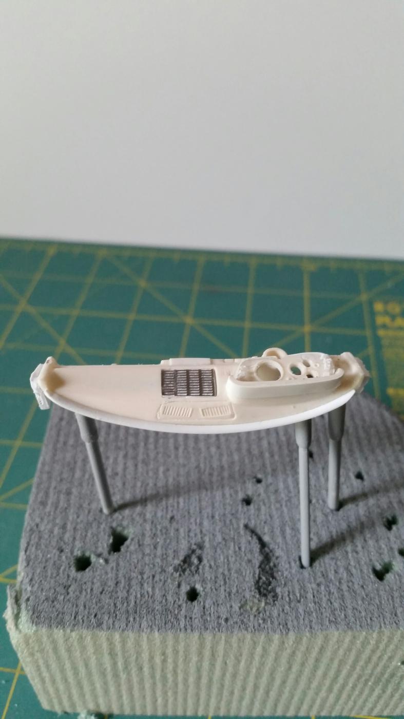

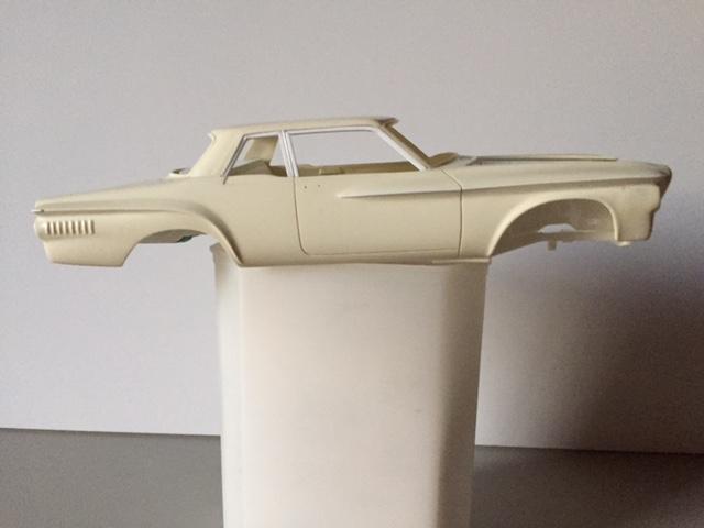

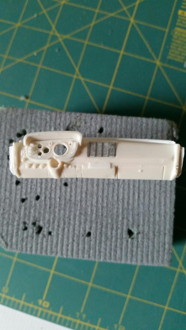

Dr. Jay I'm working on a 62 Dart Super Stock with full detail as well. Here is the dash and side panel I scribed. I included the body as well working it as a master to hopefully have it casted for resin.
