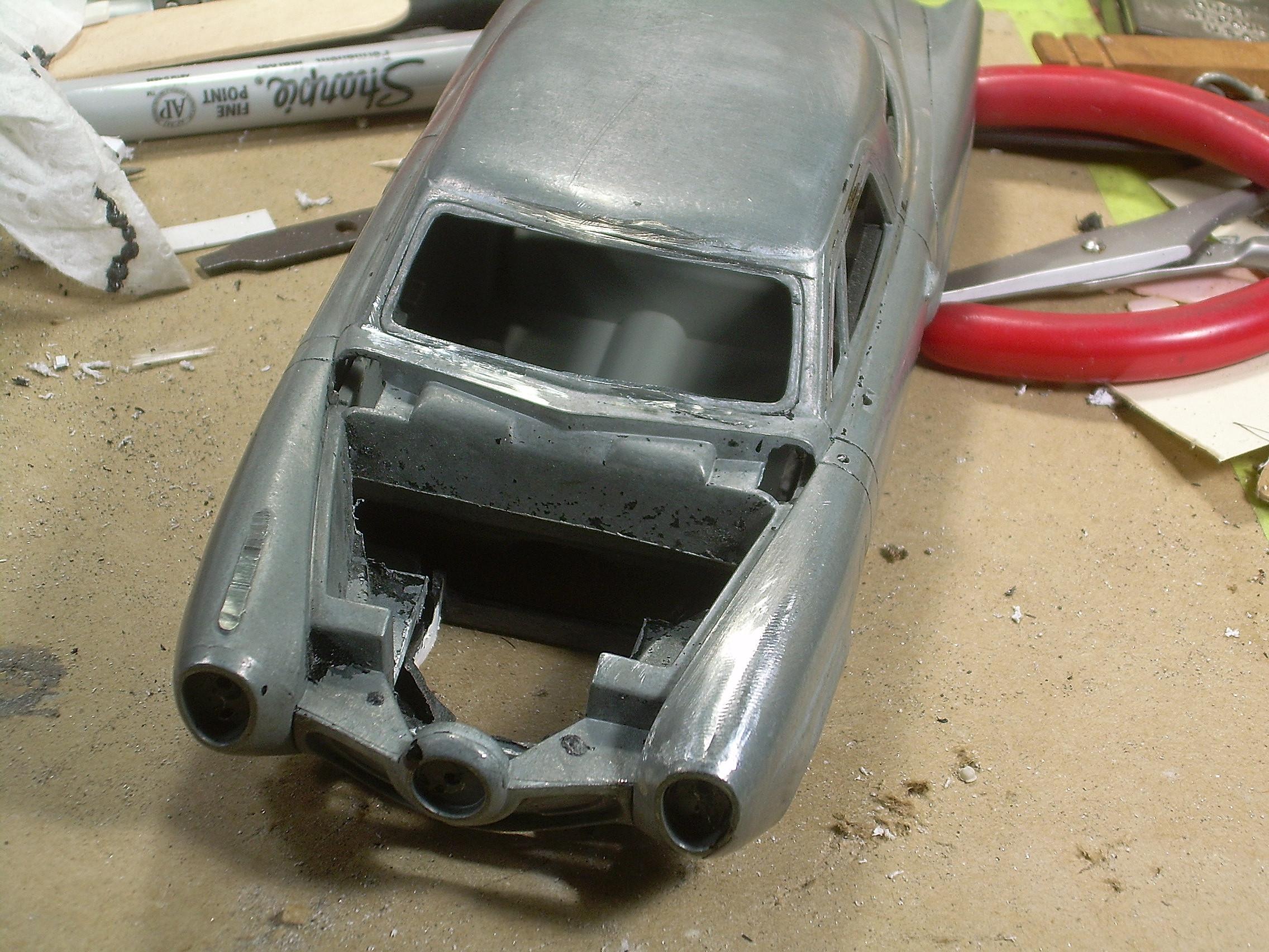

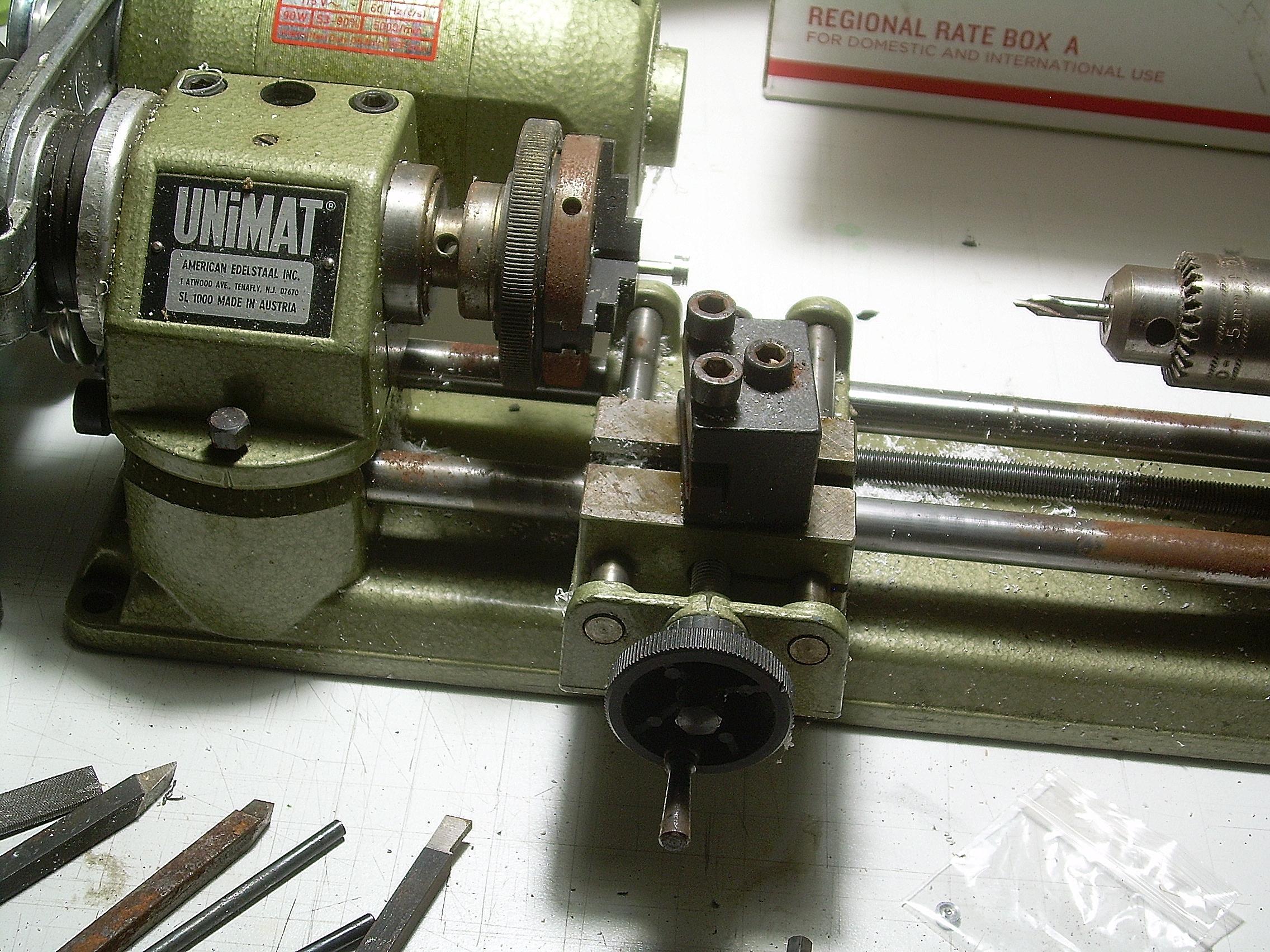

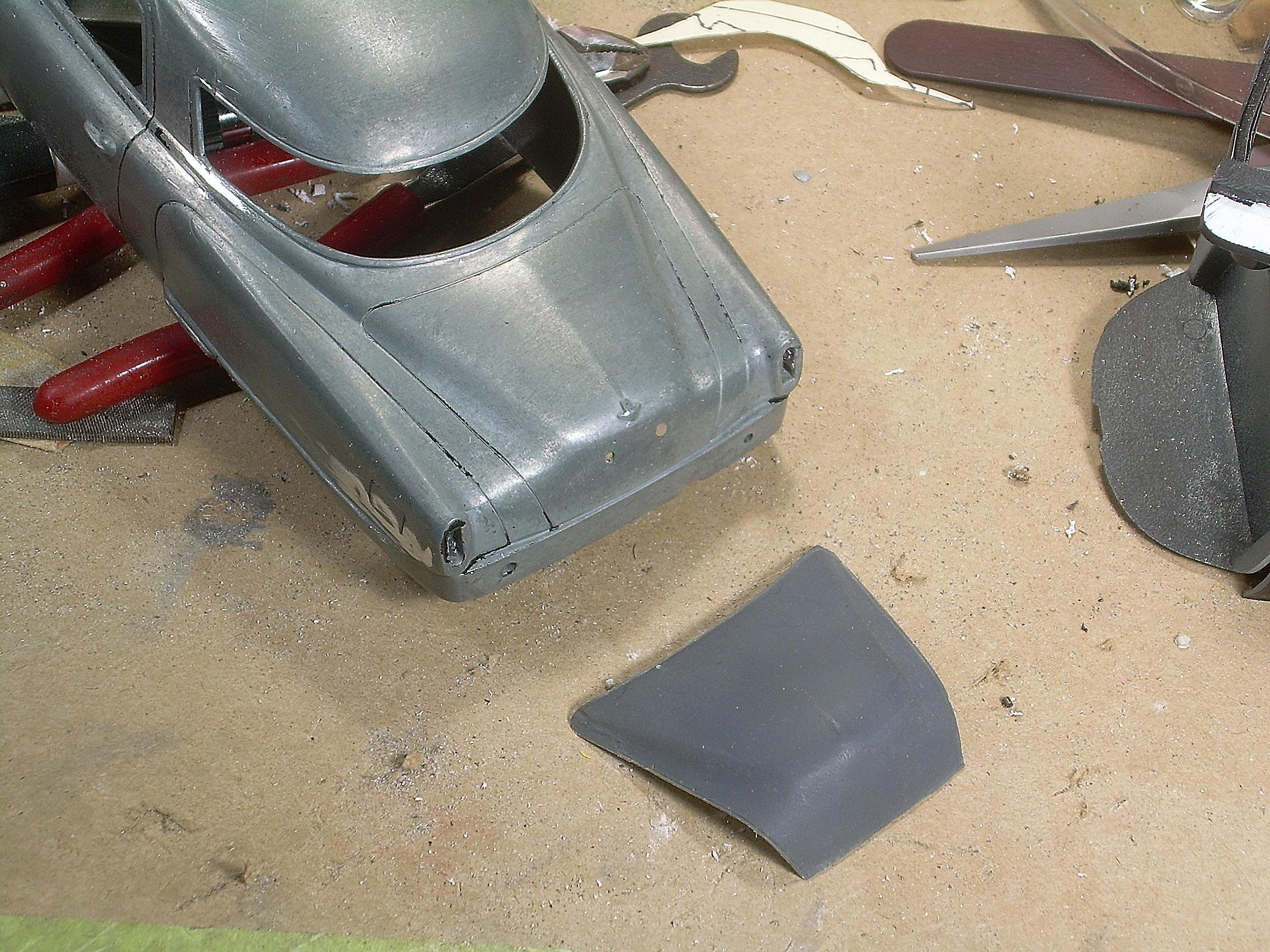

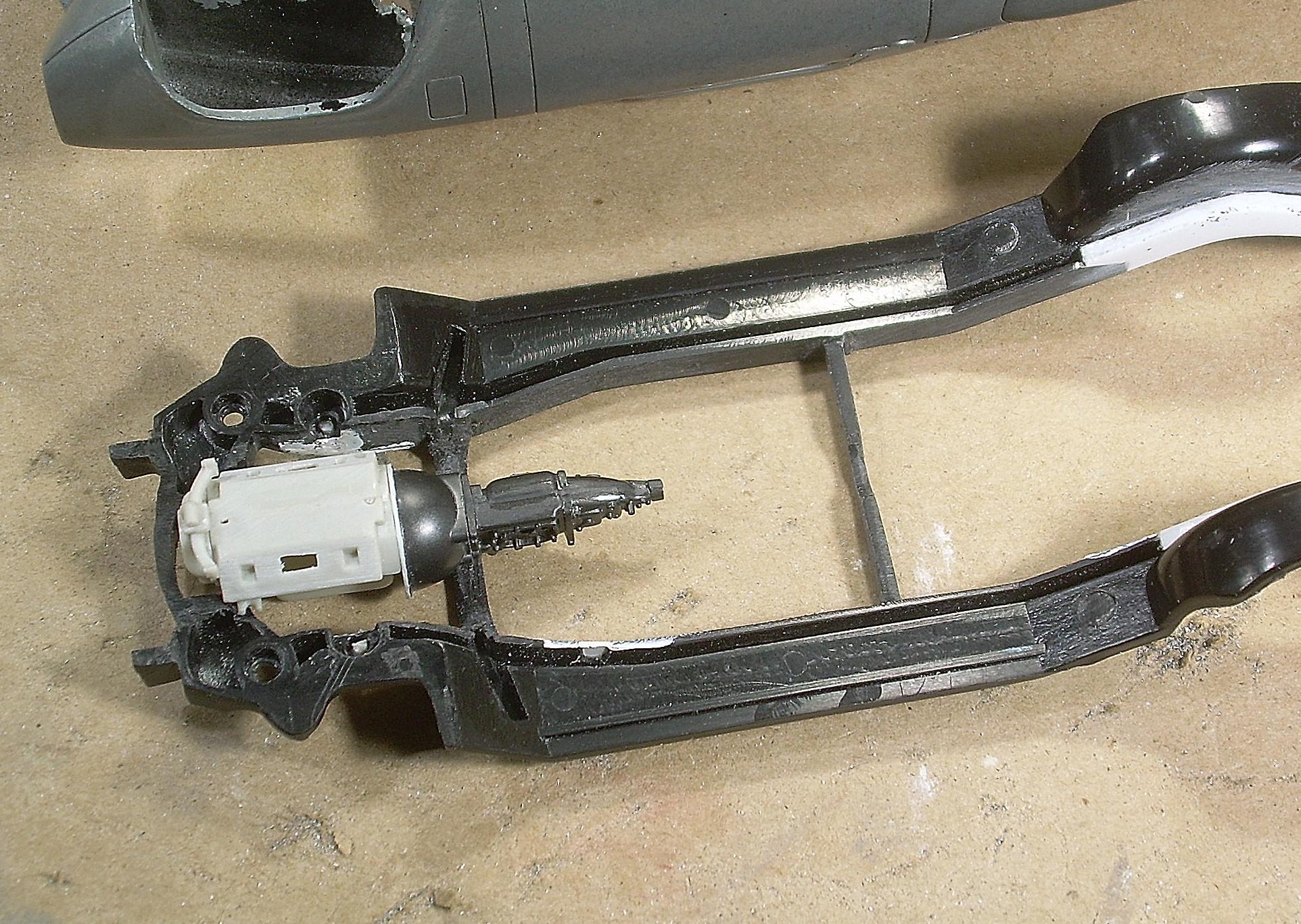

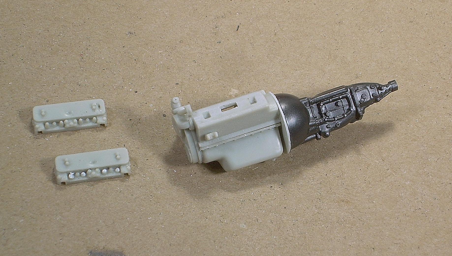

  11. While I had the little lathe set up, still on higher speed for aluminum, I thought I'd see if I could turn some pulleys. I don't really like most of what's available aftermarket. This was more to see if I could do something acceptable with the cutters I've got on hand. I'm pretty well satisfied. This is a shot of the decklid, closer trimmed, moving along. Body mods beginning, primarily de-chroming, removing the wipers, and reworking the top of the windshield opening to a more correct shape (including re-scribing the rubber surround). I got a little too horsey at the top of the pillar, but that's what they make micro-balloon and epoxy for. This model has its share of shape and proportion inaccuracies, and I could easily get into the usual never-finished mode if I don't keep myself on a short leash. This thing is already WAY beyond the original KISS plan. Lower part of the firewall got gone too, and some inner fender stuff. Engine's coming together. I shortened the bellhousing to look more like a Lakewood scattershield, and fabbed a simple engine plate to go between it and the engine (after thinning the flange on the bellhousing too). Heads have nice molded plug detail, but it's wrong, and is going away. Engine getting acquainted with the chassis for the first time. Engine in the body, and part of the reason I had to remove a chunk of the firewall. There's enough space at the front of the engine for the fan to clear the radiator, just like real. This session's money shot...the engine, bellhousing, and gearbox fit over the crossmember and under the trans tunnel just like I'd hoped.
  12. Thanks for the interest and comments, gennelmen. I'm pretty happy with the way the wheel thing worked, but I still need to diddle the drive pulley setup on the lathe to get her running a little slower for plastic.
