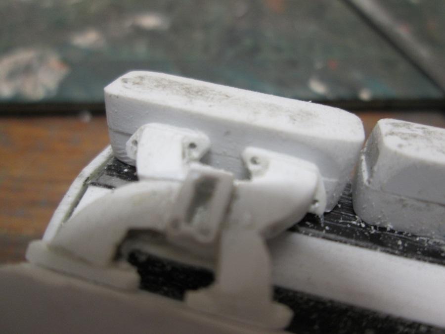

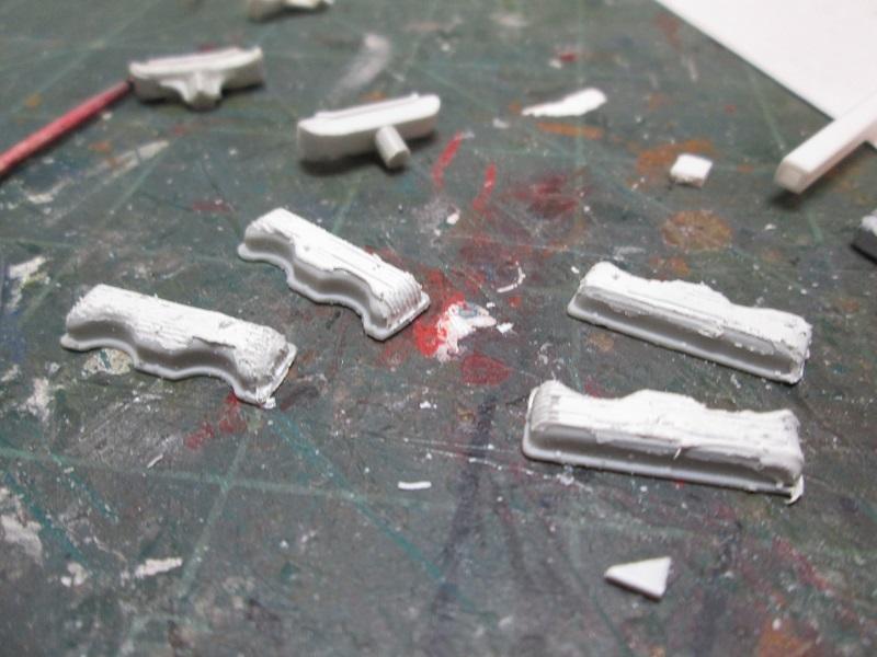

While adding pieces to the manifolds, I narrowed the valve covers by one saw kerf. Hardly noticeable but it does slim them down. Then I filled the ribs to get a smooth surface.
Remade the heads to obtain the taller profile of the originals.

Part of the "chunky" problem is visible in post 324. The runners don't rise high enough above the collector. Back to the drawing board.

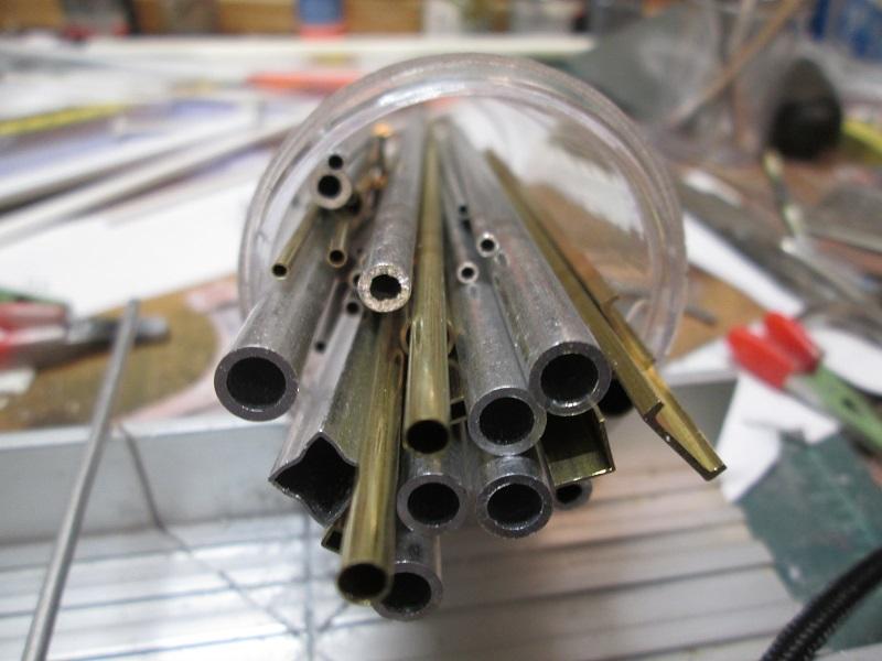

Remembered the stash of short tubings I got the other day. Cut some of that up and made what I think are more realistic frost plugs.
Also cut off all the ports off the exhaust manifolds and reconfigured them so the entire port is above the collector.

Here's a recap. Redid the exhaust manifolds using smaller material. They are better but not as slim as the 1:1s.But they'll do for now. After all, it IS a prototype. Prototypes get modified.

Just a thought on those 5 plugs. If you wrap some spool wire around a piece of small brass or aluminum tubing 2-3 times and then cut the wrappings you end up with nice small rings. Just trim the ends and squeeze them together. You can do any size you want.
Now why didn't I think of that.

I bought some smaller square tubing the other day. I may try another one with that to see.

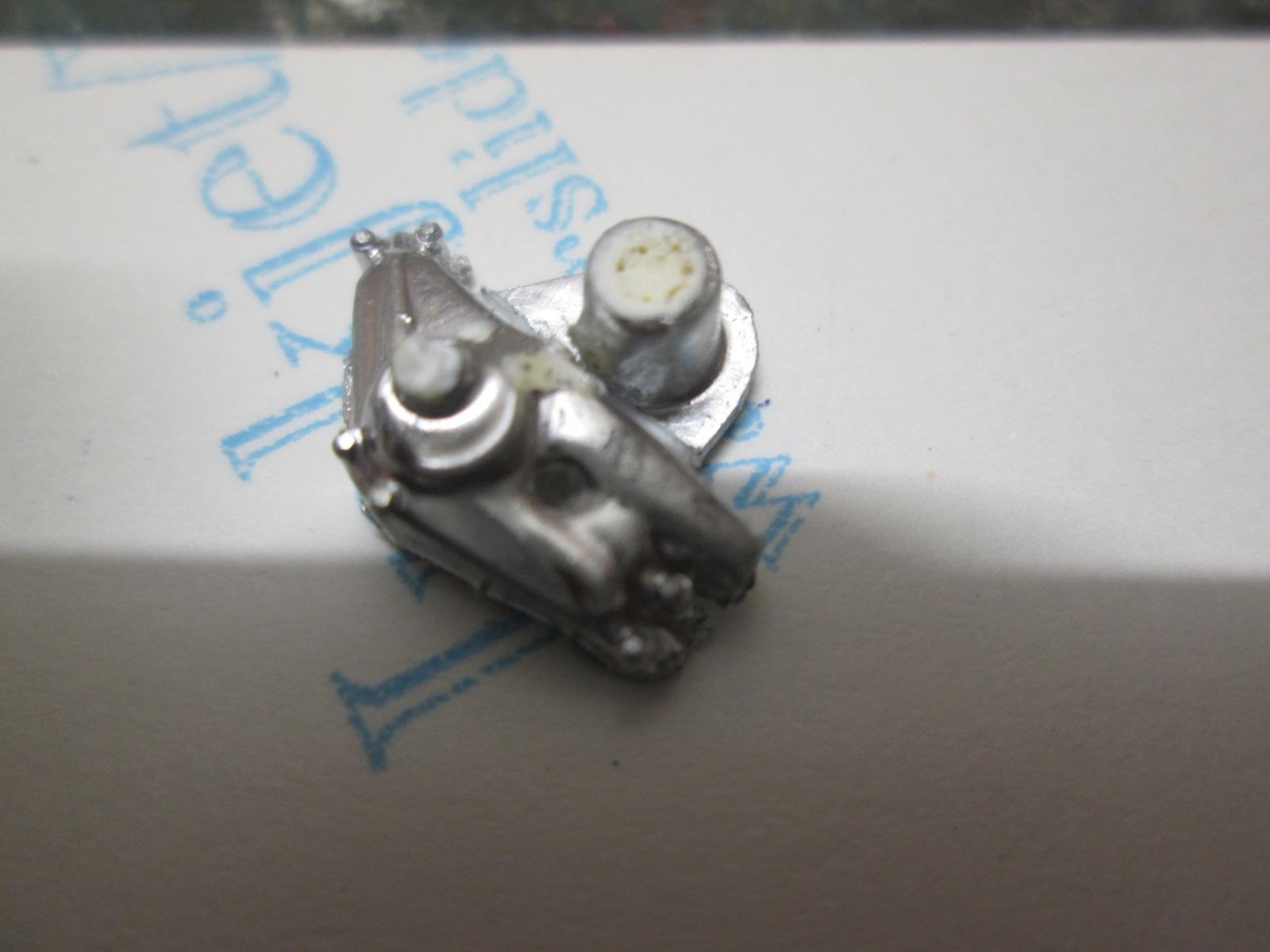

I had trouble visualizing the front of the water pump casting from the angled view in the exploded diagram so I asked for an end on picture from Thunder V12 which they provided. I then reduced it to the size needed and cut out a base from sheet styrene.
Then using bits I found the other day, I set out making the shape of the casting. The cover in the third photo will serve to make the bottom part.
Edited by landman
Front casting is taking shape. Also made up a fuel pump out of scrap bits.
