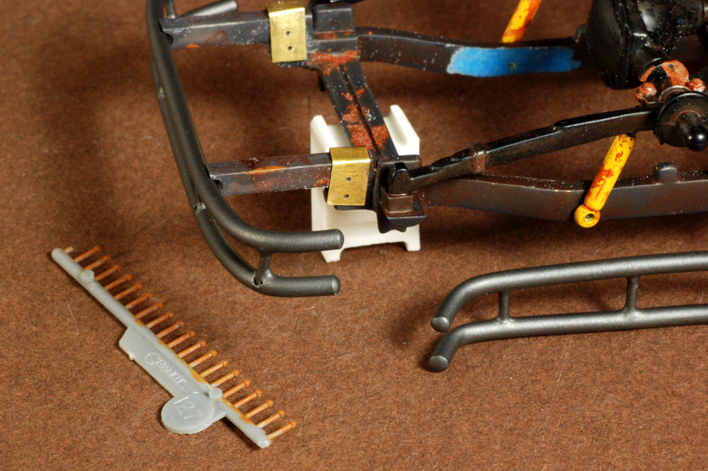

Foxer Posted April 29, 2015 Author Share Posted April 29, 2015 (edited) Here's my latest use of Bondic ... I made a bumper from aluminum tubes and needed to finish off the open ends. Normally I probably would have plugged the holes with some body putty ... let dry overnight.. and then sand flat and paint. Â These I just filled the hole with Bondic and let it form a raised bubble shape then hit it with the light. I didn't sand or touch it before painting this time. The ends are just perfect to me with their rounded shape. Nothing could have been as easy. Edited July 29, 2017 by Foxer Quote Link to comment Share on other sites More sharing options...

jeffs396 Posted April 29, 2015 Share Posted April 29, 2015 Looks like this stuff has potential Mike! The tube bumper ends look EXCELLENT! Gotta pick some up and play around with it... Quote Link to comment Share on other sites More sharing options...
