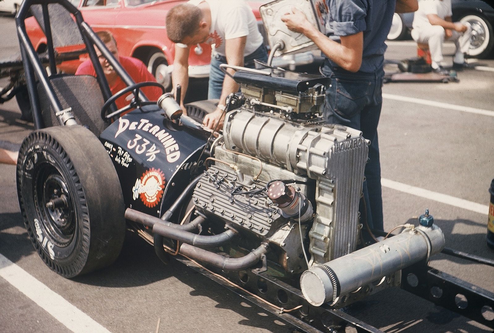

Greg Myers Posted May 6, 2015 Posted May 6, 2015 (edited) What iconic dragsters did these front blowers find their rides in? Edited May 6, 2015 by Greg Myers
Greg Myers Posted May 6, 2015 Posted May 6, 2015 (edited) And some were done as model kits Edited May 6, 2015 by Greg Myers
chunkypeanutbutter Posted May 6, 2015 Author Posted May 6, 2015 ^ Planning on building a near-replica of that... Was my profile picture a while ago.

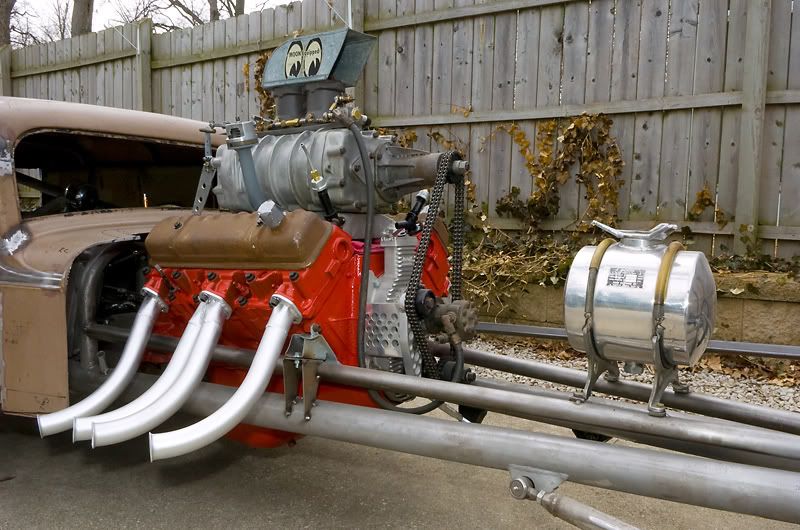

jbwelda Posted June 12, 2015 Posted June 12, 2015 well personally I think a front mounted supercharger has a lot to overcome in the way of well mixed air/fuel delivery when you consider how long and twisted those intake plenums are. its a wonder the fuel doesn't condense on the top wall of the intake tubes and just turn into drops instead of staying mixed in a good combustible mix. that's one reason why for instance the Mooneyes dragster above really improved its performance when they went to the conventional setup after the original front mount which was mostly for low profile and streamlining effect. and it seems to me that's why the form is rarely used anymore except in nostalgia cars like this one I shot at a recent meet in California jb

Greg Myers Posted June 12, 2015 Posted June 12, 2015 (edited) Now that looks safe Edited June 12, 2015 by Greg Myers
