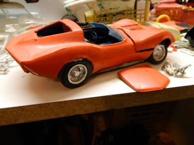

This started as an MPC Street Fever Vette. A very good friend gave it to me; it was complete, unpainted and (poorly) partially assembled. It came apart with only minor damage (all repairable) to a few parts.
The opening for the grill is probably the worst damage to the body, but not a real problem. The rear panel has some glue smears, but a minor issue as well.
I decided to go curbside. After I cleaned up the body and cut out the scoop in the hood I reinforced a few spots inside the body and cemented the hood on.
Next it was just a case of trueing the body, (typical 70s tooling), scribing in the panel lines to be more uniform and sanding off molded in details like the Corvette scripts.
I plan to go with some type of metal-flake paint job. I have a few bottles of original Testors Metal Flake colors that seem appropriate.

Looking good. Good idea to redo the suspension as built out of the box it sits way to high especially on the front end.
